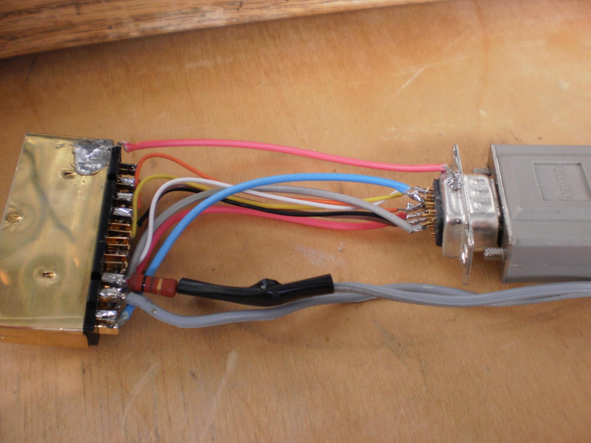

    Hi there, I wanted to connect my pc to my tube TV and using S-video isint really working.
    So I decided to make a VGA to SCART converter, I used this site as my project
    http://www.idiots.org.uk/vga_rgb_scart/index.html
    I did everything according to the schematic, but skiped connecting the 12v, as I belive it's optional.
    Now when I start the computer the TV screen flickers with yellow lines, then when booted, it's just black screen, and no difference what settings I use in the control panel.
    So nothing works.
    So is there anyone that could assist me with this?

    Hi - perhaps if you were to post pictures of the wiring to the plugs we could check them?
    Did you select Video on the tv source.
    is the TV known to work with video input.
    Did you get this bit right:The 'Blanking' control input signal tells the TV that you want to input video from either a composite or RGB source. You will most likely see a completely black screen if you try to use the RGB to SCART lead without using this pin to select RGB input.

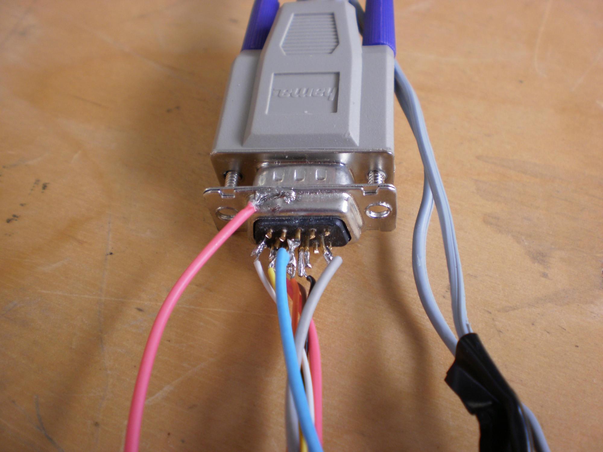

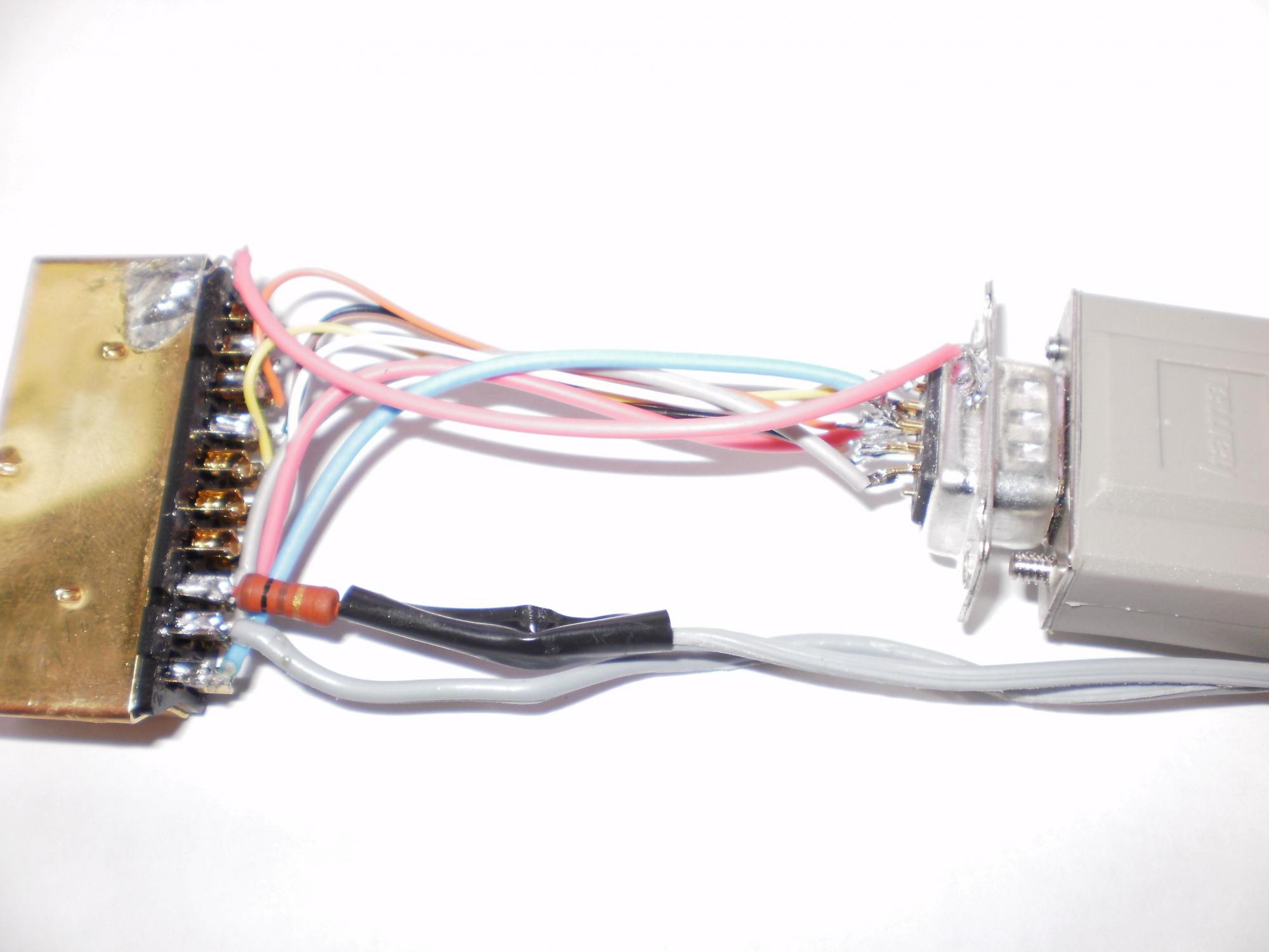

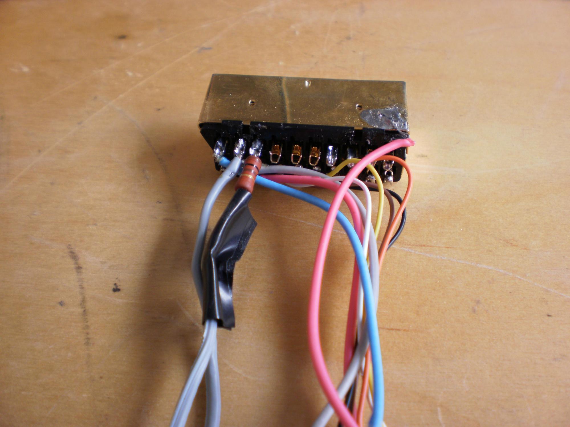

      Hi and thanks for the response.
      I hope those pictures are good enough, i'm a terrible photographer lol
      yea I selected the video source on the TV and the input is working with other things.
      I belive so, pin 18 is - from the molex and pin 16 is + from the molex with 100Ohm resistor.

        Hmm - had hoped the wires would be thinner, anyway i am sure you have checked.
        I recall looking at this sort of thing 18 months or so ago and whilst they say it works i'm not so sure. You can buy these cables but they tend to work in the opposite direction for playing video into a projector. Its to do with the timing/scanning and if you look on ebay it has warnings. They had them on amazon for a while - they are still on but are all listed as Scart TO vga.
        I think you will struggle to get it to work and if it goes wrong as the warning in the
        article says you can blow your video card, tv or both. Is it worth it.
        Does tv not have composite in sockets. I think I may have tried at some time vga to composite on a video recorder and then scart to tv but it degraded too much.
        Perhaps others will be more encouraging - good luck.

              Only so that I could see them - I could only make out one wire at both ends and the ground wire,
              so I felt I had wasted your time in getting the pics.
              From a saving your video card from damage point of view I would
              seriously consider putting some heatshrink insulation at least on alternate
              wires/pins
              When you tried the svideo did you use an adapter ? the sound has to be
              wired separately and apparently the scart socket has to be able to accept
              s video signals and the video cards has to send in pal not ntsc.
