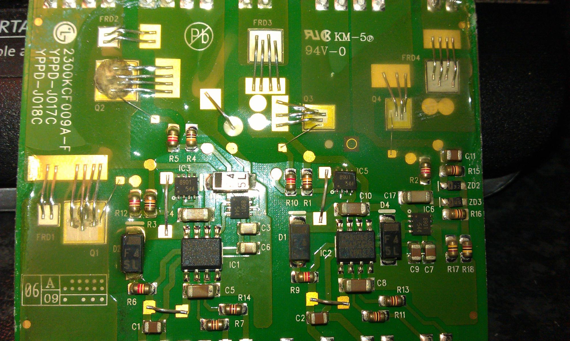

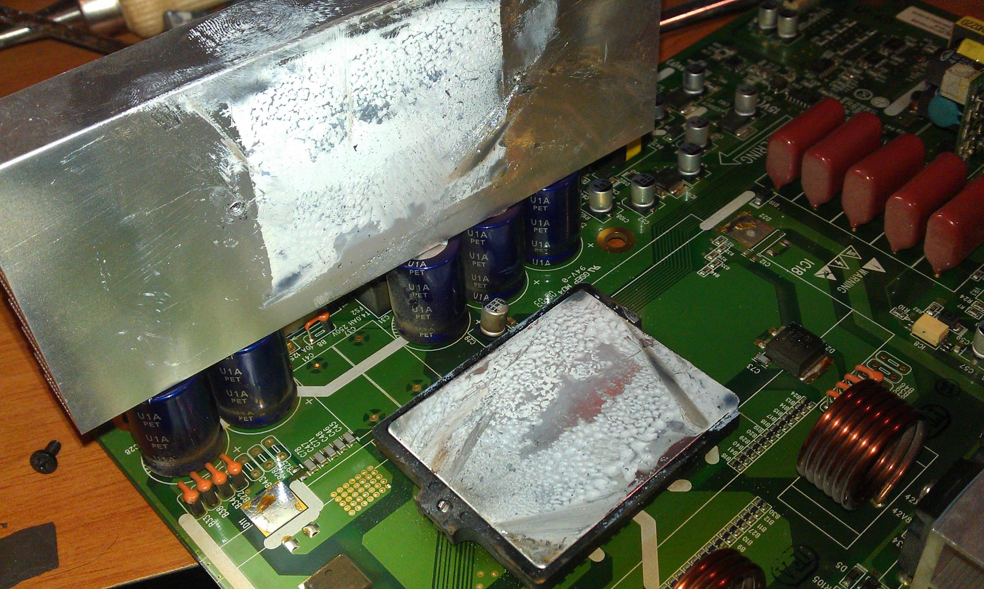

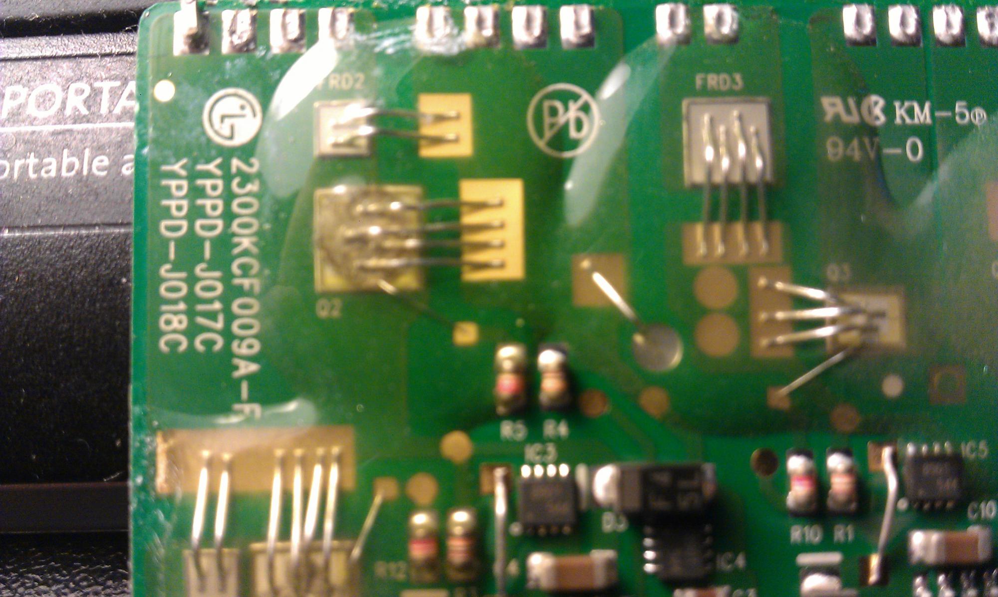

                Re: LG 42PC1D Y-sus?
                Got it out, took a while with the heatsink, but out and the board looks fine.
                I can see some damage to the hybrid I'll stick up some photos.

                  I drill holes in the board now to get at the screws to remove the heat sink.

                      I cut slot in the end of the screws that hold the heat sink on and screw them out that way. You dont drill through any traces that way. To remove the old IC, I use a dremell tool to cut all the legs off, then pull each leg out with a hot iron. You never damage a trace that way. The ICs are available on ebay.

                        One word of caution; be sure to check that supply voltage to the IPM is stable +15V (or +18V) and of correct level. A bad supply could cause the new IPM to blow. This is because the supply is used for all gate drive circuits in the IPM and a too low gate drive voltage could cause too high power dissipation in the IPM power FET's.
                        Sometimes I use to add a 47uF cap directly between +15V supply and GND to improve ripple rejection close to the IPM.
                        I have managed to replace several IPM's without having to drill or do any special tricks. Having a good soldering station is all what's needed.

                          The traces are 1" wide so it`s really not an issue. I do this to inspect solder joints directly under the chip after soldering and you need alot less heat to remove and install the ipms.

                                    New part in, BINGO!!!
                                    Thanks for all the help!!
