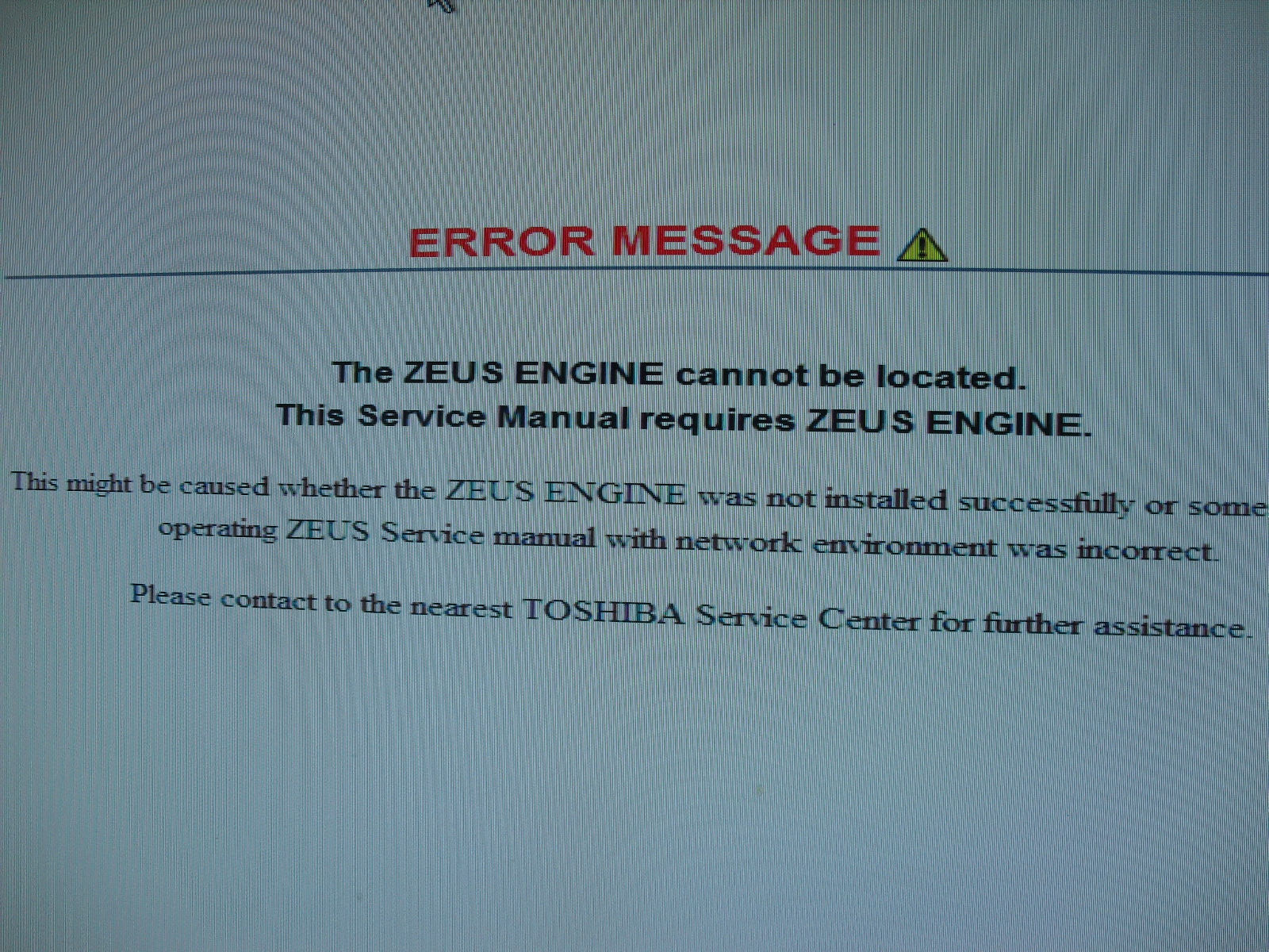

      So heres what ive done with this zeus setup
      Installed DWF viewer
      Installed the zeus programme then did the patch..when try to open the mainboard manual i get this error

        Hi - i can feel the heat over here.
        If you have got the RAR file in winrar
        Double click on html folder
        It will then have Images folder and files below
        About 6 down there is one called !adj-sm.html
        Double click on it
        Is that what you need for now?
        Dont explode if its not

          Thx alot fella..that worked a treat..now to figure it out

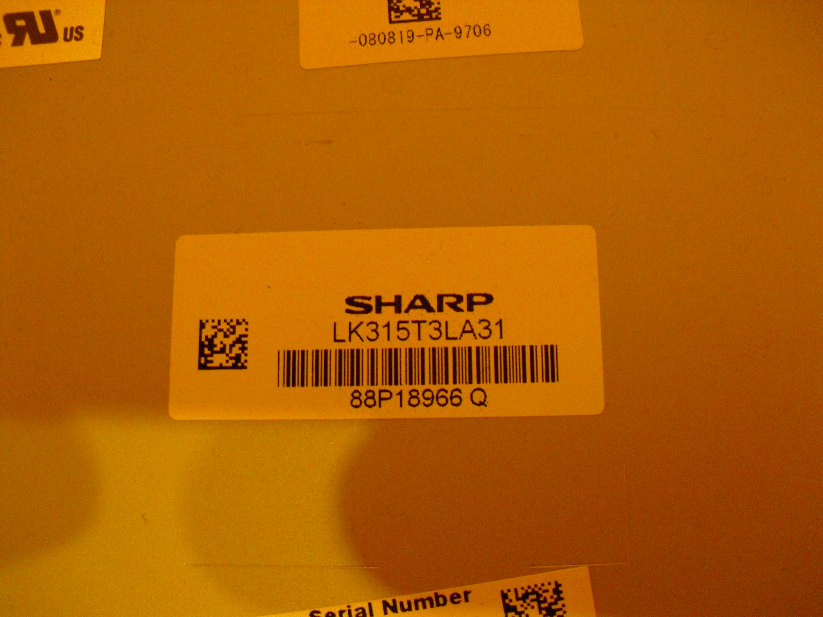

            So because this board came from a 37" model & its installed in a 32" the panel data needs changed,,im a little stuck here as i dont want to mess owt up..heres some info on it & would appreciate if any1 has had to change these settings before ..thx
              #66
              Re: toshiba regza no picture
              Do you still have the TV open?
              Look at the sticker on the back of the LCD panel. It will tell you model code and probably option numbers.
              Maybe try putting the old board back in, with the menus accessible, and copying down the panel config?

                      Do post a picture of the panel sticker on the back of the TV.

                        The 32" screen vendor is SHARP
                          #72
                          Are you sure does it say that on panel?

                              Interesting - Sharp do make nice LCD panels.

                                          the zeus program is needed to beable to read this toshiba manual..its not the same as all others from ET..
                                          Yep spot on,
                                          For PC
                                          Install Zeus ,right click on the HTML ,file open with Internet Explorer ,
                                          Allow Active X Control ......job done,If it still don,t open IE's security level is to high... lower it !
