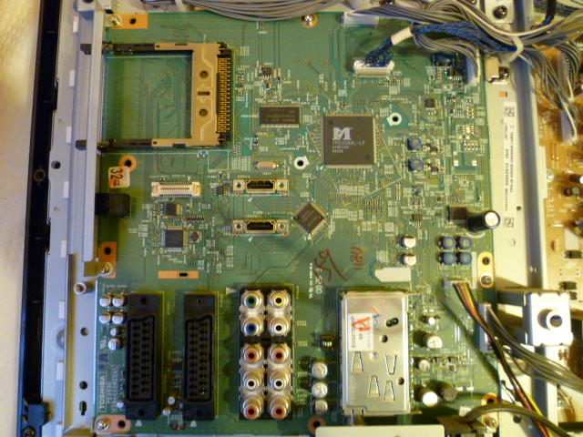

    hey guys n gals..ive a toshiba 32AV555D that will not display any picture..it has audio & the backlights are on..it will display programme guide & menu etc but no picture.. ive tried downloading schematics from electrotanya but no pdf in rar filesthx

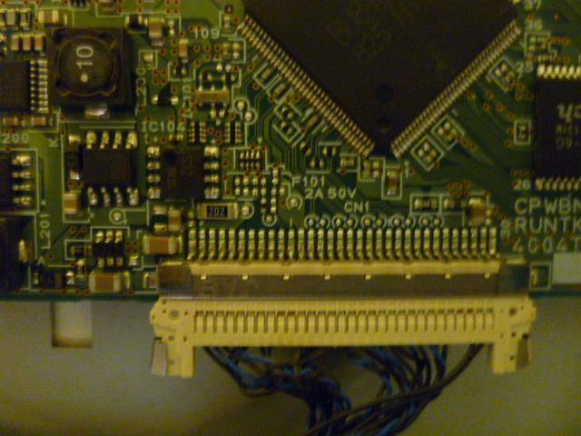

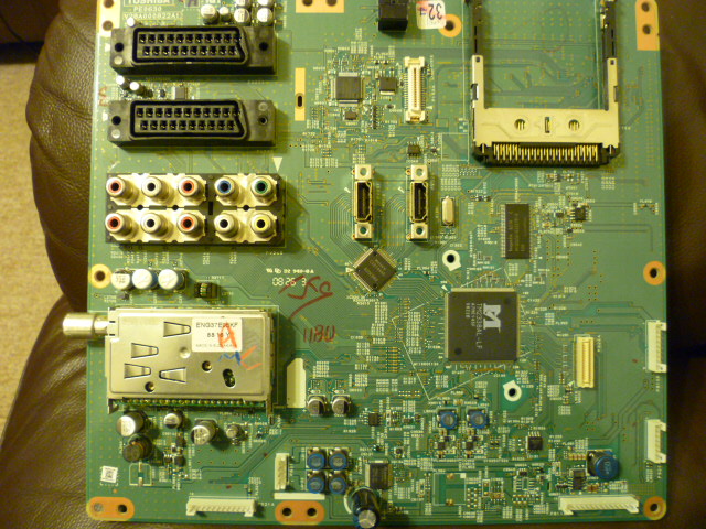

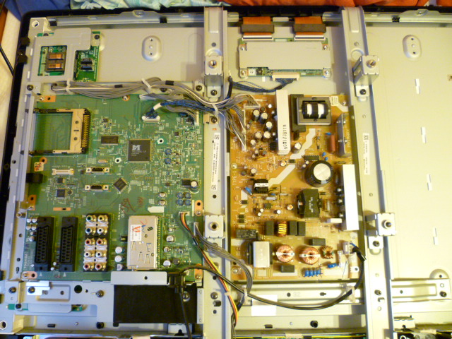

        these are best pics as no natural light..heres 1 of t-con..is the smd with 202 the fuse if so that tested ok on continuity..thx

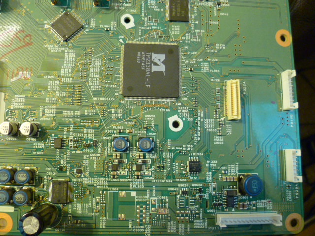

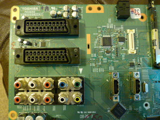

          Re: toshiba regza no picture
          If it displays the OSD overlay - i.e. menus - then the problem is with the main board.
          Check all LDOs on the main board, and any fuses you can see.
            Cheers tom..will start looking over mainboard..thx fella

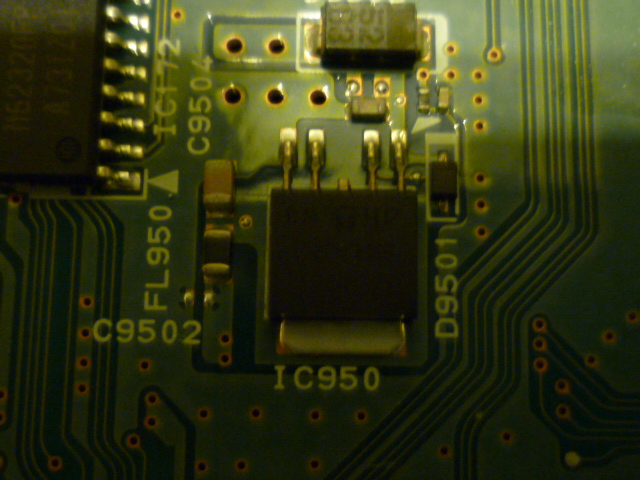

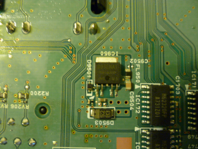

                    sienoki
                    • Jan 2012
                    • 314
                    Originally posted by sienoki

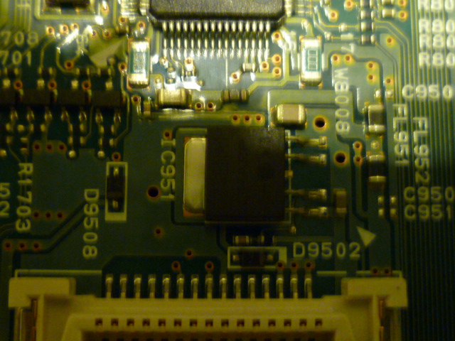

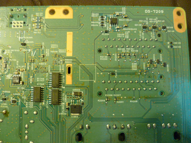

                    PM me when you going to leeds uni & i will see what ive got to rid of as they are taking over my place & r lass is going nuts

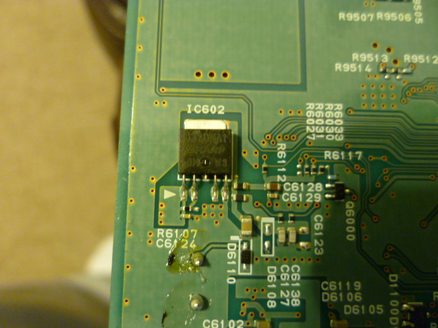

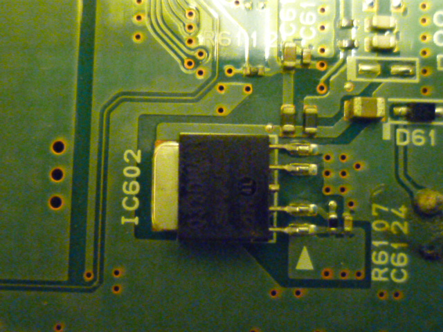

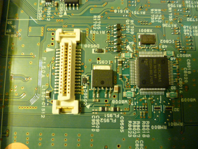

                    R these the LDO,s..thx
                      1,2 and 5 yep. Check all pins and note part # down.

                        IC951=033ENA1=SHARP..thats topside
                        1. 5.02vdc
                        2. 4.88vdc
                        3. .045vdc
                        4. .041vdc
                        IC950 same part no & brand..bottomside
                        1. 4.81vdc
                        2. 4.88vdc
                        3. .027vdc
                        4. .018vdc
                        IC602=033DNA1=SHARP..bottomside
                        1. 18.07vdc
                        2. 10.14vdc
                        3. .029vdc
                        4. -.002vdc
                        all measured with power on black probe to chassis screw & red probes to each legs..thx

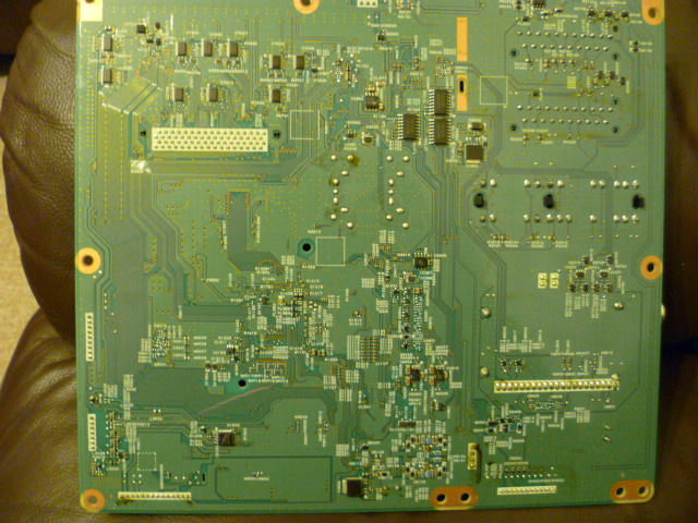

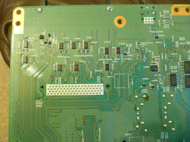

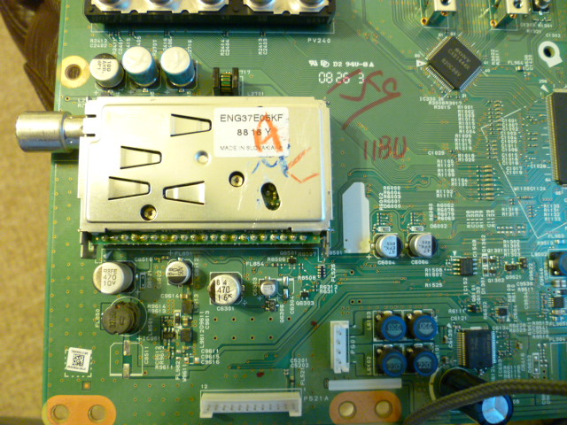

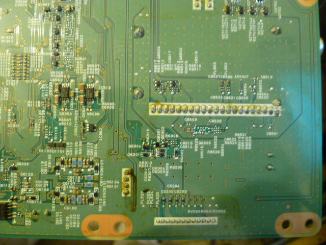

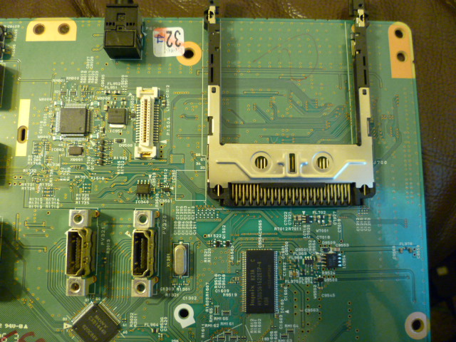

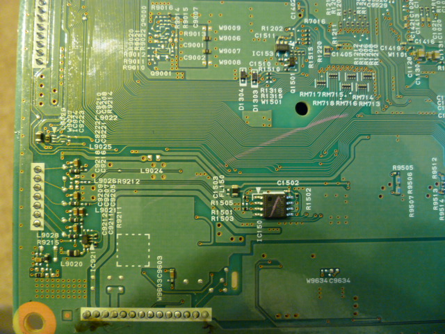

                          Ive taken 1/4 pics of both sides
                            Can you check the tab pin?

                              The wire pin outs?
                                The wire pin outs?
                                You've got 4 pins on the bottom plus a fat tab on the top. The fat tab is probably the LDO output voltage. It is also used to heatsink the regulator.

                                  the tab pins readings..
                                  IC951=from OL to 3.27vdc
                                  IC950=same reading as IC951
                                  IC602=from OL to 3.28vdc
                                    What do you mean by OL, what range did you have meter on?

                                      Got fluke77 on VDC quick O.L on display then the reading..thx
                                        That is normal for an autoranging meter. Assuming those regulators contain "33" in their part #, they are fine.
                                        Are there any other regulators? Like these:
                                        http://www.ictradenet.com/models_pic...PAK,TO-252.jpg
                                        http://upload.wikimedia.org/wikipedi...4/4f/D2PAK.JPG
                                        http://www.national.com/images/pkg/mp04a.jpg
                                        http://media.digikey.com/photos/Rohm...B1132T100R.JPG
                                        Anything you see that looks like those could be a regulator, so note down the part # and test the pins.
