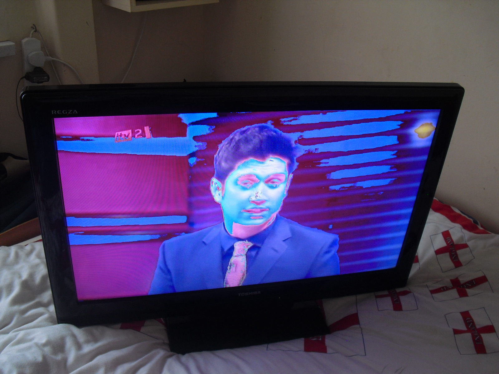

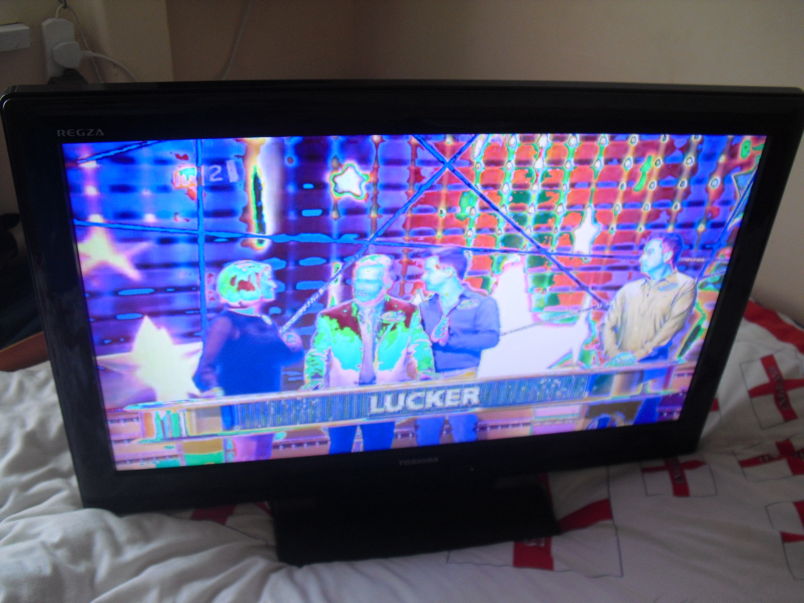

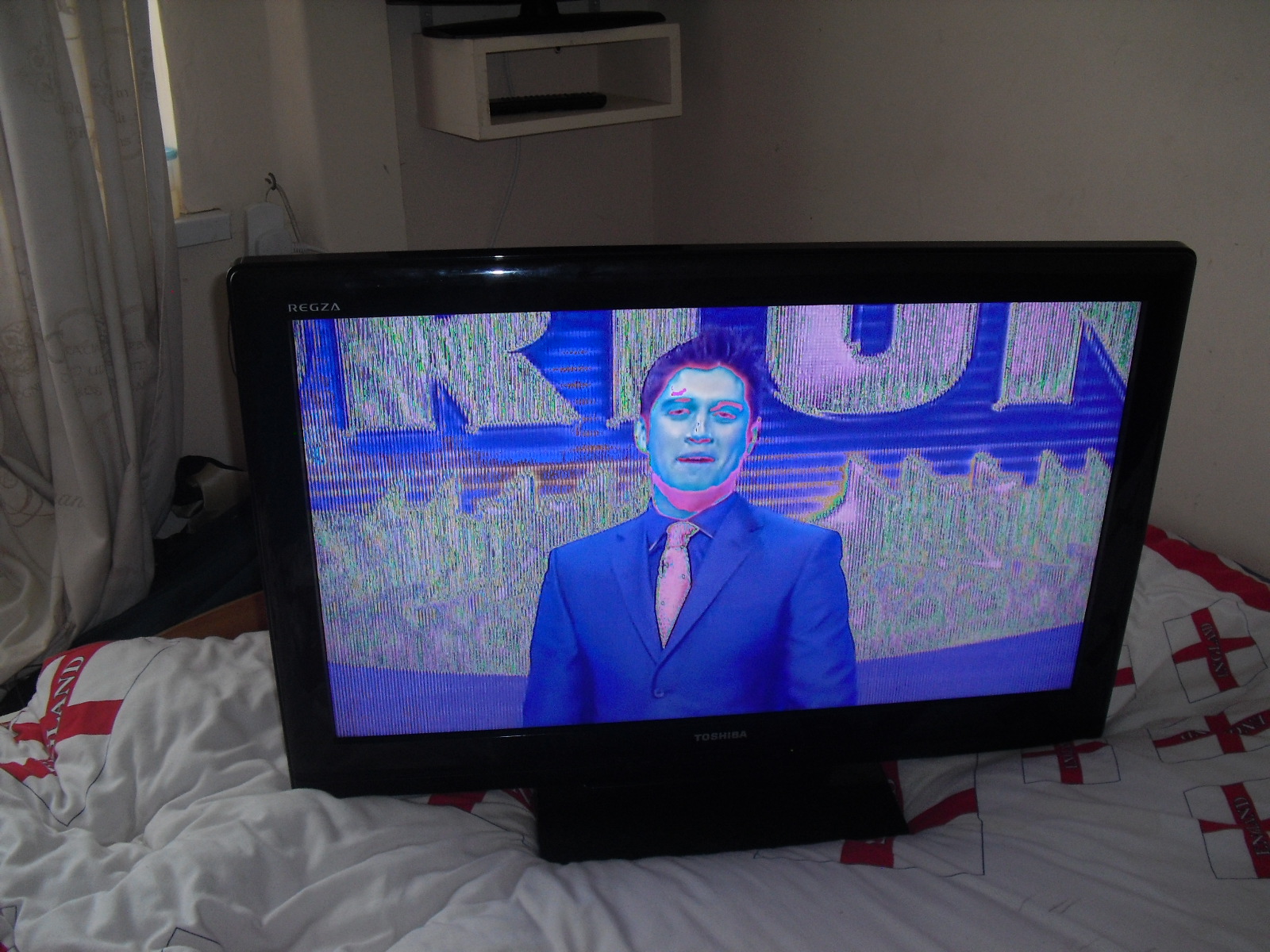

          Got hold of a 37av55d model with smashed screen for 25quid cos the mainboards are the same..fitted board into 32" and the picture comes on but its not right..i can only discribe it like in the film predator the different visions the alien has..theres nowt loose so i dont know what to try..the only way to nearly have a good picture is to turn the contrast to 0 & thats in every mode ie dynamic/movie etc..
            #45
            Re: toshiba regza no picture

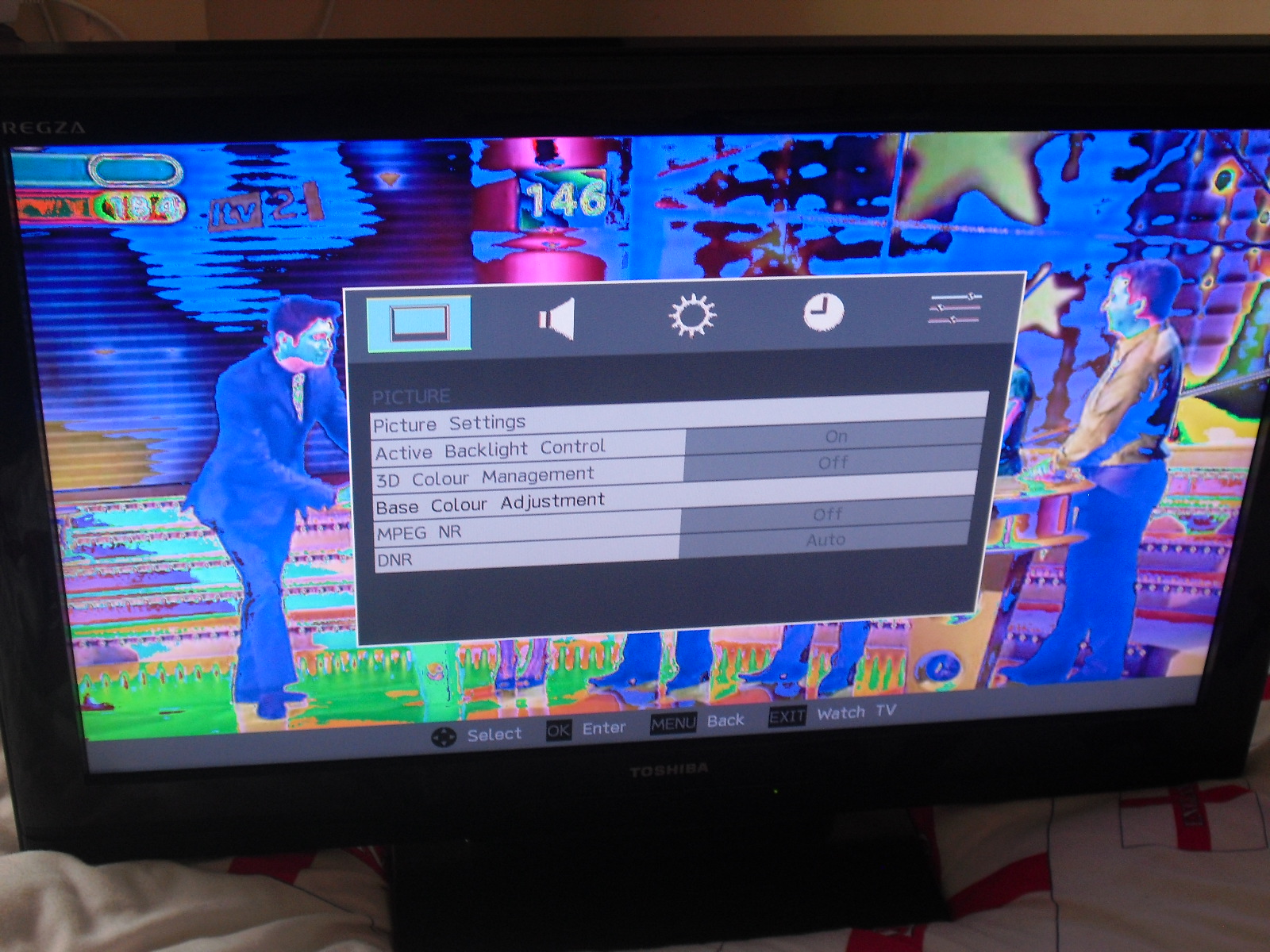

            This is caused by having the panel model # set incorrectly.
            Go into the service menu and adjust the panel settings until the picture restores.

              #46

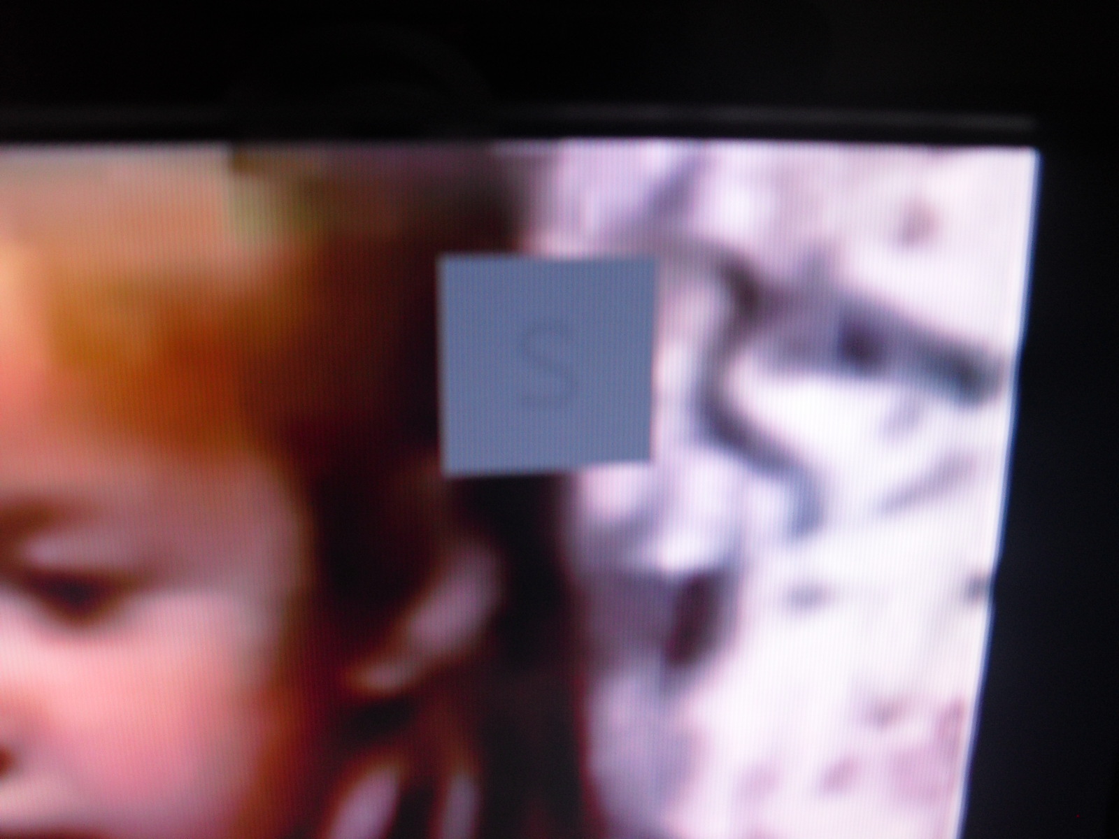

              Tom is the sevice menu a sequence on the remote? if so i dont suppose you know the sequence fella..thx
                #47
                No, I don't know the code.

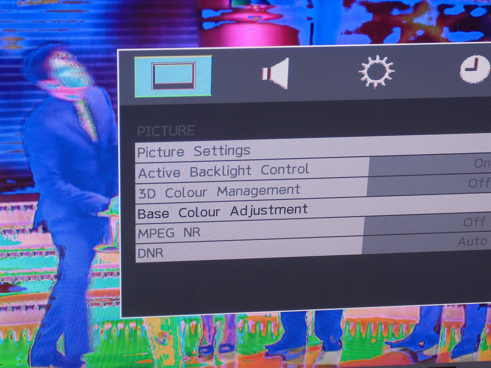

                    #49
                    You're going to have to squint to see the text but it's just about there.
                    Look in the service manual for configuration of panel options. Looks like you have to set variables individually.

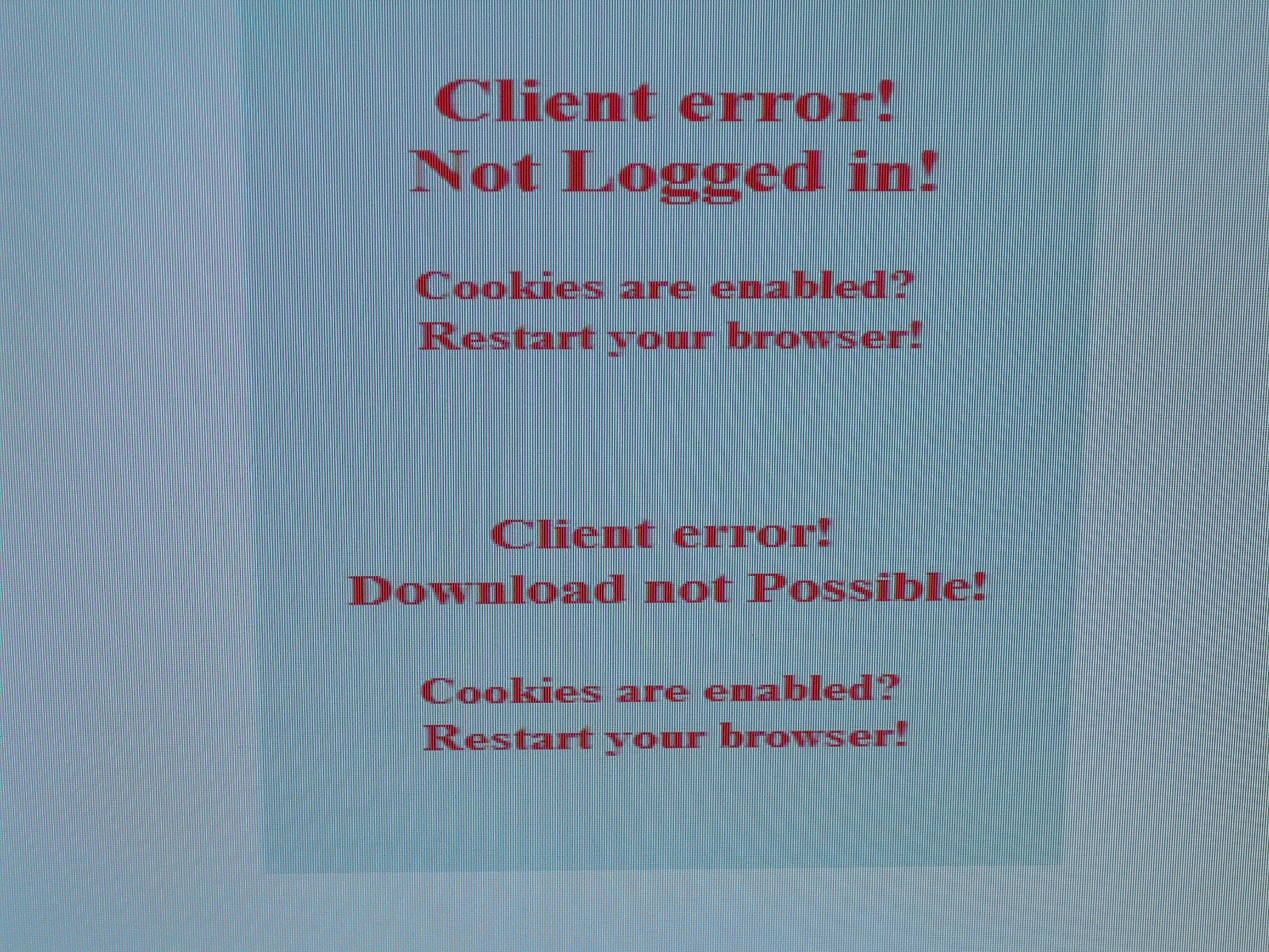

                        Cant get the manual from ET i tried before & keep getting same friggin login error..ive downloaded from ET before with no probs
                        • sienoki
                          sienoki
                          • Jan 2012
                          • 314
                          #52
                          see pic
                            #53
                            see pic
                            Try another browser?

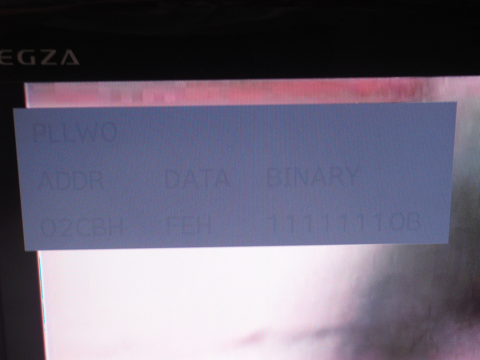

                              i just re read your post you have found the service menu code now but i will still post it may help others
                              Toshiba LCD Service Menu Code 1.Press the {MENU} button on the remote.
                              2.Highlight the "Picture" icon.
                              3.Press the {9} {3} {0} {1} buttons on the remote.
                              {OK} button will access/navigate through modes
                              {VOL +}, {VOL-}, {P+} & {P-} buttons move through options and change values
                              4.To exit, press the {MENU} button.
