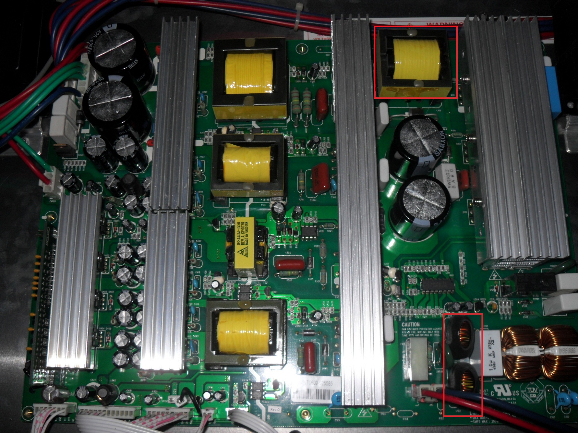

Viore PDP42V18HA Power Supply.
  • Vizor
    • Nov 2011
    • 215
    lg-3501q00156a-power-supplyusp440m42lp

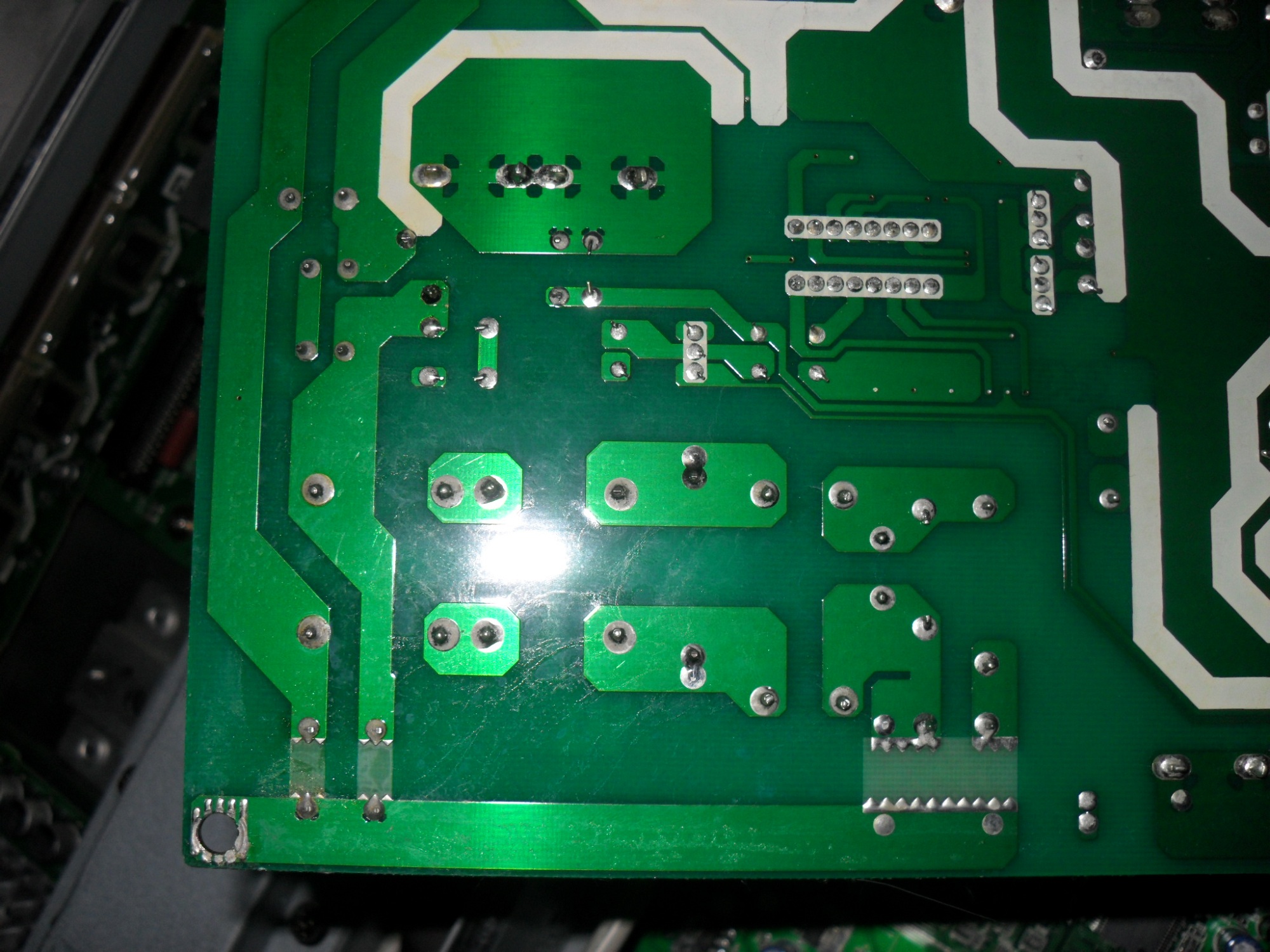

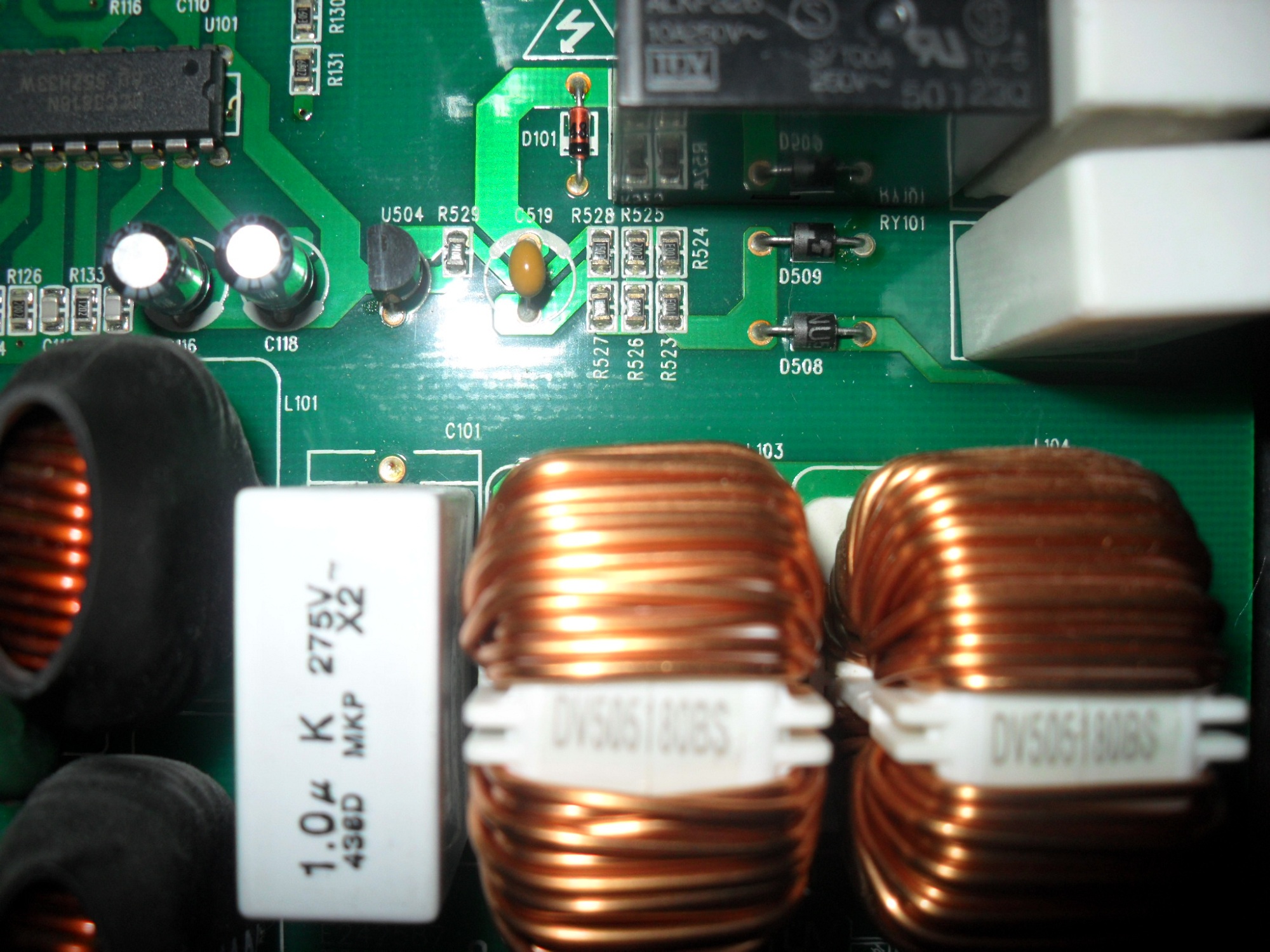

    Hearing like a Chirping Clicking noise, that's really fast and really annoying, its in the area that i have pictures for can't figure out what it is.

            Re: Viore PDP42V18HA Power Supply.

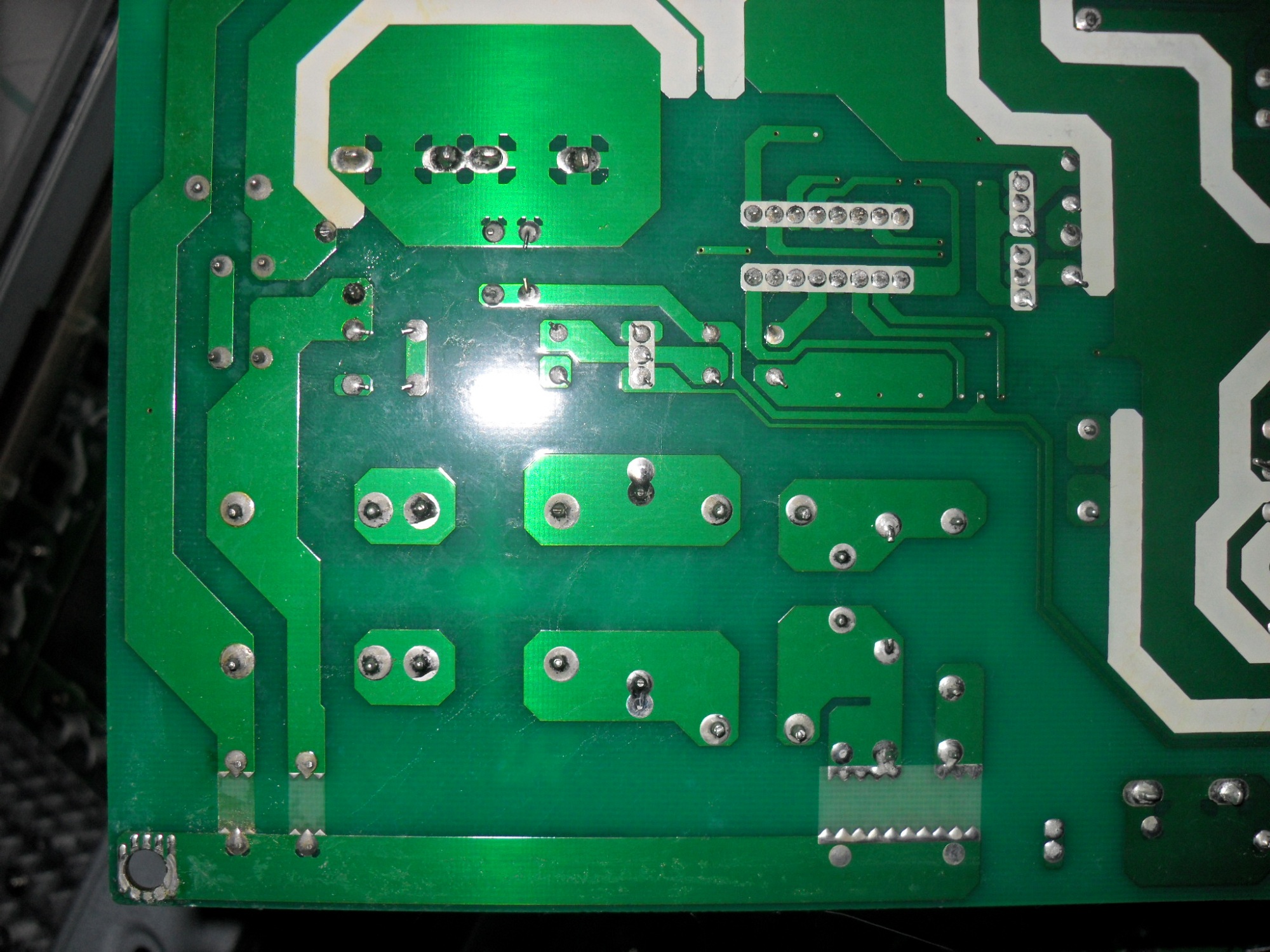

            Try resoldering the large pins in last two pictures.
            Does the set actually work apart from the noise?

              everything works, all but the z sus board is screwed. Colored Dark blue specks etc already know that's bad
              Power supply was making the noise, replaced 2 bad caps didn't make a difference.
                Use some superglue on the chirping component. (Locate it exactly with a cylinder, e.g. made from paper) The windings are vibrating because the old varnish has dried up.
                  Check these transformers for cracks (there may be barely visible cracks). I heard about these kind of problems.
                  For what I heard on your video, these one are causing the sound.

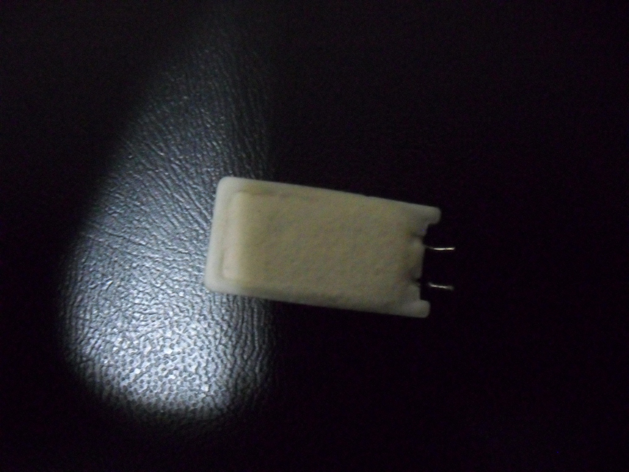

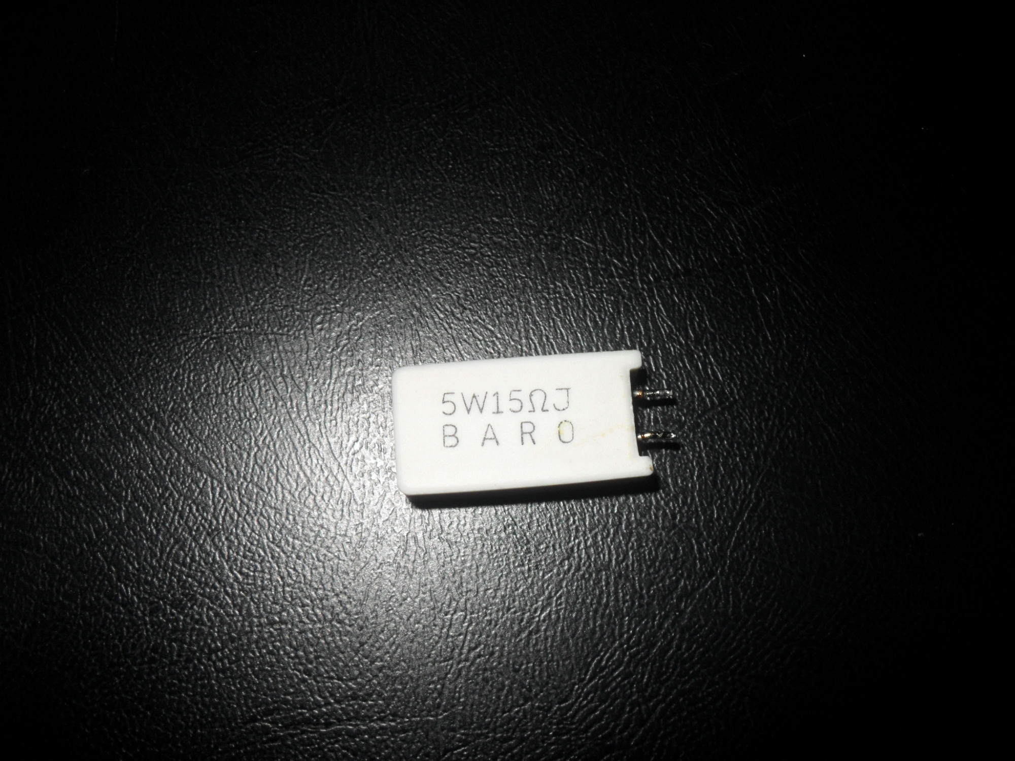

                      Anyways, i was reflowing some solder and i came across 2 of those 5W15 J B A R O their are a few on the board elsewhere that don't look nearly as bad could those be making that noise?
                        Probably not. They are "cement" resistors. A wire is coiled inside to make the required resistance and it is then encased in the ceramic white body - usually this prevents the wire from moving.
                              I don't think a resistor could cause the sound. It's more likely in components like transformers or coil windings because those components produce little vibrations.

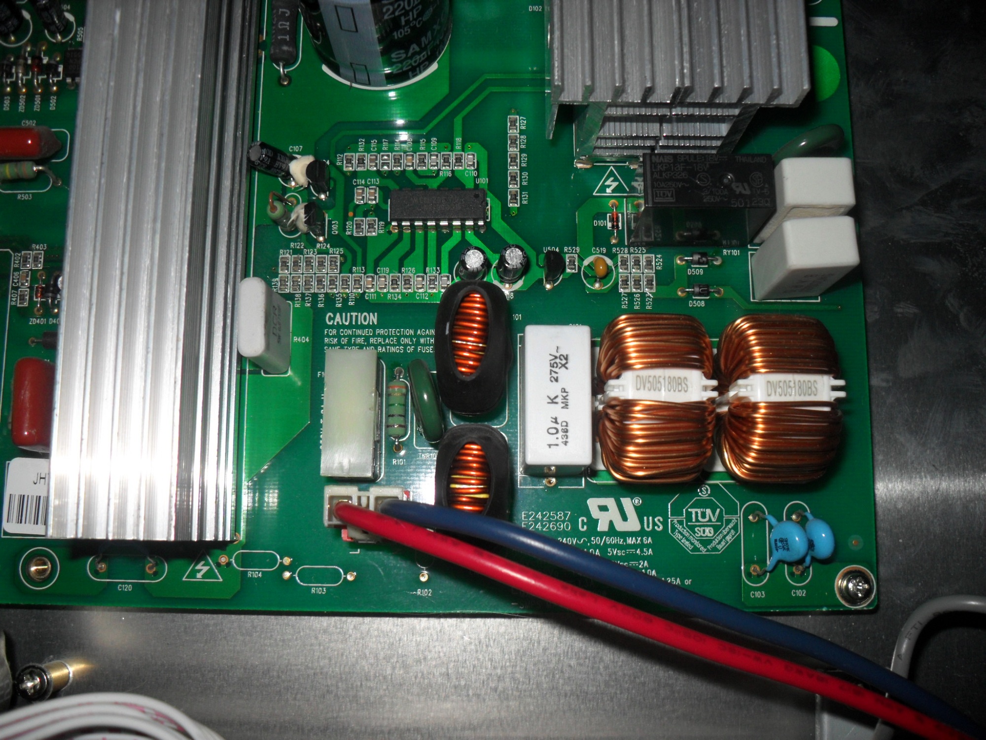

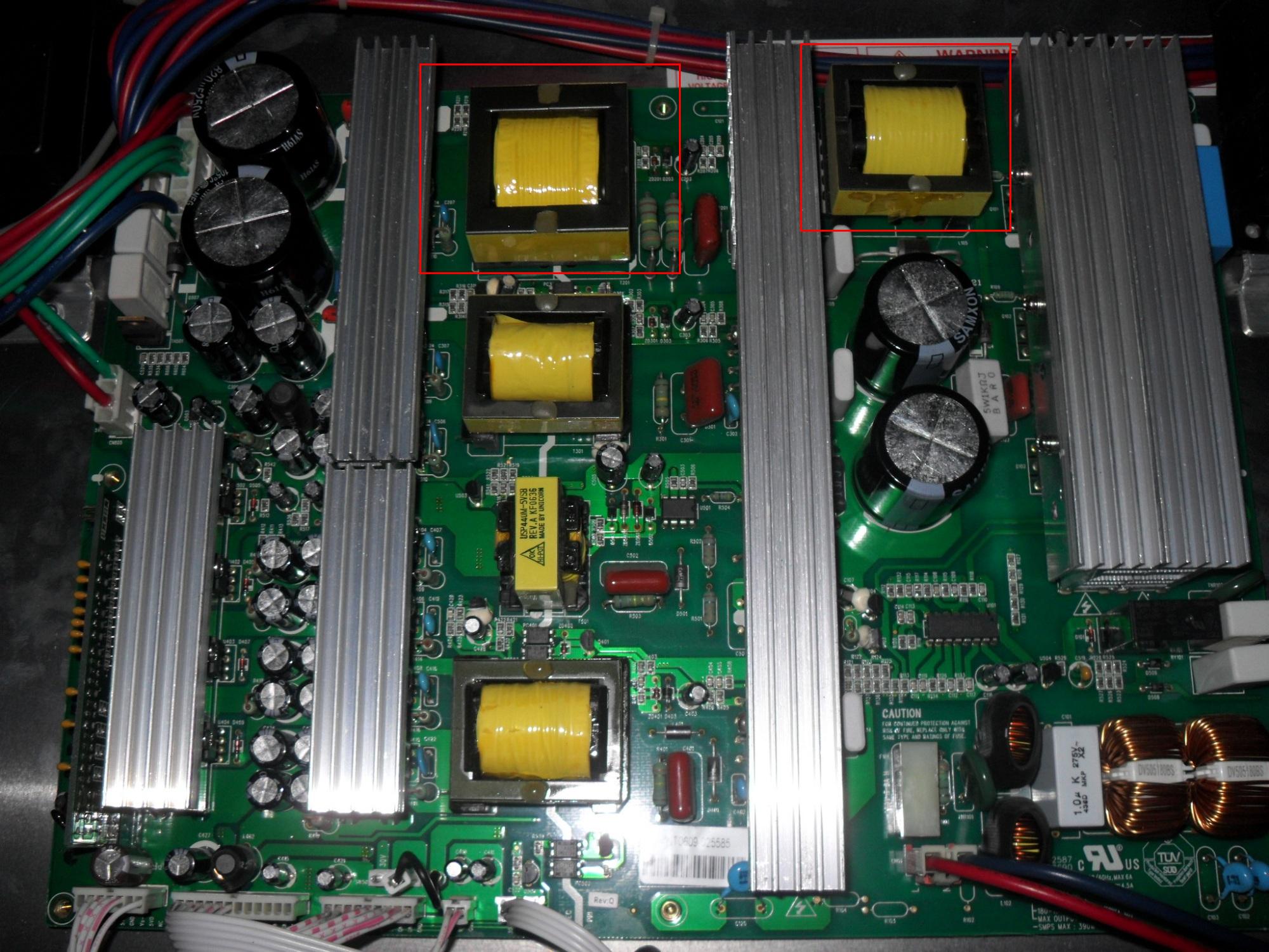

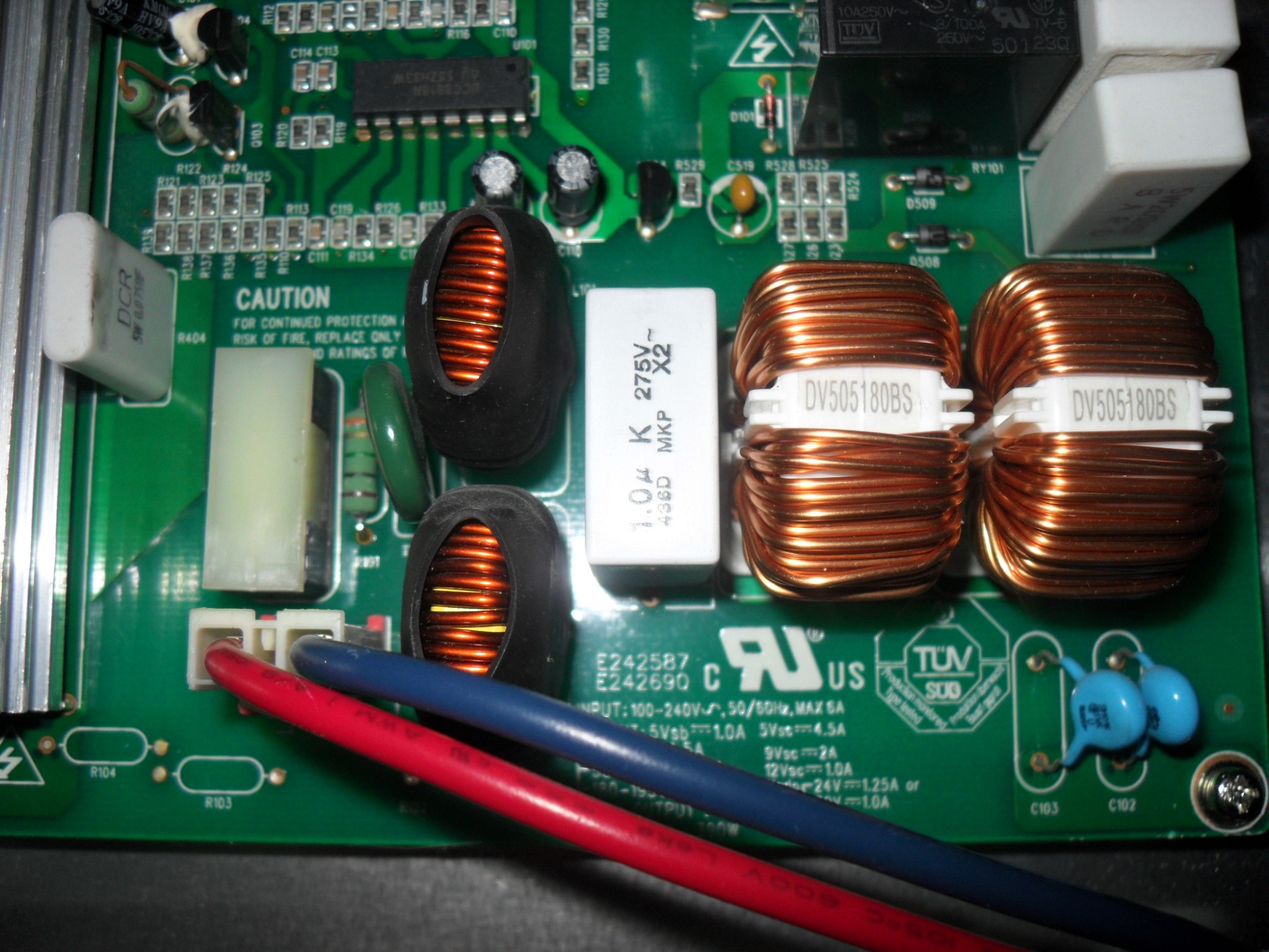

                                using a stethoscope i have pin-pointed the noise coming from the marked areas on the power supply, what does this area power/control?
                                  The yellow one is the PFC inductor. The other items are the mains filters. You can try applying glue to the mains filters to see if it fixes it.
                                    Will the noise actually hurt anything long term?
                                      It shouldn't. The glue is normally present on the inductors, but it dries up over time so it becomes much more audible.
