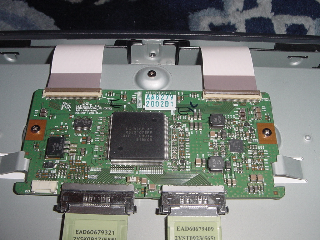

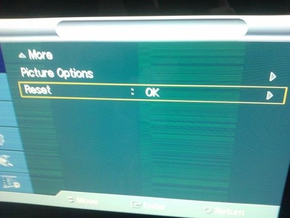

    I am thinking of picking up this TV. It looks like a T-con fault to me. Does anyone know the model # of the T-con used in this TV?

    Is it this one?
    http://flattvparts.co.uk/index.php?m...oducts_id=1497
      Re: Samsung LE40A656A1F - Possible T-con fault?
      Nice find. Looks like the one on eBay auctions. I'll think about picking it up, but I'm on the hunt for an LED set to repair now so I might let it pass.
        I'm going to pick up the TV on Friday (just checked it's a 1080p set so definitely worth picking up), but can anyone confirm or counter my diagnosis of the T-con being at fault?
          I cannot confirm but it is strange that the on screen menu looks normal but the noise bars do not affect the on screen display.
            The noise bars do affect the OSD, and the picture. Here's a video from the owner.
            http://www.youtube.com/watch?v=INPRK...layer_embedded
            Could be a panel issue? Though it looks too regular... Didn't you have a Sony with this problem, or am I imagining things?

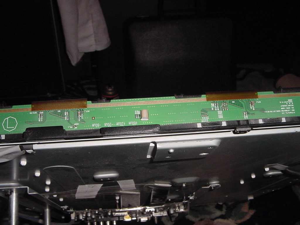

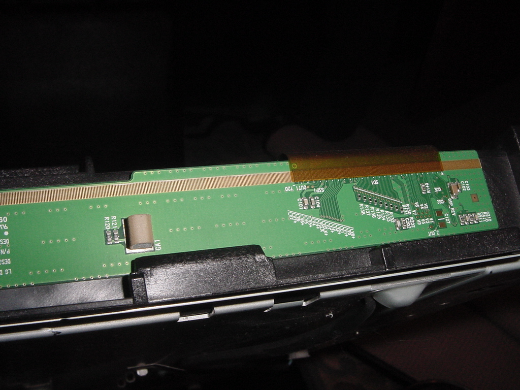

                                In the video, the noise moves, so I'm hoping it's not a bad panel, as the lines would usually be fixed with a bad panel. Still, I think it might be repairable even with bad tab bonds. I'll see when I get it.
                                I swear I've seen this problem before, but I'm not sure where! The Sony looks similar, but it's got blocks of fixed colour instead of noise.

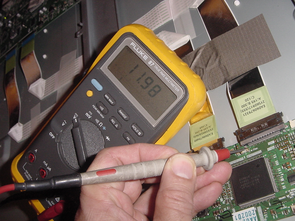

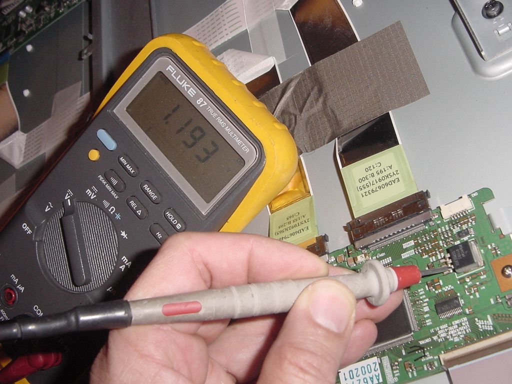

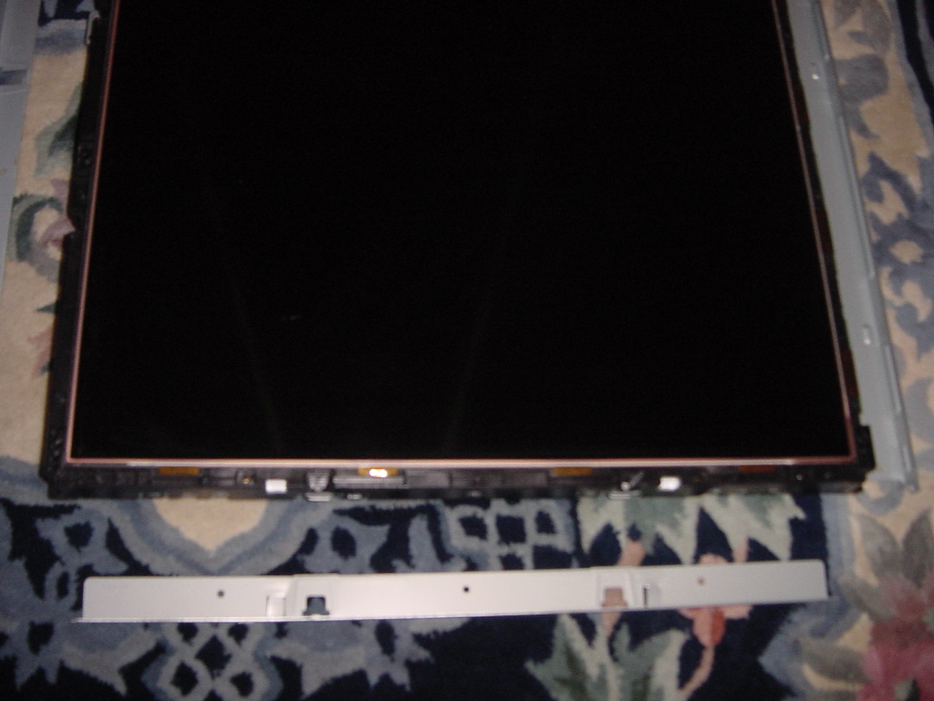

                                    I am working on LG 47LH55 with Horizontal lines and white screen after a minute on top of the pictures, so I did not see bad tab (press on them made no difference) on the panel yet, clean and re-seat the T-CON cable, no luck. There is no active components on the LCD panel board either, check MLC caps for shorts, no luck. I will be ordering new T-CON, TV is only 3 years old.
                                      I had a vaguely similar fault with a Samsung; turned out to be a bad LDO on the T-con, one was supposed to give 2.5V but was only giving 1.3V.
                                        I check the LDO RT9183-12 (1.2V) check OK.
                                        Another thing is that I did not find any Source/Gate drive for the TFT on the panel itself which is why I do not believe it is bad panel to have that many X/Y drivers to go bad on the whole screen.
                                        I need to look up the spec on that large IC on the T-CON to see how it works.
