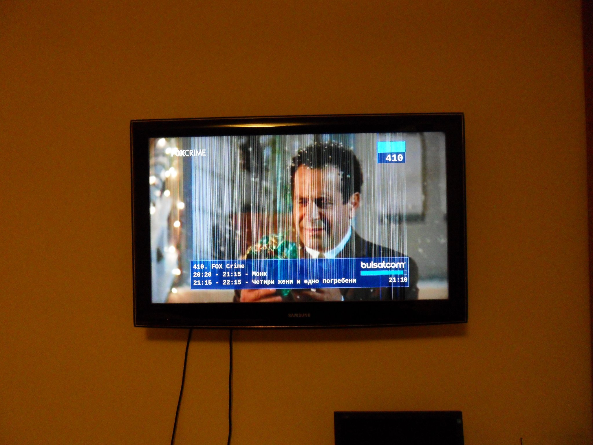

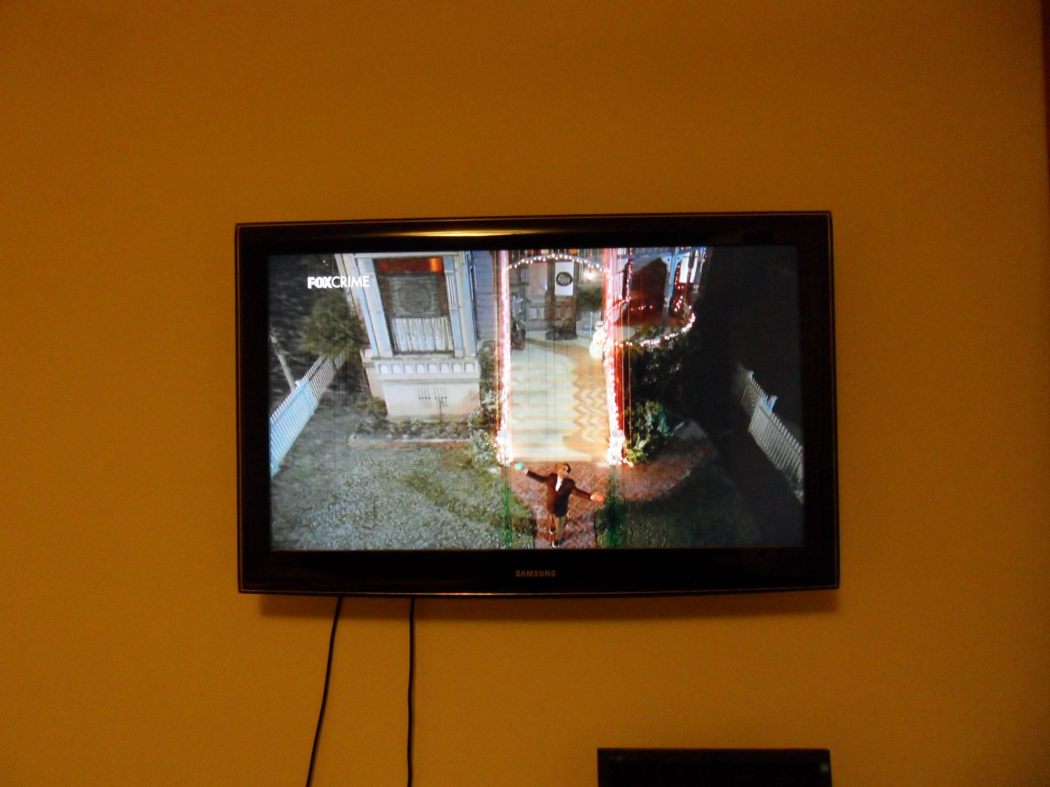

        Hi there,
        My LE40A656 today start to show same vertical lines. They are most visible when there is white letters.
        T-con or LCD panel?

          Re: Samsung LE40A656A1F - Possible T-con fault?
          Raspberry Pi... nice... I'm going to use one of those for each of the smaller TVs... running XBMC.
          Anyway, I'm going to say panel is a very likely possibility, however it could be tab bonds which should be repairable, with care.

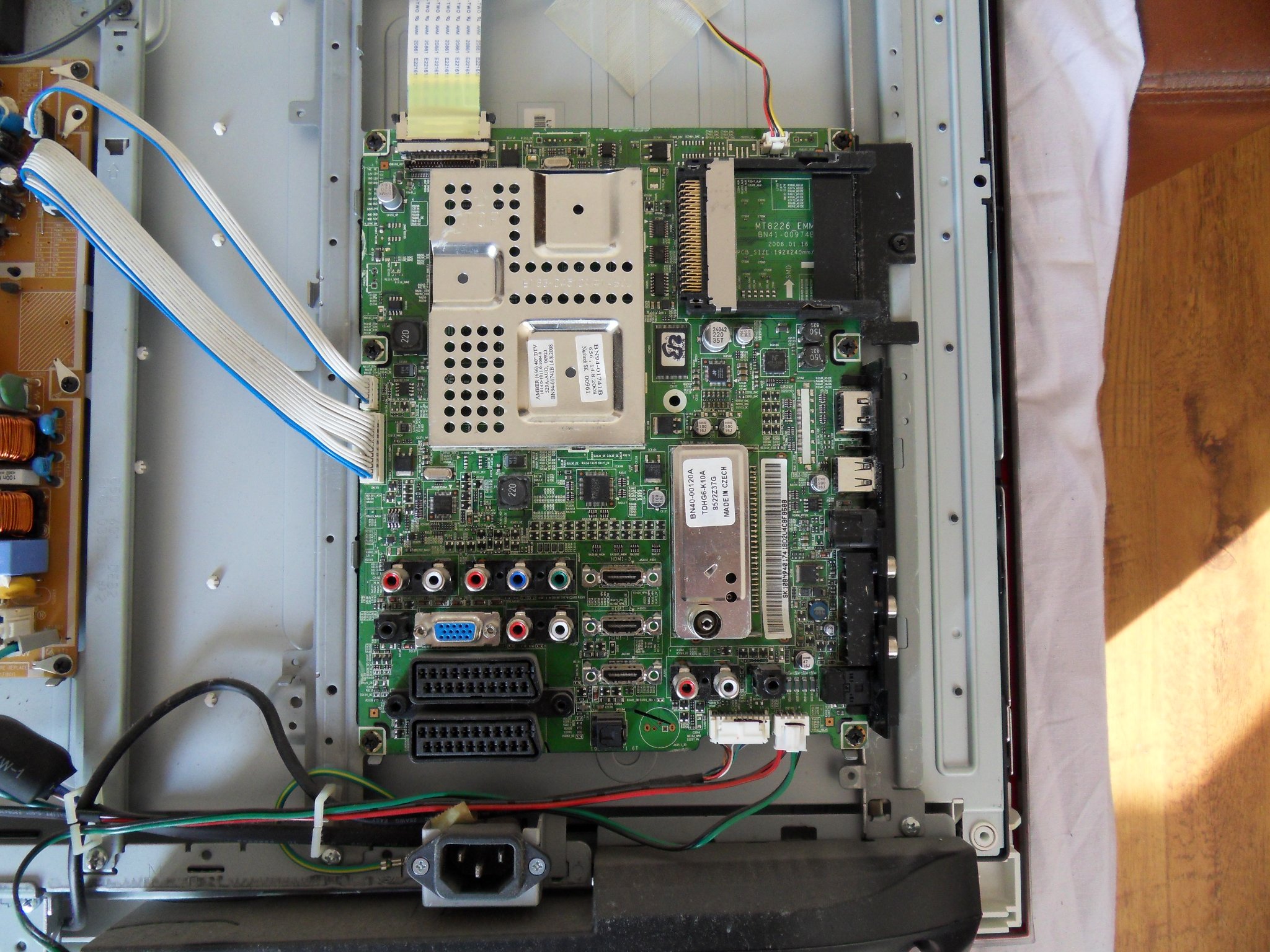

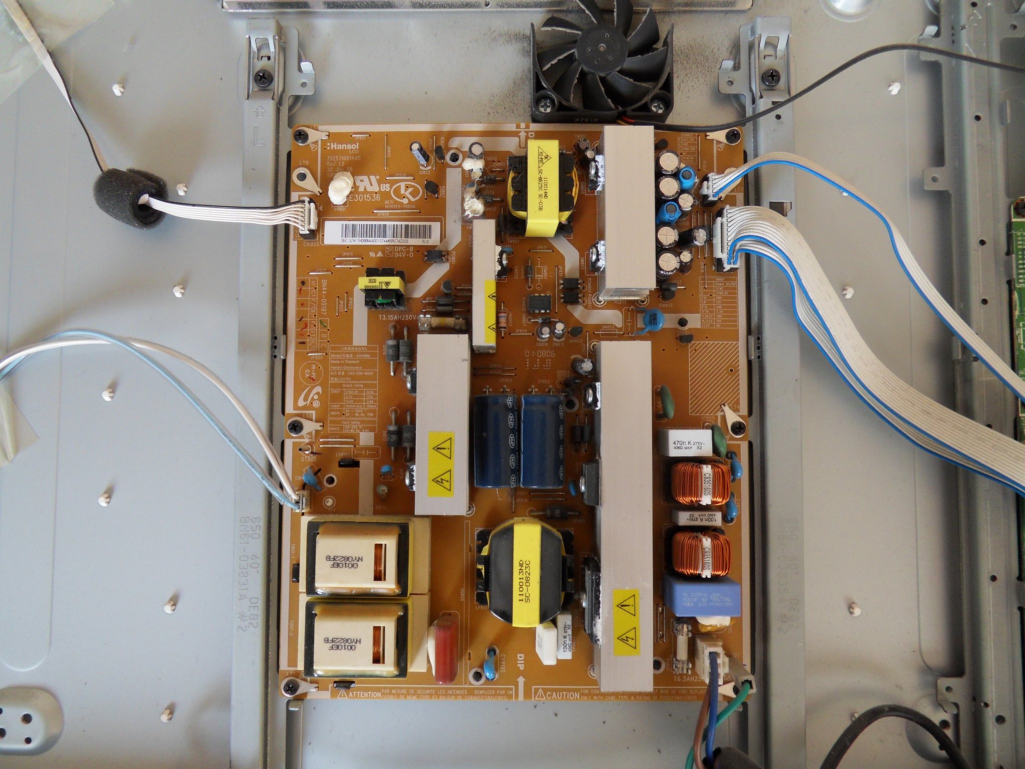

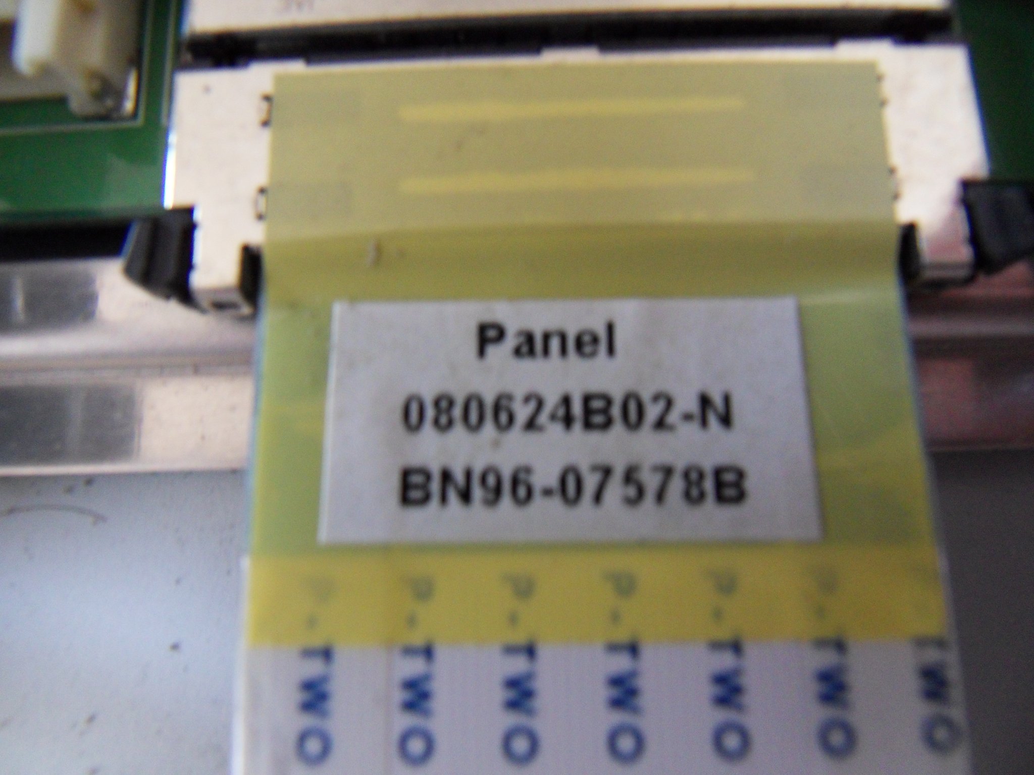

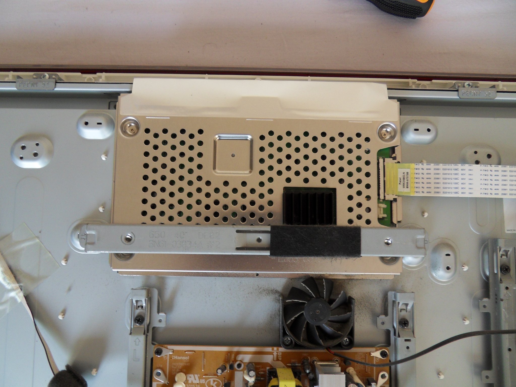

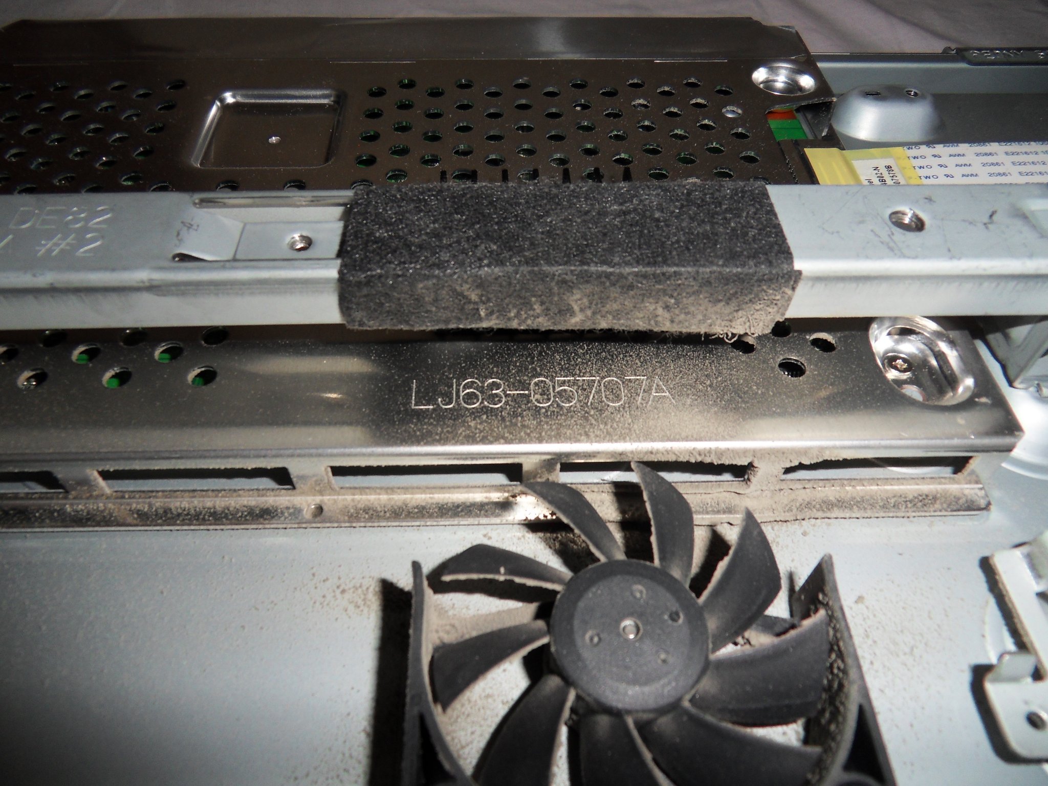

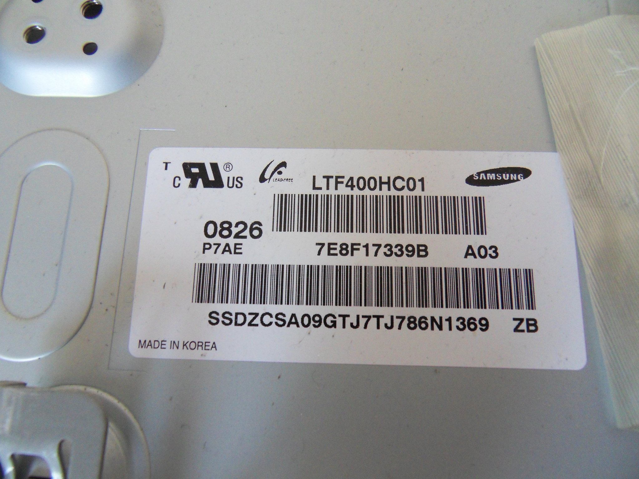

              OK ... just an update.
              I open TV, dissemble metal frame and check every tab bond ... no effect. The picture stay distorted when I apply pressure to bonds.
              I clean and reattach all ribbons - all four from Tcon to panel and Tcon ribbon to motherboard.
              I check caps - looks OK to me.
              So this leave me with faulty panel? Can I exclude Tcon?
              Effect is most visible when there are white objects (letters for example) on dark background. When picture is dark there is almost no effect and picture look pretty good.
              Some pictures from inside:
                #67
                You cannot exclude the T-con. It could be faulty. It produces voltages VGH, VGL, AVDD. Have you tested those?
