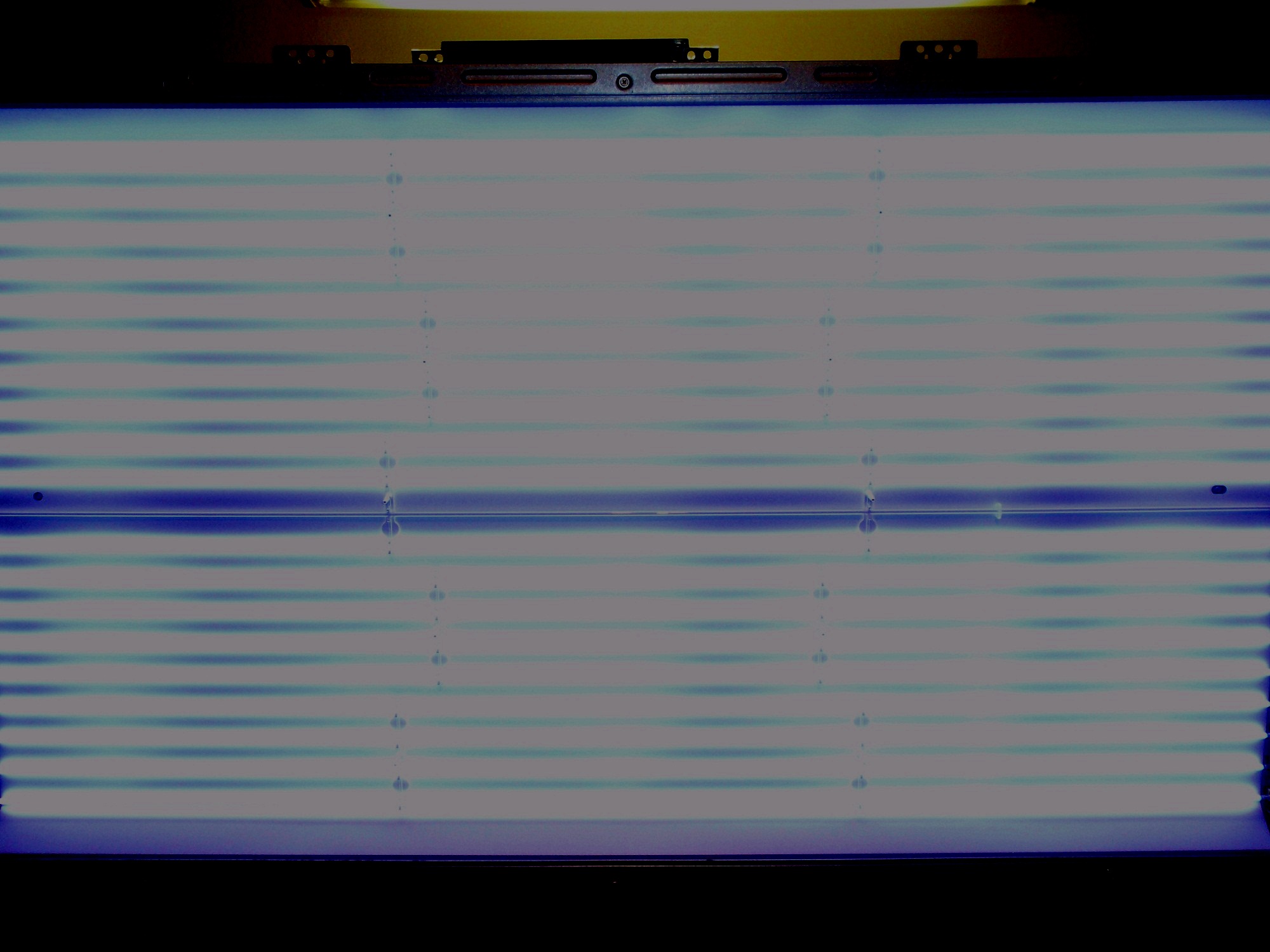

                          I managed to take a picture, which is not easy.
                            Re: Sony KDL40S4100 question
                            Nice shot. Hi speed 300 FPS video mode on some digital cameras seems useful now .
                            What you can also try, if the bulbs can be individually disconnected, is to unplug one bulb at a time until you cannot see a flash.

                                  Im not sure why he recomended you disconect 1 bulb? Because you can clearly tell from the picture which bulb is bad.
                                    Does the bad lamp has blackened end? That is usually wrong with worn out bulb, or it may glow with pinkish color. Also there is no ballast cap for the lamps or it is direct connection to the transformer?
                                    • tibimakai
                                      • Jan 2012
                                      • 3680
                                      The first thing I looked at, the black ends and to my surprise all of them had a very small black end. The bad one doesn't look any different then the others.
                                      At the ends on each lamp there is a small clip, almost as the fluorescent lamp connectors have it is just very small and much tighter fit. Basically you just have to push/pull it in/out the ccfl tube. The ccfl tube flexes a bit, but not much. It's 3MM dia. and 900MM long(40" TV).
                                      I have replaced the bad tube with a good one and the bad spot followed the bad tube, so the bulb is bad for sure.
