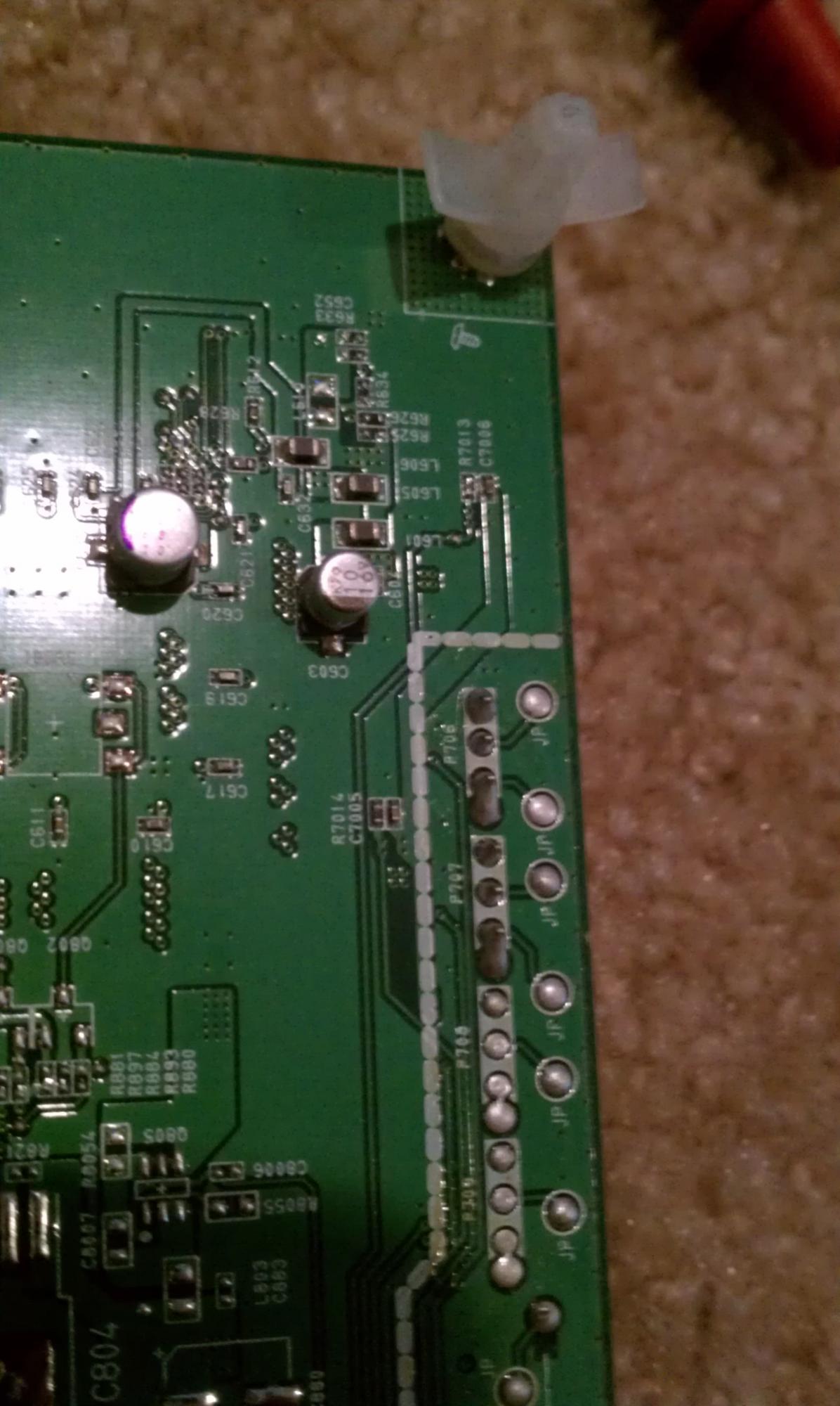

    Bottom VS-ON? Do you mean 5V-ON?

      Re: LG 60PY3DF shuts off
      Just shoot me. 5VON is .47 at idle and 3.57 during boot up. 5VDET is 0 at idle and 4.98 during bootup.

                #87
                5VON is the 5Volt standby. which the Main board receives and sends to the Power Supply to turn on but, it does go through an error checking part of the main board to verify that all is ok and to turn on. If an error is detected. You can use a 1 or 10 omh resistor to short between these points to trick the power supply to turn on bypassing the Safety shutdown circuit. to test for proper voltages.
                The 5V-DET is the PSON or (Power Supply on) voltage source
                If the set turns on properly then there is obviously some voltage drain, short or other problem.
                Do NOT leave the power supply shorted for long because, it may cause additional problems
                Let me know how you make out

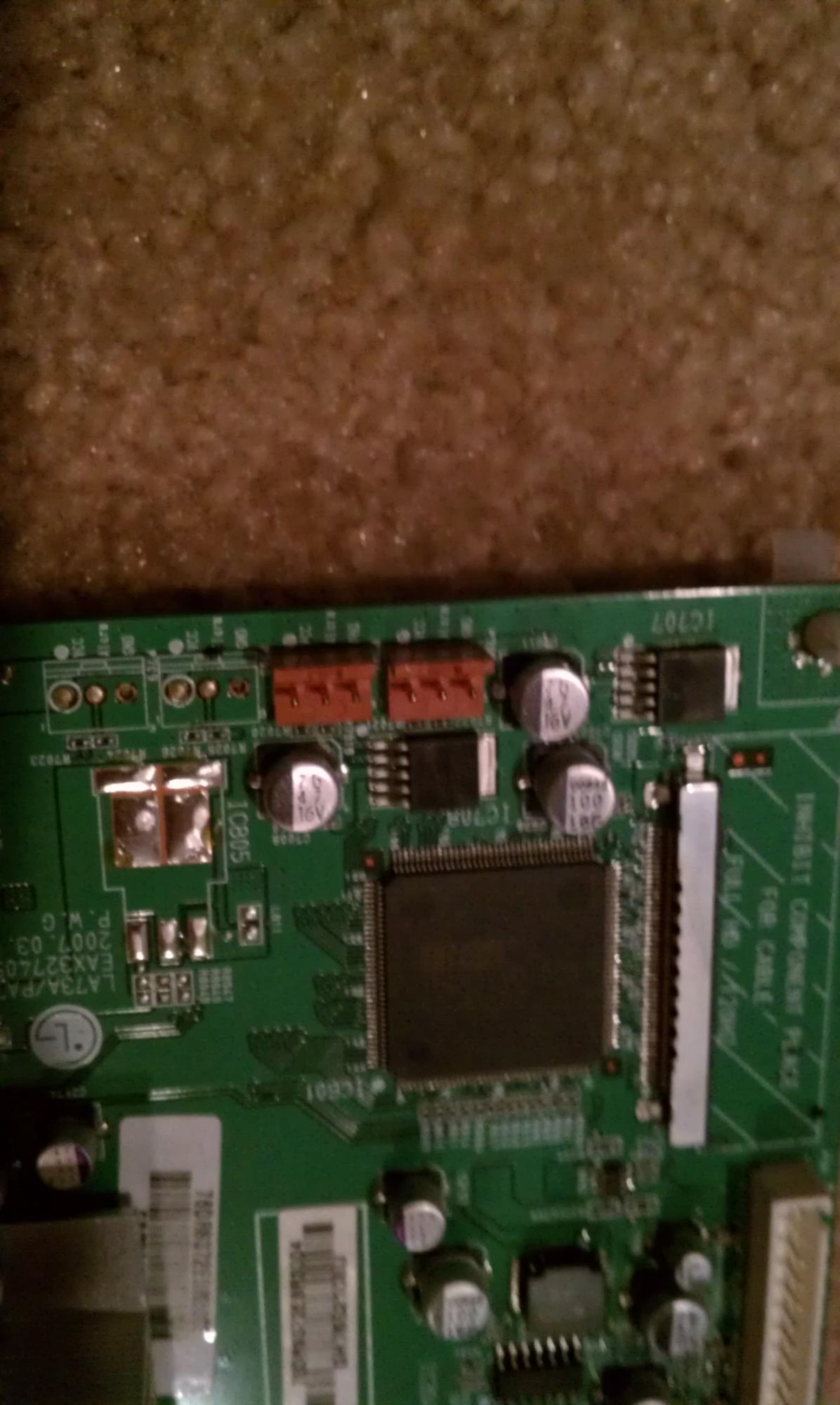

                                  #96
                                  Most set that have cooling fans whether it's 1 fan used or 2 the main board normally controls the turn on and off cycle of the fans.The Main board cpu monitors fan rotation detection via feedback line from the fan connector and if either one of those fans fail to produce either NO or incorrect rotation speed the main board will then send power supply OFF command to power down set.

                                    #97
                                    So replace both fans? Where do I get the correct one's with the proper connections?

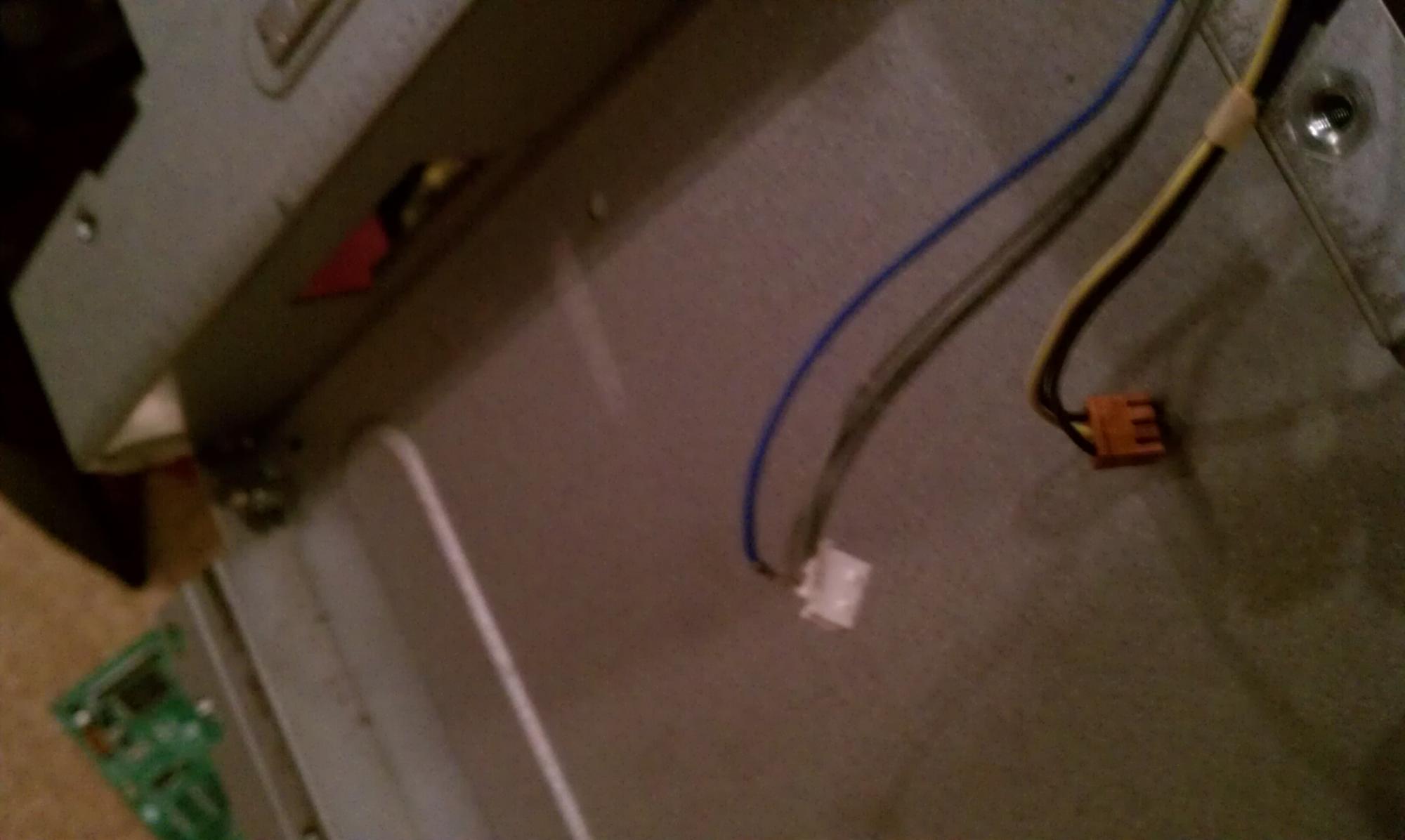

                                      #98
                                      First question, should both fans be on at all times? The right brown connection on the board is the one that will not turn the fan on during startup. But there is power there just like the left connection. The other pic are the back soldering. I'm not sure exactly how it should look. Last pic is one ground wire came out of the connector. What would you suggest on how to fix this. It plugs into top of main board. Thanks.
                                        #99
                                        If you can get a piece of wire - try jumpering from each 12V and ground line to the fan (test with a meter to find out which is which) and see if both fans spin. If they do, the problem may be in some way with the feedback. I must admit ot would be strange if each spin at a different rate or were turned on and off individually.
                                        • brentkhack
                                          • Mar 2012
                                          • 57
                                          • US
                                          #100
                                          I know both fans work but only the one plugged in the left brown connector.
