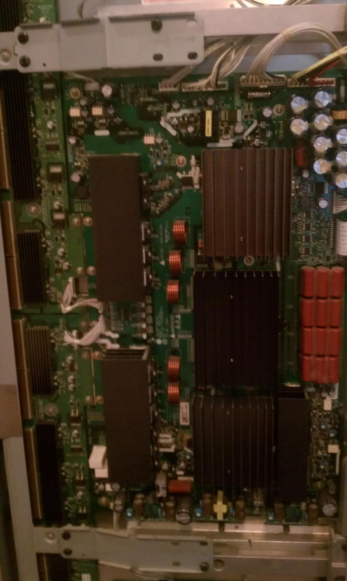

                      Can you post a closer pic of the Y SUSTAIN board? It's on the left hand side of the screen looking from the back. It is the big board that connects to the buffers through the actual plasma panel.
                        Let me know if you need more pics.
                          #32
                          Re: LG 60PY3DF shuts off

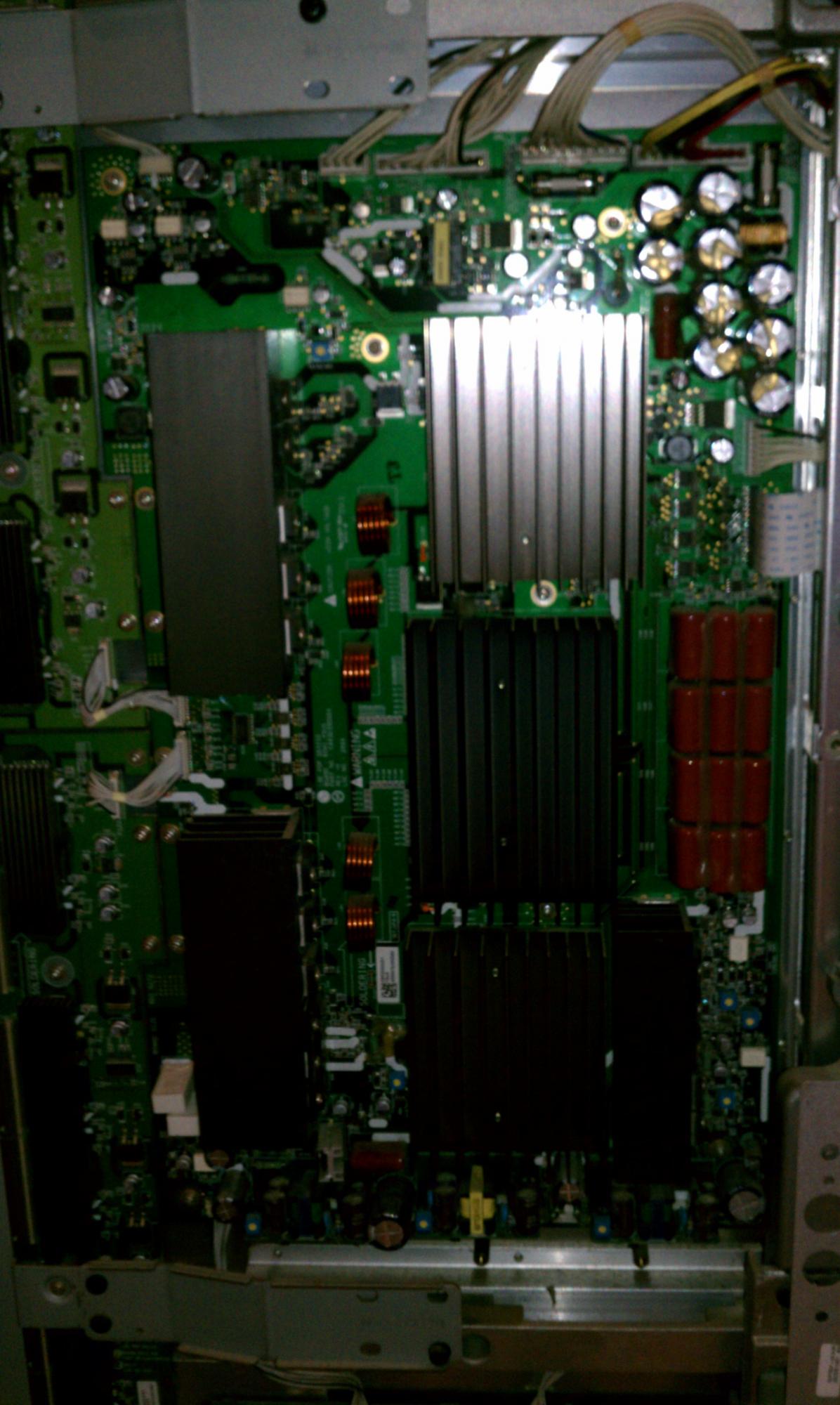

                          Can you take a clearer pic (try some light in the room to focus better) around the connectors?
                            Let's see if these are better.
                              #34

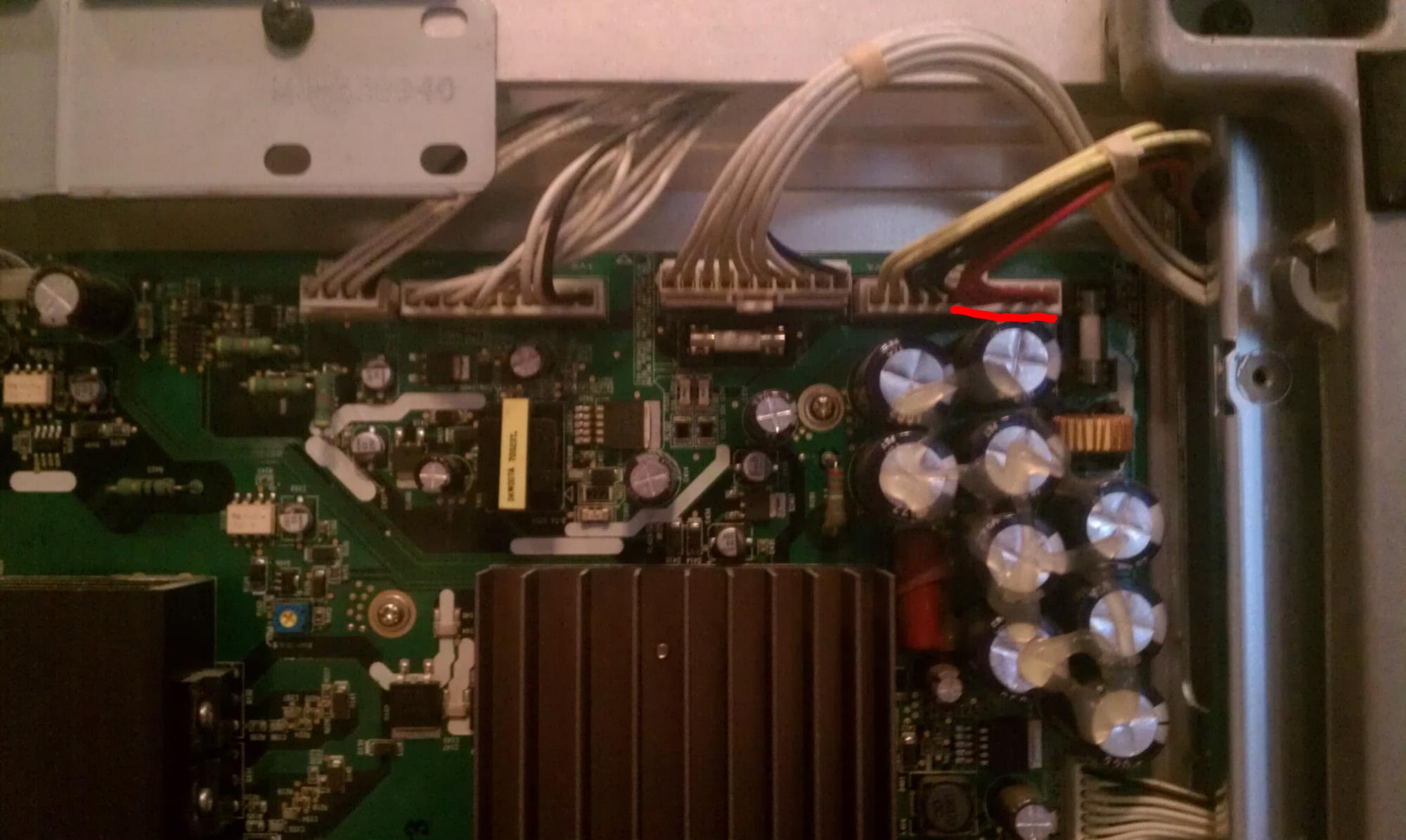

                              Good... Check here.
                              Set meter to 500, 600 or 1000V DC. If you have an autoranging meter, just set it to V DC.
                              Connect the black probe to the chassis of the TV, such as a bare screw hole.
                              Use the red probe to probe one of the pins I've highlighted. Only one is necessary.
                              Record the voltage. It should be around 185V to 195V for LG plasma panels.
                                I have multimeter set to 600 Vdc and when i plugged the main power cord in the multimeter didn't show anything. It was 0.00
                                    I used the black probe to mounting screw hole and the red probe to the very right pin of what you highlighted in red.
                                      #38
                                      Just to make sure, are you probing a red wire? With the unit turned on with a picture (if only briefly?) I eventually fixed my LG 42PC1D. It had a similar issue, although it was worse, in that it would shut down within about half a second, with the plasma panel only briefly flickering. It turned out to be an AC detect fault, which was an easy fix, but it took me ages to find it! (It should have been one of the first things I checked, but I missed it somehow.)
                                      I'm trying to figure out if the Vs voltage is dropping, and the unit is shutting down because of this (I've got a Pioneer plasma which does this), or if the AC detect or some fault detect mechanism is interfering.
                                        Sorry what I checked was the pin on the board which showed 0. I just checked the red wire on the connector itself and it showed 189.
                                          #40
                                          Seems good... Does it stay the same when it shuts off?
