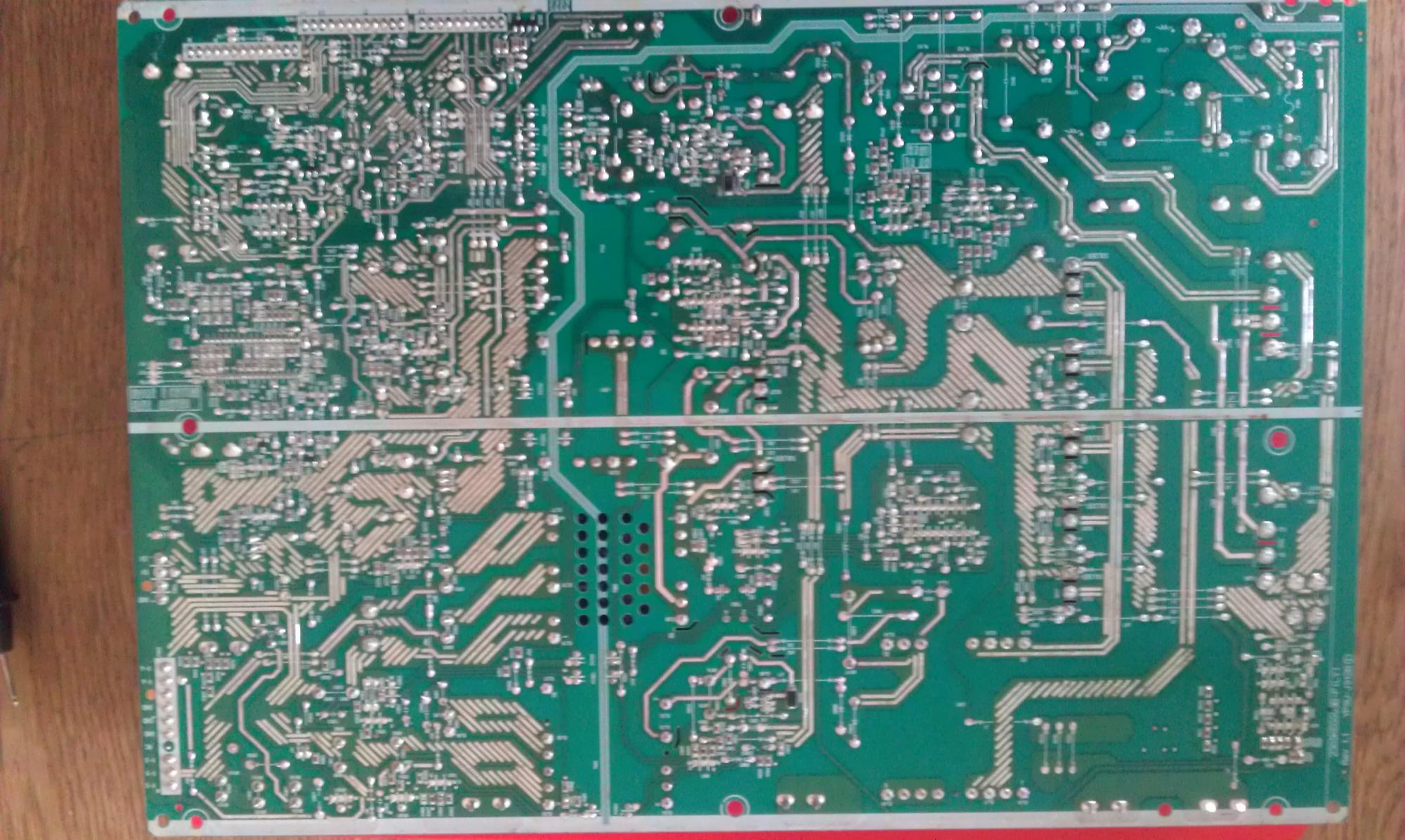

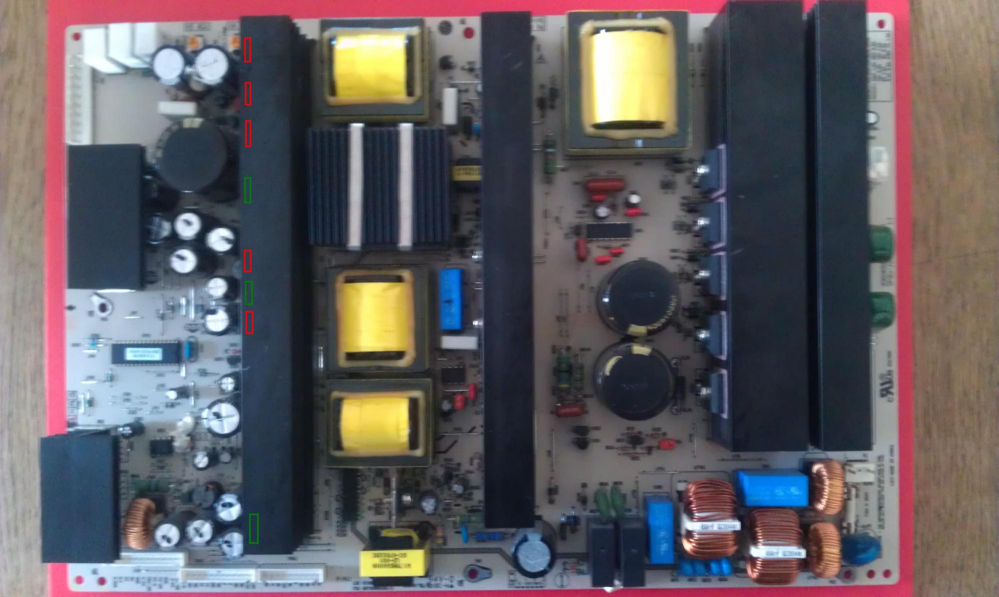

    Sorry, miscommunication - the whole of the back of the PSU. Everything.

      Re: 50PC1d power board
      PSU front
      PSU rear
        By the biggest capacitor on the board with the black cap (not the two next to each other), is there anything on the heatsink? If so, with the power off and board removed from the TV, check all the pins of the devices mounted on this heatsink using your meter on diode test. Try all combinations, note the pins down. There should only be two devices. If it makes it easier, post a closer up picture of the bottom side of this area so I can highlight things to test.

          There is two heatsinks beside that cap, I take it you are looking at the long one, it has 2 pin (red) mosfets? and 3 pin (green). Looks like there is some smudge of heat contact paste there too.
            Yep, that's the one. Check all the devices there. I suspect one is shorted.

              So far I have checked the 2 pins, There are 5 on the heatsink, 4 give the same reading on diode test one way they climb to 3.2 before OL and reversed 0.3. The one that shows the difference reads 0.3 and 0.5 the other way.
              I'll take a look at the 3pins now.
              Nice one buddy.

                two of the 3 pins seem to be doing the same readings, and the other 1 has completey differrent reading but it is a different part number. If I knew what exactly what to look of on the multi meter it would be great help.

                  On diode test, a diode should show from 150 to 700, or 0.150 to 0.700.
                  If the diode shows <30 in any direction, or the same readings in both directions for any pair of pins, it is probably bad.

                    I have the heatsink out with the diodes attached,
                    5x 2pins All show reading one way and .OL the other
                    1...0.409
                    2...0.383
                    3...0.383
                    4...0.372
                    5...0.372
                    3x 3pins
                    2 of which are the same part number (B0669 F30SC6)
                    Black probe on the centre pin, and red on either end pin show the same value.
                    0.124, 0.122 on one and the same test on the other 0.121, 0.121.
                    .OL on any other test.
                    the last 3 pin (BH06 FQPF 27P06) reads 0.528 red probe center and black on the right, all other ways .OL
                    Hope that makes sence??

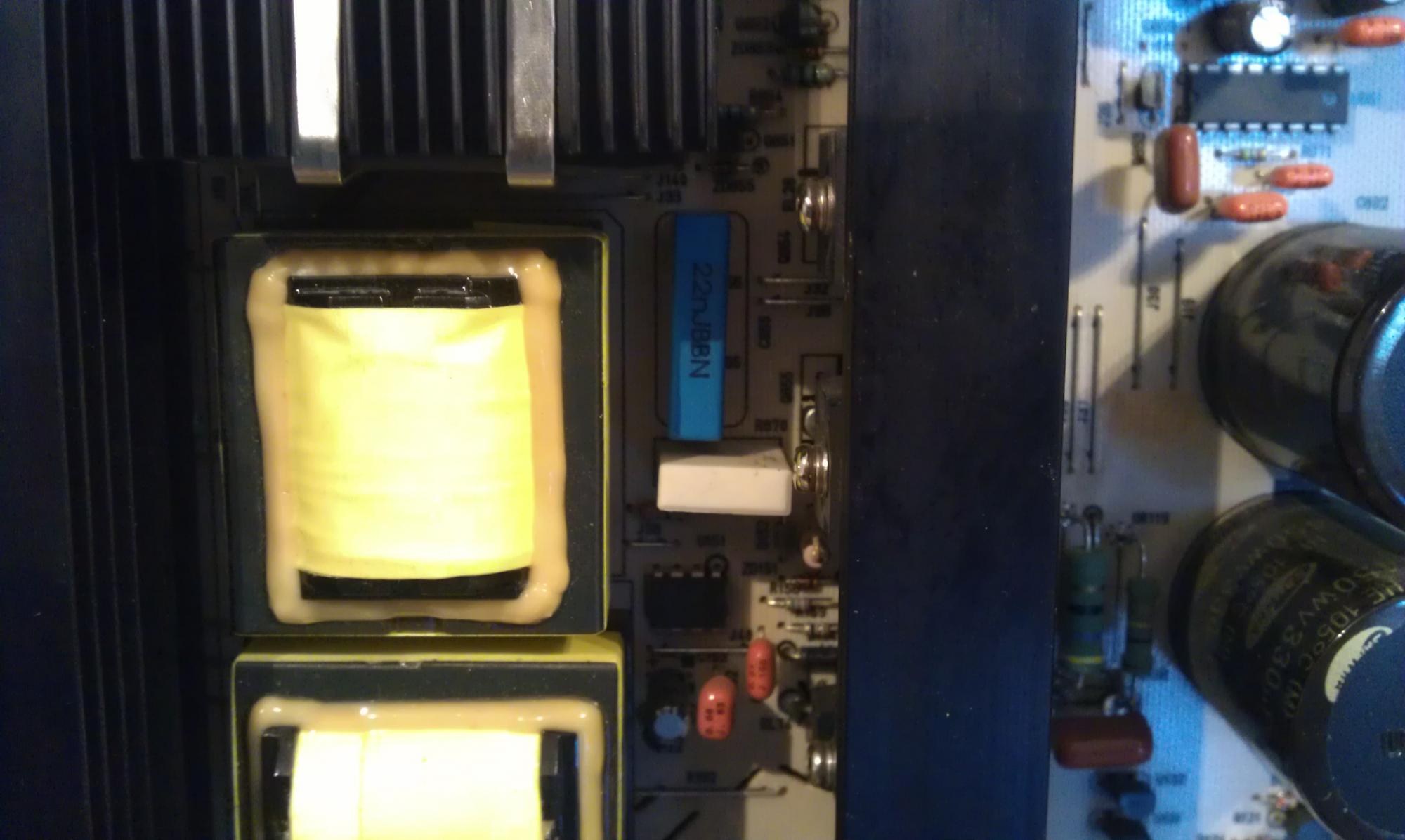

                      #20 replace with same type 22n cap
                      then retest
                        then retest
                        I'll check that out, cheers. Do the values of the diodes on my last post seem OK or do I need to change any of them??
                          #32
                          The diodes seem okay. You are looking for <0.03.
                          Next resolder the diodes. Are there any small capacitors on the primary side of PSU?

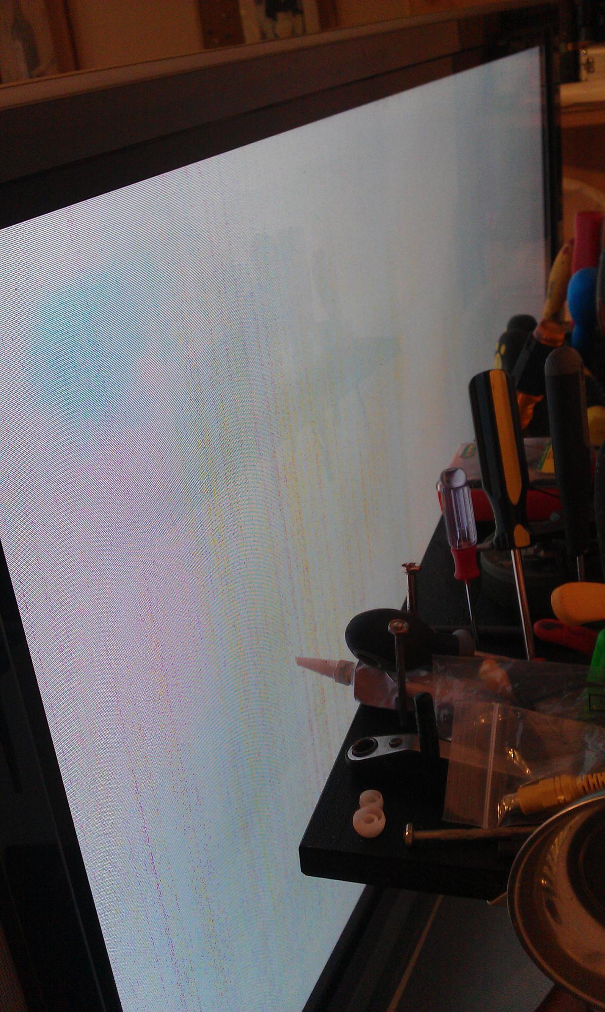

                            I replaced the blue 22u cap now I have 189v and 60v outputs from the board!!! deadly.
                            So now I have the screen on but its very fuzzy random pixels, is it a matter of tuning the set up now??

                              #34
                              So this is where I am now. Thanks for all the help!!! Any more info on what else now needs doing?

                                #35
                                whats the picture like when you have the on screen menu on? is it worth trying a factory reset in the sevice menu?
                                To get to the service menu hold down the 'Menu' button on the TV and the remote control at the same time for about 3-5 seconds. The menu will then appear
                                  #36
                                  It looks like a failed buffer (or buffers), but I'm not sure. Check the control cable from buffers to Y-sustain is properly seated, as well as the main connector.

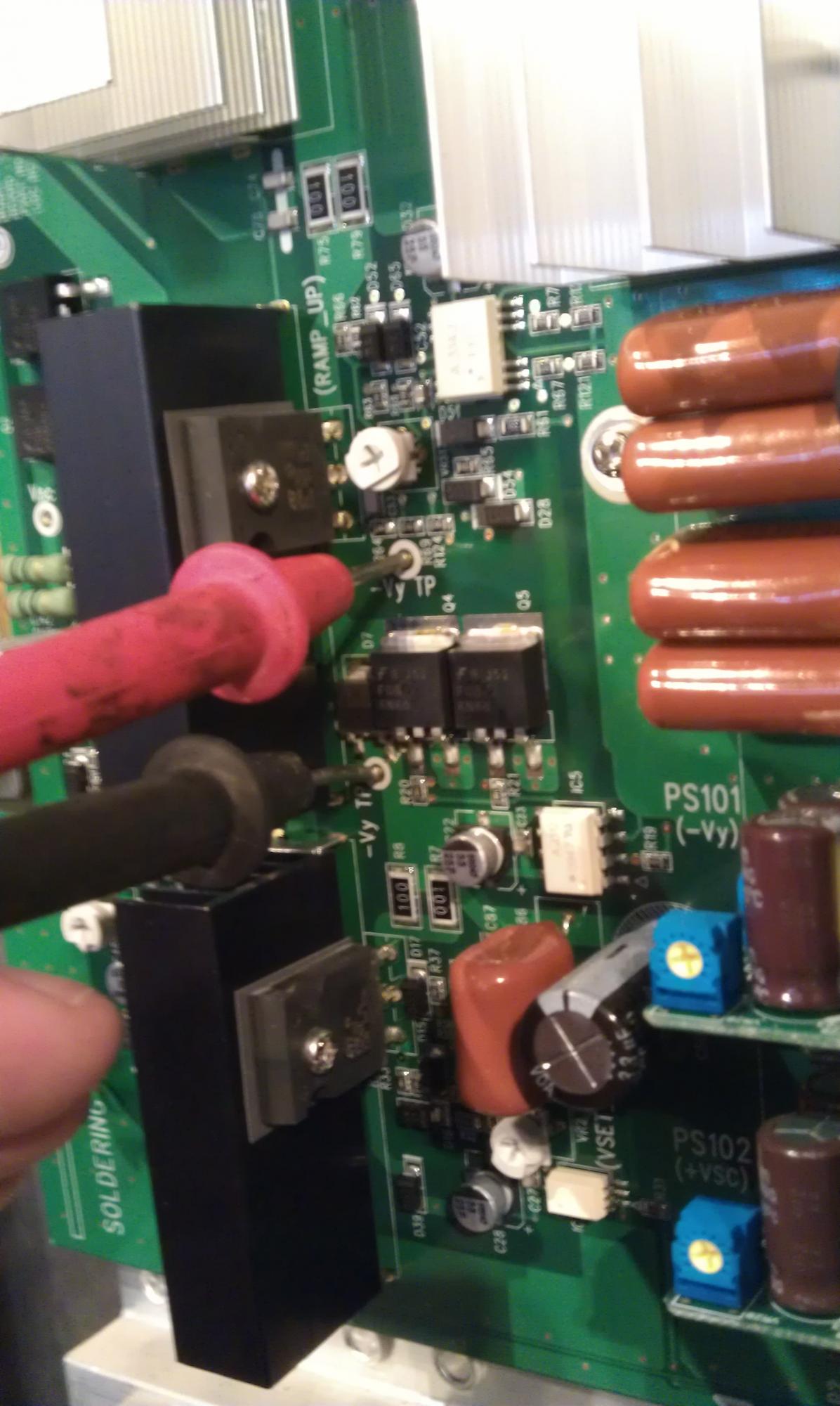

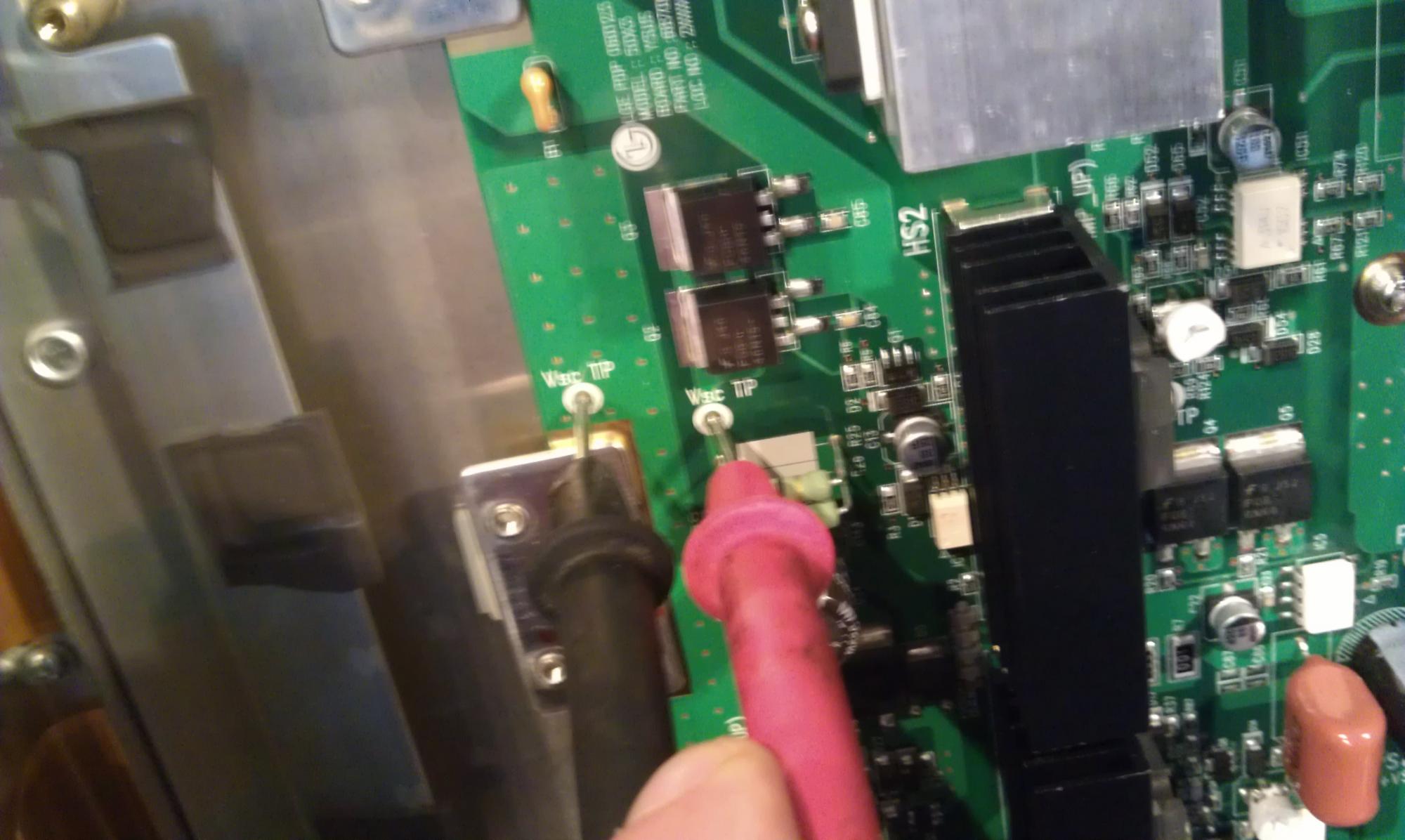

                                    Vinceroger69, got the service menu up but could only see a fat white line from top to bottom on the lefthand side.
                                    Tomm66, I was looking at voltages on the y board out, VSC check point was pulsing 1.0 to O.L. After the buffers disconnected it was 120v as it should. The -VY check point which is meant to be -200v is reading 200, unless I switch around the probes. Also there should be a readingof 18v from the IPM and I am getting 16.2. Is there a way to check the buffer boards?

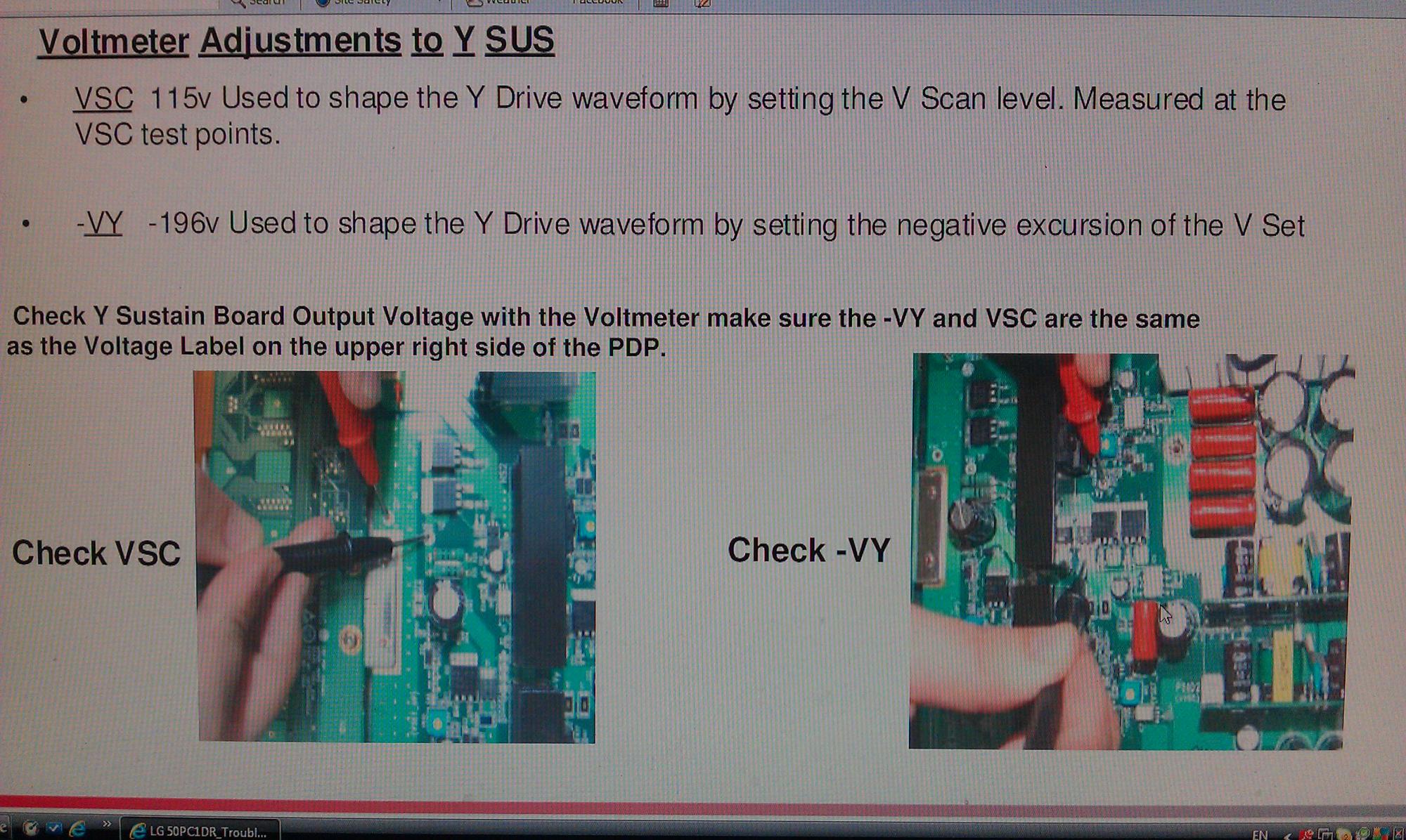

                                      Troubleshooting guide
                                      120 here when the buffers are disconnected
                                      Can only read -200 if the probes are reversed on the check points
                                        #39
                                        -Vy is normally negative, that's good.
                                        The lack of Vsc suggests a failed buffer. Remove the buffer boards, then set your meter to the 2000 ohm or 2k ohm range. Check between each of the large contact pads and report the resistance. If this TV has separate buffers, try with one and then the other to see if you can get half a picture back, although that doesn't always work.
                                        • caspermccormack
                                          • Mar 2012
                                          • 112
                                          • Ireland
                                          #40
                                          Top buffer is showing O.L in either direction, and the bottom one is shown 29.7 and 30.0 the other on my multimeter.
