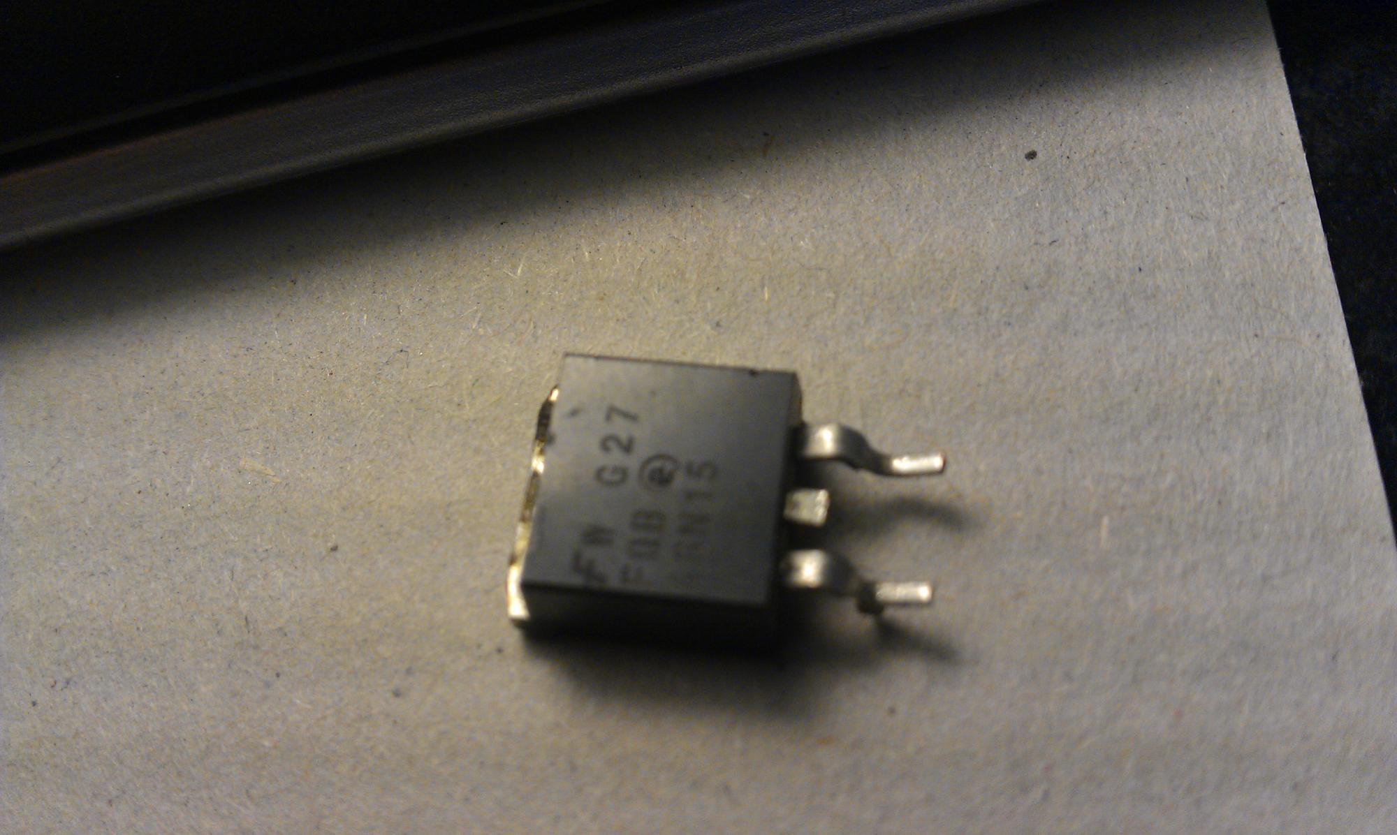

          #44
          Re: 50PC1d power board
          Now that I have the 6 fets off the boards and I know one is shot may be the other 5 are weak. But heres the trouble, on the top buffer there is 3 mosfets (fairchild) G27 FQB46N15. The bottom buffer has 3 (fairchild) G26 FQB46N15.
          So whats the difference with G26 and G27? same part number?
          Called into my local Radionics and the nears they have is:
          http://radionics.rs-online.com/web/p...633D4E4F4E4526
          At that price I'd replace all 6, thats if they will work, any advice would be a great help.
          cheers.
            #45
            cheers.
            Probably same part - different production lot code. Boards were made at a different time with slightly different parts. Wouldn't worry about it.
            That MOSFET isn't SMD, the buffer FETs probably are. I think you need TO-263/D2PAK MOSFETs.
            You will have a hard time replacing it without a hot air station too, but it may be possible with chip-quik. Never used that myself, though...

              #46
              These are the ones from the board.
                #47
                [ATTACH]38278[/ATTACH]
                Glad you were able to remove them; was it difficult? Here are some replacements on digikey: http://search.digikey.com/us/en/prod...PCT-ND/2441058
                A bit more expensive, but you should only need one, as I suspect only one is shorted.

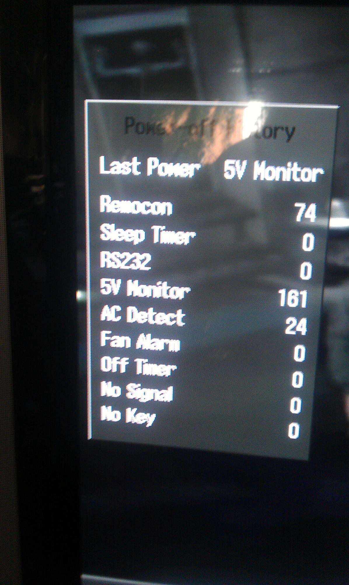

                                #55
                                What do i look out for to check its ok?
                                  #56
                                  Check the voltage at ACD.
                                  I have had the loud pop come from an LG 42PC1D when the PSU suddenly shuts down. It comes from the speakers.
                                  • caspermccormack
                                    • Mar 2012
                                    • 112
                                    • Ireland
                                    #57
                                    I'll take a look at the ac detect in the morning, Yeah loud pop from the speakers as it goes into standby. I am hoping i'm not to far from getting this tv back to working 100%. I have changed out the hybrid on the 42" and so far so good, not that bad to change it if you take your time.
                                    Cheers Tom.
                                    Casper.
                                    • caspermccormack
                                      • Mar 2012
                                      • 112
                                      • Ireland
                                      #58

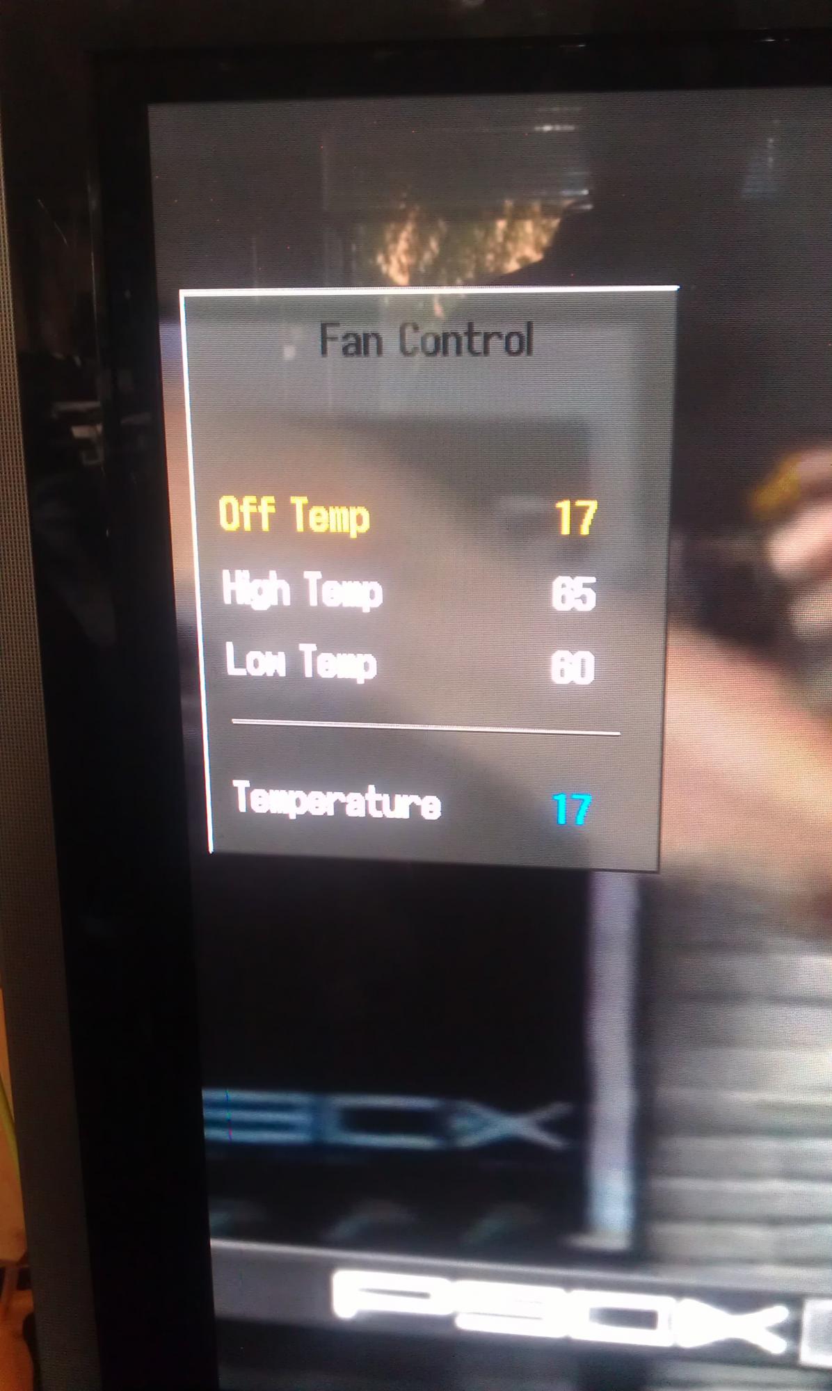

                                      The Tv has being on all morning and afternoon and no faults???? Think I'll stick the back on and put it back on the wall, hope the f--k it's ok.
                                        #59
                                        Rule 1 of troubleshooting: A problem that goes away by itself will come back by itself.
                                        • caspermccormack
                                          • Mar 2012
                                          • 112
                                          • Ireland
                                          #60
                                          The extension lead I was using during testing has a loose connection, its worked all day pluged into the wall.
