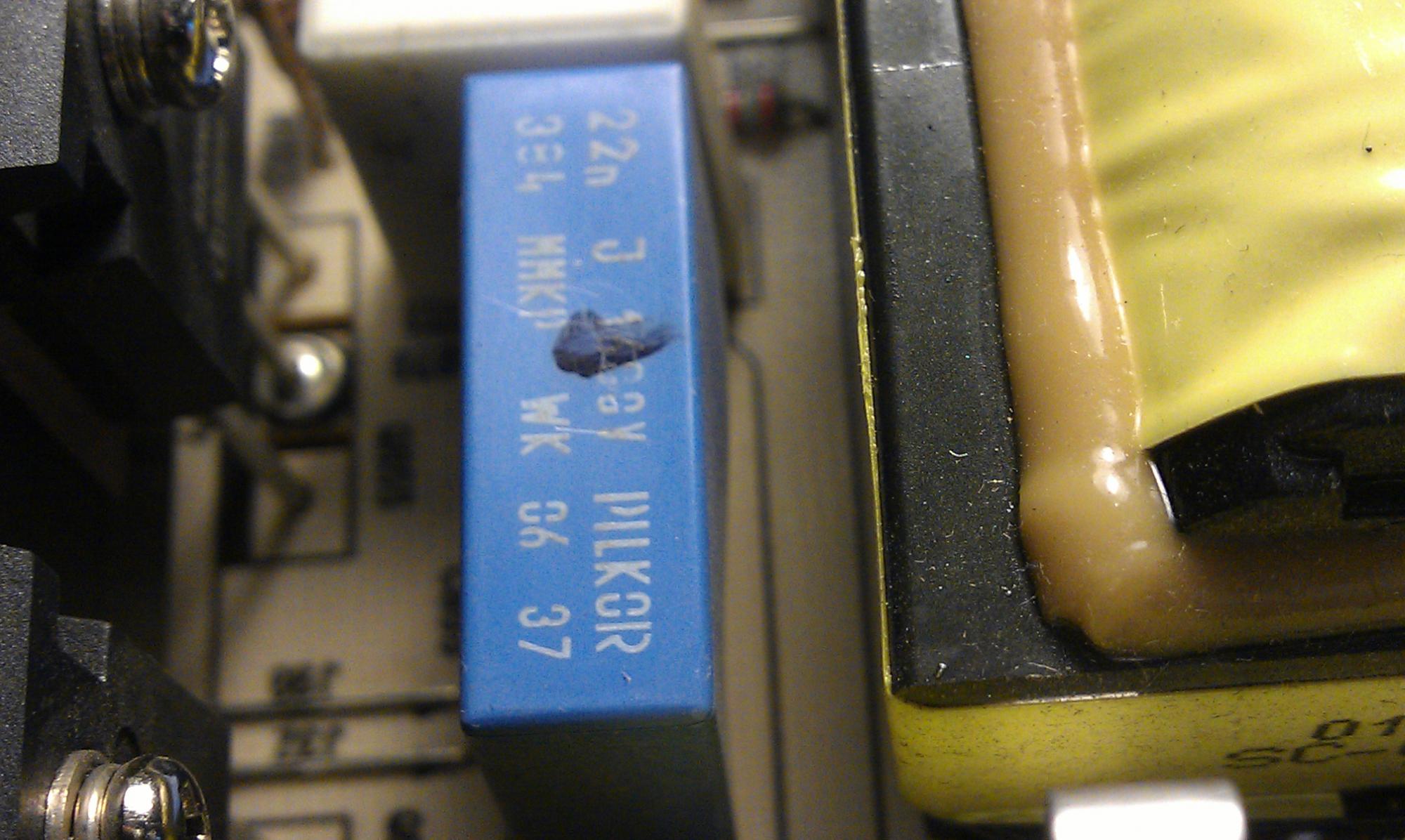

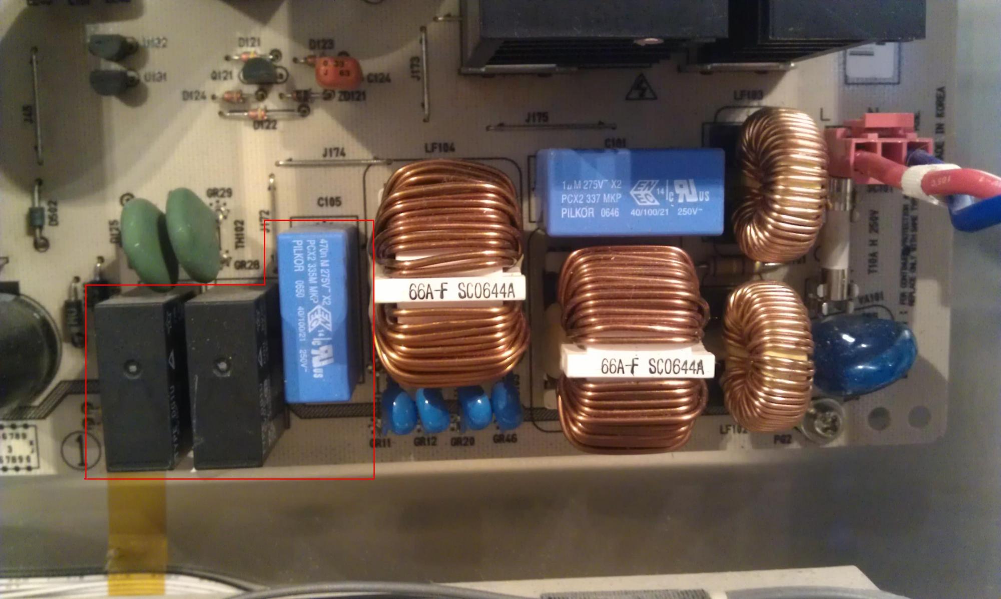

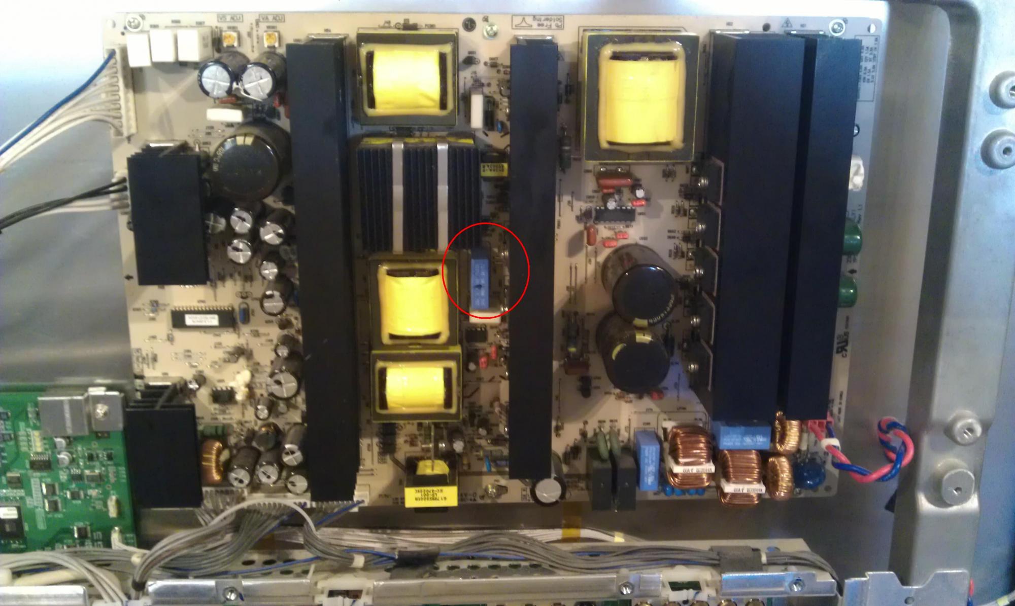

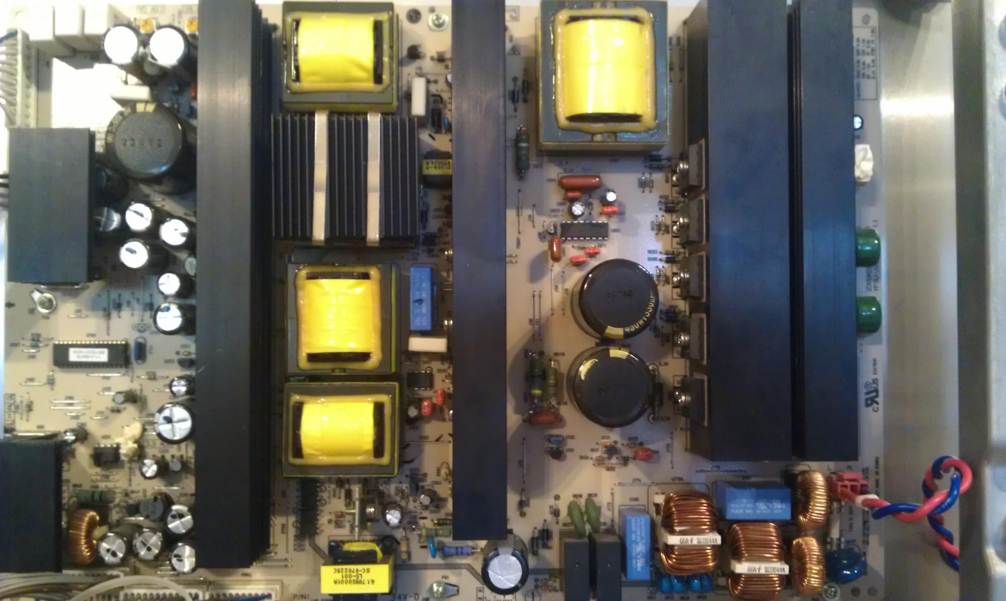

    I'am new hear and would like to find out some info on a power board for my 50" plasma LG tv. At first the whole screen went pixelated, random colours on a fuzzy screen with the sound still working. A friend of mine tested the tv and came to the fault being the Y-sus, he also checked the buffers which where fine. When I got the tv back it would switch on but only for 5 seconds and go back into stand by. This he said was caused by the faulty Y-sus and once replaced it would be fine. So after fitting the new Y-sus it still has the same power issue. I have removed the power board and checked for any burn or visual damage on it, all looks fine. There is no way near the volt outputs at the Va or Vs(60v and 192v). There is a tread here that has a simular problem on this board as in the centre blue component is bulgeing at the sides, or maybe the 3 relays at the bottom of the board, this is where i can hear the unit switching off, could these be the cause of this fault?

    The relay you circled in the photo; I don't see it bulging, but there is a black line on it. Is that marker?
    The bottom ones look OK.
    Are you sure you're not seeing any VA or VS? What screw are you using for grounding?
    Try grounding on the metal grommets on the bar that runs across, that's part of the chassis.
    Make sure the probe doesn't wiggle or move, tape it down if you have to.
    Next, while touching the red probe to the VS wire on the board's plug, use your other hand to turn on the TV.
    Just be careful, don't slip, there's a lot of voltage that you're measuring here.
    You should get around 189 - 193V, for a second or two and the TV will click, and shut off, and it drops to 0.00.
    While you're at it, go ahead and measure ALL the pins coming off the power board.
    Yes, there are many, at least 8 or 9 on each connector. Keep a notepad handy to write them down.
    It may be easier if someone is helping by turning the TV on and off when necessary.
    Always consider the possibility that the new Y-sus replacement is faulty. Where did it come from?
    Was it used or "new"? Was it repaired? (i.e. IPM replaced).
    A simple test you could perform is unplug BOTH the Y and Z sus boards. Yeah, I know you replied in another thread that unplugging the Z made no difference, what about both? And then try it with the Z plugged in, and the Y unplugged.
      Thats marker, only slightly out of shape.

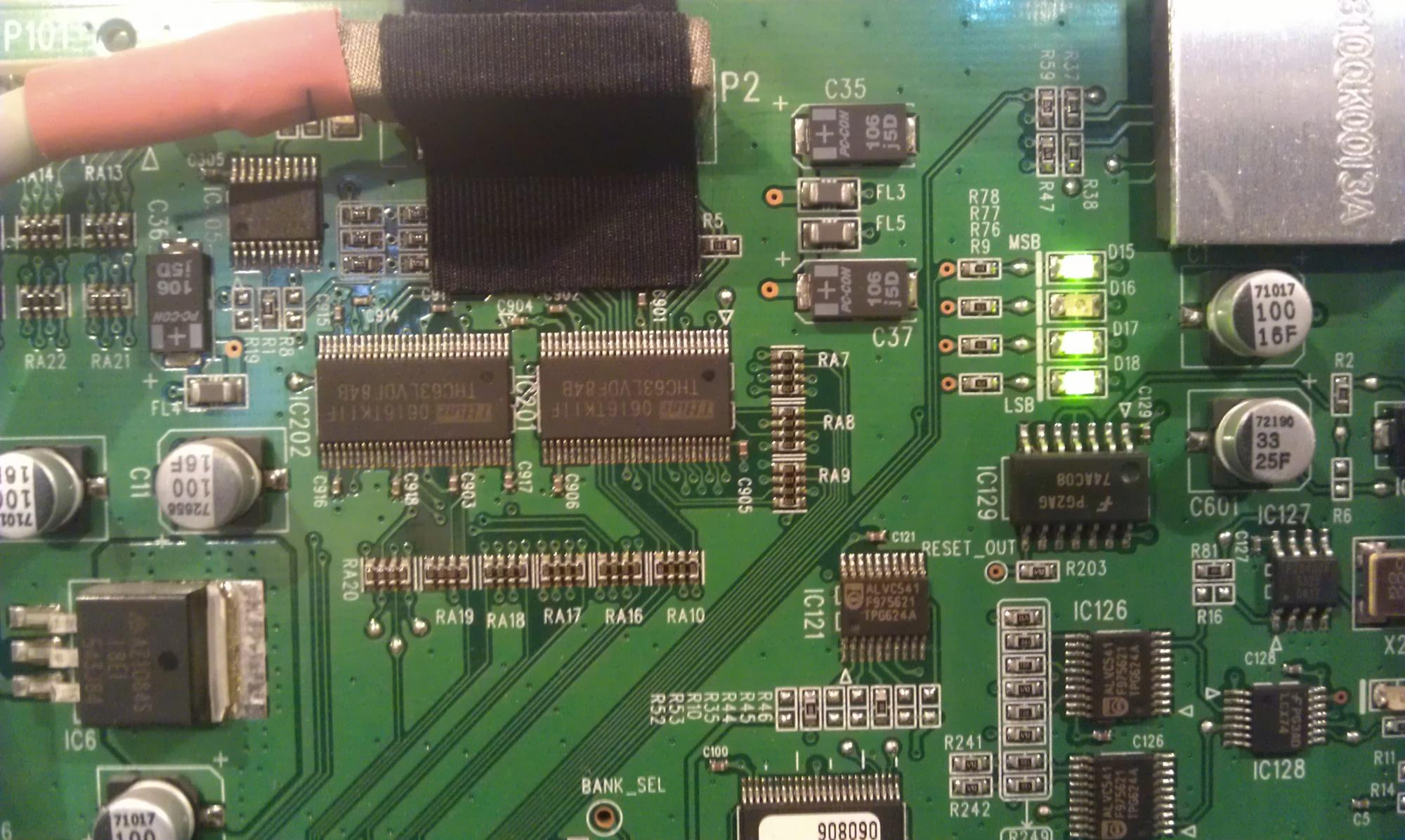

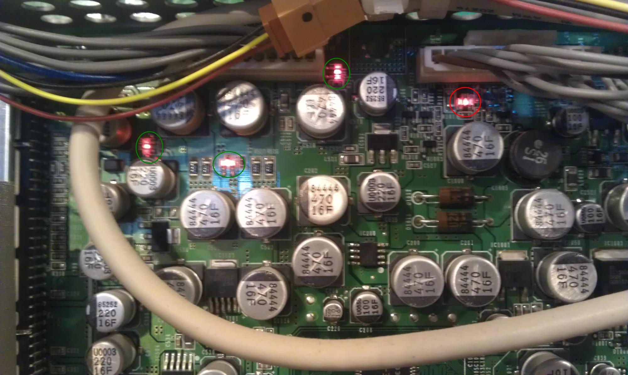

                  There seems to be missing the va and vs on the board. I have a new Y-sus board and it was supplied by GTV in Watford England. I have taken photos of LEDs that light up on the back of the tv, may help diagnose the fault.
                  The red circle is on in standby, and the 3 green are on when tv is turned on.

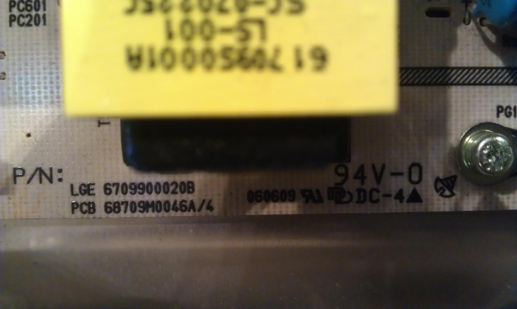

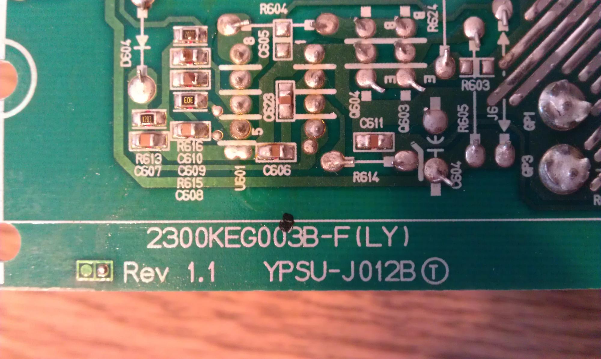

                        Can you post a picture of the bottom of your power supply?

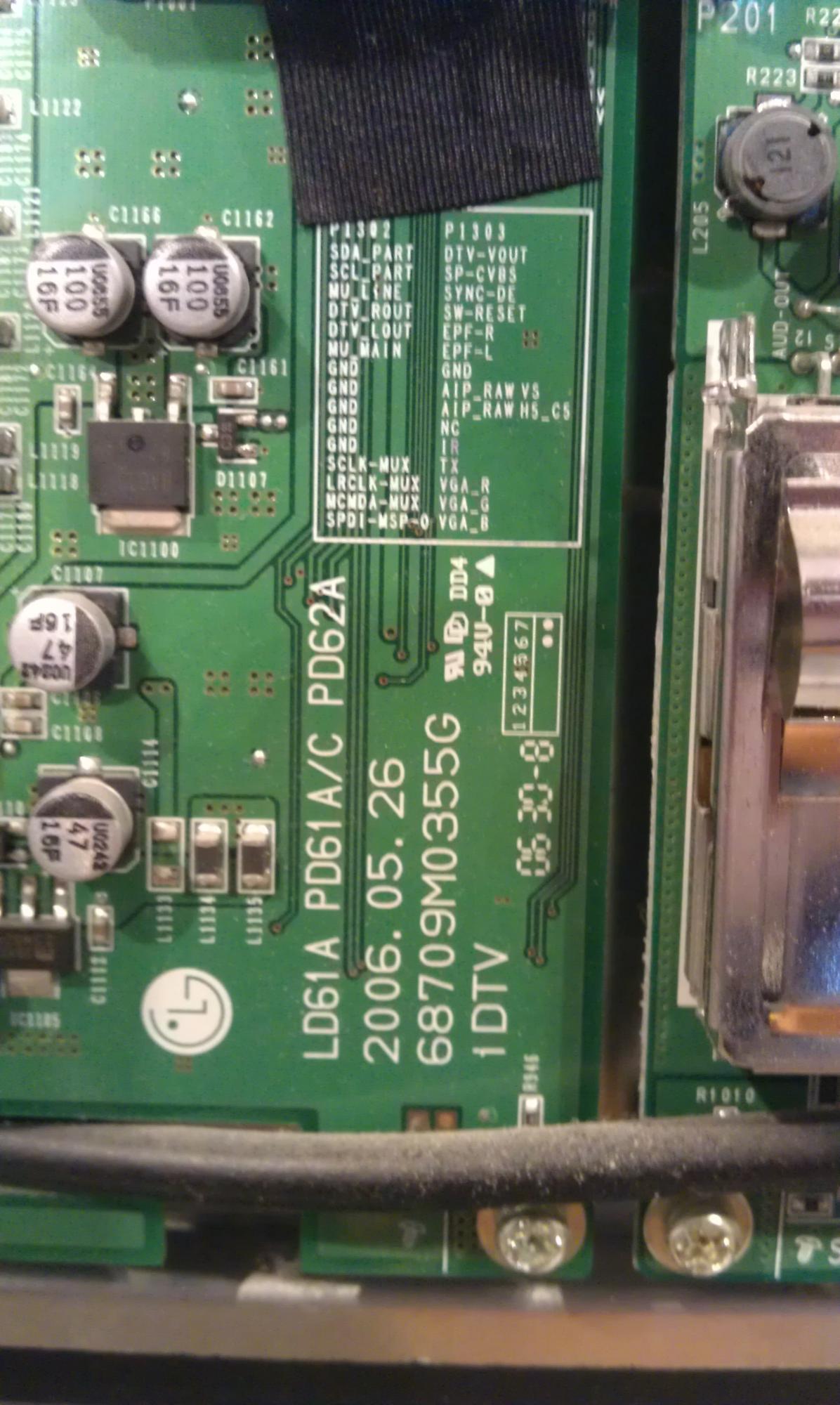

                        If you need them, I've got a spare main board and AV input board for the 42PC1D; I expect they'll be compatible with the 50PC1D. Do your boards have any numbers on them?
                          Re: 50PC1d power board
                          There you go!
                            Bottom side; it's usually green in colour.
                            Your main board is the one with the HDMI inputs and DTV tuner on it. It does all the processing to display the video on the screen. Are there any model numbers on the main board? (Come to think of it, on mine you had to take the cover off the AV input area to get to the boards, so it might be tricky.)
                              Sorry mate,
                              Cheers
                                Originally posted by caspermccormack View Post
                                Sorry mate,
                                Cheers
                                Bottom side of PSU . That's main board, I'll check mine later to see if numbers match.
                                  I'll pull it out and get a snap!! sorry

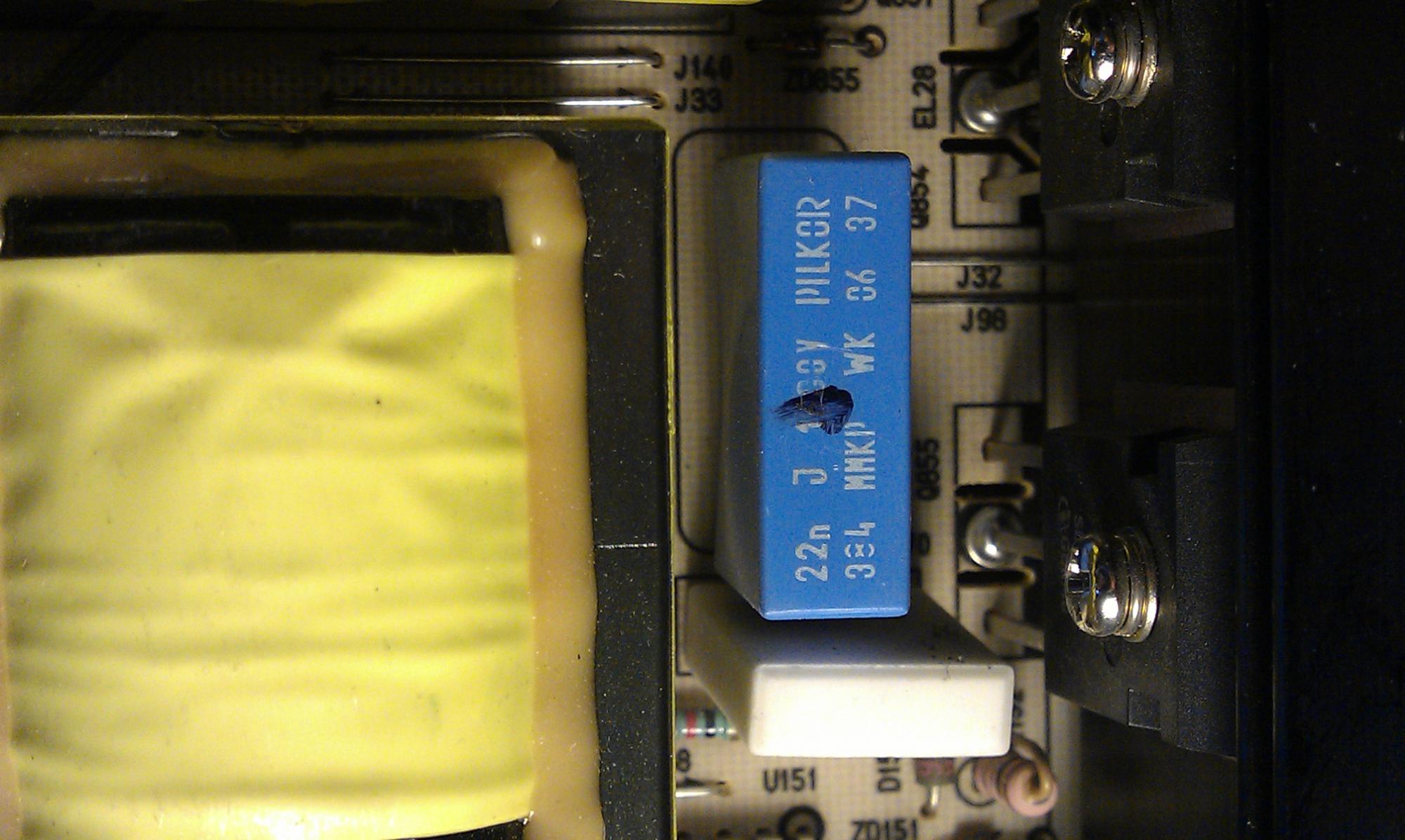

                                      You say the blue thing in the middle of the PSU is bulging out is sides? That is some type of X-class capacitor I believe.
                                      -Ben
                                      Muh-soggy-knee
                                        Here you go Ben,
