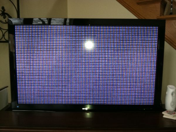

    Does this look like a bad panel or bad tcon? I've never seen the basket weave pattern. It does have audio. I don't know if the menu comes up or not. I asked the guy if he had it looked at and he told me they said it would cost more than the tv is worth. That has me a little paranoid that its the panel.

    I think some places quote the repair of a t-con as requiring the screen and the tcon since they were originally sold together, and if your buying a new one from the manufacturer you used to have to buy both together from many brands.
    I saw some sony page i think saying that they would start sellign the t-cons seperately , but that in the past they sold them with the screens only because of lots of permanent settings in each tcon that were customized to the screen.

      this tv is a sharp 52D62U. I have bud m's sony t-con pdf. It shows some examples of ad tcons and a symetrical pattern is shown but only bars not criss cross.
