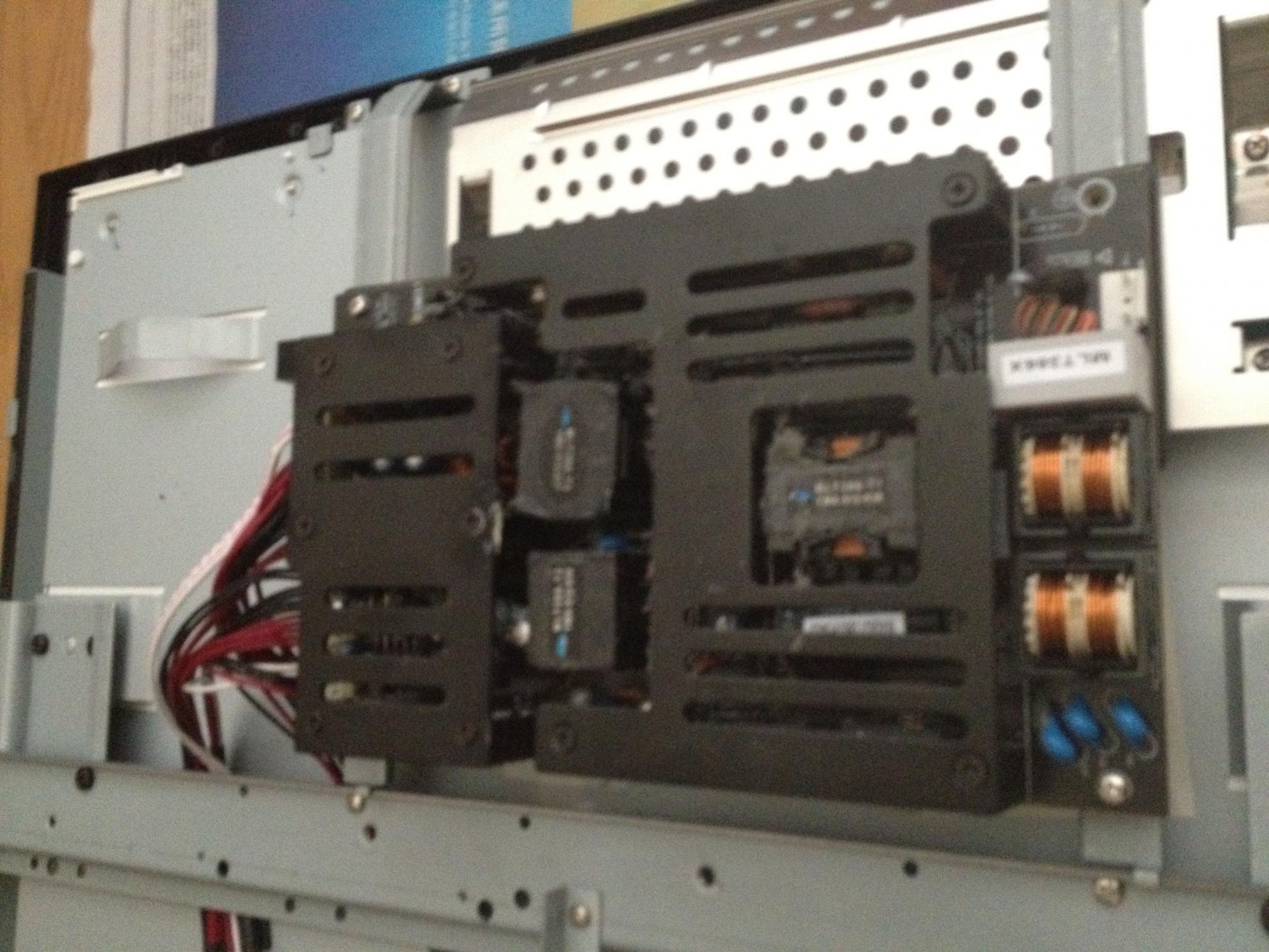

    hi, I found this cool forum while searching the web for information. Many thanks to everyone ahead of time for any help.

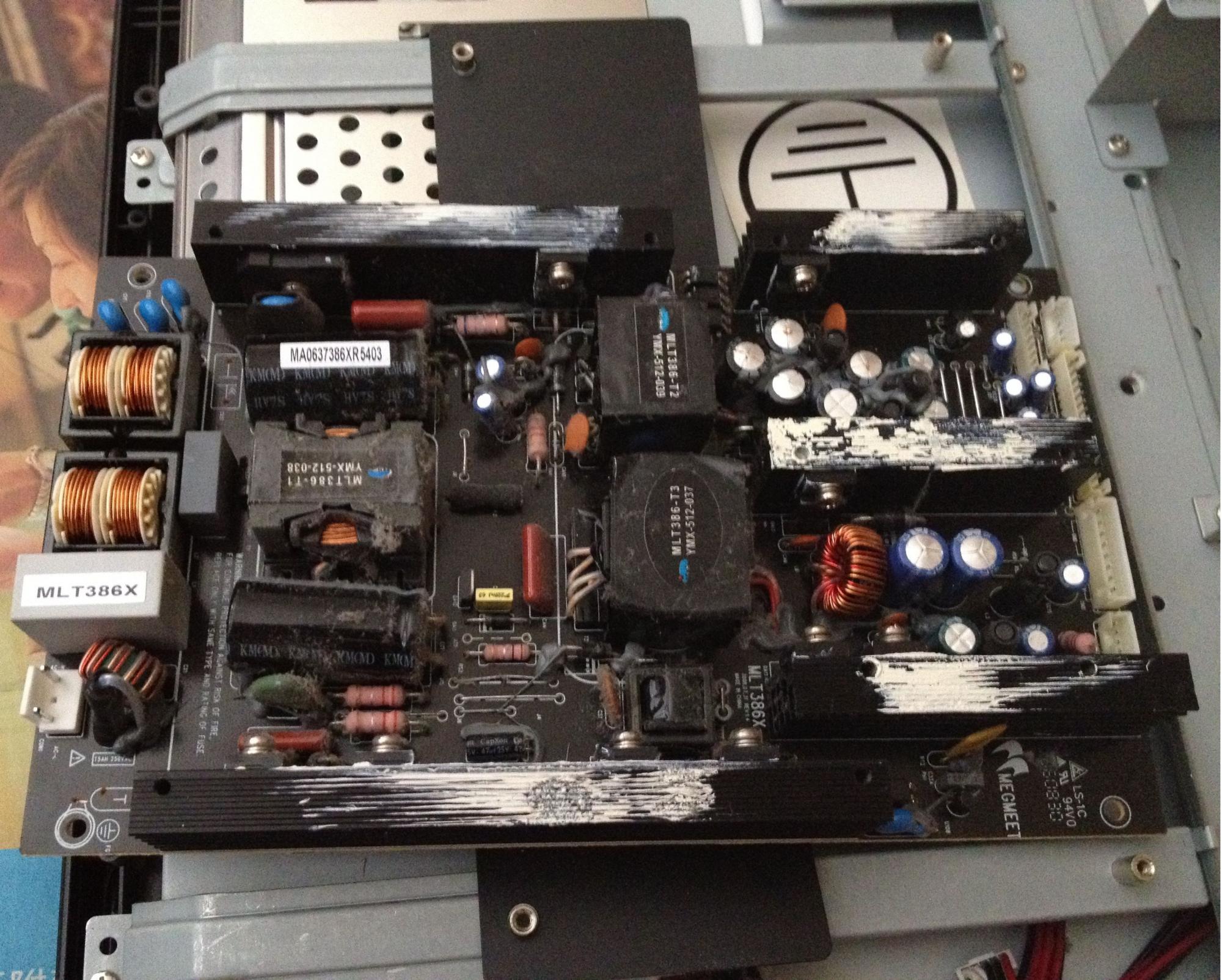

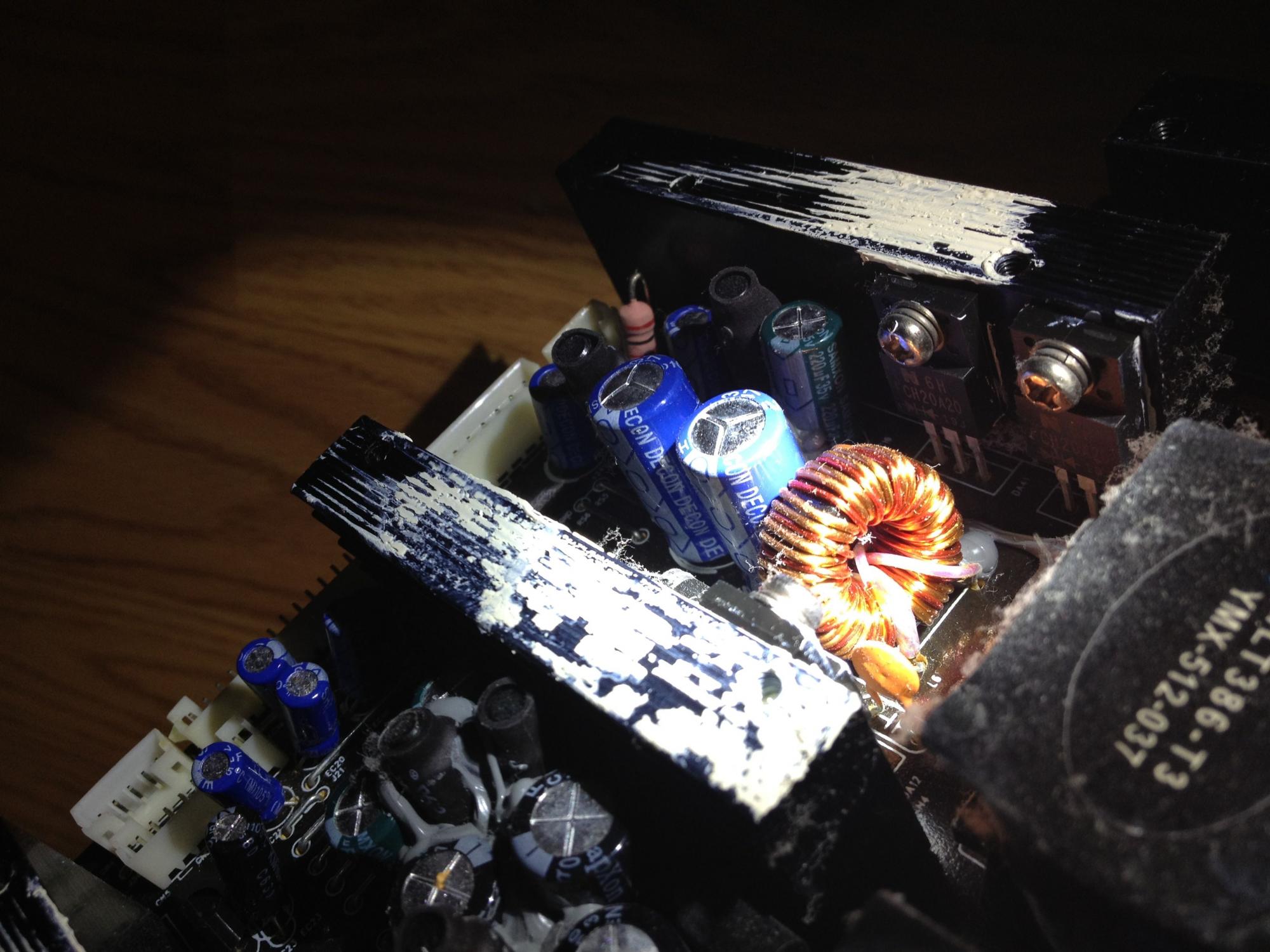

    Problem: I recently received a half-broken tunerless HDTV (works when it wants) with the MLT386X power supply. The first thing I did was open-up the psu from advice at avsforum.com and noticed alot of caps have leaked and few with bumps. The HDTV shows major distortions and "snow flakes" when it works. But when it doesn't, I can turn it on but see nothing except white snow flake screen.
    About Me: I, myself have computing experience but not much electrical. This is my very first attempt to fix the psu. I have very litter soldering experience.

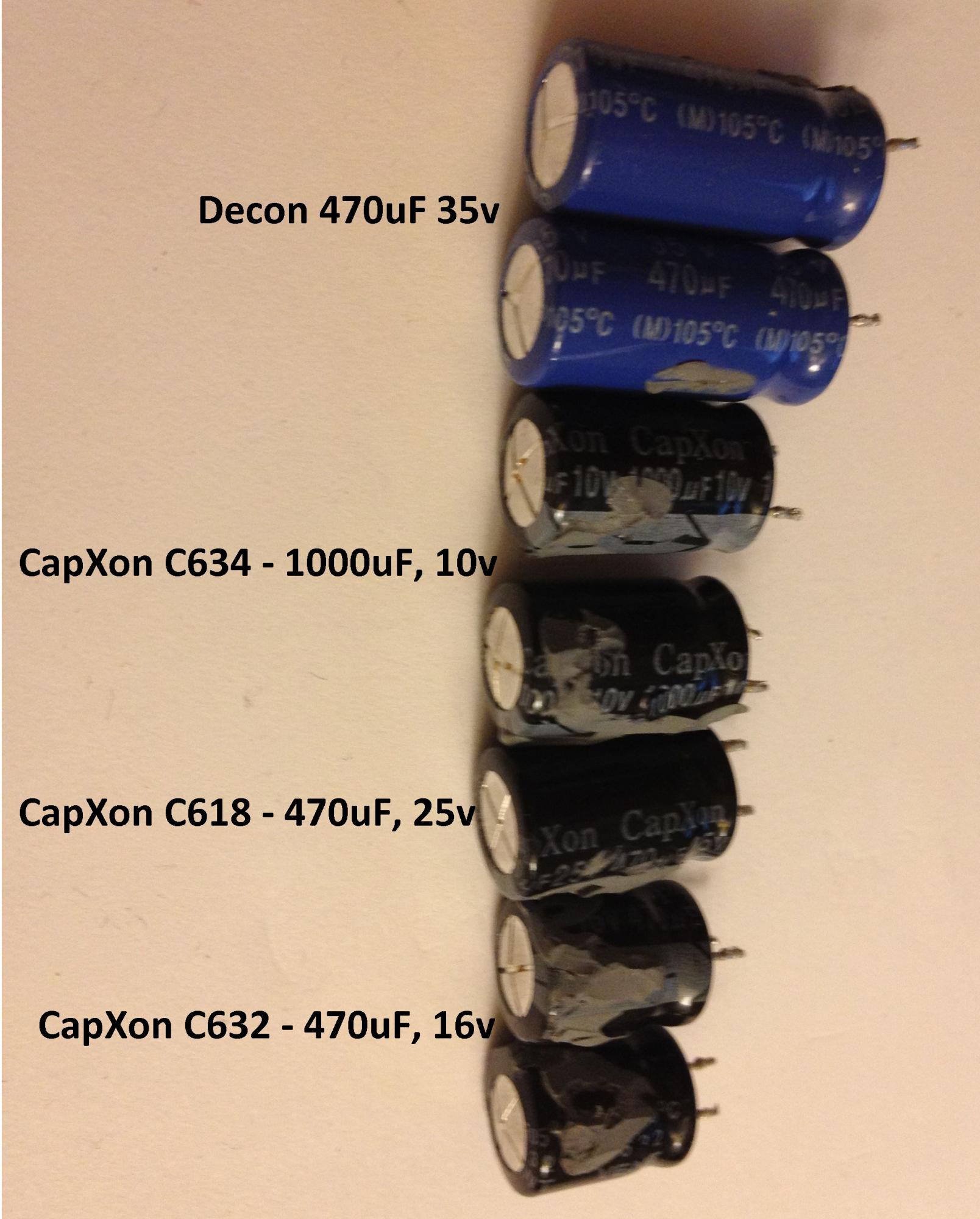

    So far what I did, purchased
    2x CapXon C634 - 1000uF, 10v > 2x NTE VHT1000M16 - 1000uF 16v
    2x CapXon C632 - 470uF, 16v > 2x NTE VHT470M16 - 470uF 16v
    1x CapXon C618 - 470uF, 25v > 1x NTE VHT470M25 - 470uF 25v
    2x Decon 470uF 35v (unsure if these are electrolytic caps and frys has no stock)

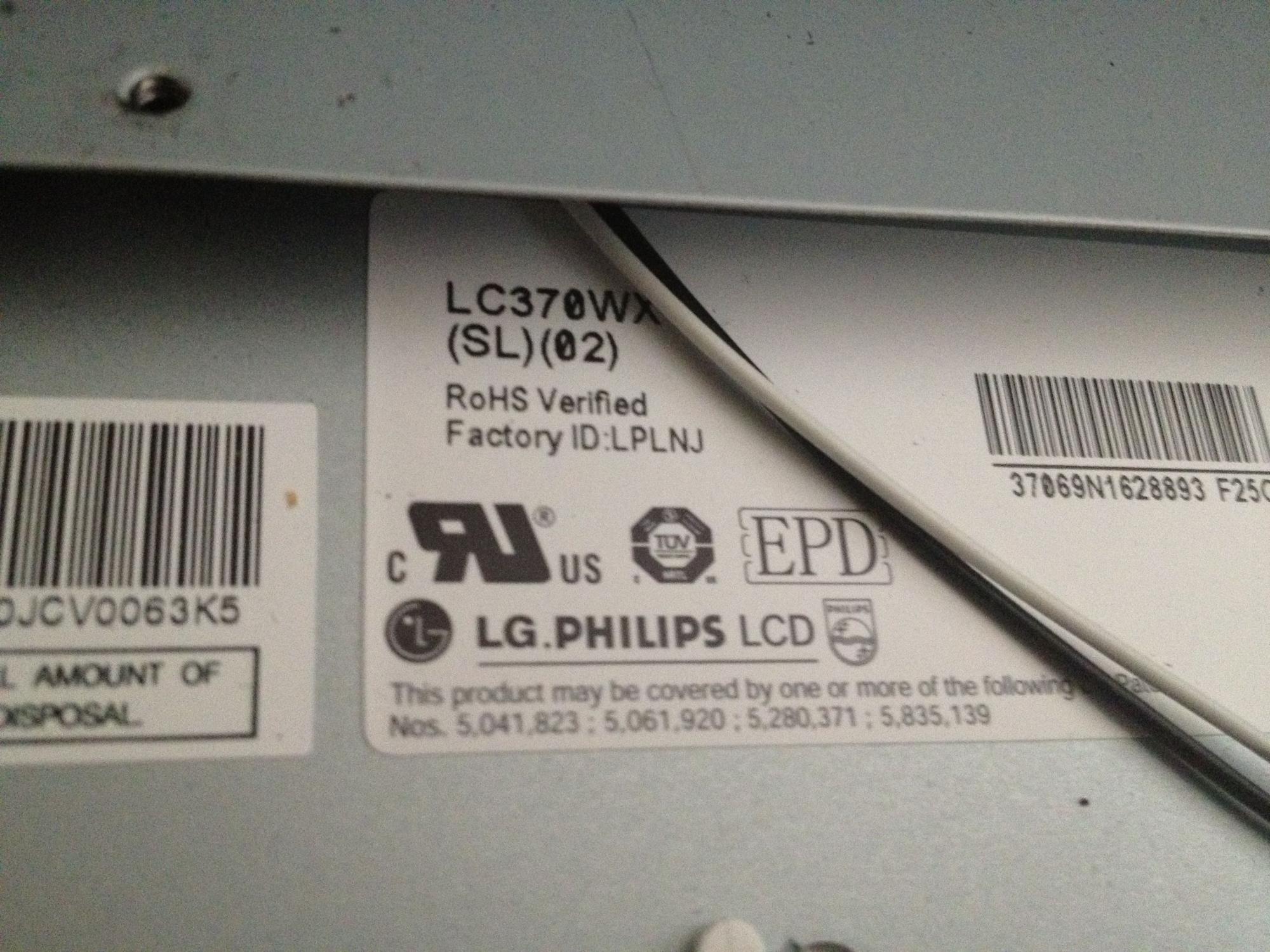

    My hdtv model is: Viore LCT37V66HM (uses LG/Philips Display)
    1) Picture of the MLT386X (heat-sink removed and exposing caps)

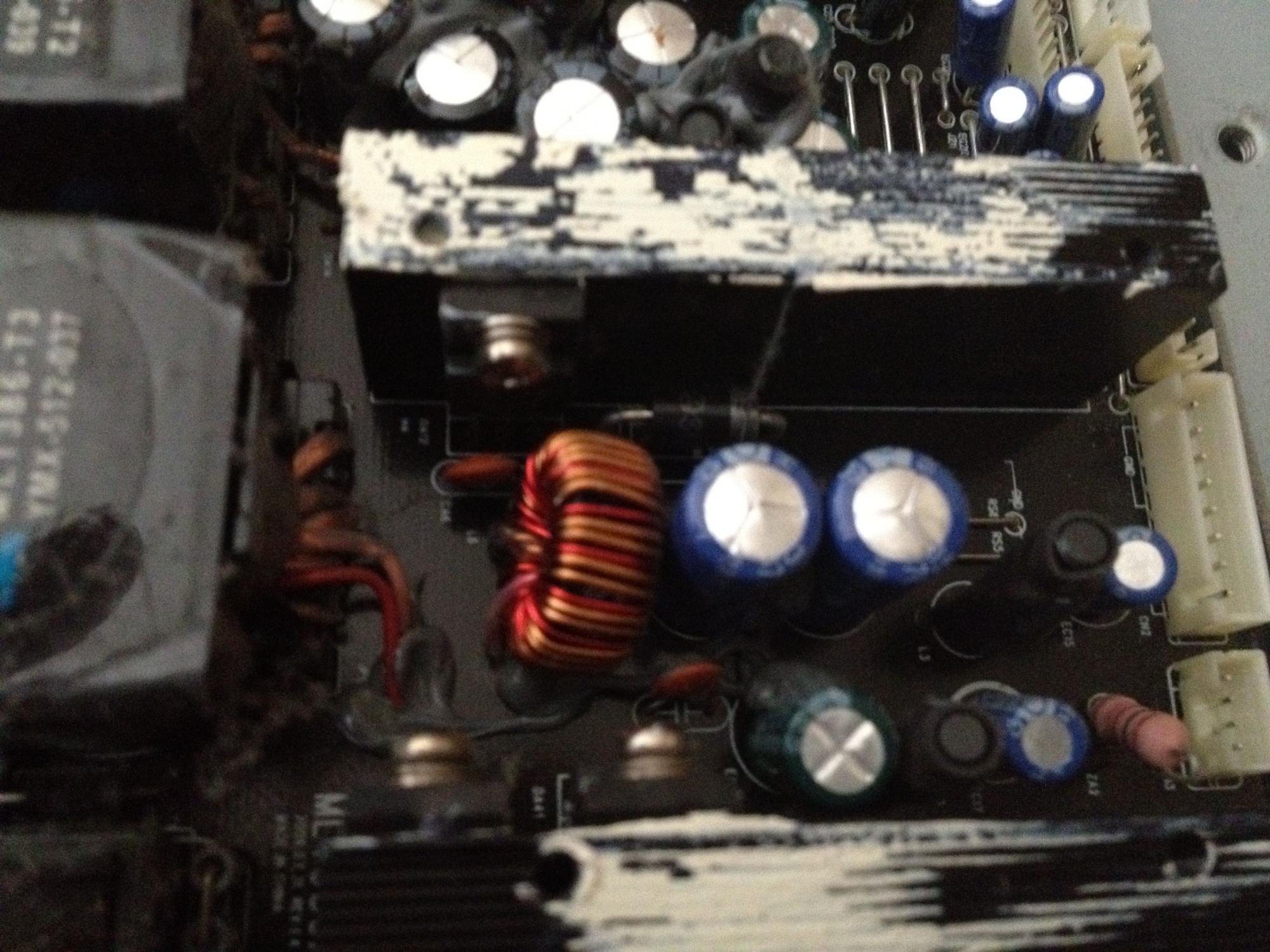

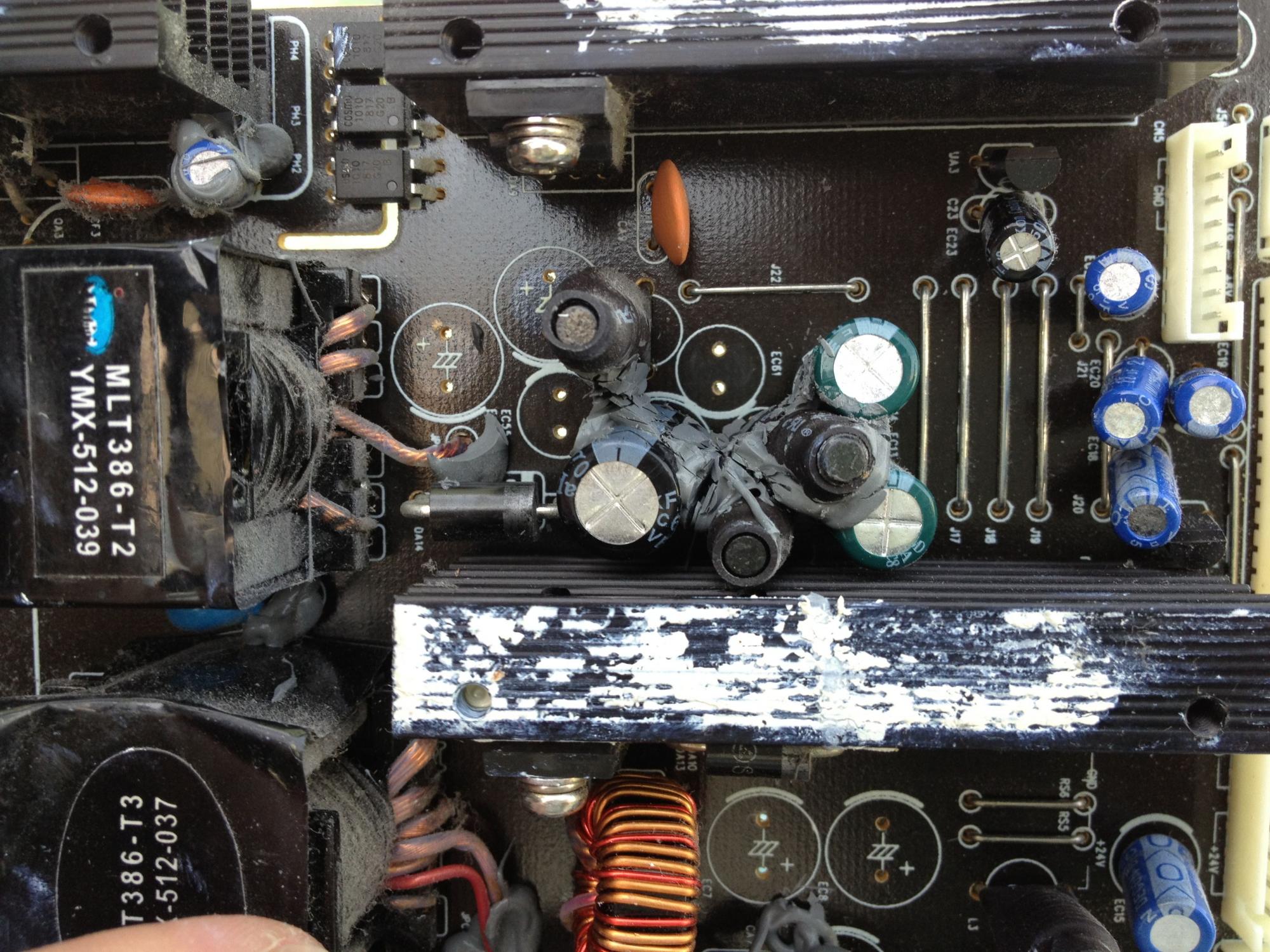

    2) Description of each leaking caps.

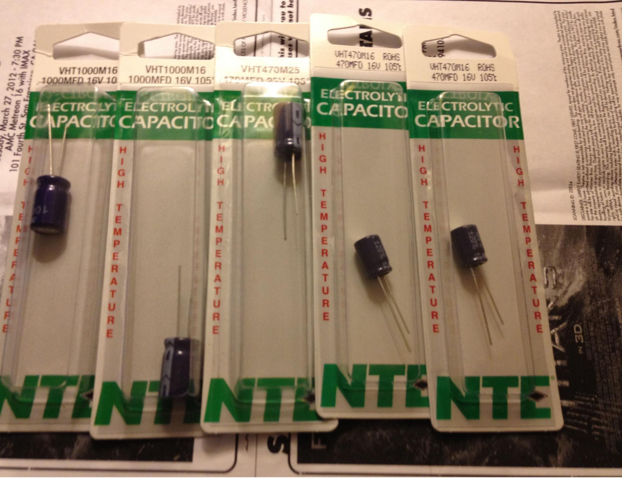

    3) Found some replacement parts at local fry's electronics. (I have a acct at digikey.com but fry's electronics was a 20 minutes drive.)

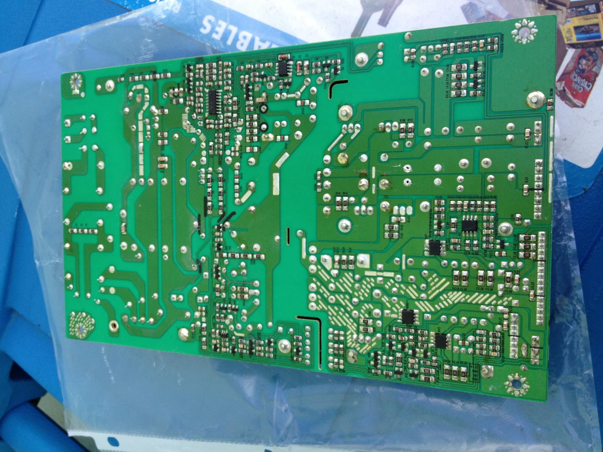

    Can you post well focused pics looking straight down on your board - both sides.
    Please do not post in line - use manage attachments which is in Go Advanced which is below quick reply jpg files no bigger than 2mb 2000x2000.
    They should look like this https://www.badcaps.net/forum/attachm...1&d=1290283049 so we can see board numbers and look for faults.
    If you see this soon you can edit your inline pics out and replace.
    You do not actually say what is wrong - a blow by blow account from switching on would help - lights sounds etc.

      Not sure about NTE caps - shouldnt think they will be much good- data sheet doesnt even mention ESR - should be ok to get working but may not last long.
      The Decon ones are electrolytic caps members here would normally recommend Panasonic FC FM series or similar Rubycon or Nichicon.

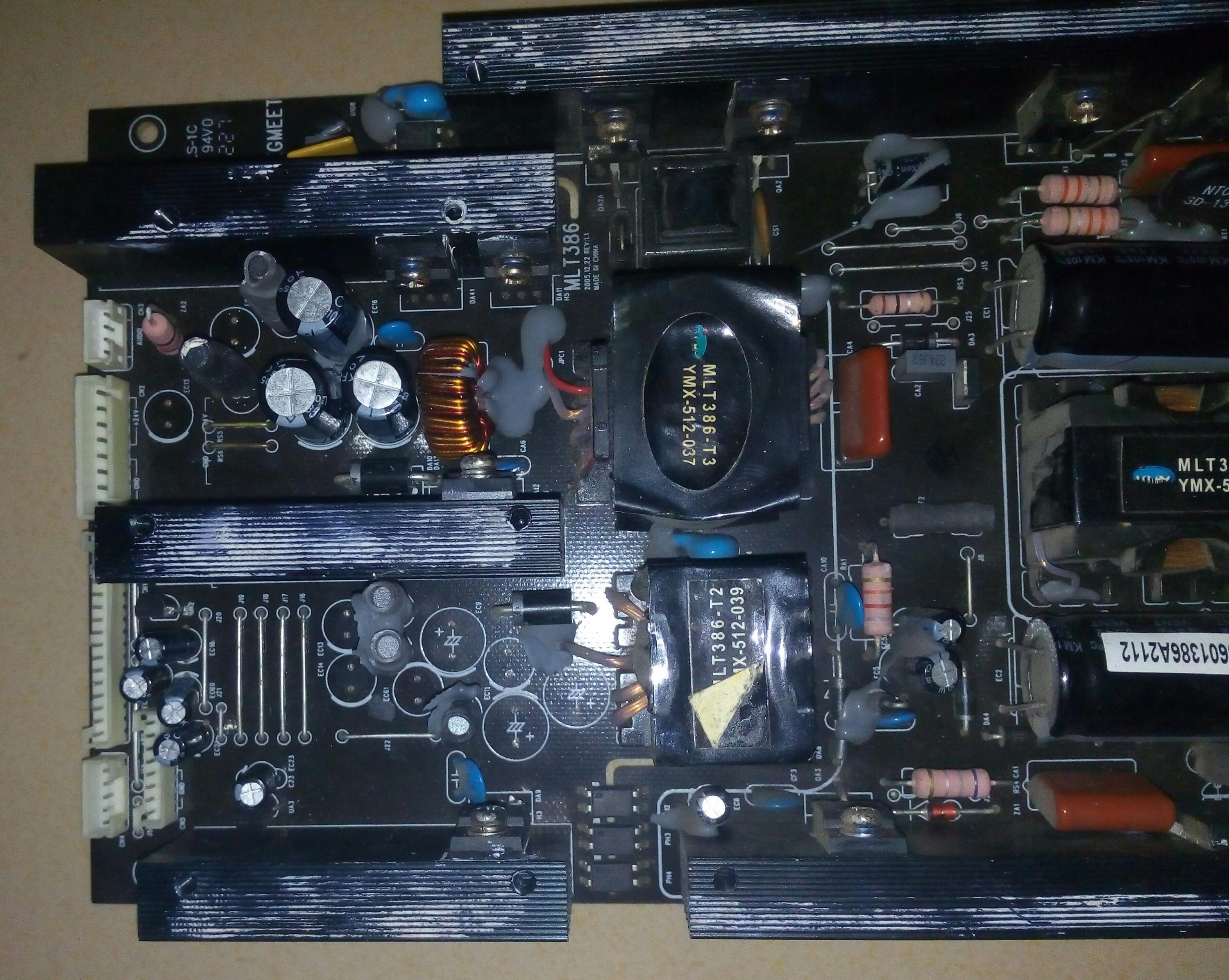

        I have re-upload the old images, removed direct links.

        NTE capacitors are designed for both the most demanding applications and those not requiring tough characteristics. And most are available in axial or radial lead versions.
        http://www.nteinc.com/capacitors.php?a=2
          Re: Replacing bad caps in MLT386X PSU
          I wouldn't trust the manufacturer.
          -Most- CapXon are rated for demanding applications yet they still don't last.
          You need low-ESR caps which cost a couple of pennies more. Digi-Key stocks them. Low-ESR caps are sometimes a requirement, not just a long life option.

            Pictures are better but you need to give the board a brush down to get the dust off.
            I would give consideration to replacing all the caps on this board except the BIG one (assuming that doesnt look bulged or leaky) with low ESR ones. Picture of the board underside.
            Sorry you did say what was wrong I missed the snow bit unless you edited it in.

              All inputs are the same. Works when it does and when "it does" after awhile screen distorts. The funny thing is I noticed the ground wire was completely off of the grounding. I dont know if I pulled it hard or it wasnt on (I re-crimp it) I also see on one wire of the inlet unit is a burn just very slightly.

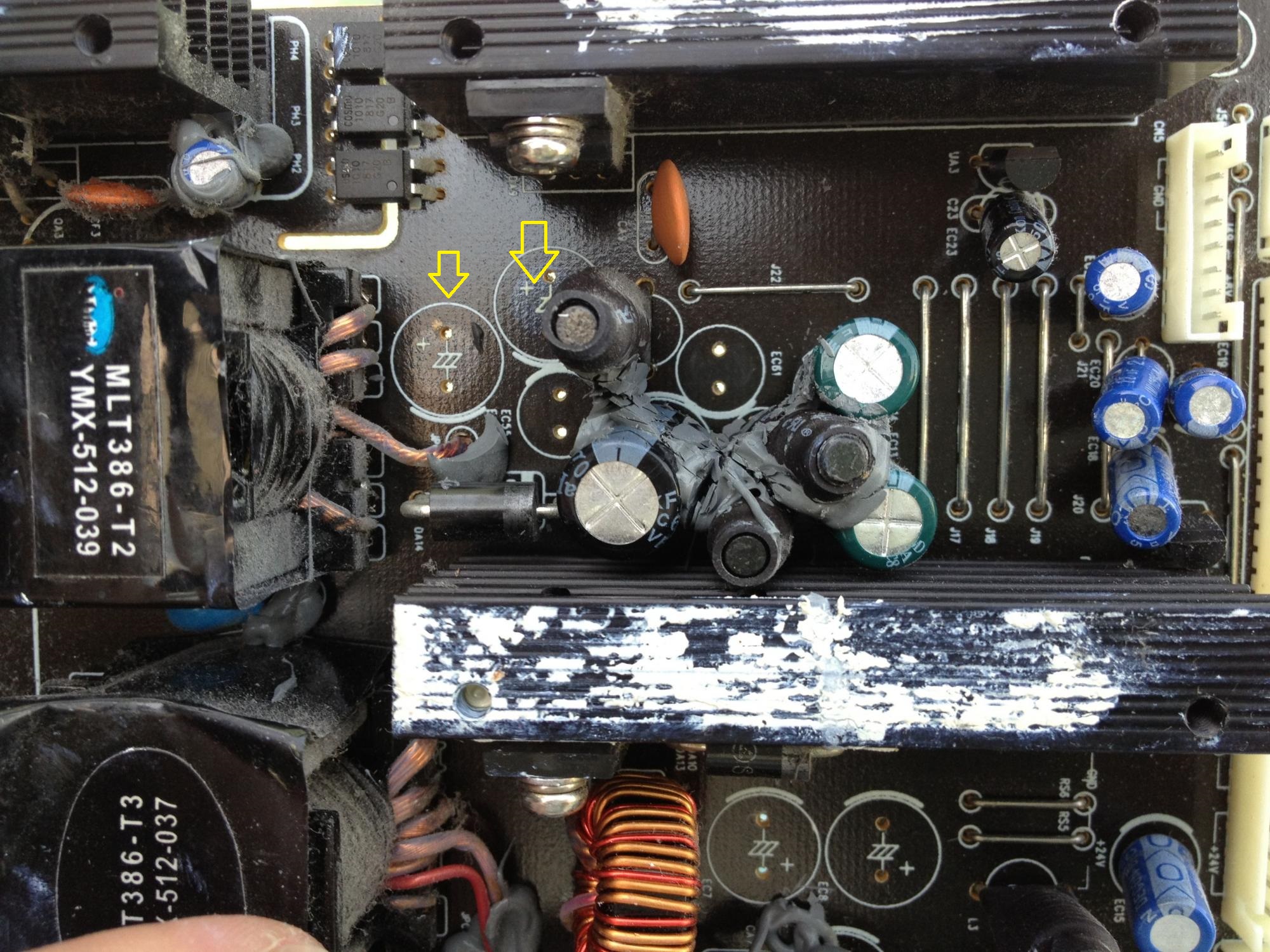

                        Hi all, I'm happy find this forum, and I Hope my LCD will coming back,
                        please help to find out my missing caps size & volt components
                        mark with yellow arrow. I forget where I put these caps when I want to buy this replacement caps. many thanks and sorry for bad my english
