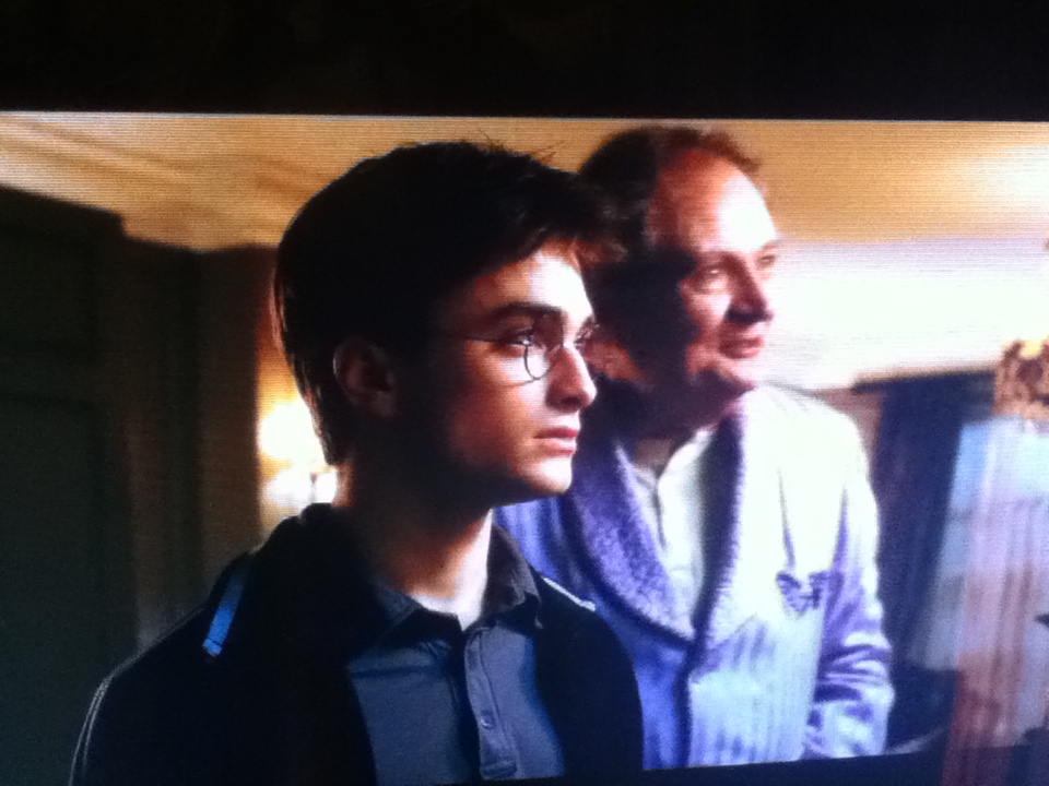

    Tv lights up and is like a blueish ,as you can see in picture,anyone have this problem yet,Im picking tv up tomorrow for 60 bucks,just wanted to maybe get a head start,I was thinking checking all ribbon cables first then go from there ,Thank you in advance,Gootch24
    Re: Samsung 46" LED TV UN46B6000VFXZA
    T-con or bad panel... quite likely to be T-con. (Budm will be able to tell us for sure.)
    Do post pictures of the insides when you get it. (It will be interesting to see how well built Samsung LED sets are.)
      Does the amount of lines and faded part of the screen get worst as it stays on longer? This kind of symptom I will try cleaning (I use DETOXIT D5) and re-seating the ribbon cables between the LCD panel and the T-CON first. I am working on one with similar problem but I do not have a chance to take it apart yet.

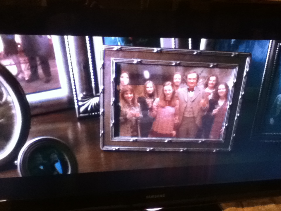

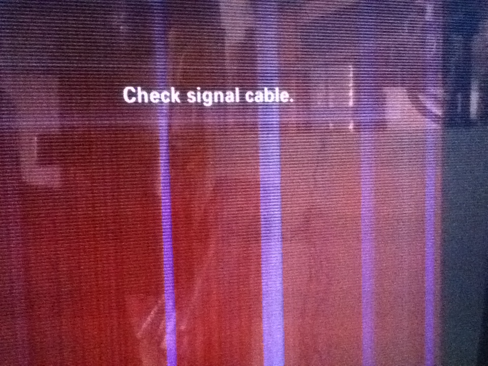

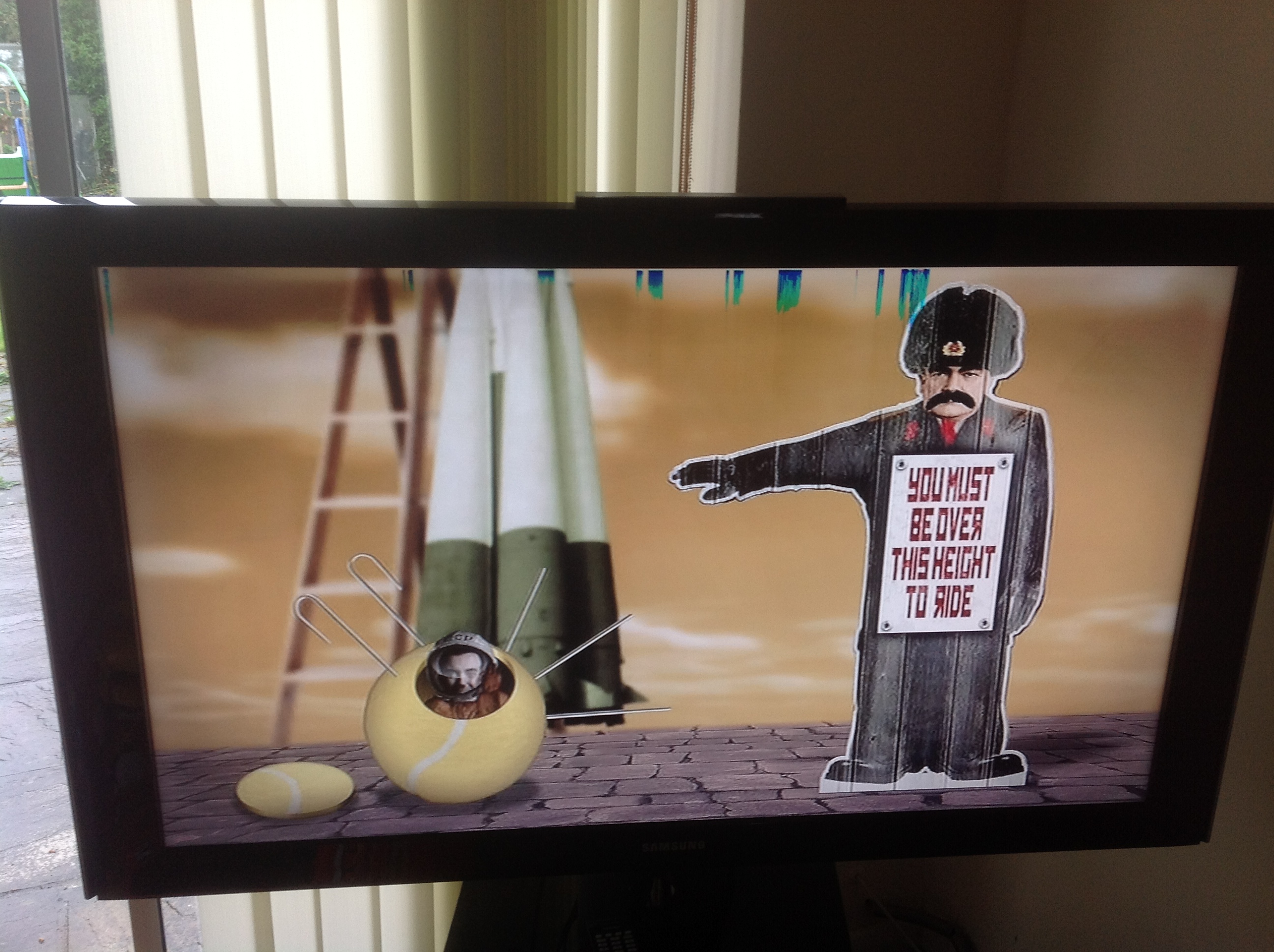

          ok I picked the tv up and havent pulled anything apart as of yet but wanted to post some pics, yes the picture did change a lil as seen in Pic 1, just horizontal lines, then started turning colors in pics 2 and 3 then last pic I was playing a movie off a stick and its not UNwatchable but not as clear as should be, Direction ya think I should Look?,Thanks ,Gootch24

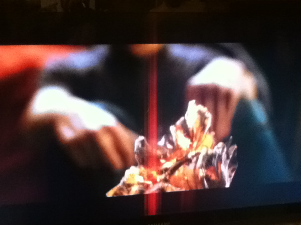

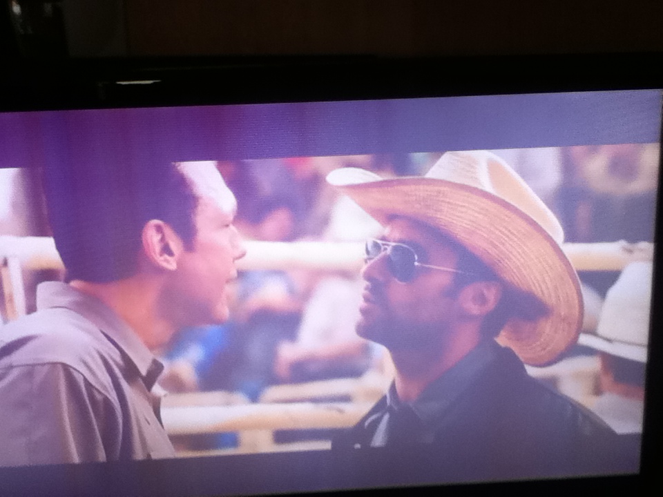

              Was watching some old movie on it and when screen goes dark all looks good except for tiny vertical lines, but if a color comes in a lines drops vertically almost that color (see pics)
                You set it to the lowest pressure setting and just spray into the cable receptacle, not on the cable, you use very very small amount of it, no need to wipe or dry, then just slip the ribbon cable back in place. Try spraying on a small piece of paper so you will know how much it's coming out from the spray tube. When you spray, you will see it start spreading by itself.

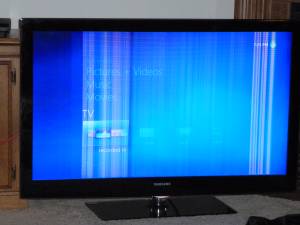

                                  My samsung LCD 46 also shows the mostly bluish lines on the top part of the screen ..at 7 places .some places show reddish.TV is 4 years old . This happened last week..I can also see those lined section as black when TV is OFF ..Can someone please tell me whats the issue ? is it worth repairing?
                                    I think the LCD panel has failed. Do the lines move with the image? Did the problem develop immediately or slowly?
                                    • kevinm34232
                                      • May 2012
                                      • 1884
                                      What's the theory on panel failure versus T-con regarding lines moving with image?
                                        T-con can drive panel incorrectly causing lines to move with parts of the image.
                                        Panel cannot typically fail in such a way.
