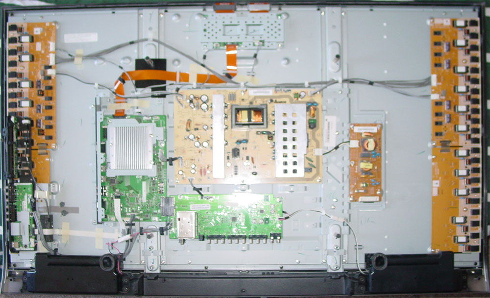

            Ok, so I am making a bit of progress here (it's been a busy weekend, and I was only able to get to taking apart my TV just now). Here is a picture of the back panel of my TV. I added some labeling to the major components to make it easier for us to talk about them - I am not familiar with the electronic jargon surrounding this TV's inner boards.
            I didn't see any loose/bad solder joints on the exposed boards. I noticed that there are a few boards (mainly video input boards I, H, and D - which isn't an input) that are covered by metal cases. I have not yet taken those off in hope that the problem is simpler than that, and will expose itself in this picture (sorry - blurry).
            Thanks again for all the help! I love learning new skills and fixing things myself (as well as saving a ton of $$$ )!
              Re: Sharp Aquos LC-46D64U - HAS DEMONS!
              You've got to be joking - blurry pictures are not going to be much use.
              Still it gives a good idea of the layout and the labels are a nice touch.
              More will be required but as a start post clear pictures of A and G.
              Do not post In Line - use Manage attachments which is in Go Advanced which you will find at the bottom of quick reply box.
              Pictures should be .jpg no bigger than 2000x2000 file size 2gb.
              We need to be able to read the component designation numbers. A close up of the board number and revision and a close up of connection sockets with the designations pson 2v 3.3v 12v gnd etc(if any)will help.
              You should also post the board numbers.

                Thank you for the replay. I am sorry about the blurry picture - I don't own a nice camera, just an old cell phone one =/ (it's on the wish list).
                I will look deeper into I/H/D, and get better pictures of all boards, and make sure to use the forum's manage attachments.
                As for your quick fix. What location are you referring to for the connectors? As far as electronics go, I build computers, and do minimal soldering. So, I'm sorry to be out of the know here....

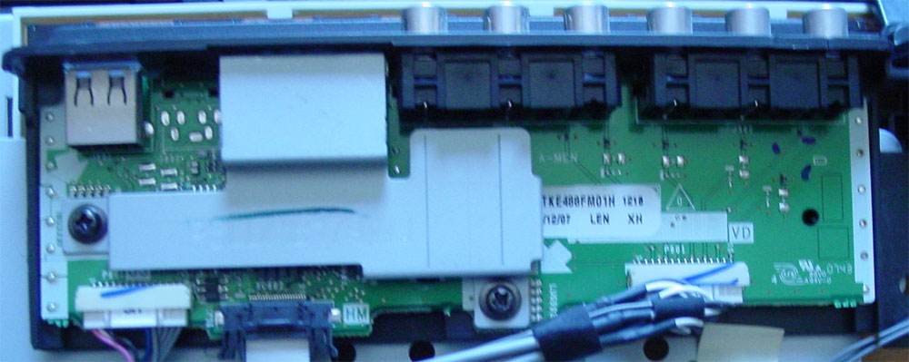

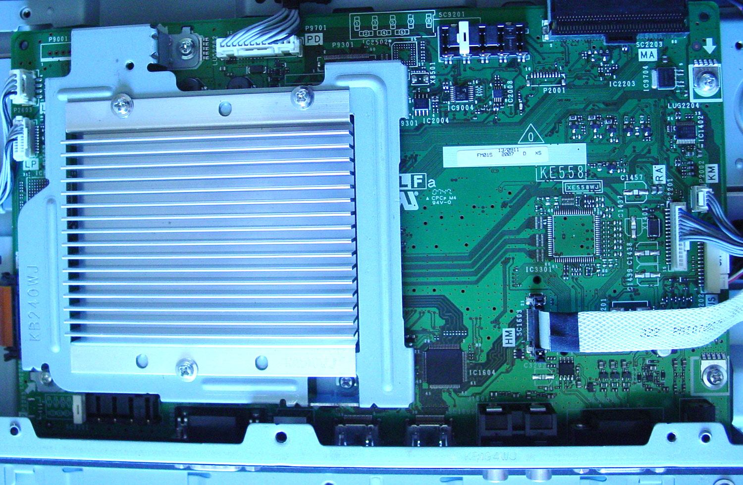

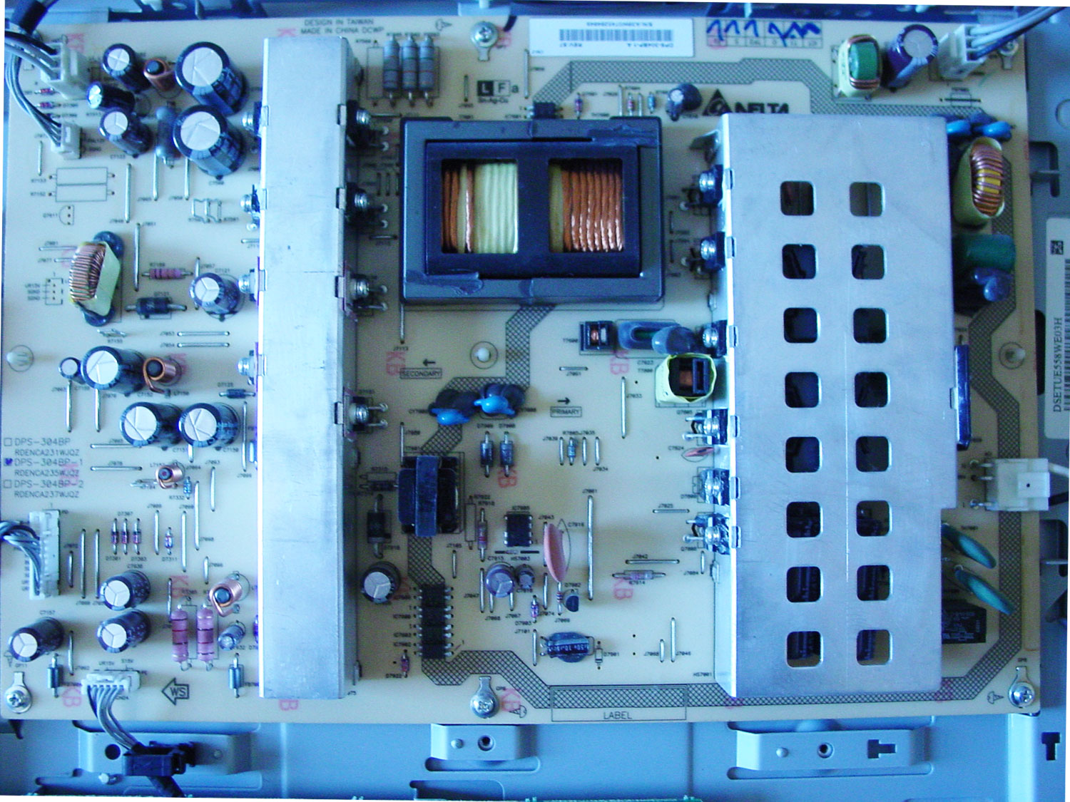

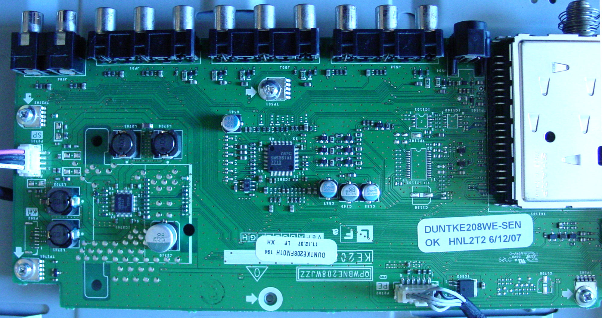

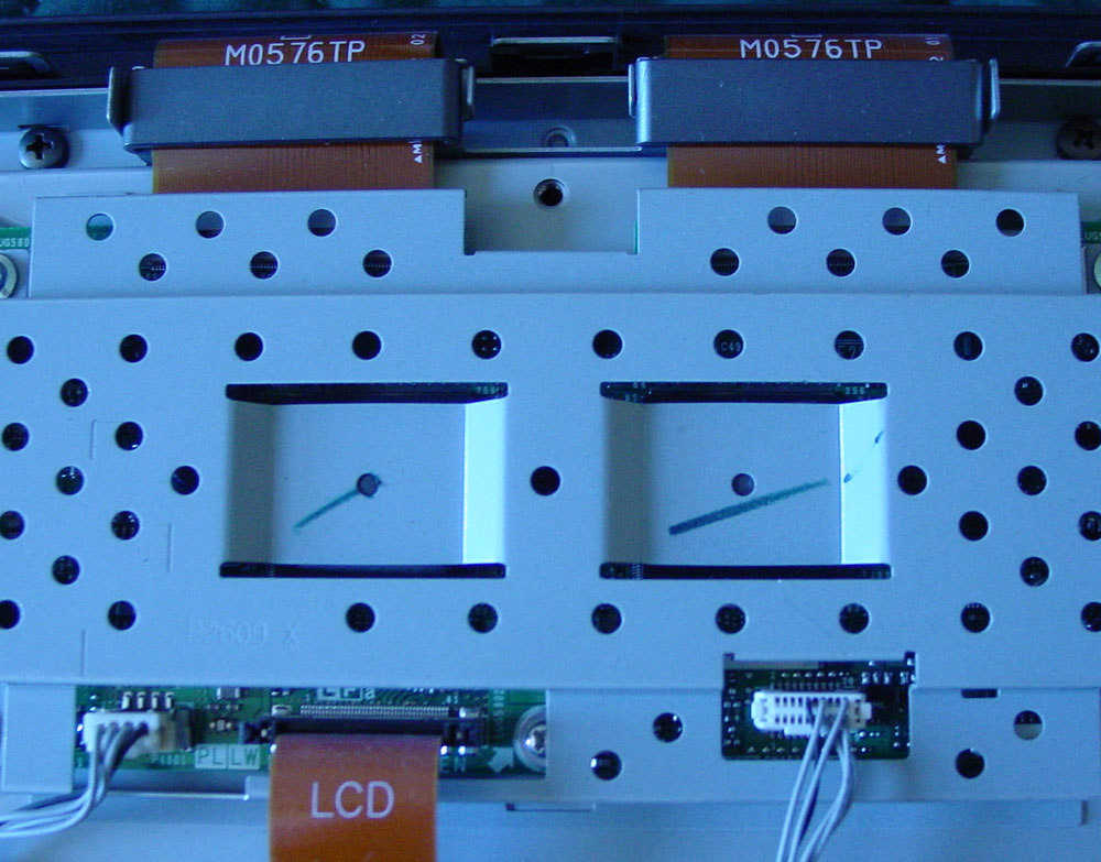

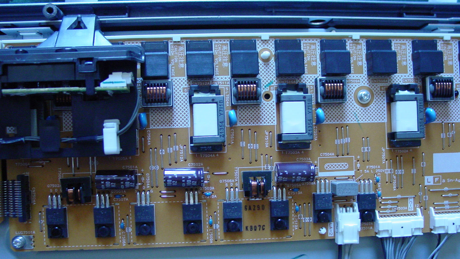

                    Attached are some detailed pictures of all the boards.
                    Thanks.
                      Hi - whilst I have got you started, I do not know a great deal about TVs
                      You will have to hope some of our TV Gurus will pick it up.

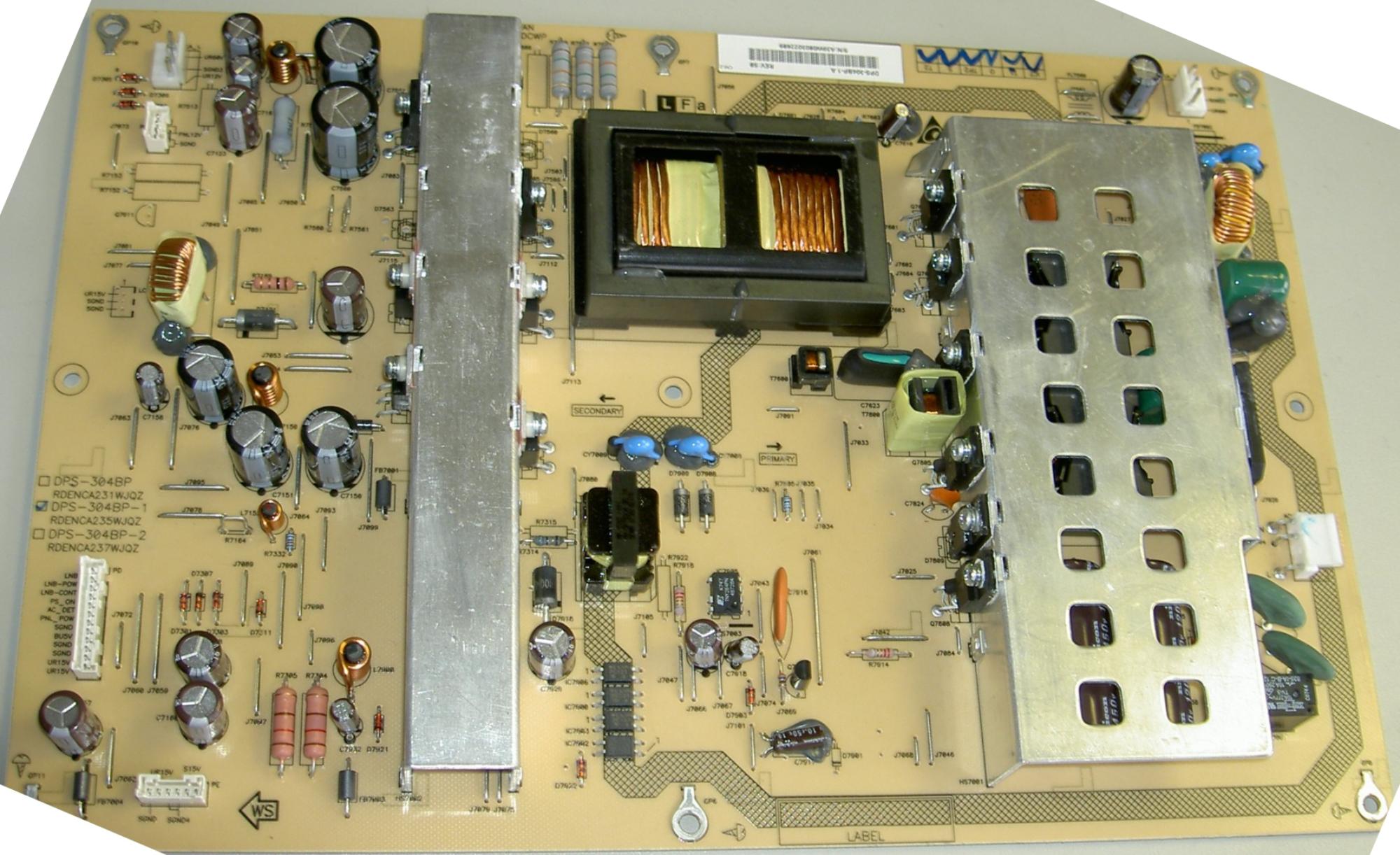

                      Your Power board is a DPS-304bp-1
                      Unfortunately I can find no schematics or service manual to help with the error codes.
                      There is this on Fixya - which is not much help but has some of the tests
                      the TV members will suggest. They will do it in a logical order but at least it
                      reading this will get you some jargon.
                      http://www.fixya.com/support/t166940...s_power_supply
                      I also found a picture of a similar board on which we can see the connector
                      designations which will be useful

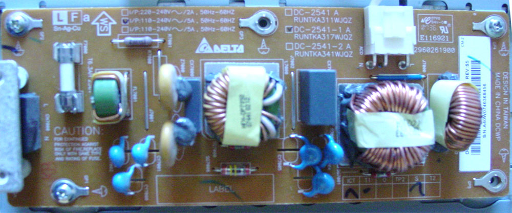

                          I did ask you not to post in line and in this case it was totally unnecessary
                          as you could have said what are boards A & G in my first picture called.
                          A is the Power Supply Board and G is a Power Supply Filter board - I have just looked it up on google - you could have done that?
                          They are often just combined onto the Power Supply Board
                          Help with Jargon:
                          primary side - I take it that this is the power board itself? Where the external power is plugged into the TV?
                          secondary side - The main board that receives power from the power board?
                          You are partly correct -this is very important for you to know and understand.
                          The Terms normally relate to a single power supply board where you have both primary and secondary voltages on the one board. Primary is at mains voltage - 120 VAC in the US and secondary is the voltage after it has been reduced - usually to 24v 12v 5v 3.3v all DC.
                          If you look at your A board you will see a hatched black line going around the components roughly on the right hand side of your board. Everything inside that box and anything straddling the line is going to be Primary
                          - at high voltage. ALSO the small G Board is Primary at high voltage.
                          Most of the rest of the set is at secondary voltage EXCEPT for The Inverter
                          Board or transformers and the CCFL ( Back Lights) and circuitry which can be at up to 2000volts - so no poking about unguided. Most members will advise at the time of you are in a danger zone. Take care with Heat Sinks
                          which can also be "live" and give a nasty jolt.

                                  What is "power converter board" where did you get that term from. Best to use the
                                  letter designations from your picture so we all know what you mean. I cant believe you bought a new board without waiting to test the old one. Anyway see if you can find a Service Manual or Schematic on the internet for L-46D64U and download it.
                                    Others had suggested I replace the board to fix the problem; it worked for them, but not for me!
                                    The 'converter board' I am speaking of is 'G' in the image I first posted, but I believe the correct term is, 'Power Supply Filter board'?
                                    I have the service Manual, but it's all Greek to me at this point. I can return the new power supply board - no worries. Before I do all that, I want to tes the Power Supply Filter board's output into the power supply and make sure it's where it needs to be - I am just not sure how to do that.
                                    I have all the equipment - the meter and such - I just need a little guidance as to which setting to put the meter on, and then as to which pins (there are only two - white/black hot/ground) to test from the Power Supply Filter board output, and what the correct output should be. If this is detailed in the manual, under what section?
                                    After testing that, and if there isn't an issue with its output, I will need to test the output from the power supply board to all the other various boards.
                                    Thanks for the reply. Hopefully you're able to share some more of your knowledge with me?
                                      Post a picture of your meter and the make/model number. See if you can find an instruction book on the net for it. Practice on a few things batteries. Check a few resistors on the board - readings will not be accurate but just to get you into the
                                      way of holding the probes and looking at the screen. Might sound a bore but there have been a few posts in the last week where probes have slipped and ruined components and a power board in one case.
                                      Its late-ish over here and I have an early get up tomorrow but others will help.
