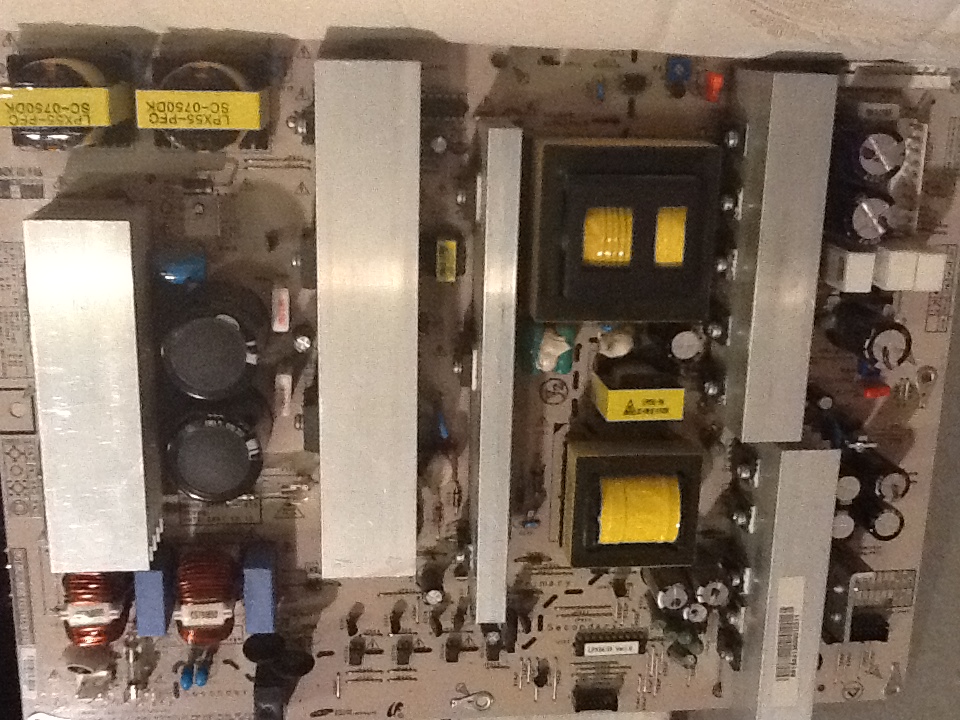

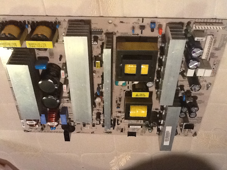

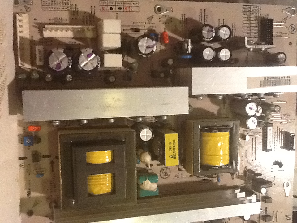

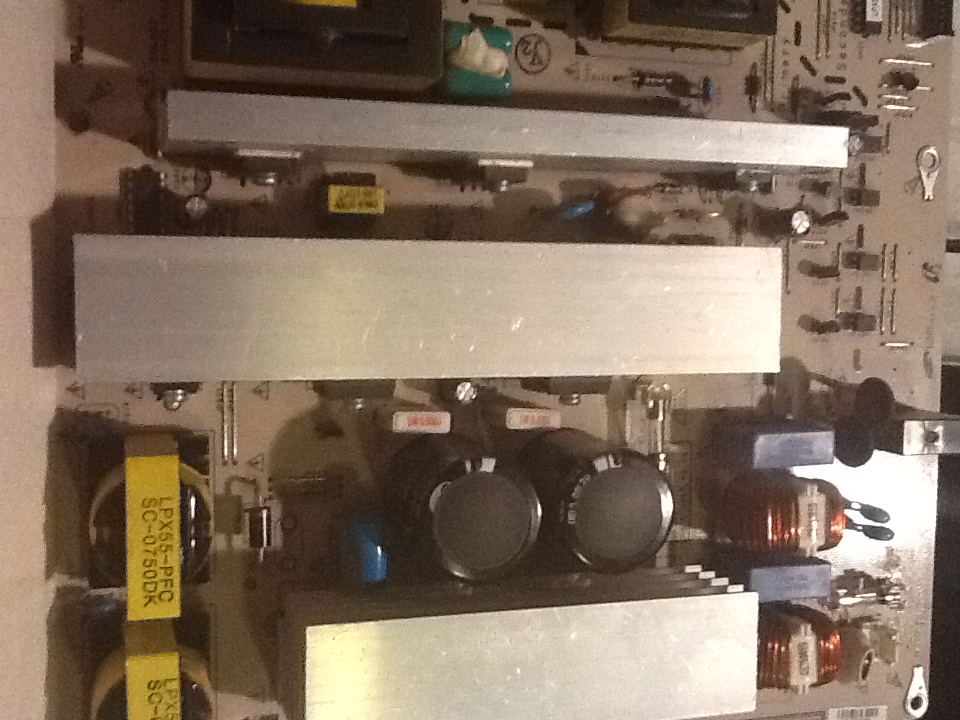

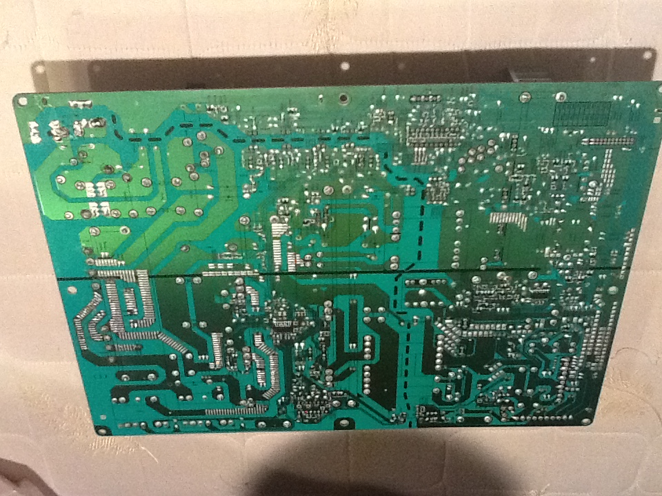

    so my tv mad a pop noise when watching it and completely lost power.so i opend it up and noticed sum capacitors buldging with burn marks on the top so i replaced them and a fuse that had no continuity so i replaced it.put every thing back together pluged it in and the fuse i replaced pop again but the capacitors were fine. so today i replaced the fuse again and unpluged every thing from the power board and pluged it in again and the same fuse poped.the model of the power board is LPX55 and the fuse is labeld 250 VOLT T5AH.PLEASE ANY HELP WOULD BE GREAT....THNKS.....

    Hi Daryck88,
    The Fuse normally blows when something has failed. If it keeps blowing then its definitely something other than your capacitors that are at fault.
    To help you out we would need some pictures of the back of your tv and then some pictures or the top and bottom of your power supply. These need to be really clear so that we can see traces and wording.
    Do you have a Mulitmeter also?

          Hi pictures are not really clear enough - they need to look like this
          https://www.badcaps.net/forum/attach...1&d=1290283049
          If necessary take the board outside or near a window - plenty light but no flash or
          glare is the answer.
          When you say you replaced the caps what make are the new ones? are they the same
          values as those removed? are you sure you put them in the right way round?
          Hopefully the board was not on a conductive surface when you re tested.
          Can you test the Bridge rectifier see Youtube http://www.youtube.com/watch?v=dqkT6hF0O3E

            Re: lg model 50pg20ua no power at all
            When the fuse blows on the input voltage (120vac) you need to go after the bridge rectifier (as said above) and mostly the mosfets that are directly after it or a shorted transformer.
            You will find on the primary side of the power supply these will short (on) and thus making a direct short and popping the fuse.
