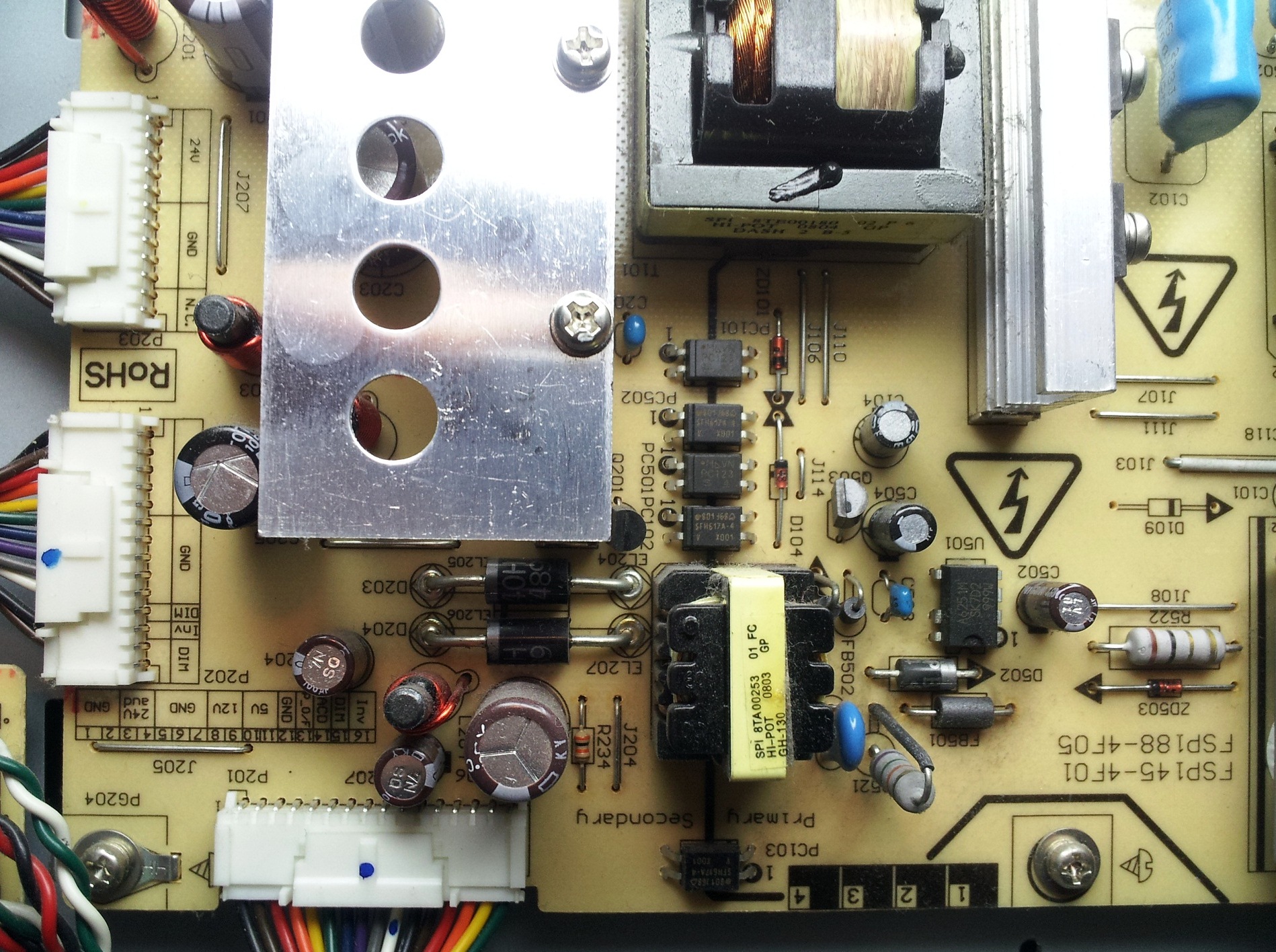

      I will take some pictures, you are interested in the main board?

          Main board and power supply.

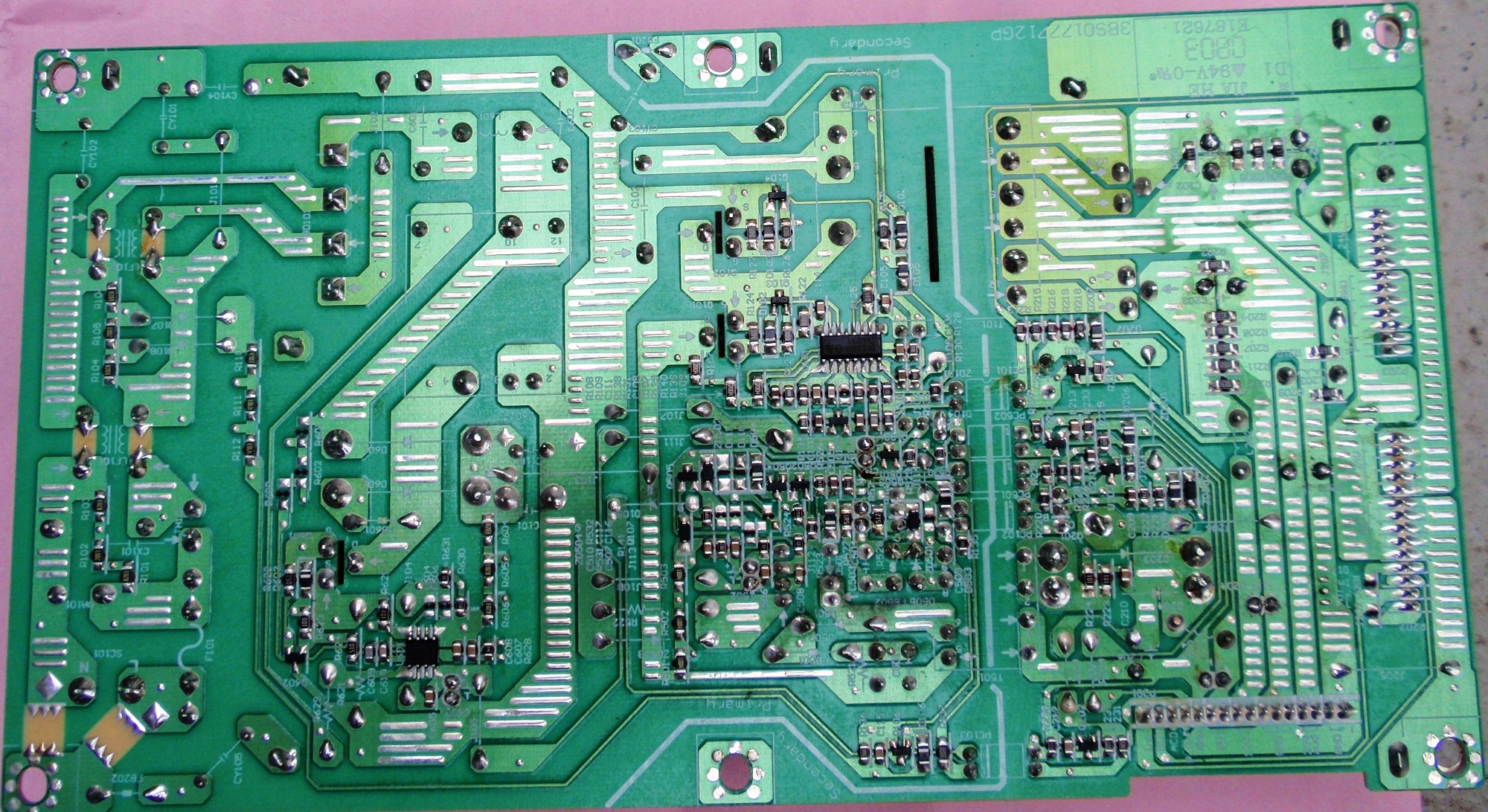

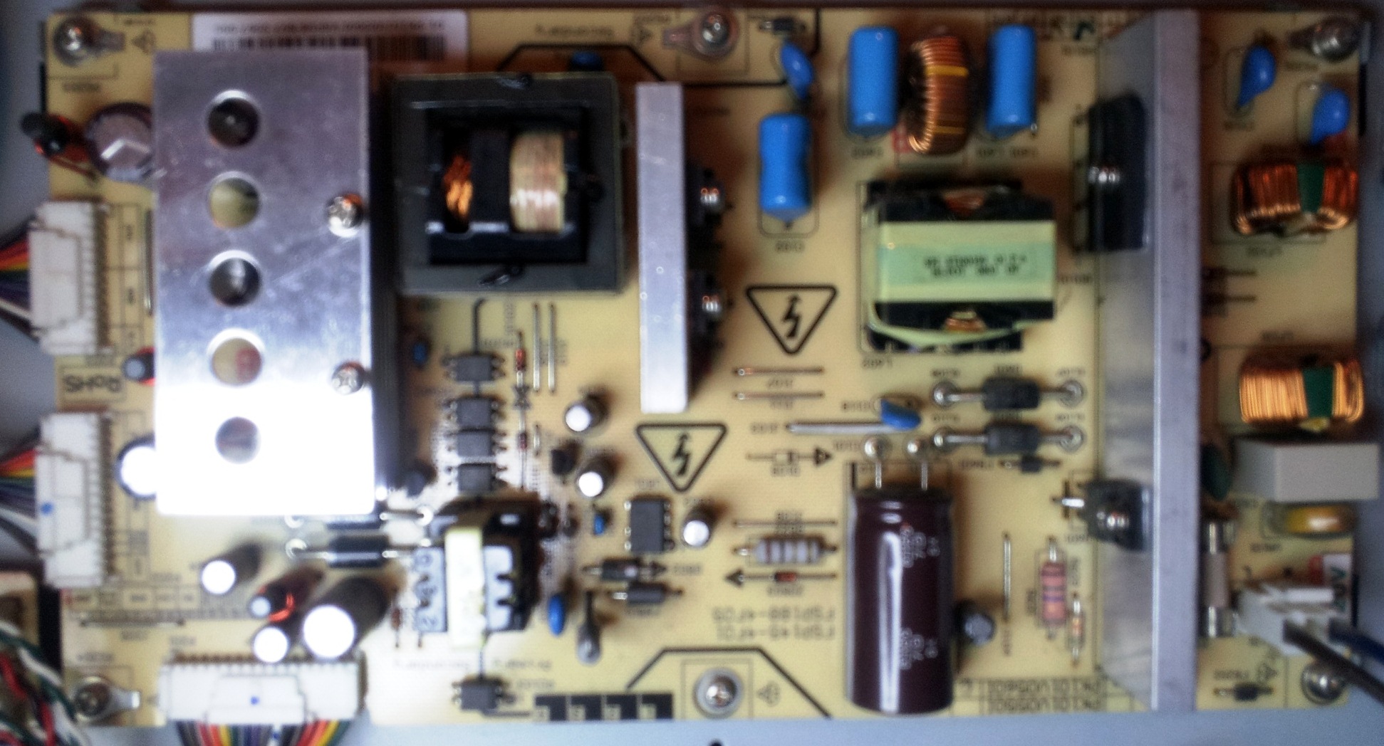

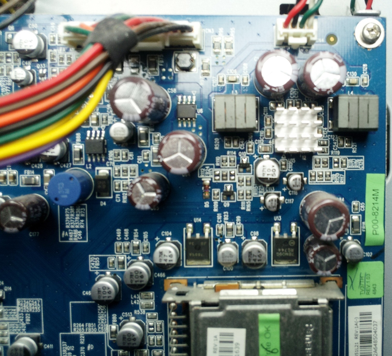

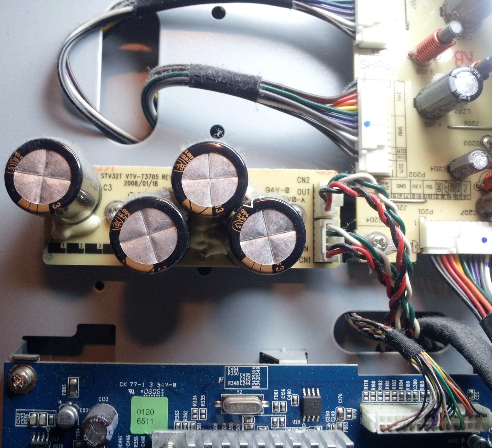

            Re: Atlas 37AV500U popping sound
            Here are the requested pictures:
              So which capacitors would be those?
              Those four capacitors on that small pcb looks like they could be for the audio amplifier. Wires come from main board where the amp is located and from the small board the wires run all the way to both speakers.
                This TV uses Class D power ampliers (two amp in one chip), Do you hear poping sound if you use the audio line out? If you do not, then the problem is in the power amp, or power supply problem as mention by others, if you do hear the popping in the Audio line level output (Red and White RCA audio line out) then the problem is in the preamp section.

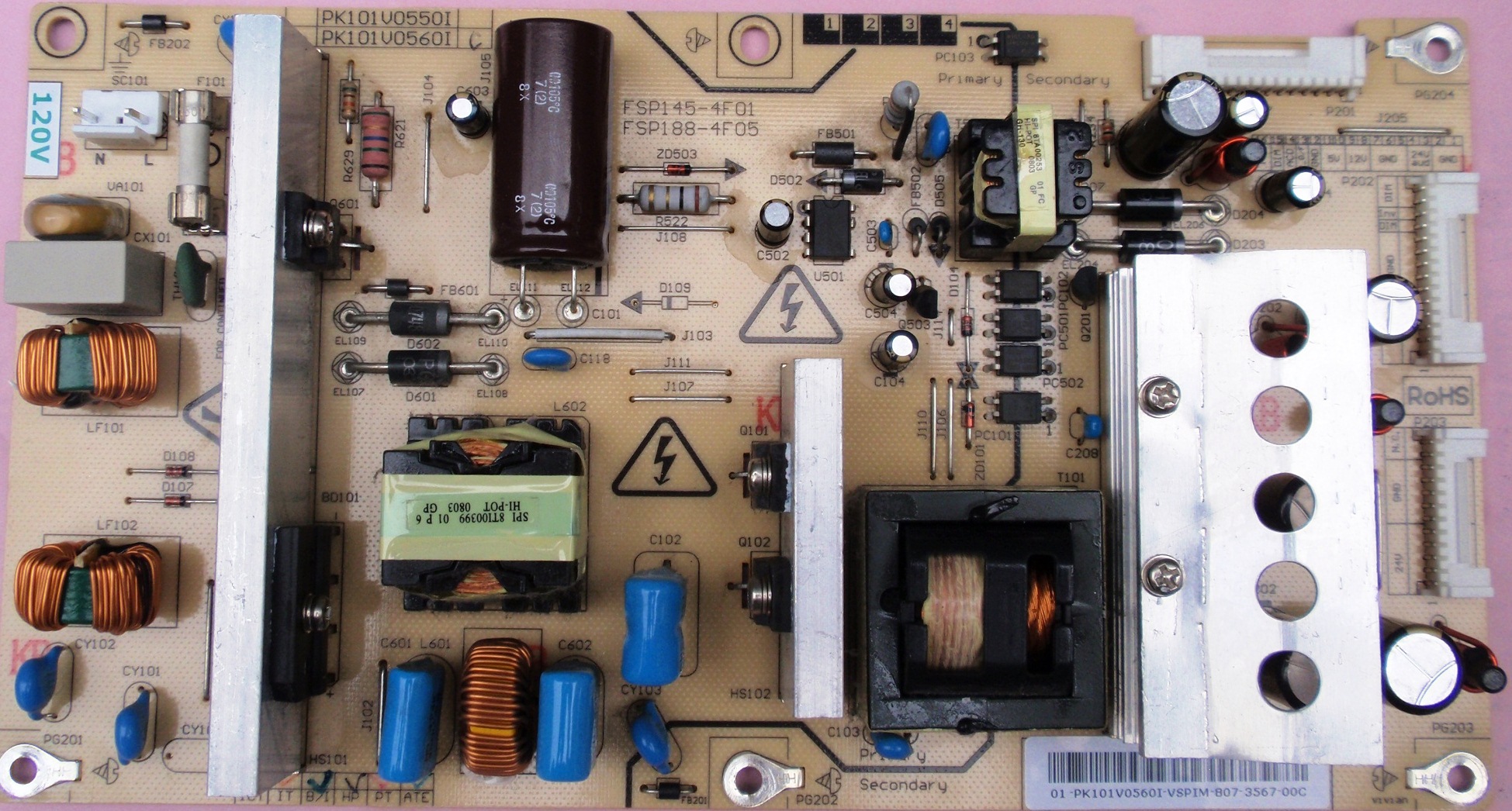

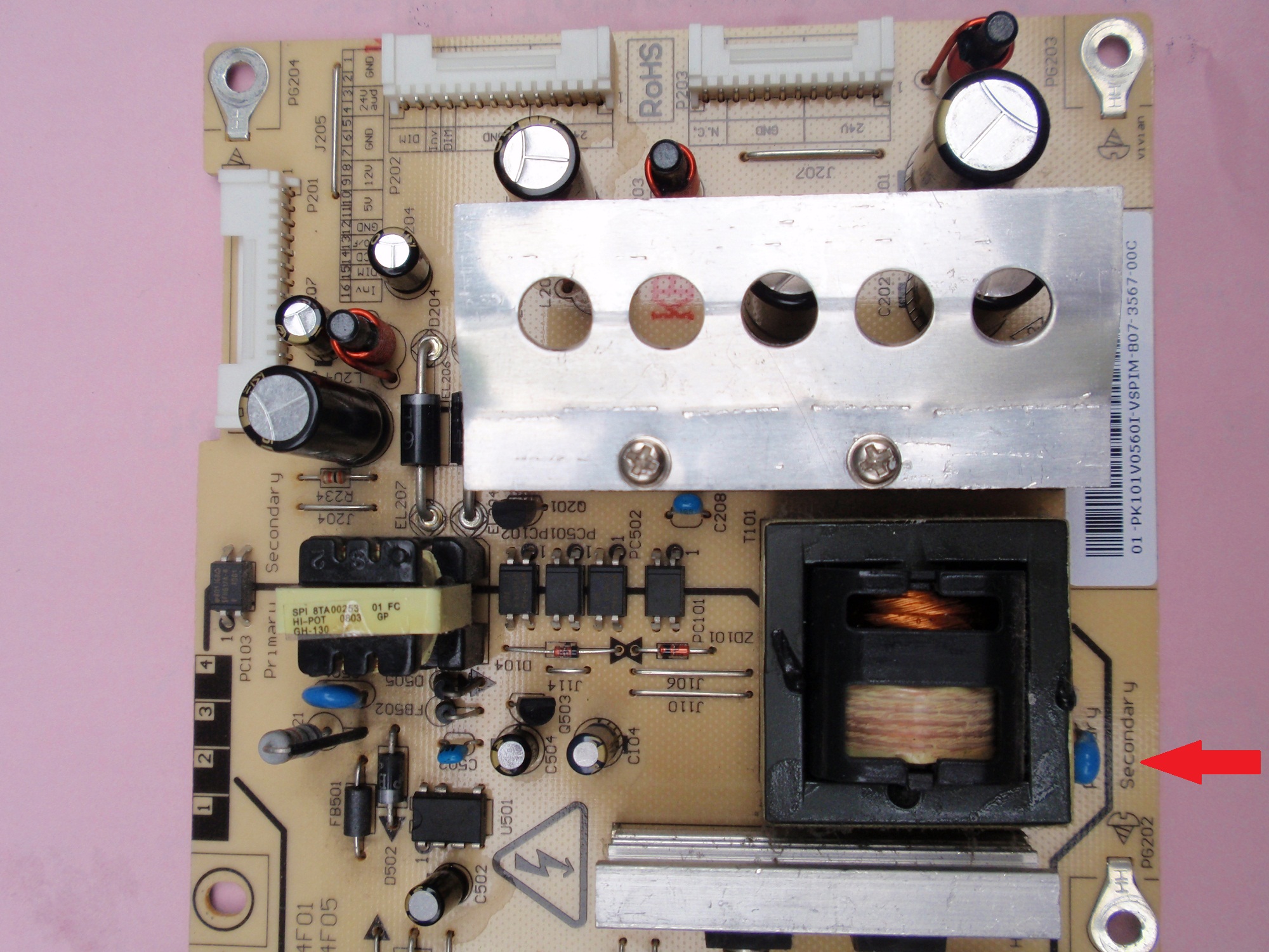

                                sorry about the late reply, but I haven't had time to work on it.
                                it's next to the biggest transformer on the primary side(first picture, above the transformer).
                                So today I have replaced all the electrolytic capacitors on the power supply and on the main board.
                                The popping is still there. It began doing the popping much later, about 7 restarts, previously after the second restart it was popping.
                                So I guess the next step is to replace the blue capacitors. These are ceramic capacitors? Could somebody show me one on digikey? It matters the brand, type?

                                  Where is the cap located?
                                    i"t's next to the biggest transformer on the primary side(first picture, above the transformer)."
                                    I can barely make it out - this picture is useless!

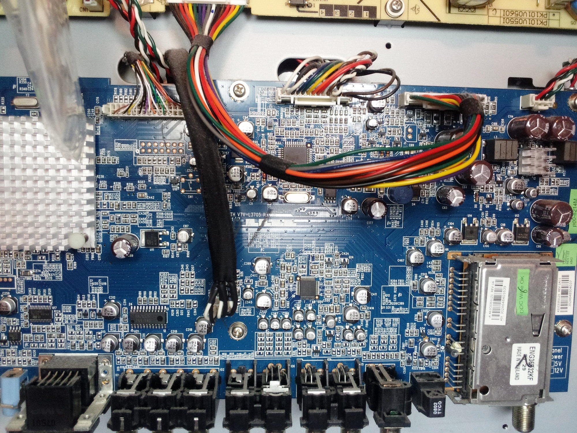

                                      I agree about the quality of the pictures, they were taken with my phone. Sorry about that. I work in my garage and I don't have natural light in there.
                                      I will take some new pictures and more of them in a short while.
                                        here are the pictures:
