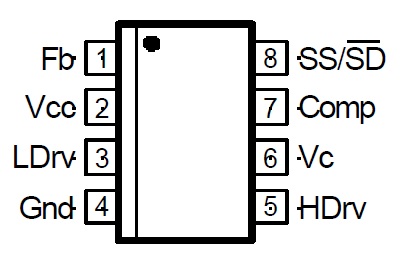

    Measurements on the 3037 chip:
    Fb - 0.67
    Vcc - 4.11
    LDrv - "-0.02"
    Gnd - "-0.02"
    SS/SD - 0.05
    Comp - 0.03
    Vc - 3.56
    HDrv - 0.02
    Refer to the attachment diagram for the PIN layout.

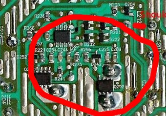

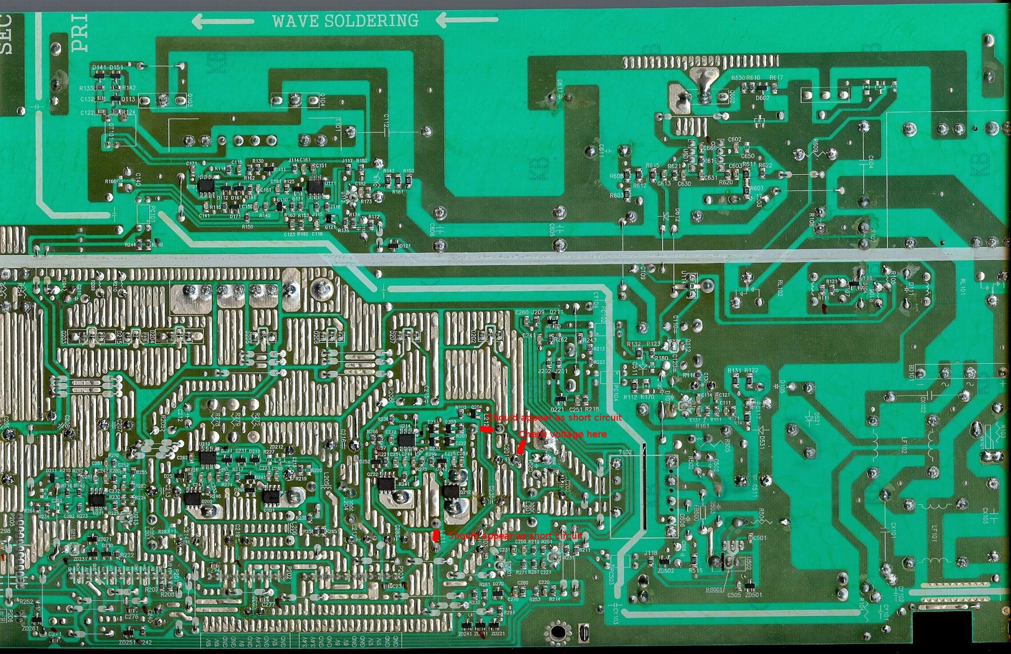

    I also was able to check the voltage in the area you specified earlier. I attached the image again for reference. The area read 5v.
      Re: LG 42LB1DR No Video or Sound
      Vcc is a bit low - should be 4.0 - 4.4V minimum - this could be the problem.
      The feedback voltage is also too low - should measure 1.25V. The feedback is the signal going to the controller IC to tell it if the output voltage is in regulation.
      The fact that both HDrv and LDrv appear low does seem to suggest a problem - however your multimeter may be averaging the pulses these pins should provide.
      I would say replace the controller IC and maybe the two MOSFETs but I'm not entirely sure right now.
        Just noticed: SS / SD
        This pin provides soft-start for the switching regulator. An internal current source charges
        an external capacitor that is connected from this pin to ground which ramps up the output
        of the switching regulator, preventing it from overshooting as well as limiting the input
        current. The converter can be shutdown by pulling this pin below 0.5V.
        As the voltage is below 0.5V this could be your problem. It's definitely not going to help.

          Okay well lets do it and see. Which MOSFET's do you suggest replacing? U202?
            U202 as well as the two MOSFETs - the 8 pin devices that look similar to U202.
              I actually meant D202, and which MOSFETs are 8 pin? I'm not seeing them. Thanks
                These devices
                • IRShifty
                  • May 2009
                  • 78
                  Okay cool. I'm having a hard time finding those MOSFETs, they read 4410n over AA60B. Closest I can find is http://www.ebay.com/itm/5PCs-AO4410-...item3370b287da Can you let me know if you think this part will work or if you can locate a better location to purchase them. Thanks
                    I think eBay is going to be your best shot for these devices, but I'm not certain the MOSFETs are at fault. The 3.4V is definitely your problem. I'm suspecting the controller IC more, so try and replace that too (possibly if you can get that cheaper, try it first.)

                                Hey so I just got the TV working. I purchased 2 MOSFETS to replace the 8pin ones on in the specified area. Replacing these MOSFETS was a pain because even after i melted the solder with my heat gun the MOSFETS would not come off easy because they were held on with some type of adhesive as well. I was able to replace one and while replacing the other i became extremely frustrated and a handful of the CAPS i replaced started falling out do to the lower rosin-core solder becoming fluid. I stopped and did not replace the other MOSFET or the CAPS that fell out. I found a replacement power board listed in working condition on EBAY and was able to buy at my offer of $25 with free shipping. I installed the new board and the TV is now working great. Thank you for all your help and I will still becoming back here first when I have issues. Thanks guys!
