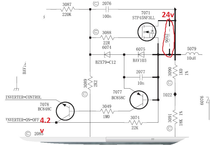

          I found an answer to this,4.2v is required on pin 5 of connector 1089 when the power supply is
          Is plugged into the wall socket. Apparently someone removed jumper 9052 on the power supply.
          Anyway with that jumper replaced I do see the standby voltage of 1.3v on pin 9, and the 24v section comes alive.
          I wonder if there is a problem with the panel and the service tech disabled the power supply to try to make the power supply useless?

            Maybe the jumper is there to allow you to check other parts of the board without the inverters getting power? and they forgot to put it back?
            Fixed so far : 1 Home cinema system, 16 LCD Monitors, 4 LCD TV's
            How to resize your pictures guide click HERE
            Retiredcaps Ideal post example click HERE
              Re: Philips 37MF321D No power no LED
              If the MOSFET 7071 is not installed, then I can see why you have to have jumper installed, if 7071 is on the board, then it means that the Gate is not getting the signal to turn on 7071 which function as a switch, and the jumper is used to force the 24vdc to come on, that way the tech can tell that the 24vdc is OK but the turn on signal for the 7071 is not functioning. It is like having a relay to turn on the light, but you can jump the replay contact and make the light to come on, then you will know that the relay is not working instead of trying to find out if the lamp is good or not. Same principle as applying voltage to the PS_ON pin to force the power supply to come on, if it does, then the power board is OK but the PS_ON is not coming through from the main board.

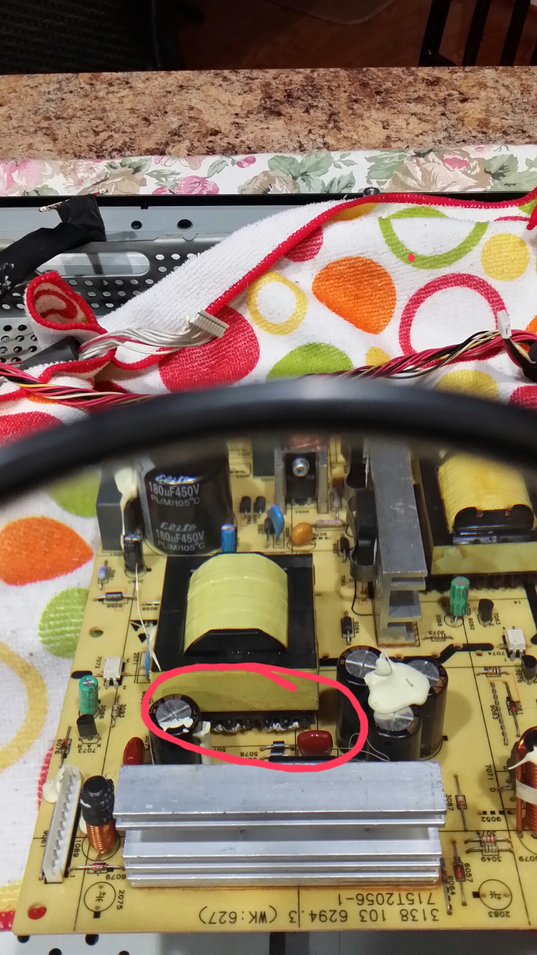

                                  I too do not have voltage on pin 4 and 5. I don't believe there needs to be a jumper at 9052. All my caps do look good but I know just because they look good does not mean they are. One thing I do find odd looking at my PS board is solder built up on these pins. Look normal?
                                  • Horty24
                                    • Oct 2011
                                    • 54
                                    #37

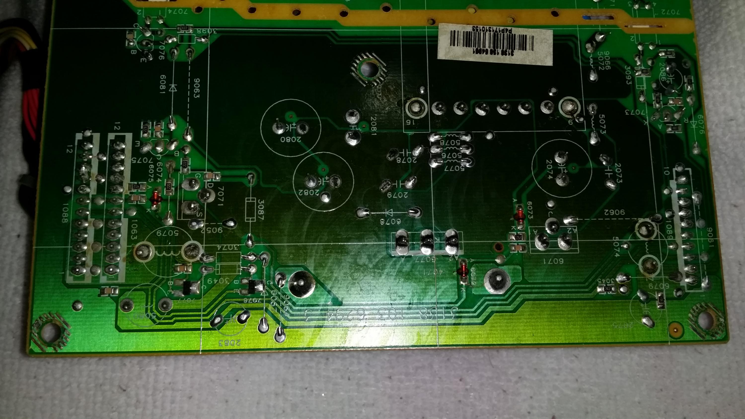

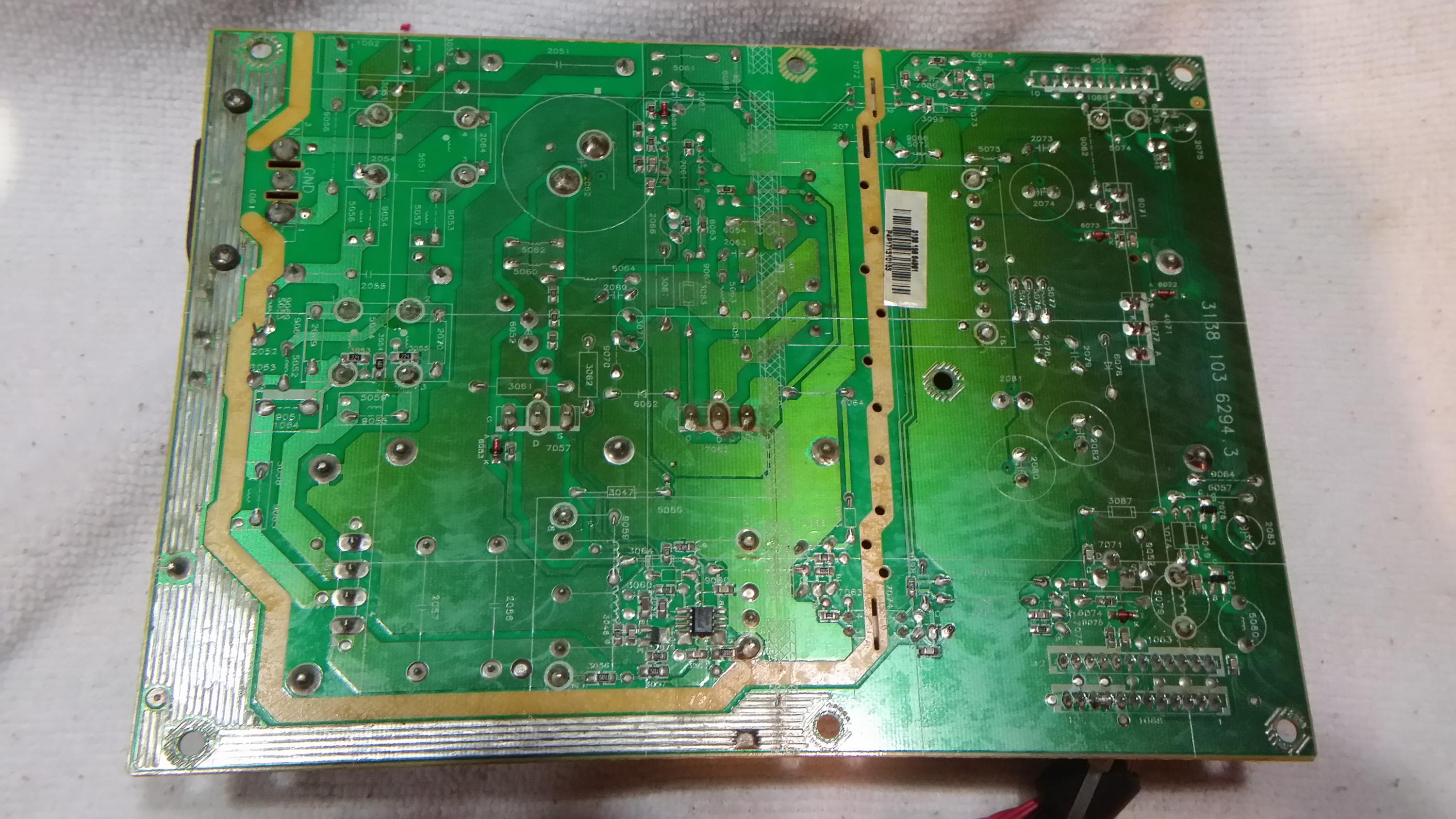

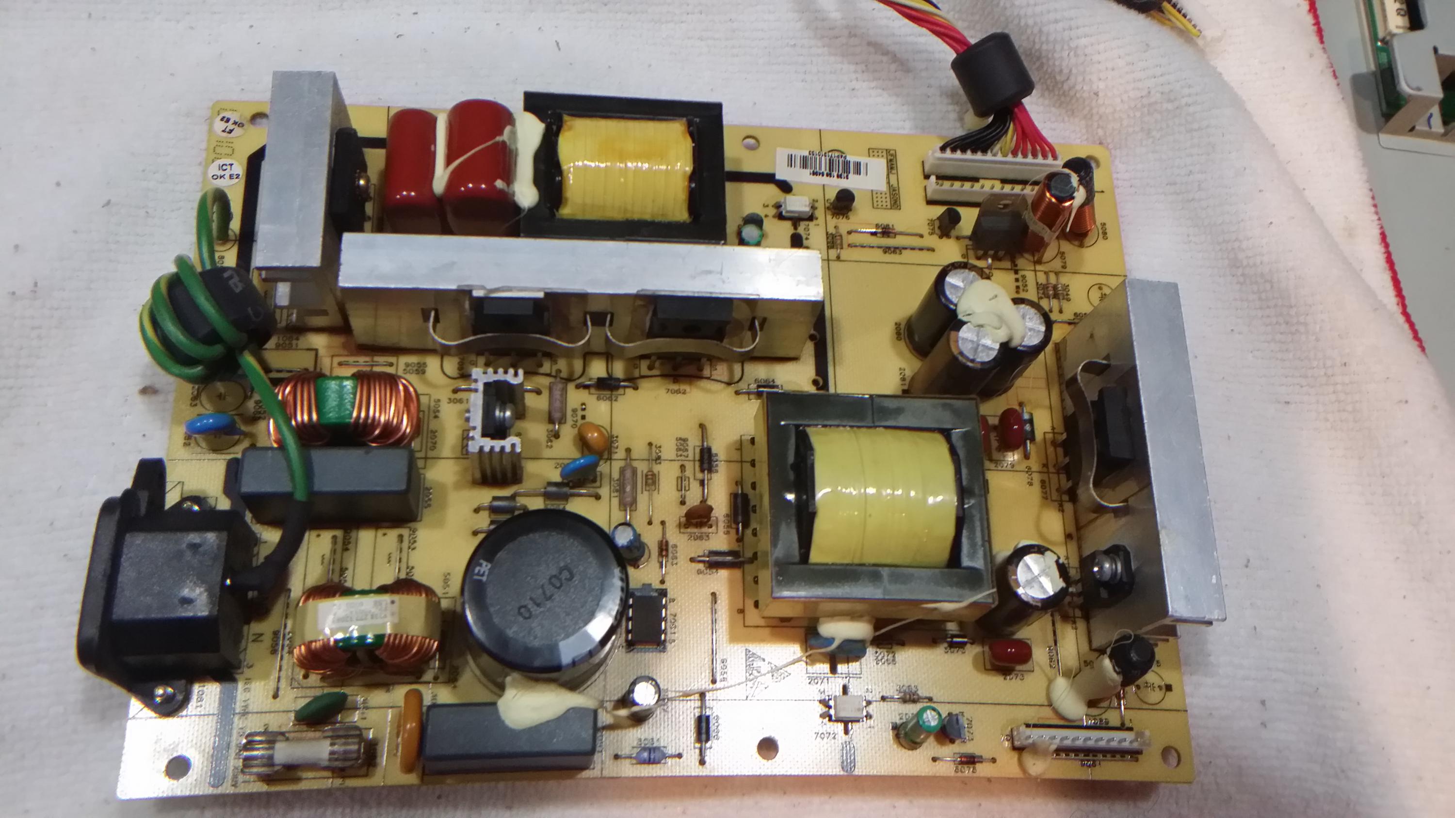

                                    Here are some pics of the PS.
