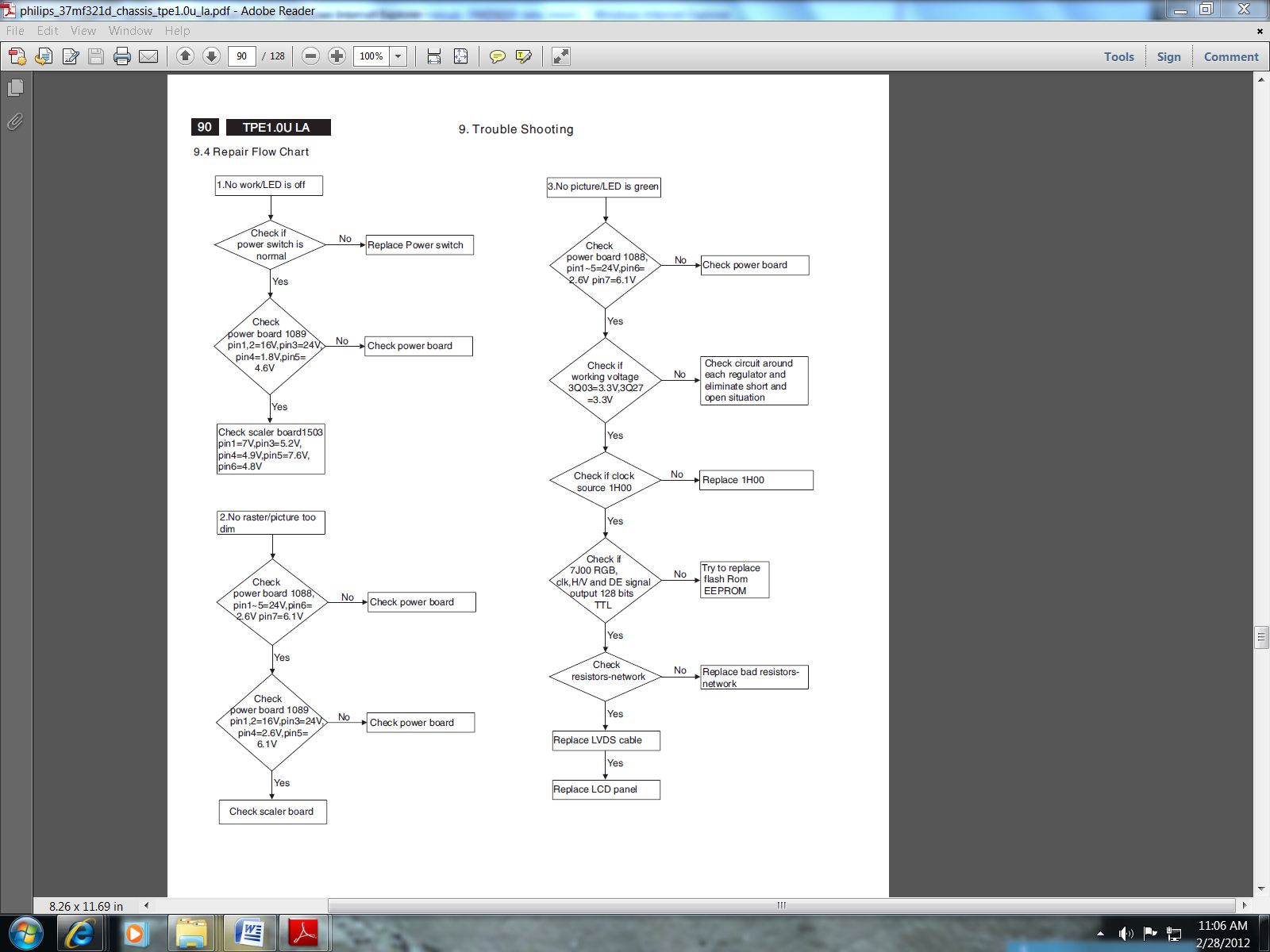

    I am having trouble figuring what is going on with this television.There is no power and no LED
    Following the trouble flow chart has me wondering if it's correct.
    The service manual looks like it's for a 26 and 32” model, with a supplement for the 37 and 42” models. The connectors for the scaler board appear to be different, but the supplement for the 37” power board is correct.
    The service manual is available at Elektro Tanya.
    On connector 1089 I have,
    Pin #1 16v
    Pin#2 16v
    Pin#3 24v
    Pin#4 .8v
    Pin#5 0v
    Pins # 6-7-8 are 0v
    Pin#9 0v and
    Pin#10 is 0V
    Pin # 9 appears to be standby but its not mentioned in the flow chart; I am thinking I should see a voltage on that pin?

    Re: Philips 37MF321D No power no LED
    I looked at the diagram, the STANDBY PIN is the control pin from the Main board that when it goes high (3.3~5vdc) it will turn on the PFC circuits which will kick the voltage on the that large cap (120uf 450vdc) from 170vdc (when it is in standby mode) to about 400vdc when it is in the ON. Since you are not getting the logic high from the main board on pin 9, you should verify the connection back to the main board.

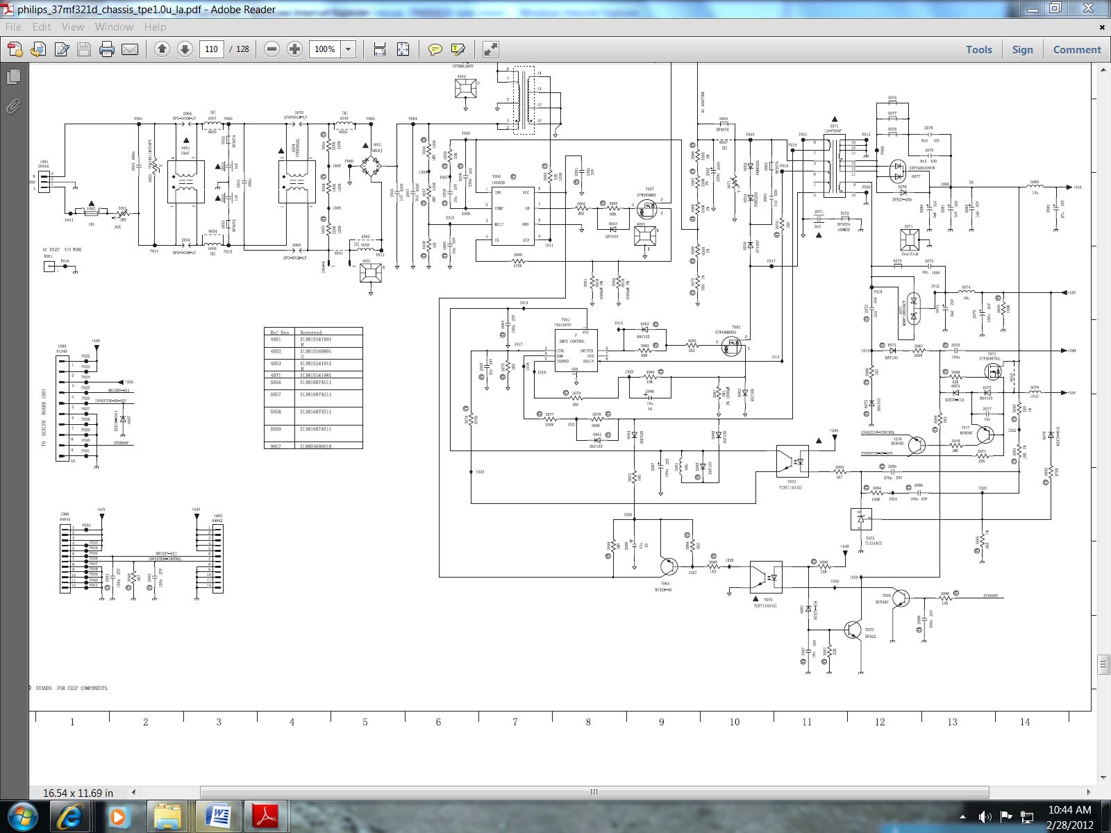

                      In this case, per SCH, the HI signal from main board will turn on Q7076, which will turn on the OPTO, which will turn on Q7063 which will supply the VCC voltage to the PFC Cotroller IC.
                        Here is the SCH of the power supply.
                          I do not notice 5v on any of the connectors on the power supply.
                          Do we want to try to turn on the power supply with applying 3v on the standby pin? And if that doesn’t work try grounding the standby pin?
                            If you've got no standby voltage, then that's the first place to start fixing. The rest of the supply probably won't work without that.
                              There is no 5vdc standby in this power supply, it has the always on 16vdc power supply that feeds the main board, this 16vdc will be used in the stepdown switching power supply circuits (5v, 3.3, 2.2, etc.) in the main board to run the main board , see page 20 of the service manual.

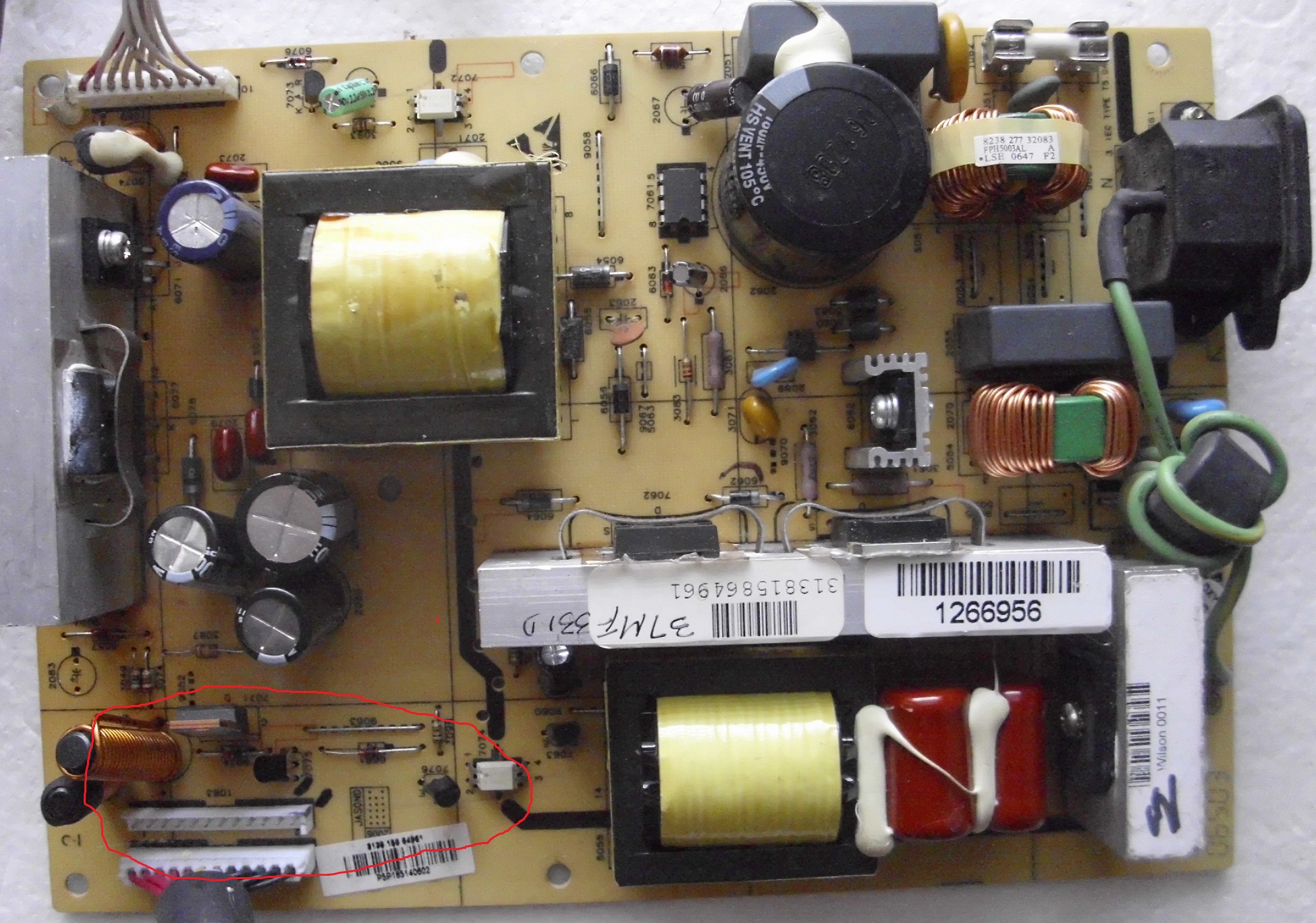

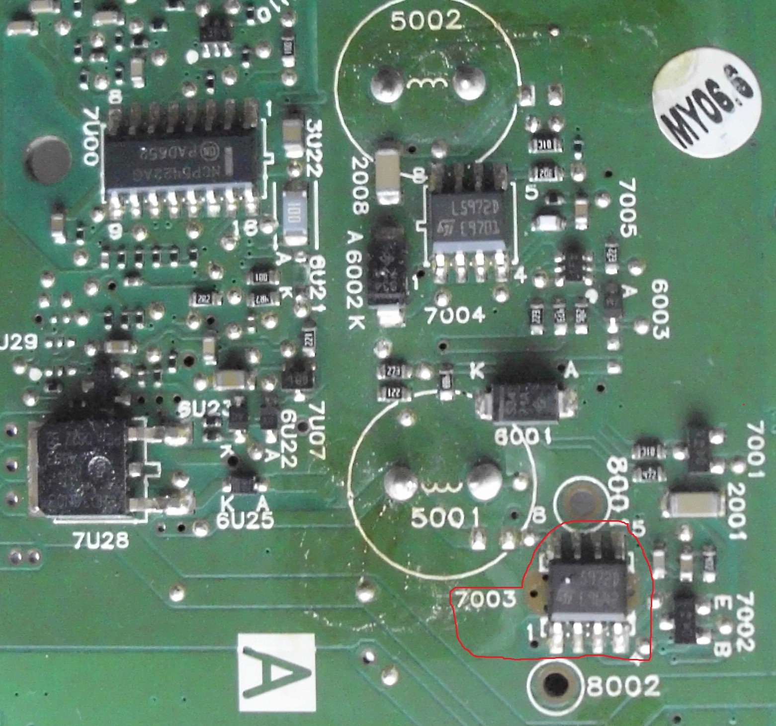

                                    Just an update on this television,
                                    Appling right around 3.3 volts to the stand buy pin causes the other 24 volt portion to come alive.
                                    Checking voltages going to the main board, I am loosing 16 volts to the 3A 1u101 fuse on the main board.
                                    I can trace the path of what should be the 16 volts to the 7003 L5972d switching regulator.
                                    It is easier to see in the photo but it has a very small pin hole in it.
                                    I will let you know what happens when I get the regulator. I am fortunate that it's a good number and Digi- Key has them.
                                    The two pictures Show the 24volt section that comes up with the 3.3 volts applied to the standby pin, and the 8SOIC regulator on the main board.
                                      That is good the 24 PS is OK, and it sounds like you on the right path on the main board to find out you are not getting the PS_ON signal.
