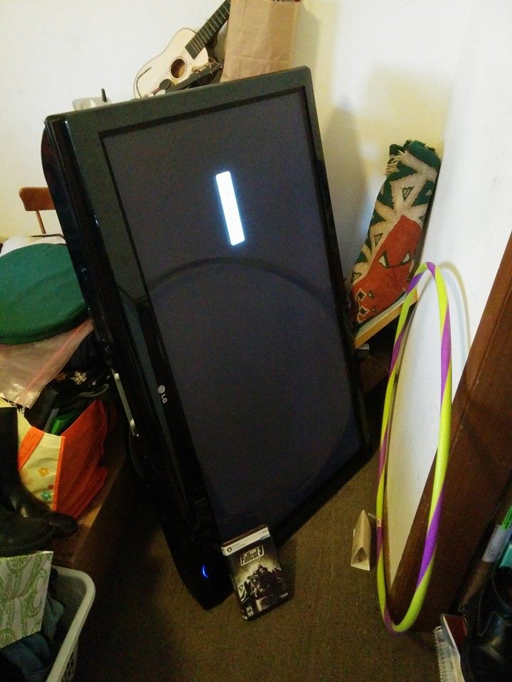

          Alright. So I have to update.
          I continued to fail attempting to repair the board. Even bought one of those "kits" that came with some caps and MOSFETs. No luck.
          All the while it had been experiencing typical and obvious Y/Z failure (unplug one, stays on... etc).
          Finally found a reasonably priced PSU on eBay. It wasn't the exact board model number. Mine was an EAY39190301, and it seems everyone else's 50PG20 has a EAY41360901 (this is what I bought). I took a chance, the price was right, and I dissected the connections of each board and concluded they (the boards,) function the same but have a different layout (components) (but: all pinouts matched, connectors looked to fit, etc).
          "Whatever, I'll give it a shot."
          Board came in the mail a few days ago, and I installed it this afternoon.
          Works perfect.
          [see attachment]
          This is the corner it sat in for the past couple years.
          Pardon the poor picture, but that's the "NO SIGNAL" bar on the screen (which bounces around). It even picked up a local digital channel (no antenna connected) occasionally and the picture looked great.
          DISCLAIMER THOUGH!----:
          I don't want this to sound like my "obvious" sustain board problems were wrong and are normally wrong. My board replacement worked, I believe, because I was quite sure that was the issue in the first place when I first got the unit. My repairs were not successful on the original power board (heck, I know I broke it even further at some point).
          I took a chance, an educated guess, and won. When I first got the TV, right when I got it and before I attempted repairs, it had textbook power supply failure, and kept blowing fuses.
          I feel that if the "kits" were available as readily as they are now, I would have snagged a kit and fixed it first-try.
