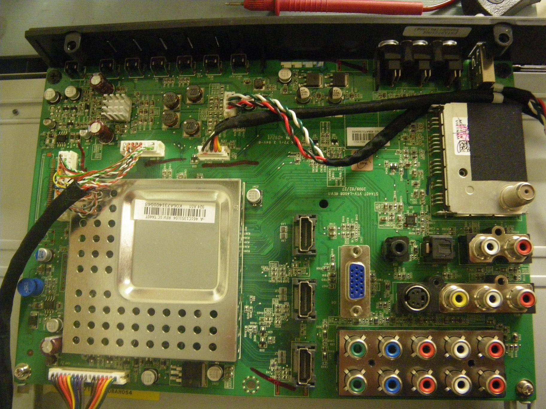

            Hi pictures would be good- there is currently a lengthy thread on the go for a 40RV525U I can find the difference on specs other than the weight & vesa holes if they use the same boards we would then have two to compare/contrast.
            • Bmellero
              • Feb 2012
              • 4
              • usa
              Re: Toshiba 40RV525R service manual?
              Thanks. I will upload some pictures of the boards and report the test results in my next post. PFC stands for power factor correction, right?

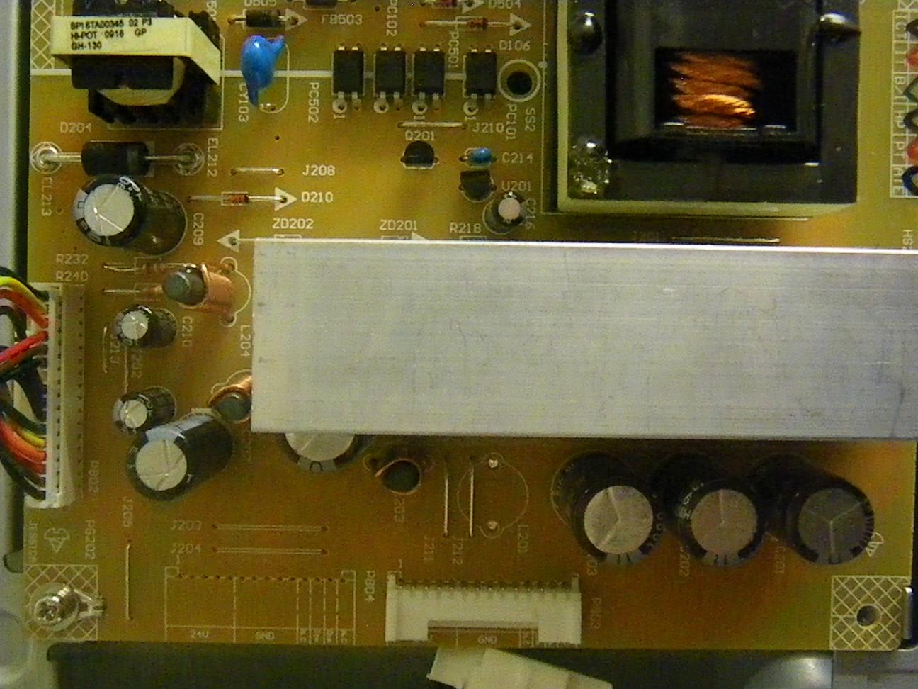

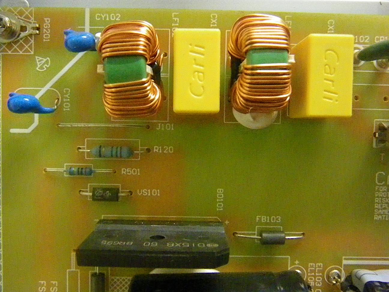

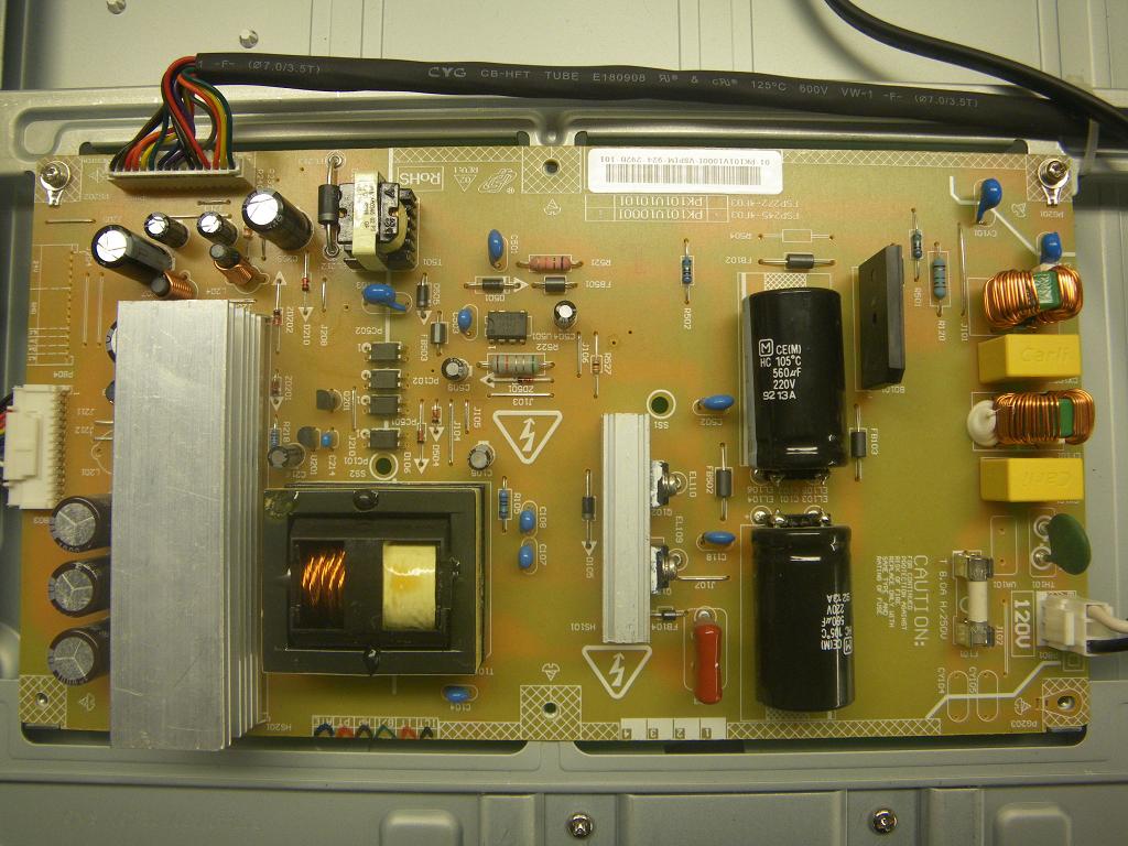

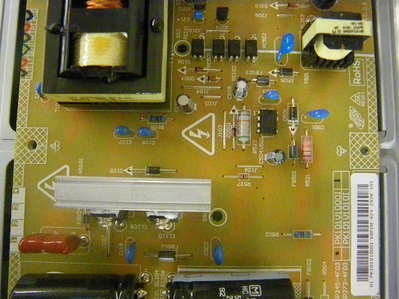

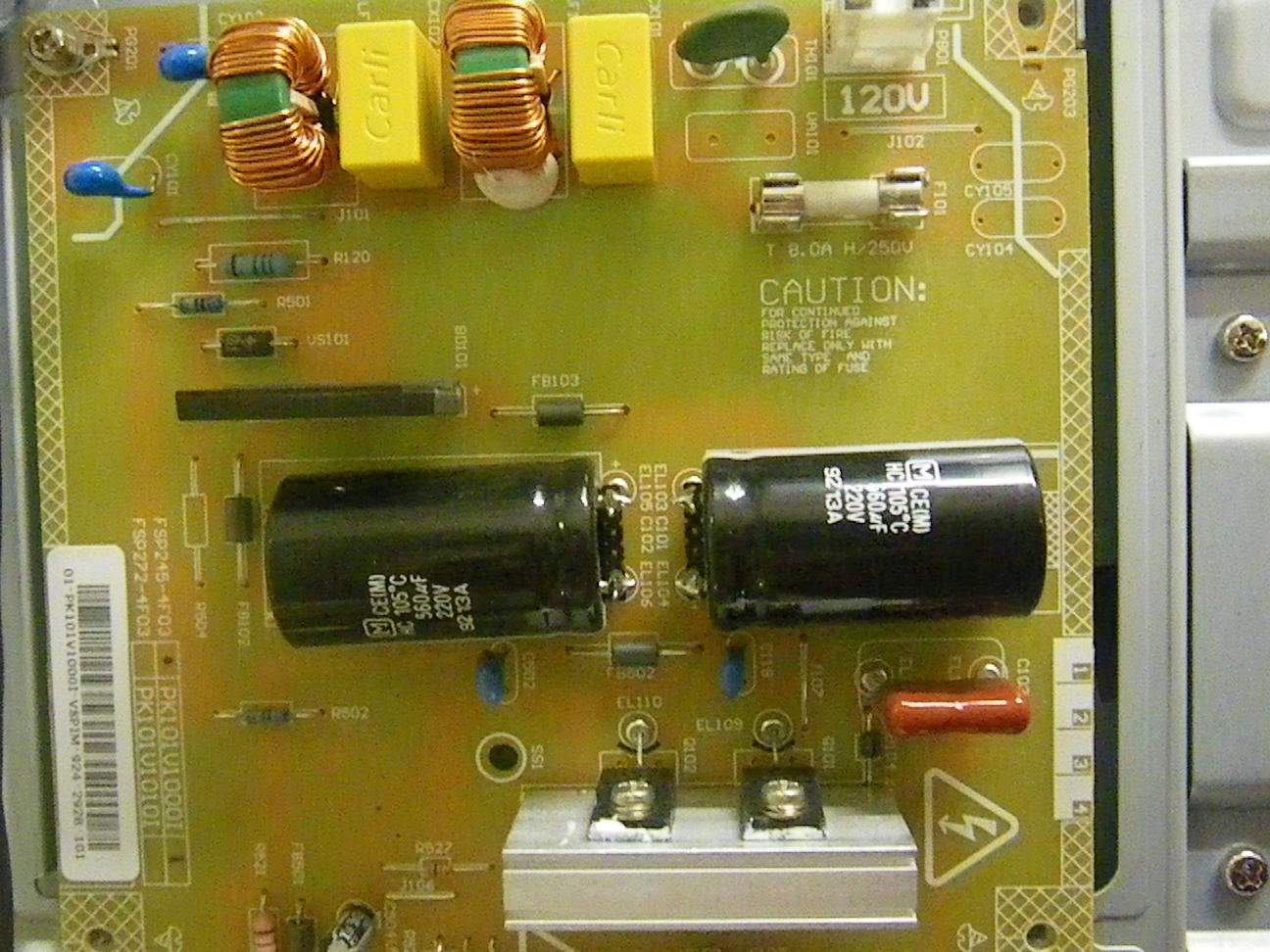

                  I measured the line voltage across both of the large caps on the power board and get 166Vdc over each one. Switching the Pwr signal via the power button has no effect on boosting the line voltage up to 375-440V even though the Pwr signal high is 3.6V and low is 50mV when I do this.
                  As PlainBill suggested, I will disconnect the mainboard and do the same test with the 2k-3k resistor between Pwr and 5v and then between Pwr and Gnd. I am not to sure what the purpose of this test is. Could someone please explain?
                  I have included photos in this post, mainly of the power board. Please let me know if I should add more.

                    There are several reasons for the 'No main supply output' fault. One is an excessive load on either the main board or the inverter. By disconnecting those loads and turning the main supply via the resistor we can determine if the failure is on the power supply or an external board.
                    IF the failure is on the power supply it is helpful to know if the fault is on the 'hot' or 'cold' side of the board. If the PFC kicks in and boosts the voltage across the caps we can be sure the 'on' signal is being coupled across the boundary. Unfortunately, this power supply does not have a PFC front end, so that clue isn't available.
                    We will need a single high resolution (close to, but not over 2000 pixels on a side) picture of the bottom of the power supply if the resistor test does not turn on the main supply.
                    PlainBill
                      If it helps, I believe this power supply uses the two caps as a voltage doubler to generate around 325V in for a 115V AC input (162Vpk). ComputerGeek has a similar problem with a similar supply.

                          I can tell from the picture that this power supply does not have PFC Voltage booster circuits, there is a small transformer on the top left for the standby PS, the large transformer on the bottom will more likely be for the 12v/24v power supply. and two common mode chokes for input line filter Since you supply the PC_ON and it still does not turn on the 12v/24v section, then we will need good clear pictures of the bottom side of the board, take a lot of closed up in MACRO mode will be good. i would wok on the board by itself and you can use lamps for load.
