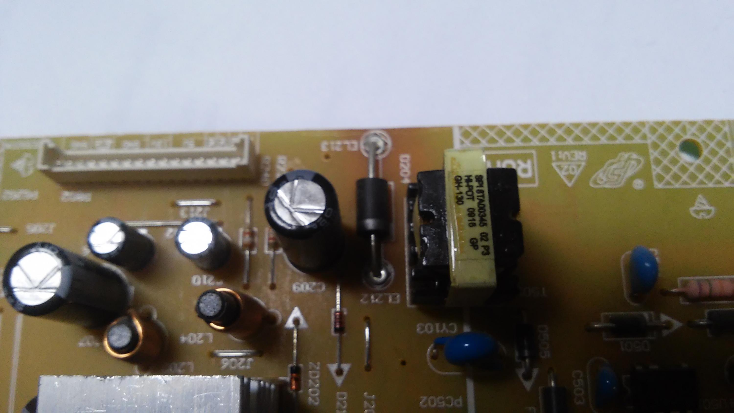

                  Thank you so much. I am attempting to repair a Toshiba 40RV525R, so I'm hoping this service manual applies to this TV. All I have is a multimeter, this manual, and some rudimentary skills as a computer technician (not much in the way of electrical work). So, every piece of information helps.
                  EDIT: Of course, right after I finally see your service manual I finally find a service manual for the 40RV525R. This manual also applies to the 32RV525RZ, 37RV52R, 37RV52RZ, 37RV525RZ, 40RV52R, 40RV52RZ, 40RV525R, 40RV525RZ, 46RV525R, 46RV525RZ.

                    Same model. Same problem.
                    Limited skills. Harbor freight multimeter.
                    Pin readouts on PS at P802 expected and (actual)
                    1. Gnd
                    2. Gnd
                    3. 24V Aud> (no reading)
                    4. 24V Aud> (no reading)
                    5. Gnd
                    6. Gnd
                    7. Gnd
                    8. 12 V> (no reading)
                    9. 12V (Panel Pwr.)> (no reading)
                    10. 5V>** (no wire in connector but 5V without connector in place) ** indicates standby
                    11. 5V>** (5V)
                    12. 5V>** (5V)
                    13. Pwr. On (Enable) 4.0V< (.07)
                    14. AC Det (PWR Good) .07V> (5 V without connector - .04V with connector)
                    15. Dim 1.3 to 3.3V< (.02V)
                    16. BL On 5V< (.01V)
                    There is signs of burning at D204 between E212-213 on PS board right of the connector black with silver band in attached photo above on page 1. I don't think I have attachment privileges yet.

                      used the diagnostic flow diagram in the manual linked above and it points to "problem with the SYSCON circuit on the main board"... whatever that is.
                      The main board is priced in the $70-80 range which might mean this 9 year old tv is heading for the heap?

                        Disconnected Pwr board to main and inverter boards and applied AC. I used a small wire and shorted pin #12>5V to pin #13 Pwr On (enable) and now I get 16V where 24V is expected and 7V where 12V is expected.
                        Any suggestions appreciated.
