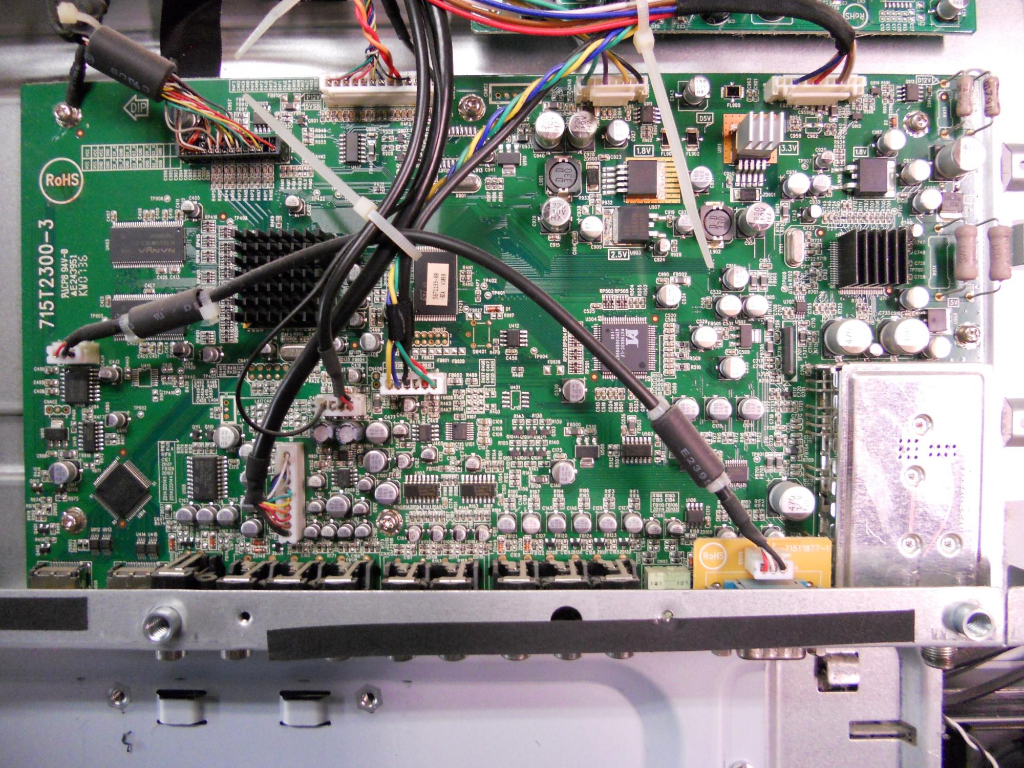

    I have a digital multimeter, and am ready to check whatever that you tell me. Keep in mind that I have very little knowlege of electronics but am willing to learn. I've enclosed some photos of the boards.

    Are there any markings on the cable going from the PSU to the main board?
    If so, check the voltages on the pins match these markings.
    I notice one Rubycon cap and a few Chemicons - did you replace these or did someone else? (Or are they factory originals?? That would be very surprising...)

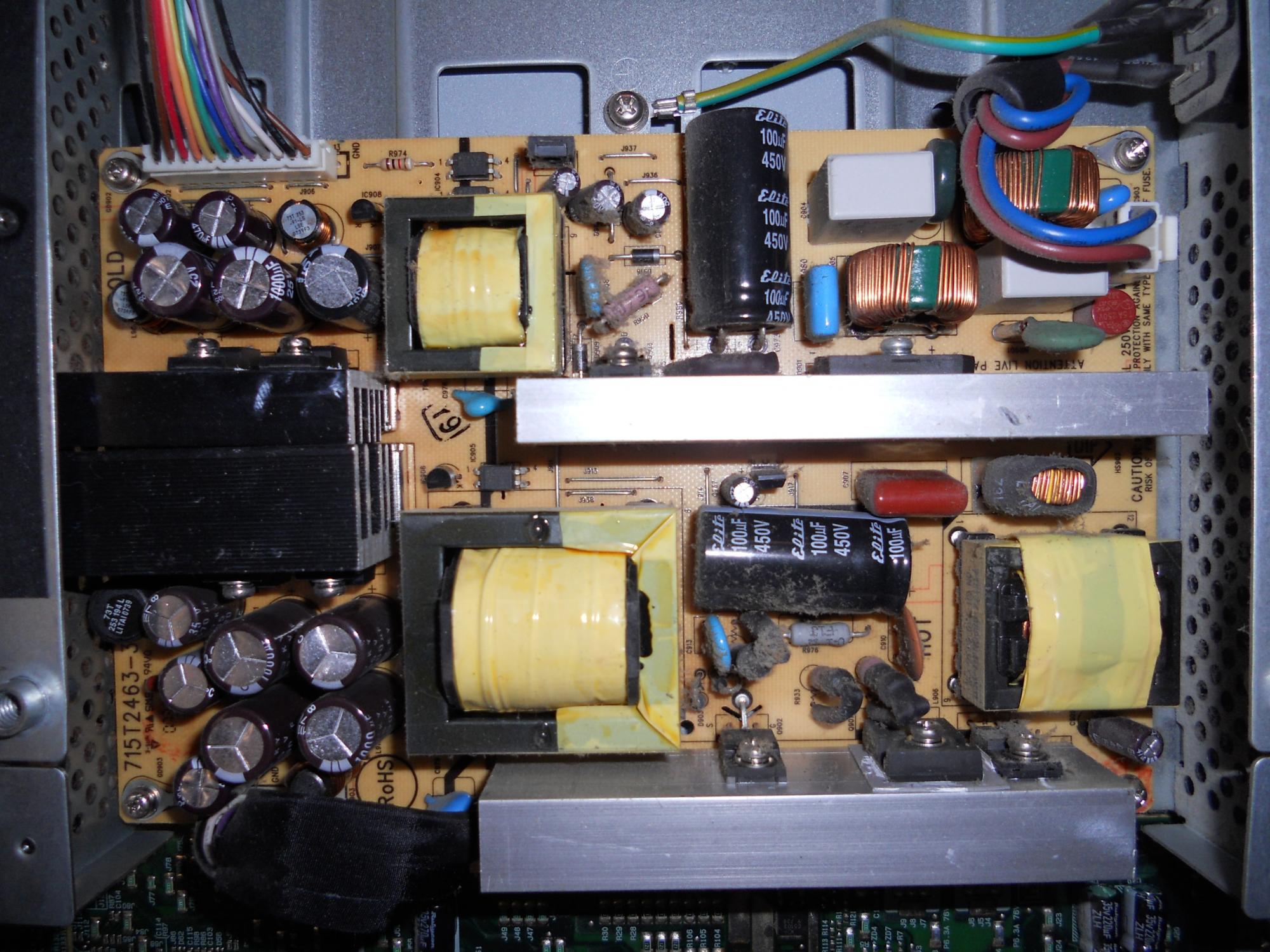

      I did check those voltages on that side of the PSU, and here is what I got:
      Red and Orange both have 13.2v, and were marked 12v on the board. Yellow and Green both have 5.1v and are marked as 5v on the board. The only other marking was what looked like 1 15v. Not sure if that was supposed to be 1v and 15 v, or what. But neither wire had anything. These wires are going to that small rectangle board. There were 3 wires with no markings on the board but had current. White 2.7, Black 4.0, and Brown 3.1. These were going to the main board.
      And all of these readings were with the green power light on.
      I also checked the other output on the PSU and got nothing except .1 on the wire marked dim on the board.

          The 12V lines measured 13.2V? That's rather high... Something doesn't seem right. Where were you measuring ground?
            Re: Dynex DX-LCD32, with no power
            At the chassis ground screw.
              Even using the wire in that plug that is labeled GND, I still get 13.2 on those wires.

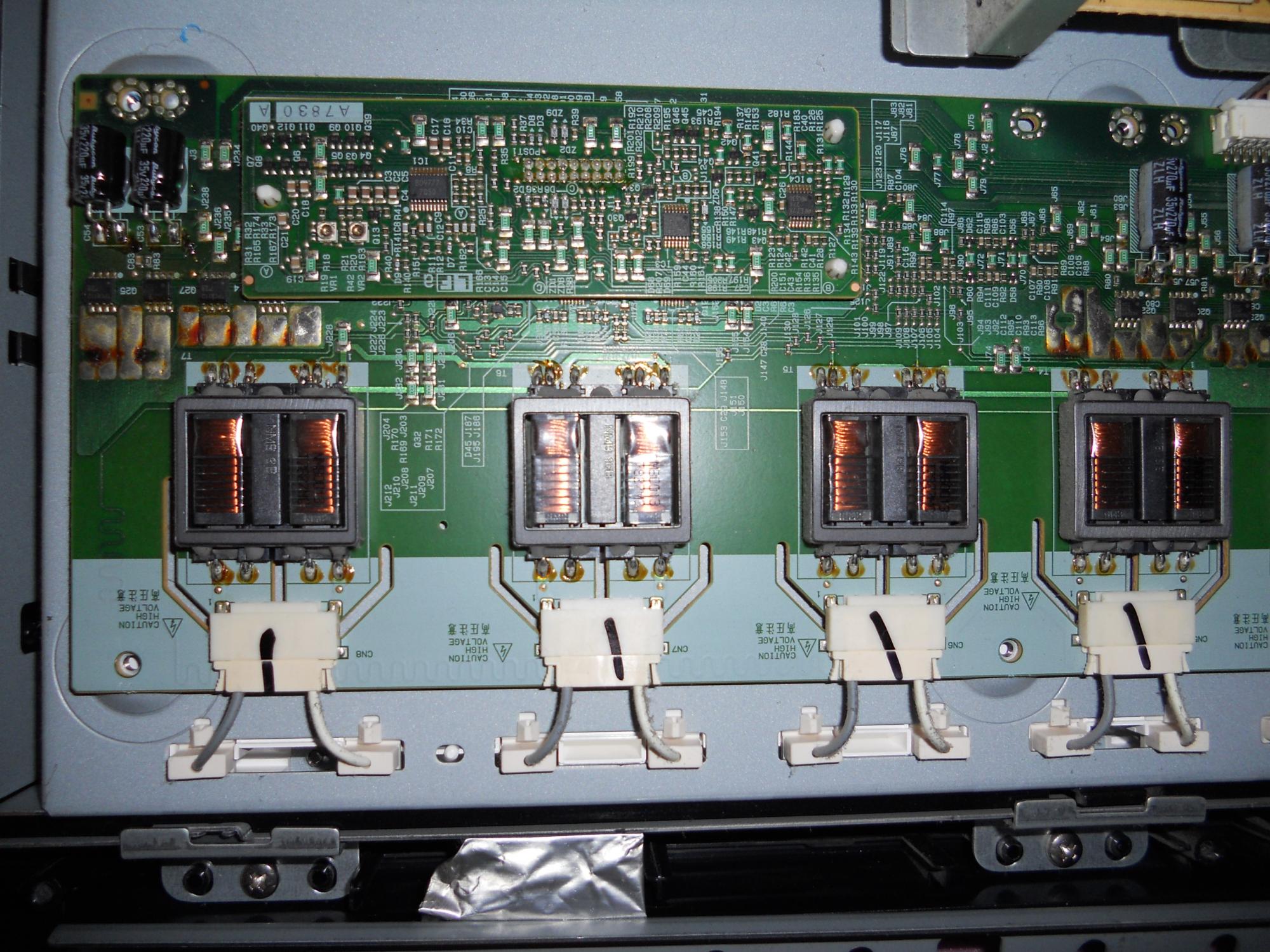

                                Can you please take good clear pictures of the the whole chassis so we may be we will be able to see how it is wired up? We also need to see the third connector on the power supply board which I think it goes to the Inverter board, back side pictures of the power supply, closed up pictures of the inverter multi-pin connector, LCD panel make, model, revision number so we can look up the spec of the LCD panel which will show the T-CON and inveter board pin out of the connectors, etc.
                                By the way, do you get sound?, also try turning it on without the inverter board discoonected from the power supply board.

                                    Looking at your picture of the power supply, I think this is what it has on it, see PDF. Right now the standby PS seems to be working (this power supply is running 24/7).
                                      All of your assumptions are correct about where the wires are going. And I checked the voltage on the cap, and they fell right in line with where you said that it would.

                                        So if I am right, right now you do not have the 24vdc feeding the Inverter board, yes/no? If not, disconnect the cable to the inverter board an see if the 24vdc comes back since if the 24vdc PS circuits sensing over current draw, it will go into shutdown mode.
                                        Another reason you do have 23vdc can be due to 24vdc circuits itself, or it is not getting the command from the main board to turn it on.
