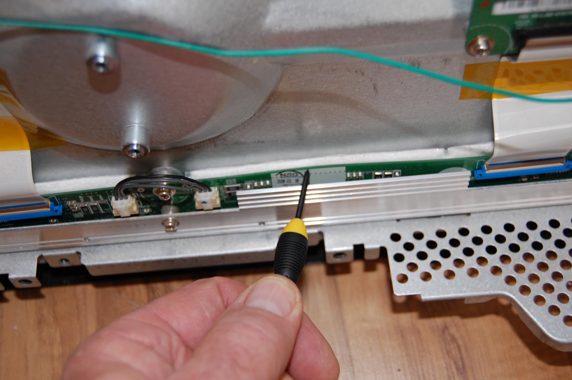

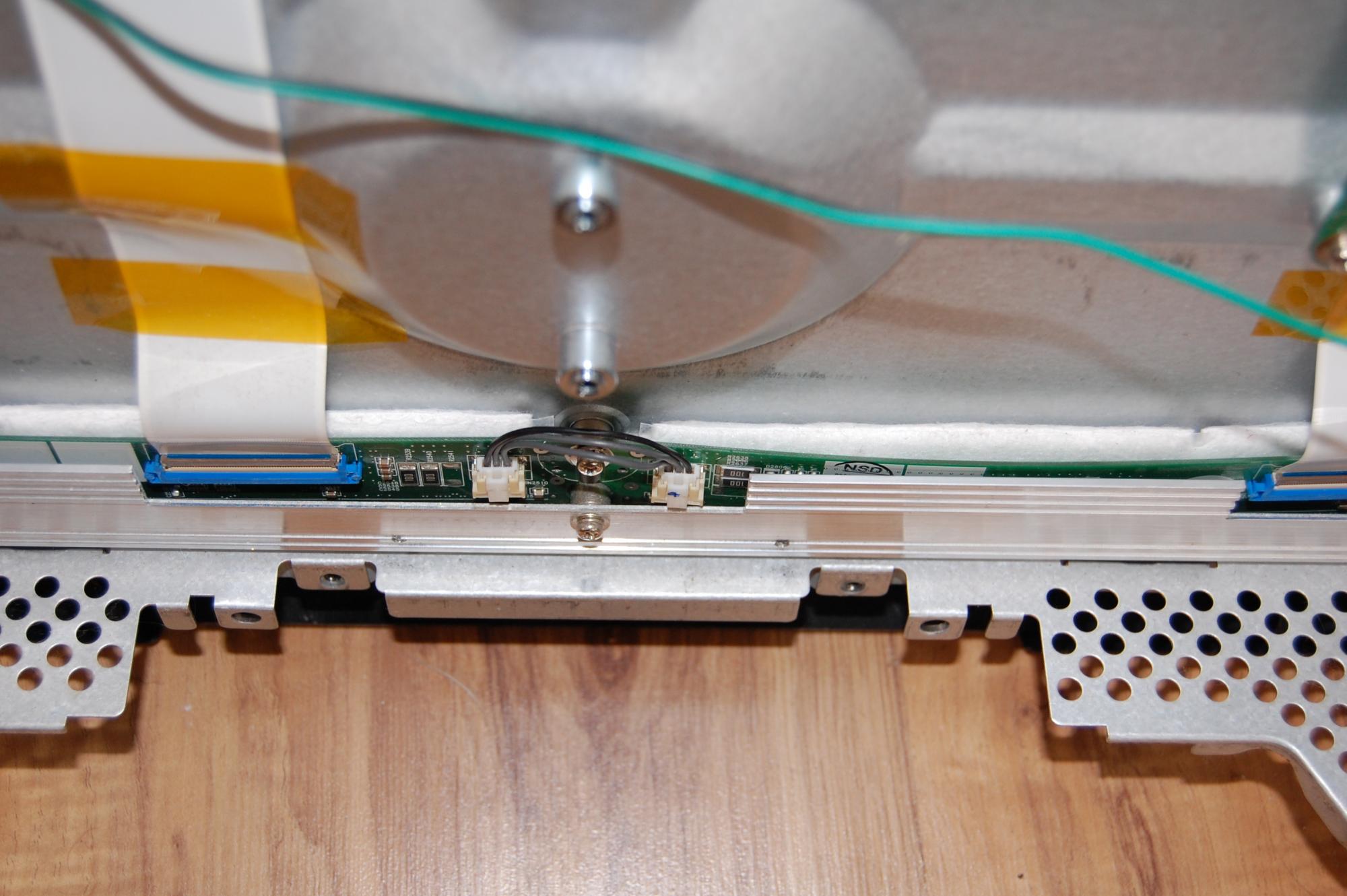

                                Well, you are correct, the E and F buffers are permanently attached. I removed the aluminum shield to have a close look but I couldn't see any evidence of failure.
                                One think you may help with - I have been unable to find the test point for the Vsc voltage (-190v). I did find the pot that adjusts the voltage but no pin or solder pad.
                                There is a resistor adjacent mounted vertically on the Y board that has "vscan" silkscreened next to it.
                                Peter

                                  You need to measure Vscan across both ends of the resistor.
                                  Show a picture of the damage it MAY be repairable.

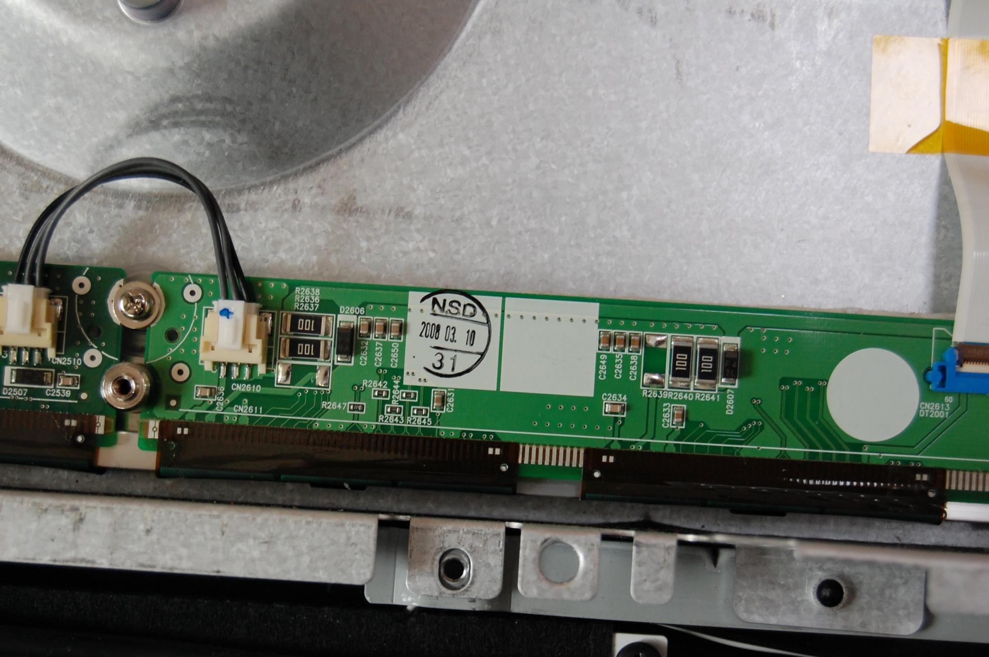

                                      Here is a picture of the suspect area of the F buffer, with the aluminum shield removed.
                                      No apparent damage-arcing etc.
                                      Vsc measured -190vdc, normal.
                                      So- I may resolve to remove all the boards in sequence and look for a dry joint.
                                      If this were a hifi project I would be tracing the signal circuits rather than power circuits.
                                      Is it worth checking all the video signal ribbons for continuity?
                                      Peter

                                          Re: Samsung 50" plasma blank screen
                                          Peter
                                          Checking for continuity could be useful. If you do hifi do you have a scope? Even a basic 20 MHz one can "see" if the waveforms are there or not.
