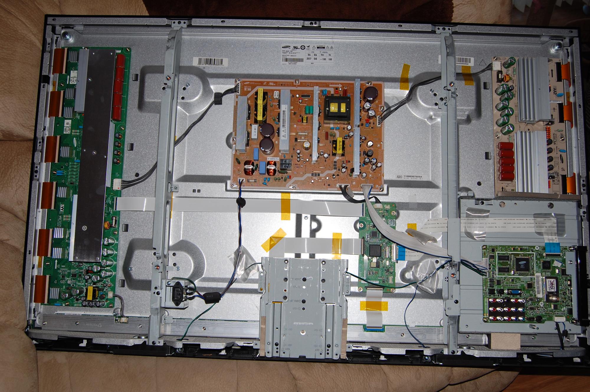

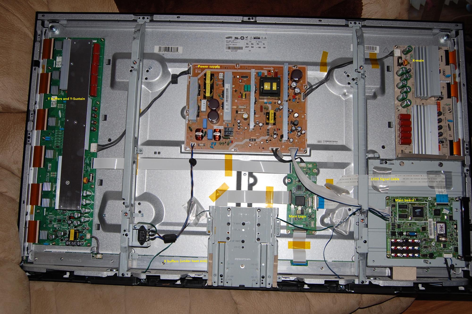

        I've marked up a picture, indicating significant points.
        In the lower right corner is the signal cable from the main board to the logic main board. That caries the video signal. Check to make sure the cable is firmly seated in each connector. The one on the main board appears to be a locking connector. If you don't know hoe to release it, attach a picture. Also, check all poser supply cables.
        PlainBill

          Thank you, Plainbill.
          I have checked every ribbon and wire connector for security, except the the type that carries the video signal. They appear quite fragile and I am not sure how to release them. There is no sign of corrosion anywhere and all seem tight.
          All fuses check OK.
          I cannot see any signs of capacitor failure or toasty resistors. This is the first time the back has been off and everything very clean and secure.
          I'm attaching a picture of the main board-maybe I should check the video signal connectors.
          When I power on the tv, there is a momentary, very slight flicker on the screen (twice) when the chimes start and stop.

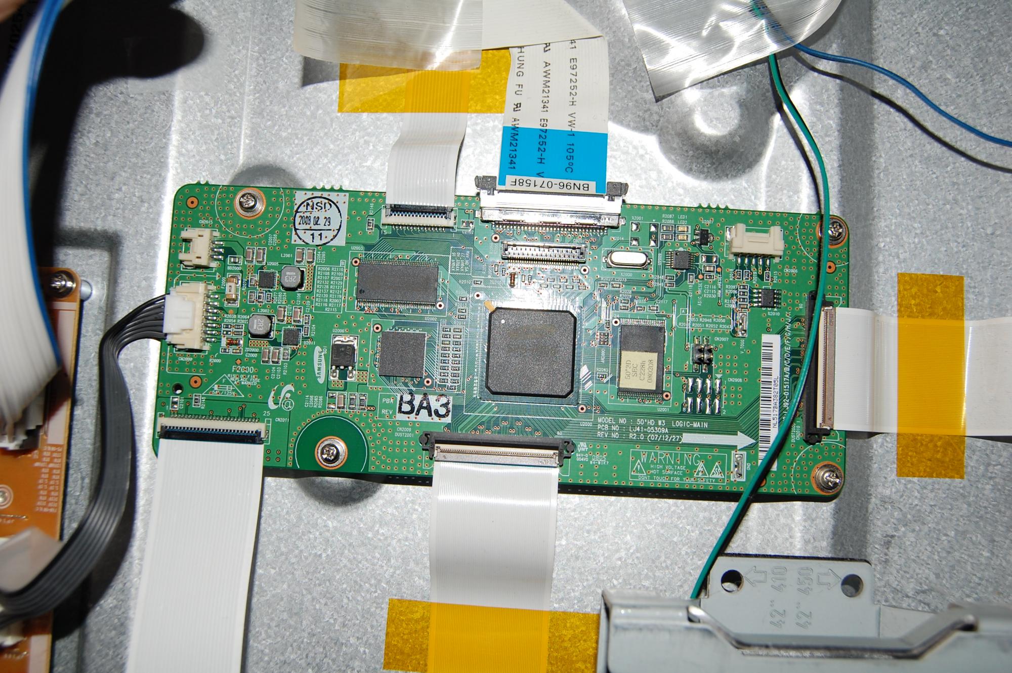

                      Here is the closeup of the main logic board.
                      have yet to voltages(busy finishing my DAC/headphone amp project)
