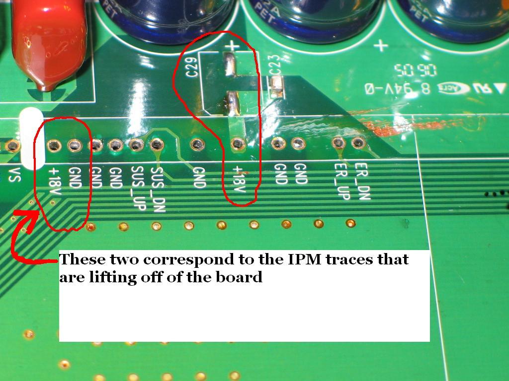

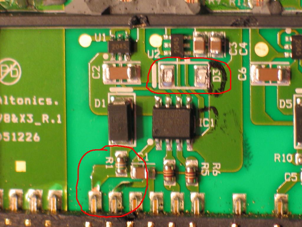

                I did find a short between the +18v mounting hole and ground. Turns out it was the C29 cap next to the bank of larger caps. It was very loose, and wiggling it would make or break the short. I desoldered the inside leg and the cap came off of the board. Looks like that leg was broken. The short is gone between the +18v and gnd holes, but I am getting continuity across the legs of the cap when off of the board. Is that correct?
                Also, looking at the underside of the IPM, I found the traces leading to the pins corresponding to the +18v and ground mounting holes (as shown in the photo) to be lifting off of the board. I followed the short through the diode (D3, failed diode check, so it was removed) to the IC1 chip. Not sure how that one is laid out, so I don't know if it's at fault or not.

                  A good cap should never show a short on the 2K ohms or lower range.

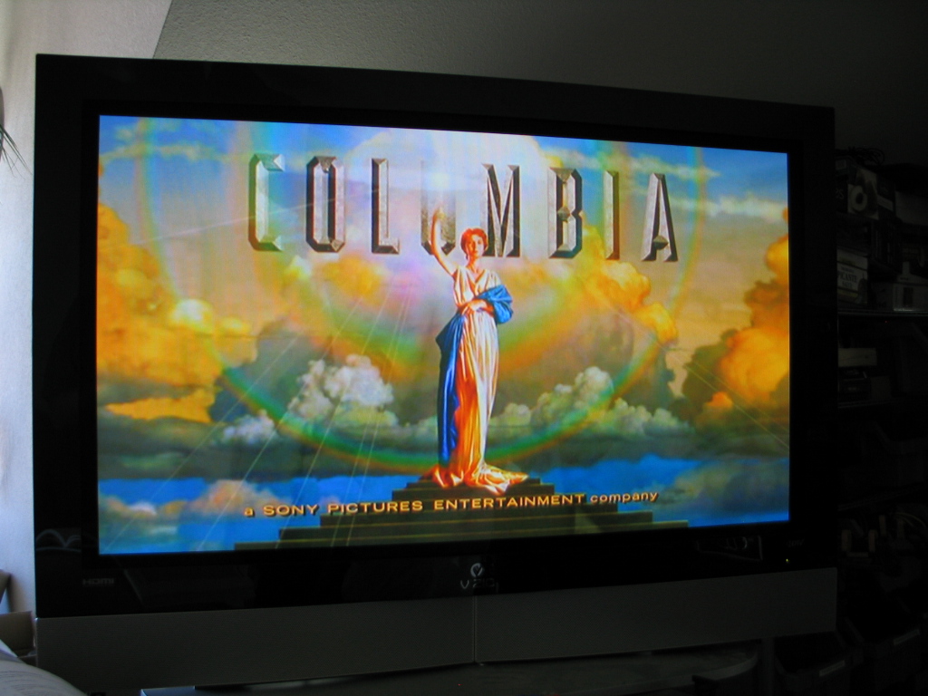

                    I got the new IPM installed, the board back in place, and BAM! the screen lights up. So I hook up a dvd player via HDMI and get video. Hmmm.. still no sound (which doesn't upset me too greatly, it's going to be used as an A/V monitor anyway), so I hook up a set of RCA cables from the DVD player to the audio inputs on the TV. Still nothing. And still not a big deal. Heck, I paid $75 for this TV, along with a Sony GPS unit (working), and a Casio digital camera (which I sold to a co-worker for.. wait for it... $75) so I don't have a lot invested. Then it hits me, let me check the audio settings. And there it is.. Speakers = OFF.
