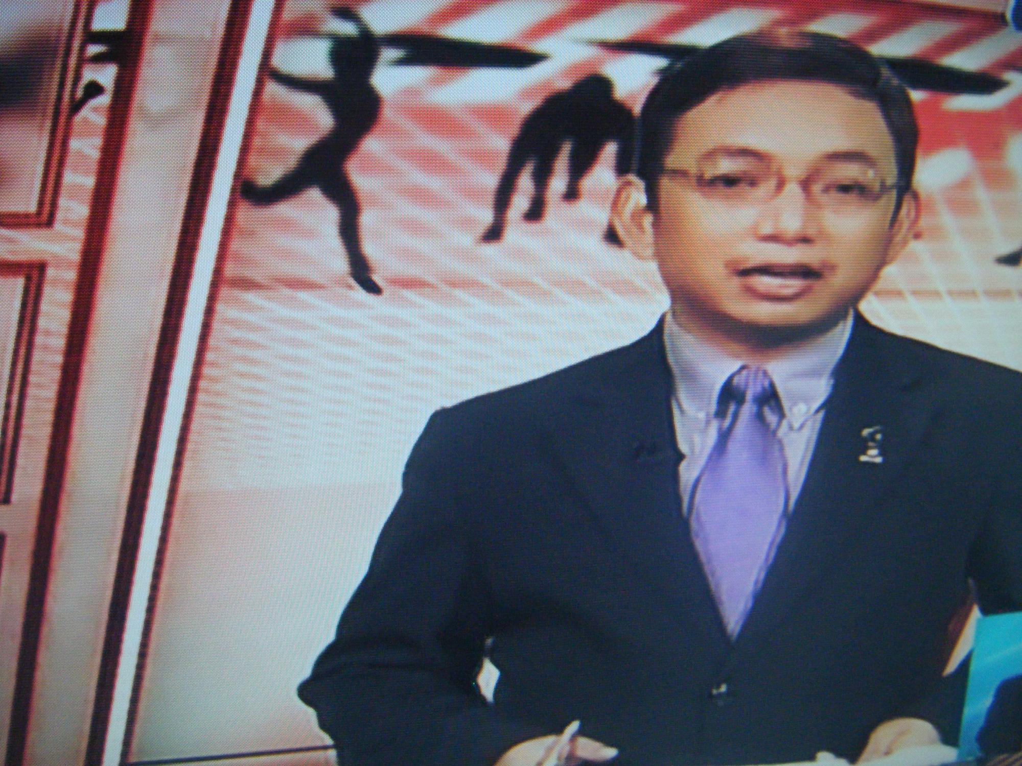

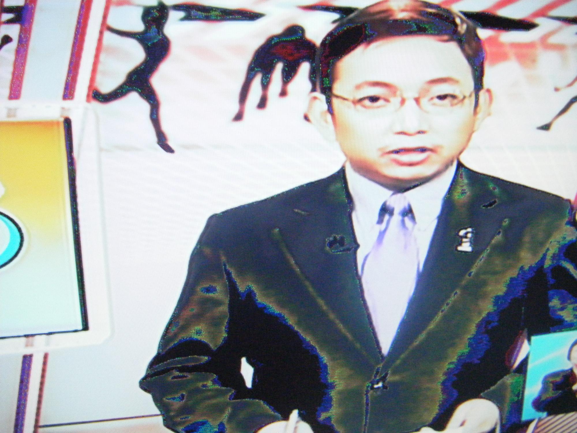

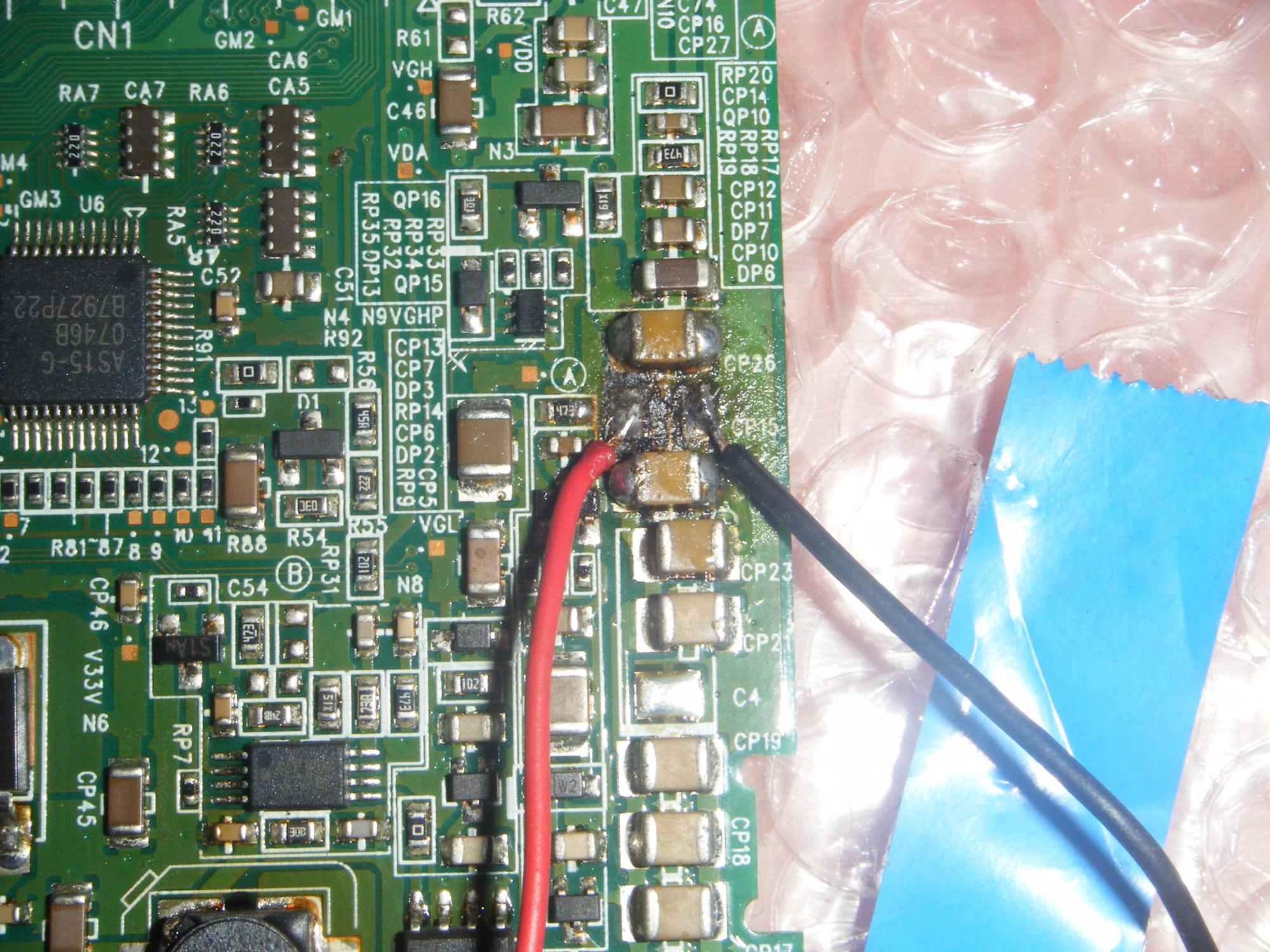

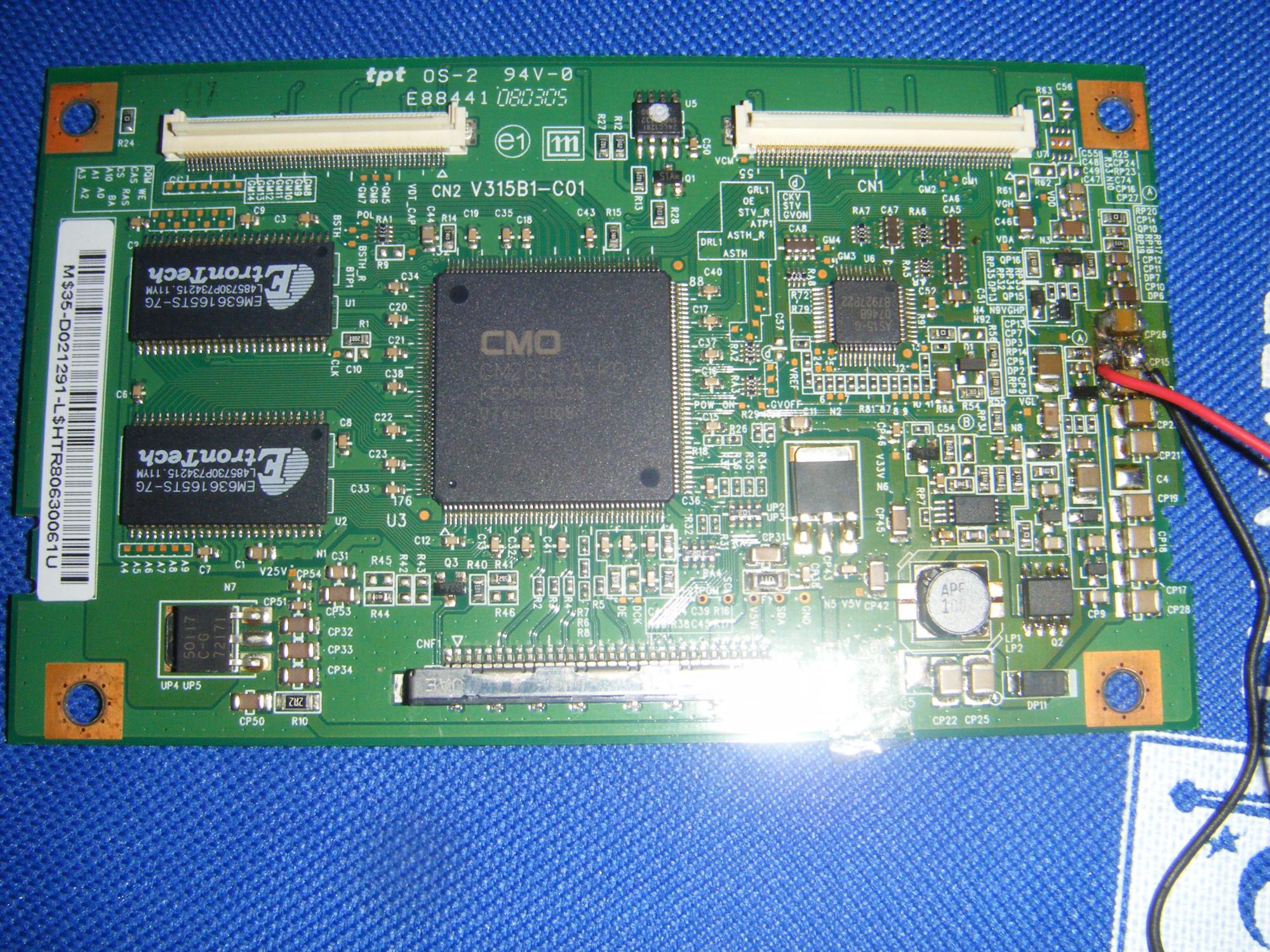

    Hey Guys,
    I am encountering a problem with this LCD TV T-con board above which I am hoping the experts here can advise me. Please excuse the flash in the photo/s below. I was taking them when there is not much sun shining here. Ok here goes…
    T-con board model : V315B1-C01 found in Samsung (mine is LA32S81B) and if I am not mistaken, some of Chimei LCD TV models.
    Symptom/Fault of the TV: I plugged in the TV to the Mains and Power LED standby light up. I switched on the TV, Power LED blinks 4 times (normal) but no chime was heard (abnormal). The backlight lights up but the screen is black with some vertical lines and a buzzing sound on the speaker. I decided to leave it on for a few more seconds & I could smell burnt on the back of the panel near the top (middle) of the TV. I disassemble the back panel & remove the metal cover of the T-con. Indeed a burnt SMD capacitor (CP15) can be found on the T-con. Using my multimeter, I measured shorted across it. I removed it & measured again & it is no longer shorted. I decided to leave CP15 empty & fix it to the back of the TV again. This time when I switched on the TV, Power LED blinks 4 times & a chime sound is heard (normal). Pictures appear on the screen but are washed out (negative mode). After a while, the image was better but the color especially black, contrast, gamma was off, not as a normal TV (Sorry I could not take a image of it as I have now already removed the T-con). Black image/background do have colored, fuzzy lines on them. The lines will go away if I increase the brightness though. Hope I am describing it correctly.
    I have also confirmed that the other SMDs capacitors lining up above & bottom of the burnt one (CP26, CP21, CP23, CP20) are inter-connected together (parallel?). 1 point on them is connected to the VDA point (below the label C46) while the other point is grounded. VDA is measure 13.65V to Gnd. I did experiment by wiring up the 2 point of the burnt SMD capacitor & placing a Electrolyte capacitor (ranging from 1uf to 47uf) across it but still the image is not normal. I do not have a capacitance meter.
    So what do you guys think? Should I just buy the whole T-con board set which I think will cost me around US$40 (including shipping from China)? TRY to replace the burnt SMD capacitor? But if I do that, I do not have the information what is the capacitance of the original burnt SMD capacitor or if there is other components failure on the T-con board. Many thanks in advance for all the feedback/s provided.

    Re: T-Con board V315B1-C01 shorted SMD capacitor
    Depends on how much your time is worth.
    Personally, I would try replacing the burned ceramic capacitor. You don't really need to know the info on it - just grab another ceramic capacitor that has the same size. Junk motherboards and video cards should have plenty of these.
    If that doesn't fix the problem, check the voltage on test points VDD, VGL, and VGH. VGL should be negative (typically -5 to -15V depending on the t-con design), and VGH is typically 15-35V. Post what results you get.

      Thanks momaka.
      I managed to find an SMD capacitor from graphics card. Same length but it is thinner. Replaced it and the image was initially dark (negative) but slowly producing a much proper image. However, the black areas are having colored lines on them (See first photo). I then realized that the picture is in ‘Dynamic' mode setting. I changed to ‘Standard' mode and the image is better (See second photo). However, in ‘Standard' mode the white area of the display is more yellowish than white.
      Measurements taken from the T-con board are:
      VDD = 3.3V
      VGH = 18.7V
      VGL = -5.5v
      VDA = 13.6V
      Do you guys think that the T-con is causing the description above or is the logic board faulty? If it is the logic board, then i guess I have to live with it as I am not sure I can get a used one for cheap.

        I can't confirm that VGH and VGL are 100% correct since I don't have the service manual for this TV, but they still seem okay. The other voltages are fine.
        Not sure. Check the TV's menus - do they appear to have the same problem as the picture or is the color there fine. If the color in the menus is fine, then it's most likely a faulty logic board. If the menus have the same problem as the picture, then it's most likely the t-con.

                Hi Guys,
                Just an update. Replacing the whole T-Con board solve the problem. Thank you guys for all your input/s..

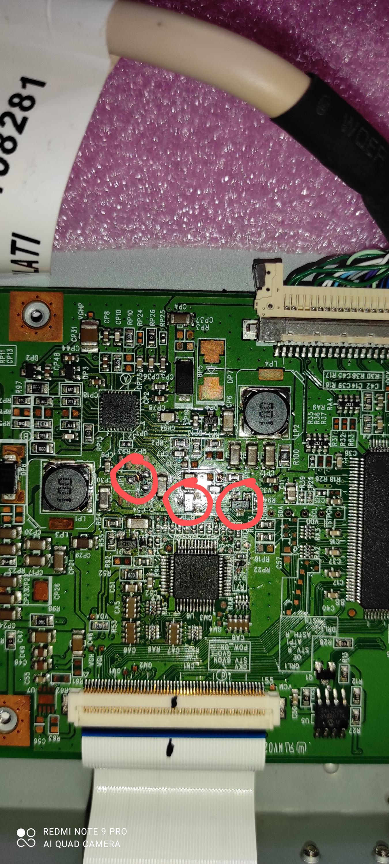

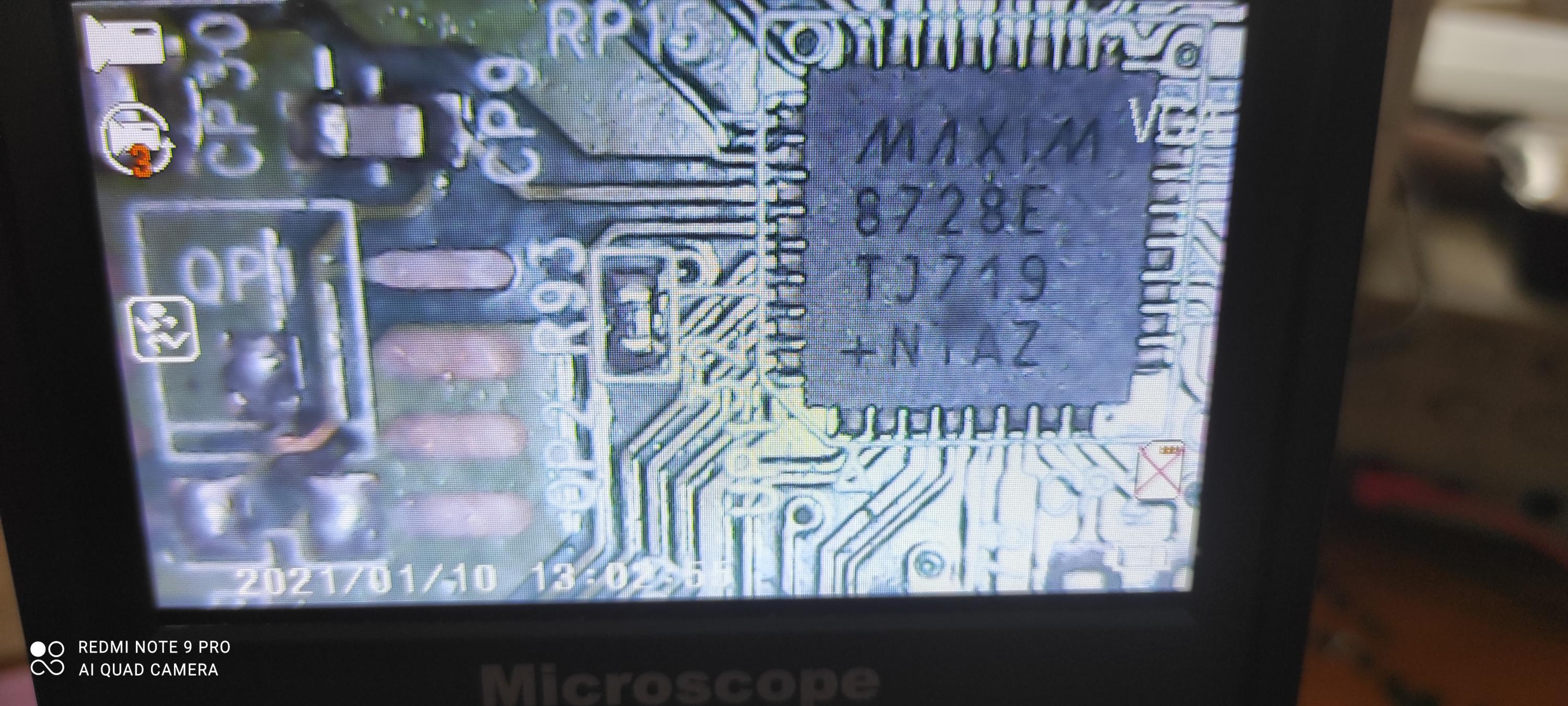

                          Good day. Can you advise me what the part according to the attachment was - it was burned and I circled the empty space and the place where there are probably identical components. The designation is S1Ac and I can't find what it is and the equivalent. Maybe it's a mosfet or a double diode. There are no diagrams anywhere. well thank you
                          This T-CON V315B1-C05

                            master hoarder
                            • May 2008
                            • 12170
                            • Bulgaria
                            The PCB designator for that component shows "QP1", so it must be a transistor of some sort. If I had to guess, it's most likely a MOSFET as I don't see any Base resistors. But it's hard to say. Infineon has a MMBT3904 transistor (NPN BJT) in SOT-23 case that is marked with "s1A" rather than "S1Ac".
                            Post the part number found on that square IC chip above it (UP1.) If we can get a datasheet for that, we can see what pin the missing QP1 transistor goes to, and then try to determine that from the app circuit in the datasheet for UP1.
                            Another approach is to see to what rails the pins of QP1 connect to. We can see the left-most pin (when the single pin on the SOT-23 device is at the top) should be the Gate/Base connection, given the thiner wire. So if we can figure out to what rails the other pins connect to (i.e. ground, 5V, 3.3V, etc.), then we can see what function this transistor has in the circuit and then we may be able to guess if it's a MOSFET or BJT.
                              Thank you for your response. I'm just a beginner. Here's a photo

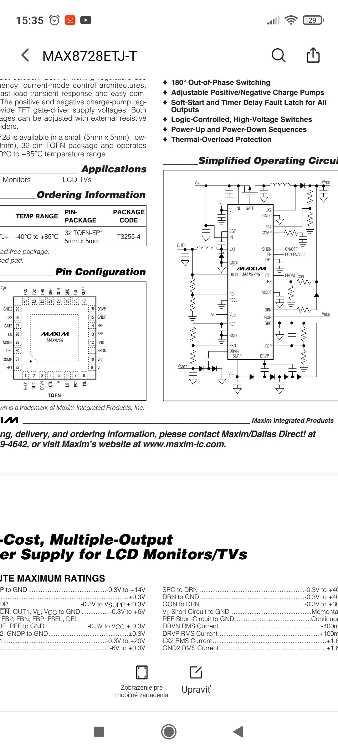

                                Thank you for helping me. So far, I have found that PIN 27 from MAXIM is marked as GATE and goes to the missing part. So it should be a MOSFET. But according to that table, it should be an NPN transistor. So I don't really know what part was there at all.
                                      According to MAX8728 datasheet, pin 27 has the following description:
                                      "Input MOSFET Gate-Driver Output. GATE controls an external p-channel MOSFET between the input voltage and the step-up regulator’s inductor. The switch is off when the step-up regulator is turned off, so that the regulator’s output discharges to ground. During startup, the step-up regulator’s soft-start begins when VGATE falls below the GATE done threshold"
                                      So you just need a P-ch MOSFET there.
                                      As for what MOSFET to use, that you'll have to search what is available to you. I think a MOSFET rated for 25-40V V_sd and 750 mA to 1 Amp should work, but maybe get a small variety, just in case. And make sure to get P-channel type. N-channel will NOT work.
                                      Also, you don't really need to get a matching SOT-23 case size. If all you can find is bigger cases like TO-252 or SOT-223, you can just solder these MOSFETs with a bunch of wires to the board - at least for a test, if nothing else.
                                      Lastly, was QP1 chipped from physical damage or from overload? If from overload, check for shorted ceramic caps on the AVDD rail (i.e. check resistance between ground and the Cathode of SMD diode DP6 - you should probably get a few hundred Ohms there or more.) If you get less than 50 Ohms, there may be a shorted ceramic cap somewhere, and that may cause your new MOSFET to blow again.
