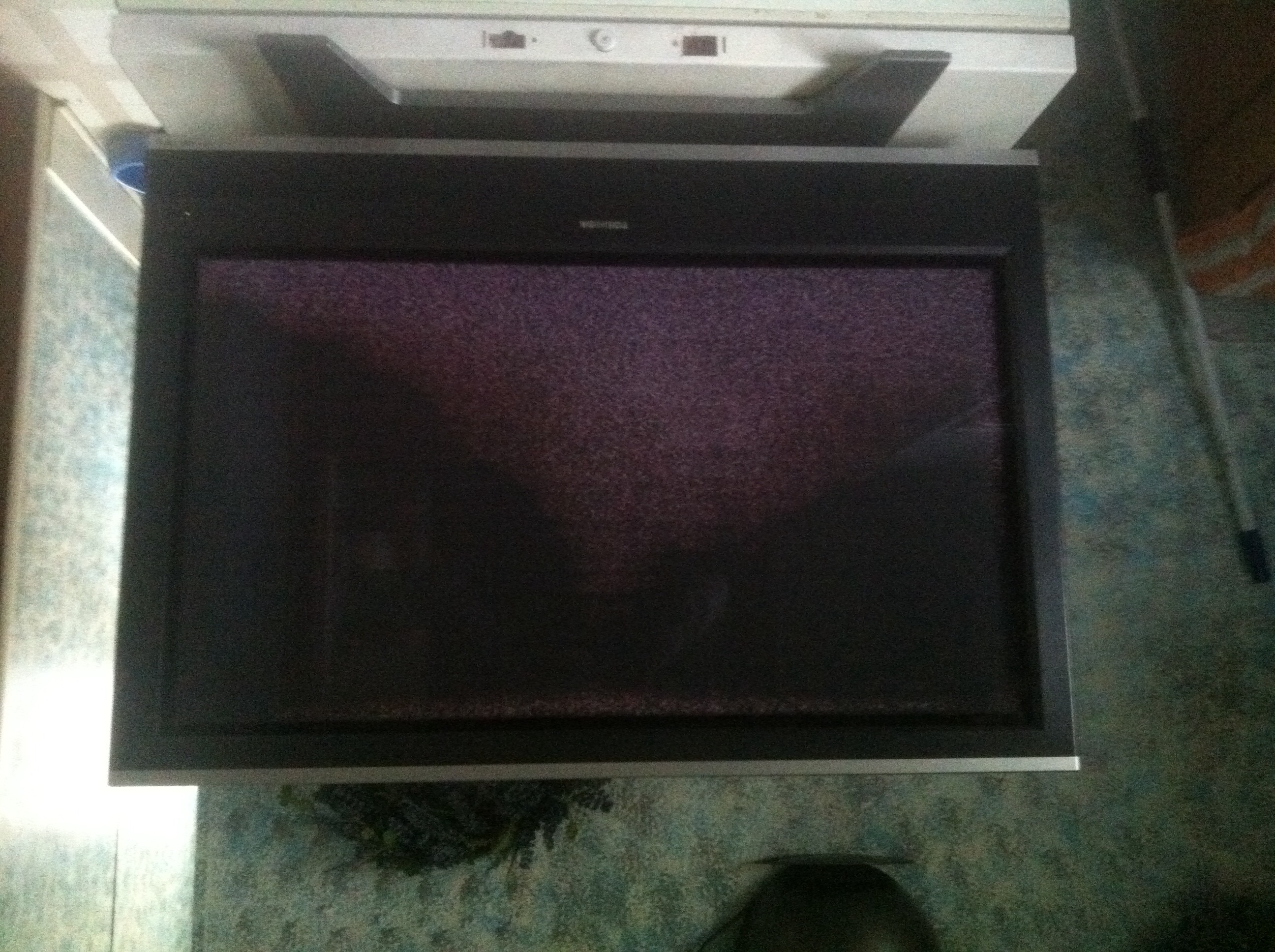

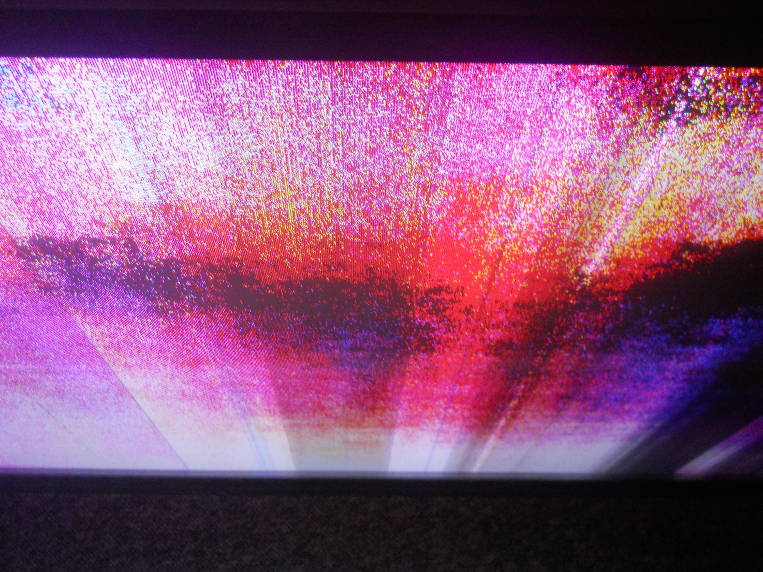

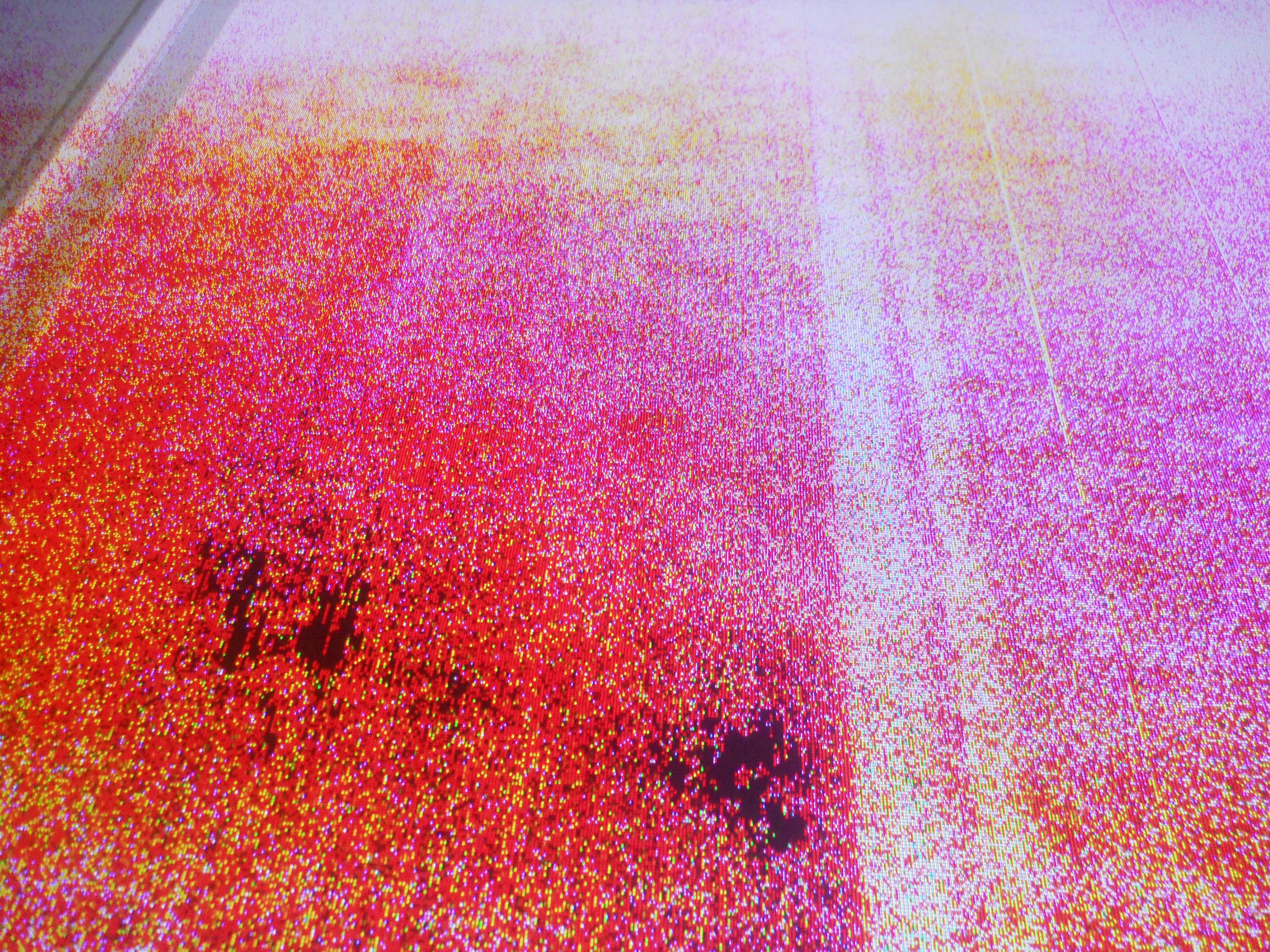

A guide to fixing/troubleshooting some common plasma TV problems
This topic is closed.
+ More Options
Latest Activity
  • Jason 82
    replied
    Re: A guide to fixing/troubleshooting some common plasma TV problems
    Hey Tom, great threads, I have a toshiba 42" plasma 42hp16, I've done a little troubleshooting from your threads already, yet I don't know. I have sound, and my picture has a blanket if you will of black over the top of it, I have replace a fuse that was bad on the y- sustain right side top, of course did not fix it, so my question to you good sir is what do I check next?
    Leave a comment:
  • Jwick14
    replied
    Re: A guide to fixing/troubleshooting some common plasma TV problems
    Originally posted by munirutech
    hy everyone my name is muniru from ghana and an electronics tech,am here to learn more and share what i have learnt in electronics for 17 years in the field and still counting, i hope am welcome
    Maybe you could help me with my plasma , there's no sound or picture. The only thing that seems to work is the backlight.
    Leave a comment:
  • markgarry1
    replied
    Re: A guide to fixing/troubleshooting some common plasma TV problems
    Cheers Tom,
    Cant believe that a bad capacitor can cause that fault.
    I hope that the two buffer boards connected to the Y-Main board are OK?
    Will post new pictures of the boards and sticker tomorrow.
    All the best Tom and thanks
    Regards,
    Mark
    Leave a comment:
    replied
    Re: A guide to fixing/troubleshooting some common plasma TV problems
    That fault is most likely due to bad capacitor.
    Leave a comment:
  • markgarry1
    replied
    Re: A guide to fixing/troubleshooting some common plasma TV problems
    Thanks Tom. will do that tomorrow and get back to you and will supply new pictures....I know that the Y-Main board is the one connected to the two buffer boards (hope that is correct)
    If the Y-Main board is faulty? would it be likely to be a bad cap or faulty mosfet transisters?
    Thank you again Tom
    Kind regards
    Mark
    Leave a comment:
    replied
    Re: A guide to fixing/troubleshooting some common plasma TV problems
    Best to start a new thread. Supply pictures of the boards in it, and one of the voltage sticker on the metal plate (e.x. SAMSUNG Vs/Va...)
    Leave a comment:
  • markgarry1
    replied
    Re: A guide to fixing/troubleshooting some common plasma TV problems
    Hi Tom
    Thank you so much for your advice
    I have a digital multimetre, so what do i need to check next?
    Would I be better off buying another Y-Main board? Im ok with checking voltages and changing components though
    I have downloaded the service manual for the TV
    Once again i would like to thank you for your help.
    Best wishes
    Mark
    Leave a comment:
  • markgarry1
    replied
    Re: A guide to fixing/troubleshooting some common plasma TV problems
    Hi.
    I hope somebody can help me.
    I have a PHILIPS 50PFP5532D Plasma TV.
    It works fine for about 20 minutes then the picture breaks into pixelated colours with moving vertical lines sometimes...but if you have a dark image the picture is fine until you get a bright image....turn it off and on and it works for another 20 minutes then does the same again
    ive attached some pictures of the TV
    Thank you for your help
    Kind regards
    Mark
    Leave a comment:
    replied
    Re: A guide to fixing/troubleshooting some common plasma TV problems
    Looks like a Y-main fault, probably due to a problem with the -Vsc or Vsch voltage. You will need a multimeter to diagnose the fault.
    Leave a comment:
  • markgarry1
    replied
    Re: A guide to fixing/troubleshooting some common plasma TV problems
    Hi.
    I hope somebody can help me.
    I have a PHILIPS 50PFP5532D Plasma TV.
    It works fine for about 20 minutes then the picture breaks into pixelated colours with moving vertical lines sometimes...but if you have a dark image the picture is fine until you get a bright image....turn it off and on and it works for another 20 minutes then does the same again
    ive attached some pictures of the TV
    Thank you for your help
    Kind regards
    Mark
    Leave a comment:
    replied
    Re: A guide to fixing/troubleshooting some common plasma TV problems
    Originally posted by Pingers
    Samsung PN51F5300 51" 1080p 600Hz Class Plasma HDTV
    Since I first got my TV a little over a month ago when I power on the TV after it's been off for 8 hours or more the pixels can take up to 5 seconds to completely populate before the image is viewable in its entirety. This includes the Samsung logo at start-up. Some of the pixels are missing from it and then after 5 seconds everything is normal. If I turn off the set right away and turn it back on, no pixels are missing and it runs just fine. The issue only occurs after the TV has been off for some time. I'm wondering if this is going to turn into a bigger issue down the line.
    Return it. Likely already has an X-main fault. I would avoid Samsung in future.
    Leave a comment:
  • Pingers
    replied
    Re: A guide to fixing/troubleshooting some common plasma TV problems
    Samsung PN51F5300 51" 1080p 600Hz Class Plasma HDTV
    Since I first got my TV a little over a month ago when I power on the TV after it's been off for 8 hours or more the pixels can take up to 5 seconds to completely populate before the image is viewable in its entirety. This includes the Samsung logo at start-up. Some of the pixels are missing from it and then after 5 seconds everything is normal. If I turn off the set right away and turn it back on, no pixels are missing and it runs just fine. The issue only occurs after the TV has been off for some time. I'm wondering if this is going to turn into a bigger issue down the line.
    Leave a comment:
    replied
    Re: A guide to fixing/troubleshooting some common plasma TV problems
    Originally posted by amlez
    LG Plasma 60PC1D
    When powering up, large pink horizontal 'line' (occupies top 2/3's of screen) flashes on & off (about 1 second intervals).
    No other picture or sound, and no control buttons (Menu, Input) have any effect.
    Can you advise if this is likely to be merely a 'board' (control/sustain) issue, or beyond economic repair?
    Cheers!
    Y-SUS ER IPM + Y-buffer
    This would be economical but expensive (around $250 US.)
    Leave a comment:
  • amlez
    replied
    Re: A guide to fixing/troubleshooting some common plasma TV problems
    LG Plasma 60PC1D
    When powering up, large pink horizontal 'line' (occupies top 2/3's of screen) flashes on & off (about 1 second intervals).
    No other picture or sound, and no control buttons (Menu, Input) have any effect.
    Can you advise if this is likely to be merely a 'board' (control/sustain) issue, or beyond economic repair?
    Cheers!
    Leave a comment:
    replied
    Re: A guide to fixing/troubleshooting some common plasma TV problems
    Make? Model #?
    Please start a new thread.
    Leave a comment:
  • Jwick14
    replied
    Re: A guide to fixing/troubleshooting some common plasma TV problems
    My plasma tv is having issues. So first of all, it powers on, the little red light next to the power luminates. The issue is no picture, meaning the screen will flicker and the back light luminates, that's it. I can not select inputs, change settings ect. Another thing to note is the tv will not remain powered off longer than about 3 seconds. Does this sound familiar to you?
    My armature diagnosis is power supply issues
    Thank you,
    -Jacob
    Leave a comment:
  • munirutech
    replied
    Re: A guide to fixing/troubleshooting some common plasma TV problems
    hy everyone my name is muniru from ghana and an electronics tech,am here to learn more and share what i have learnt in electronics for 17 years in the field and still counting, i hope am welcome
    Leave a comment:
  • munirutech
    replied
    Re: A guide to fixing/troubleshooting some common plasma TV problems
    hy everyone,my name is muniru from ghana and a professional electronics tech and am here to learn more and share what i have learnt in electronics for 17 years in the field,hope am welcome from my friends. THANKS
    Leave a comment:
  • zenzee
    replied
    Re: A guide to fixing/troubleshooting some common plasma TV problems
    Originally posted by tom66
    Bad Y-buffer+Y-sus ER-IPM. Very common on these models... Fairly expensive to fix around $200.
    Thank you Tom!
    Leave a comment:
    replied
    Re: A guide to fixing/troubleshooting some common plasma TV problems
    Originally posted by zenzee
    Can you possibly tell me if this is worth fixing? I've included a link to a short Vimeo file. Thank you in advance for your expertise!
    http://vimeo.com/77737941
    Bad Y-buffer+Y-sus ER-IPM. Very common on these models... Fairly expensive to fix around $200.
    Leave a comment:
  • m1ch43lzm
    by m1ch43lzm
    05-12-2025, 08:37 PM
  • howardc64
    by howardc64
    Problem
    08-04-2024, 10:36 PM
  • Hakuu
    by Hakuu
    Hi There,
    More Details
    TV Model - LG OLED77G1PUA
    07-12-2023, 02:37 PM
  • jb_Bak
    by jb_Bak
    CN6401
    Pin 01 NC
    Pin 02 NC
    Pin 03 "BL_ON": 0V
    Pin 04 "N/C"
    Pin 05 "STBY 3.3V": 3.5V
    Pin 06 "GND": N/C
    Pin 07 "AC_OFF"...
    09-27-2021, 04:52 PM
