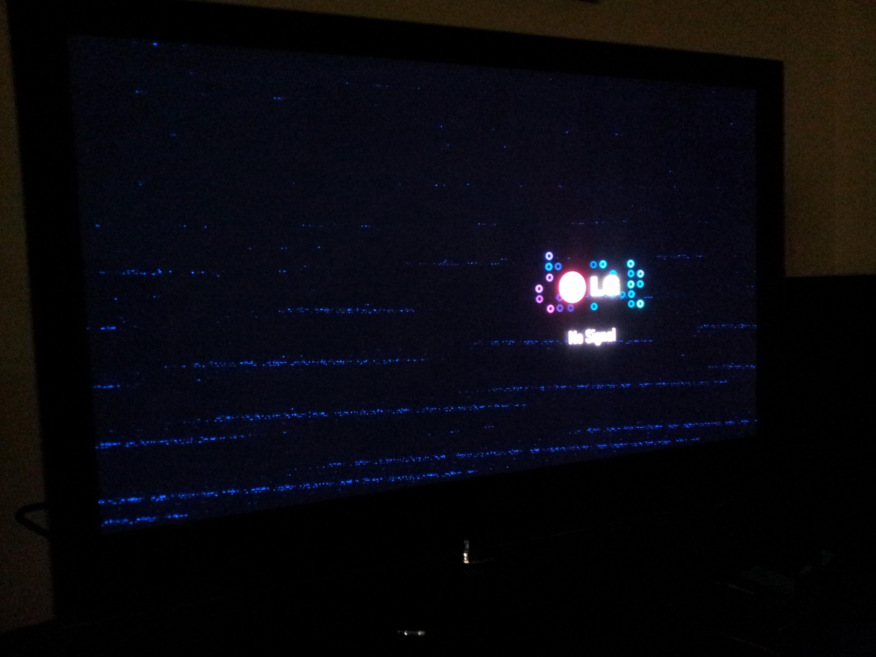

      My LG 50PS80 plasma, which is around 3 or 4 years old, has developed an issue. I was watching TV last night and noticed these cool bright blue dots in the black scenes on the screen and thought it was part of the show I was watching. It wasn't until the screen went full black that I saw this (see attached pic please) These blue lines are made up of little blue dots and the entire array of lines/dots is moving left and right all in succession. It's sort of bouncing left and right on the screen a few inches. I left the TV off overnight and this afternoon turned it on to find many more lines. The entire screen is basically covered with these blue lines to the point that black is no longer there. Has anyone seen this before? I'd greatly appreciate some input on which board to look at for an issue or is the panel failing? When I bring up a menu the menu looks great except that the reds are more pink than red and any black area has blue dots/lines in it.
      Thanks.

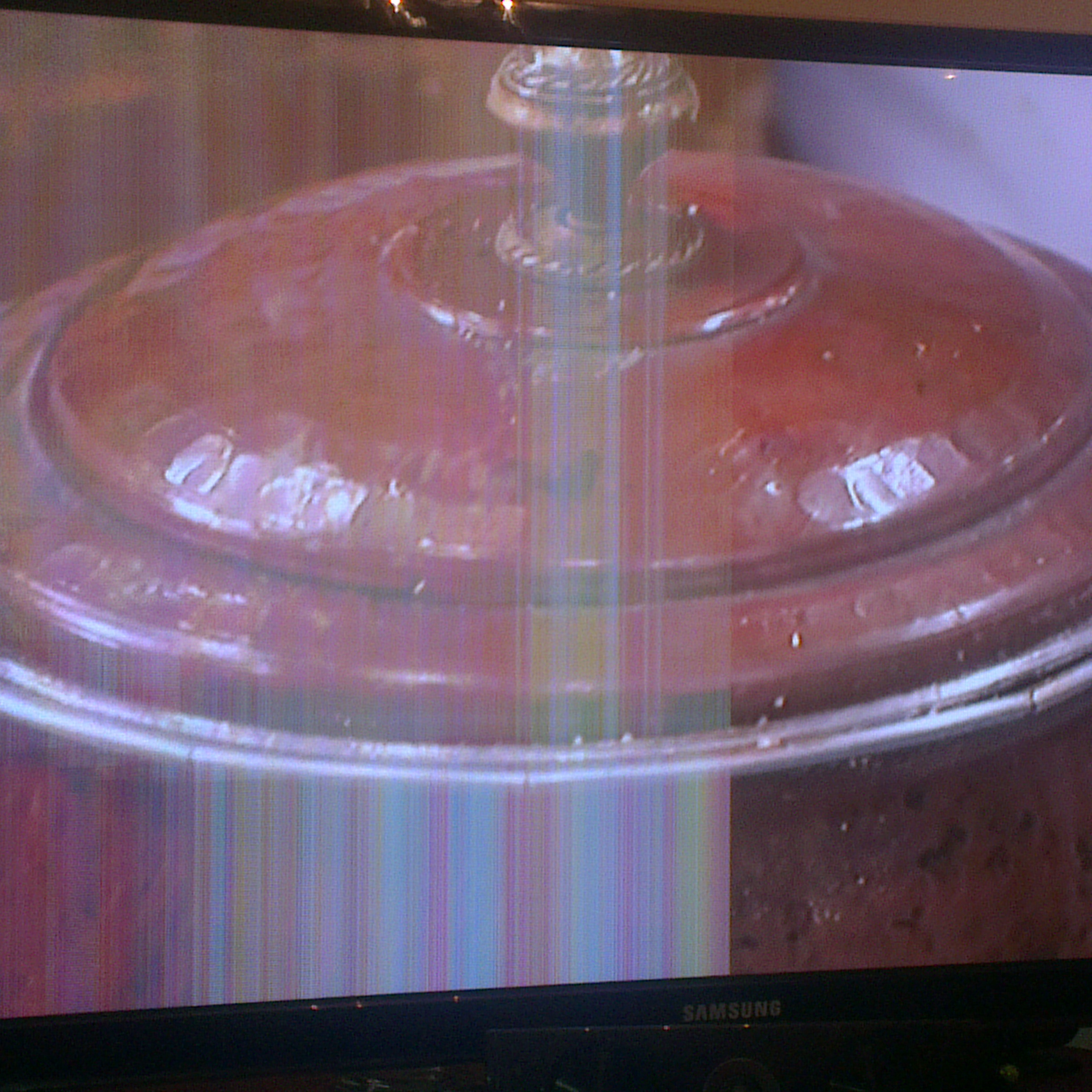

        please help my samsung plasma ps50 has developed a problem that effects only the left side of the screen lots of fuzzing and lines which change according to the picture displayed and is on all inputs

          Re: A guide to fixing/troubleshooting some common plasma TV problems
          Huh, that's an odd one. I suggest you create your own thread so we can keep up with the diagnosis, I'd be checking connectors going to the lefthand C board, consider the logic board as being a potential fault. Panel looks OK to me.

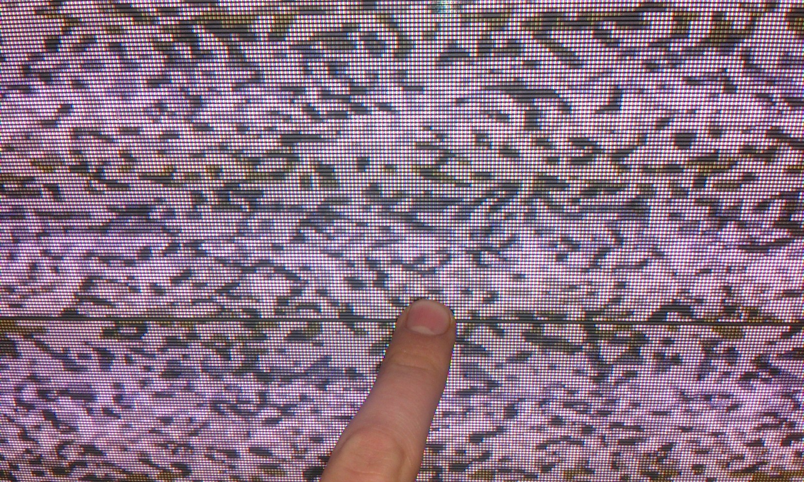

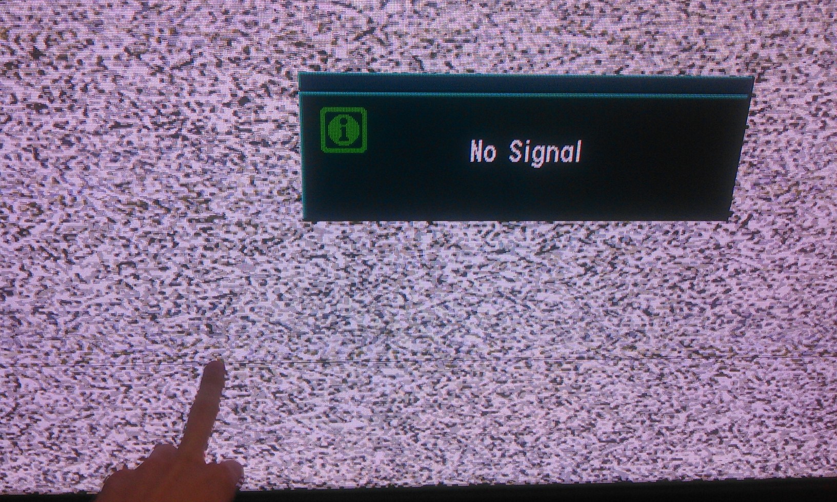

                I picked up a samsung plasma pretty cheap off craigslist and now I'm having problems with the display. The model is Samsung sp-s4223. Anyways, I've read a lot of troubleshooting forums about possibly having to replace individual buffers in order to get rid of the lines, but in attempting to find out which buffer it was, I realized it appears to be between buffers (anytime i disconnect the 3rd or 4th buffer and cut the tv on, the line disappears). Anyways, I was wondering if any of you had any suggestions on what to do with this. Thanks in advance.
                -Kyle
                  Can you show a pic of the problem?

                    #329
                    You can see it in the following photos
                      #330
                      That looks to be a defective plasma panel, not repairable. Small chance of bad buffer board but probably not.

                        #331
                        And thanks for your quick response--I was definitely not expecting that...

                          #332
                          is it possible to diagnose the issue any further?
                            #333
                            You can try replacing the Y-buffer board, but I would not expect it to fix this issue.
                            • kgkyzer
                              • Oct 2013
                              • 5
                              #334
                              sounds like throwing away money...it's a thin line, I'll just deal with it. Thanks again!
