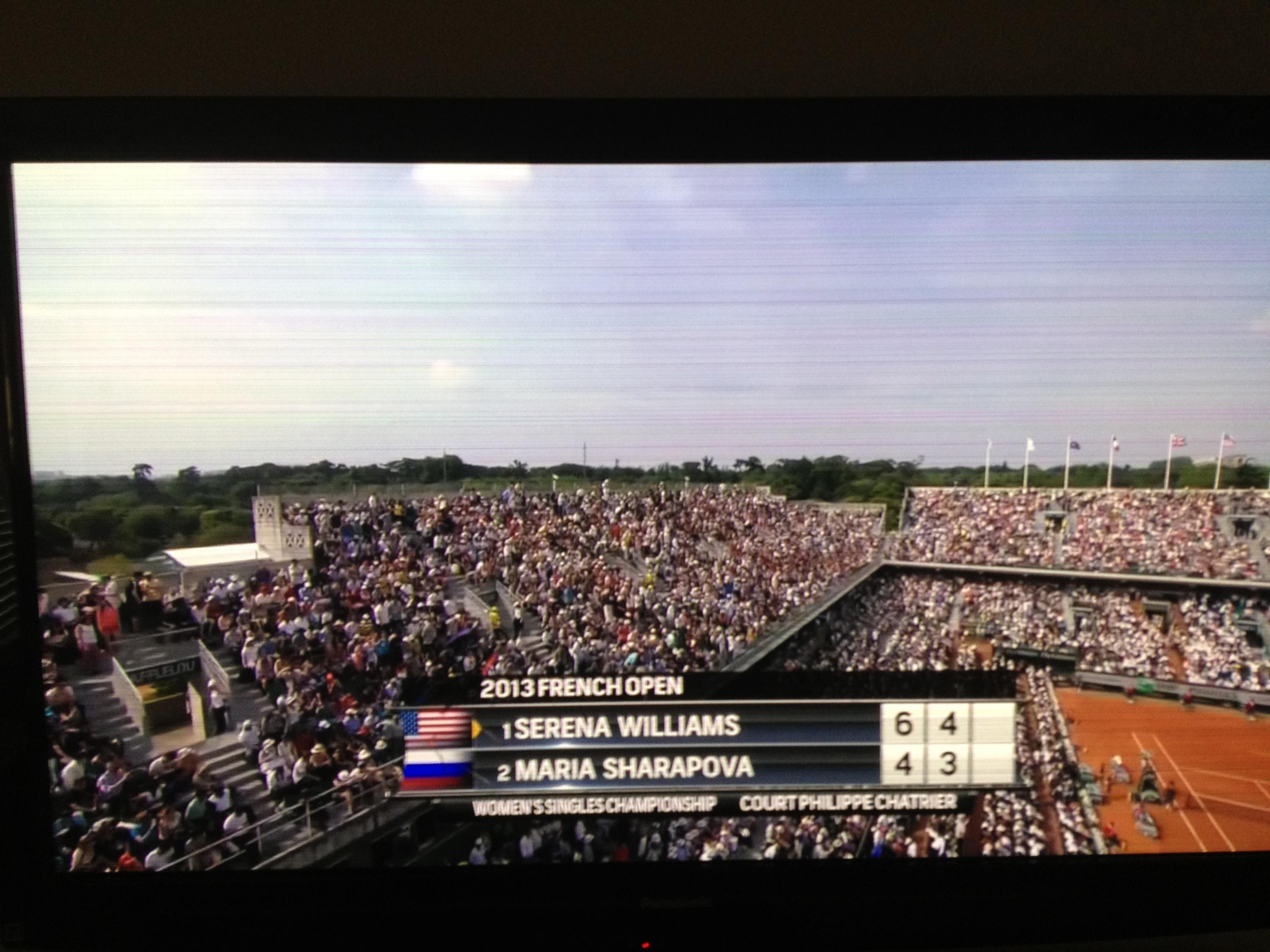

    I have a 50 inch Panasonic Plasma TV (TC-P50GT25) that has thin horizontal lines going across the entire screen from top to bottom. It happens with all inputs and varies in intensity. Sometimes I can turn it on and watch for 30 minutes or so with no lines but they always reappear. The lines flicker a lot and sometimes they are different colors but most of the time they are black.
    I would appreciate any help in diagnosing the issue so that I can try and replace the defective part. The TV is only 2 years old. Thanks.
      #182
      Re: A guide to fixing/troubleshooting some common plasma TV problems
      I would be considering a bad A board or bad SU/SD but more likely to be A as it affects both halves.

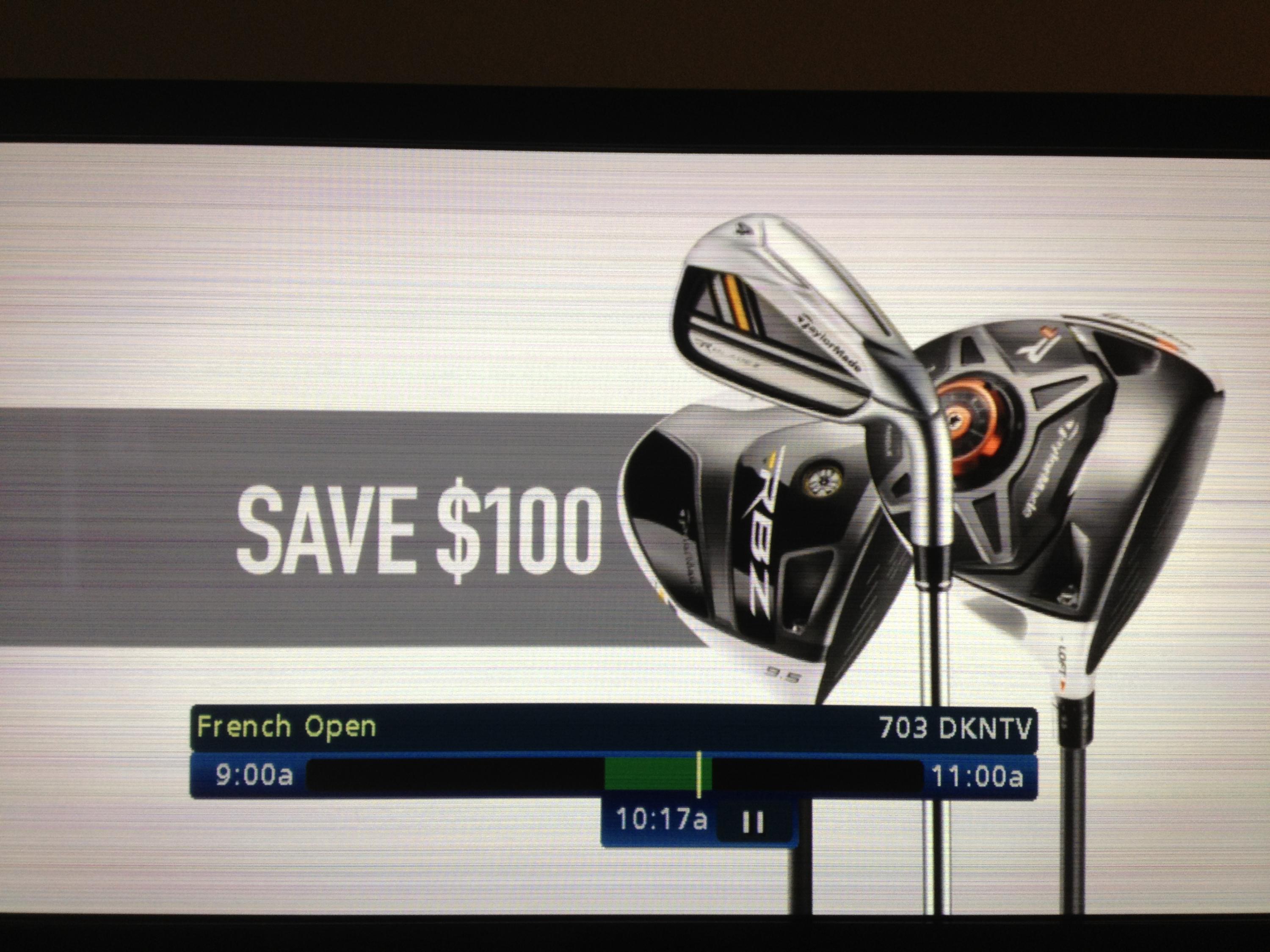

                        Looking for an opinion on my 2.5 year old LG Plasma TV (60PK550). Not sure how to best describe the picture issue so I've attached an image. Any ideas as to what component would be the culprit? Prior to this, we would periodically see a white vertical line (about an inch wide) on the right side of the screen.
                        Thanks,
                        G
                          #192
                          I'm going to say main or control board. Please start a thread for further advice.

                            I got a new A board for $30 on eBay with a 30 day warranty and installed it into the TV. I had no lines for about 5 minutes and then they returned so it seems that it is not the A board. If it is both the SU/SD boards then that would seem unlikely that both of them went bad at the exact same time because it has always been the whole TV screen. Any other possibilities?
                              #194
                              Did the original board show these lines after some time, or immediately?
                              If you leave the TV to cool down and then turn it on again, the lines come back?
                              If so, can you try heating up some parts and see if the problem returns quickly when a certain part is heated?
                              • ryebred
                                • Jun 2013
                                • 7
                                #195
                                Yeah, the original board did the same thing. I timed it twice and it runs without lines for 15 - 20 minutes before the lines start appearing again. If I leave the TV to cool down then the lines will go away but it takes a while to cool down enough for the lines to not appear right away.
                                How would I heat a part up? Blow a hot hair dryer on it?
                                  #196
                                  Hairdryers work well.
