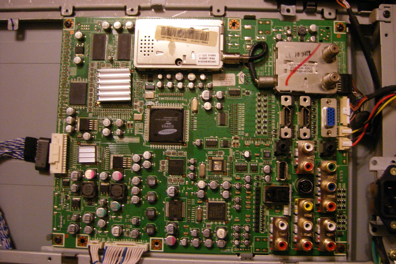

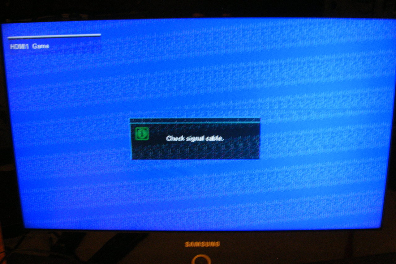

    Hi again everyone,
    I've acquired another broken display. The display is pixelated in all display modes. I'm trying to ascertain whether the problem is the Tcon board or
    the main signal board, or perhaps a bad LCD. Wiggling the LVDS wires from the main board to the Tcon board does not change the display. (A Tcon
    board on Ebay can be had for as little as $10).
    I've attached pictures of the picture displayed and the internals of the TV.
    Thanks for any help,
    Jerry

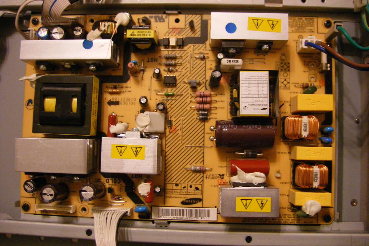

    Re: Samsung 32" LNS3238DX/XAA LCD pixelated
    That certainly looks like AC ripple. My first move would be to check the power supply, in particular the voltage across the large Capxon cap while the TV is working. My second would be to seriously consider a complete recap of the power supply.
        You will most likely need a scope. You may be able to get away with earphones.
        Another option is the T-con is failing. The lines look almost like digital noise, like from a noisy LDO that has nearly failed. If the T-con is cheap I would give it a go before looking to other things.
          Measured 384v DC/1.12v AC across the large Cap.
          Ordered a Tcon from Ebay this morning.
          Could you explain the "earphone" method for checking ripple?
                  I replaced the Hot side main filter Cap (150microfarad/450v) with another cap from another power supply. Still the same picture.
                    I also removed the secondary filter caps and measured with
                    Atlas ESR70, replaced two caps(marginal esr) with tested good caps and still no change in the display.
                      Got the Tcon board in yesterday and installed it. No change. Looks like a main board problem.
                      • cliff_hootarski
                        • Jul 2006
                        • 411
                        Finally found a main board @ shopjimmy. Installed and works like a champ now!
