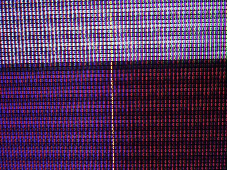

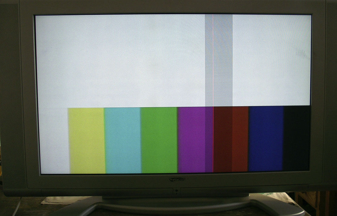

Vertical line
    Vertical line
    This is another Chinese LCD set, apparently assembled in Portugal with various different panels.
    Brand name is a private one - DigitalArt.
    Not listed anywhere!
    Customer sent two for repairs, the other one is dead, but the power seems to be going [I already sent email to LiShin Enterprise for diagram of PS - not sure if I'm lucky - PS model n. 0420D02216].
    Is this a screen problem or plugs?
    I have not yet stripped it to check because I'm not sure if customer wants to replace screen [if it is the screen].
    Apparently, he can get a new screen from where I don't know!
    Re: Vertical line
    Looks like panel, sadly - unlikely to be T-con.
      Re: Vertical line
      Thanks.
      Is it worth checking any anomaly in the plugs to the screen panel, do you think?
        Re: Vertical line
        Originally posted by burntfingers View Post
        Thanks.
        You could try pressing on them, if you are lucky it will just be that and may be fixable.
          Re: Vertical line
          I once had a vizio with similar vertical lines like the first picture and it ended up being the tcon
