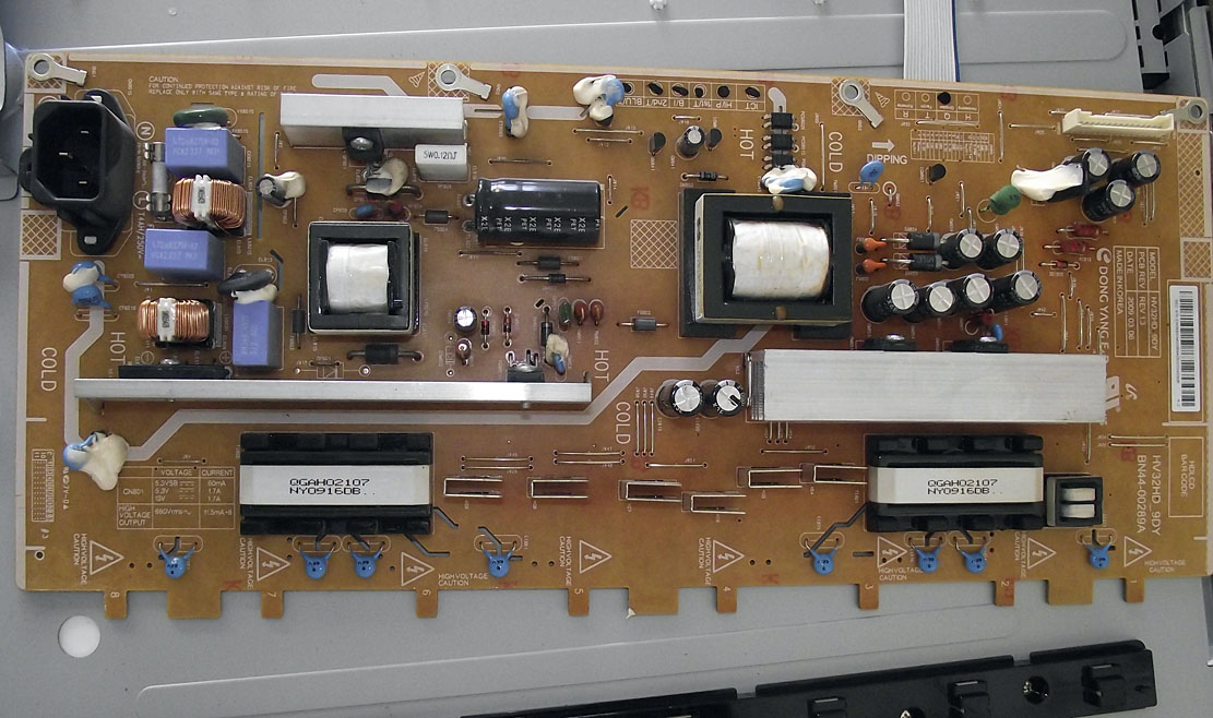

    LCD Samsung LA32B350F1 - sound, no picture
    Do I need to suspect one of the inverters?
    Sound is there OK, but a perfect picture only appears for a second or less any time it is powered, on the standby touch button.
    Sadly, the Manual does not have the diagram.
    Manual suggests replacing the entire PS board [which, I guess, would not be cheap - customer wouldn't accept]**.
    http://elektrotanya.com/?q=showresul...at2=schematics
    ** Are these LCD sets getting more into the disposable "dispensation" with such faults?

    Re: LCD Samsung LA32B350F1 - sound, no picture
    That would be a good guess at 2 seconds to black. See
    http://lcdparts.net/TransformerDetai...ProductID=3944
    for the secondary pins.
    Measure both transformers and see if all 4 readings are within 3% of each other. Post your measurements.
    $20 on ebay + free shipping if that is the problem.

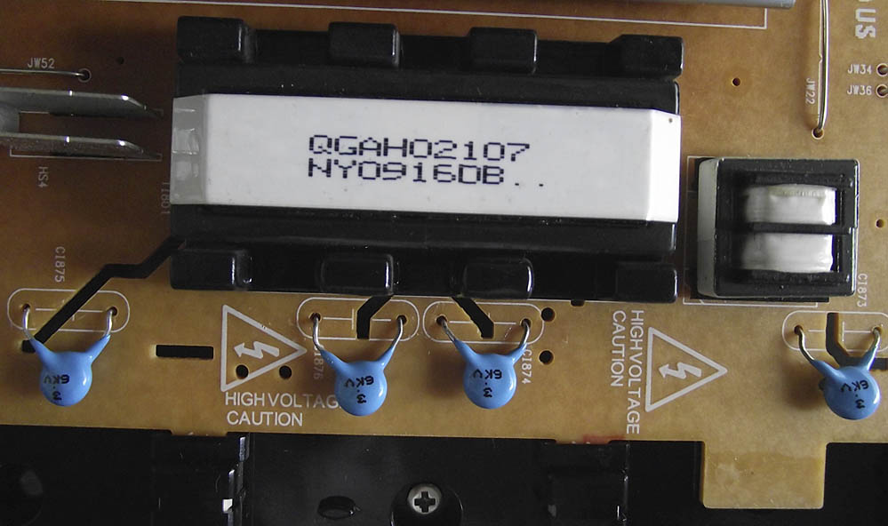

                It's not always the lamp. Sometimes the blue capacitors can fail open circuit. Try swapping the lamp connectors around: for example plug the topmost lamp into the socket below and vice versa - then see if the band is fixed (lamp failed) or if it moves (cap or transformer).
                  Oh, that would be an easy one, I guess!
                  But I will check them tomorrow - I already checked them for shorts in-circuit and nothing strange to mention.
                  As for stripping the enclosure with the lamps, not the easiest jobs.
                  I know another friend who also has exactly this same model, and I guess this would be some sort of a stock fault that I will have to repair sometime again.
                  It would very nice to fix this one first.

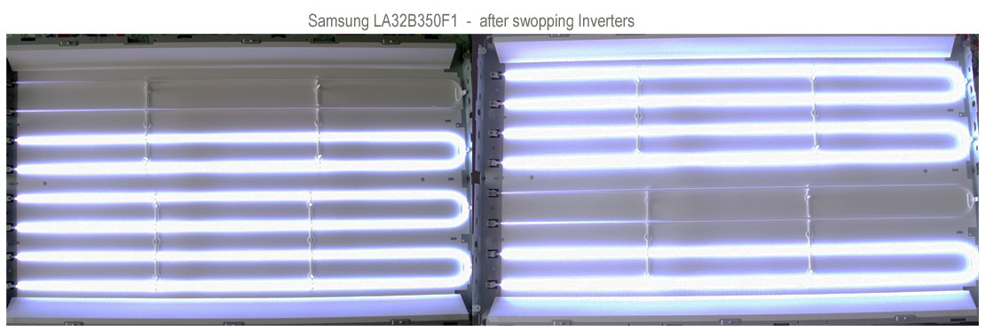

                  • burntfingers
                    • Jan 2011
                    • 148
                    Checked blue caps - 3pf 5kv - OK.
                    Swopped lamps, same result: top one not on.
                    Swopped inverters, top lamp now OK, third not on.
                    [Still on only for a second]
                    Conclusion: faulty inverter.
                    Must I replace both?
                      Are you sure about 3pF? That's very low. Typically it's 20-50pF.
                      • burntfingers
                        • Jan 2011
                        • 148
                        Actually 3pf, 6kvolts.
                        Check proof.
                        • PlainBill
                          • Feb 2009
                          • 7034
                          No. the transformers, part number QGAH02107, are available for $20 on eBay. I suspect you did not measure the windings correctly. There are two secondaries on each transformer, it is almost certain one of them is open.
                            Interesting CCFLs. Never seen curved ones like that.
                            Anyhow, note how the faulty inverter output is very dim but it is lighting up slightly; this generally rules out a driver problem. Double check the secondaries as PlainBill suggests but also check the wiring and the orientation of the connector (it sometimes matters which is white and which is pink/blue/other.)
