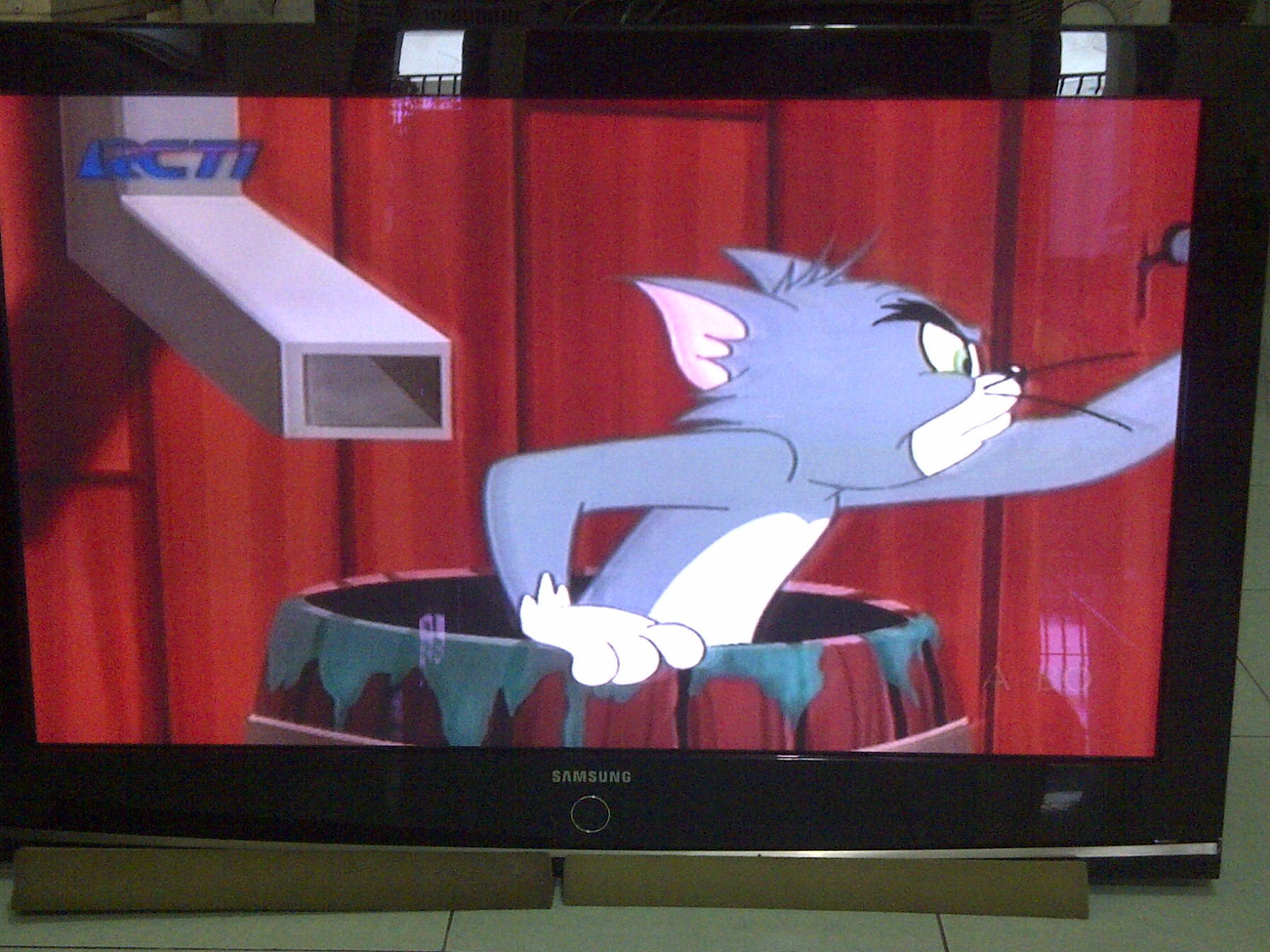

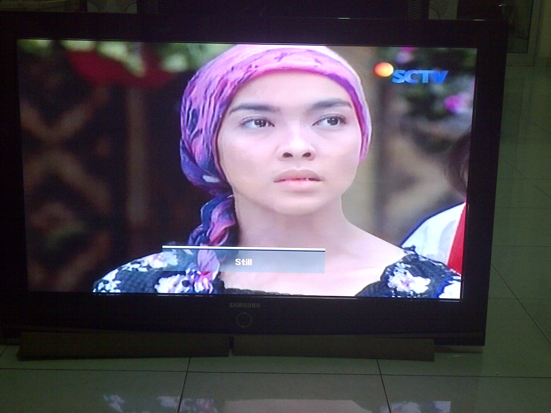

Hi, I have a similar plama samsung (ps50c96hd) and the picture is very bad.
I'm new in this forum so i edit this post, sorry for that...
The picture :
With no signal there are grey point :

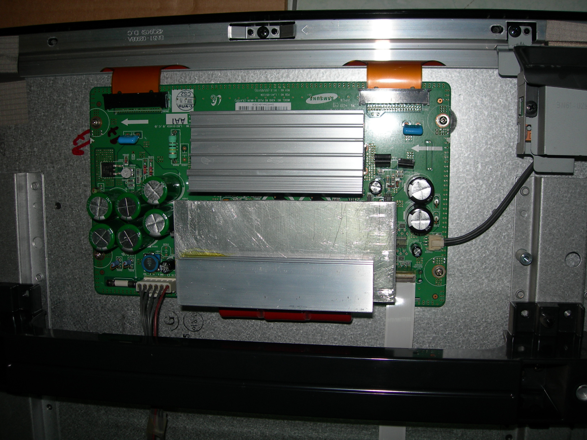

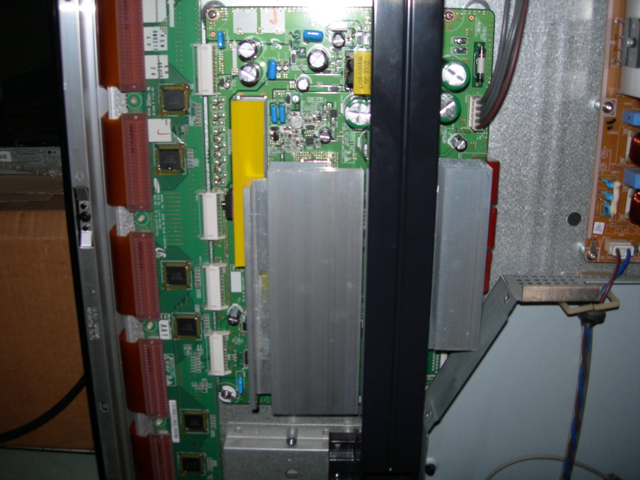

I have control all the voltage (Vs, Vsc, Va, Ve...) all is good.
On the Z card (on right) i just replace a capacitor (25v 680mf) but no effect.
I have change the t-con module but no effect...
If you can help me plz
