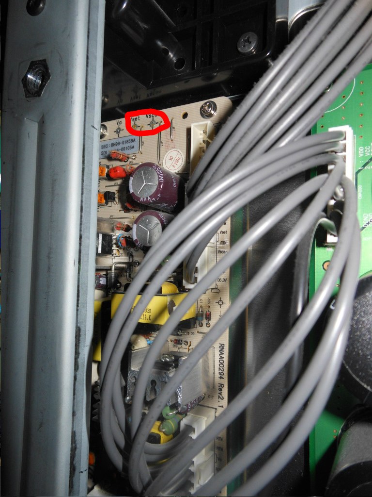

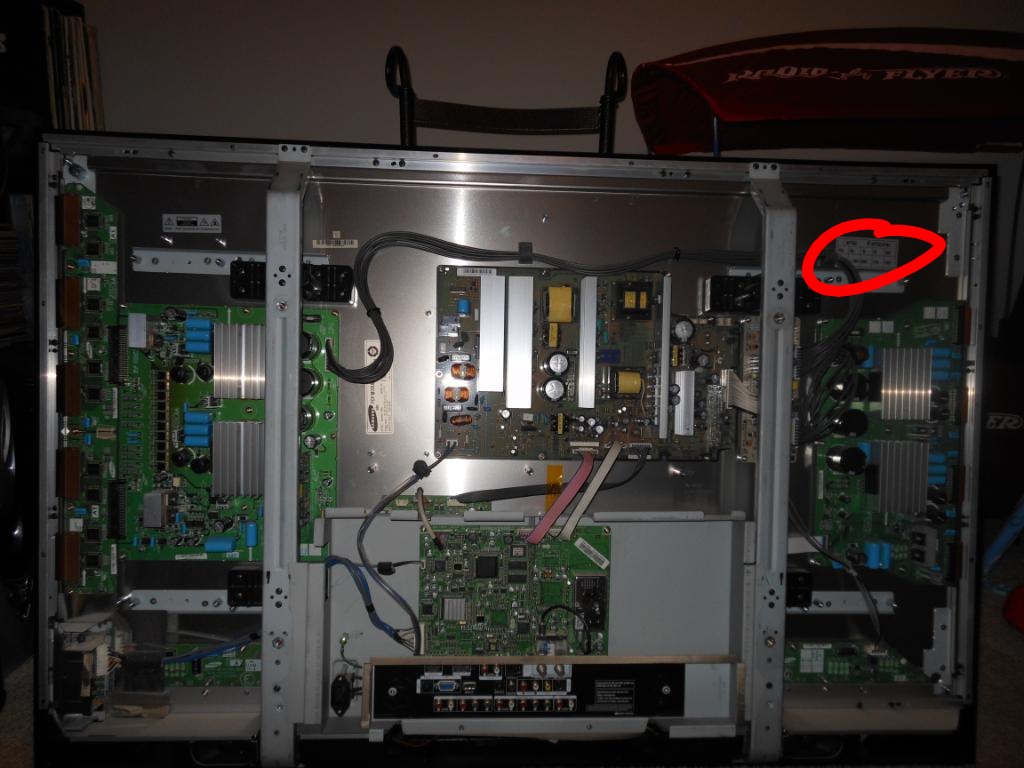

      Re: Samsung 50inch Plasma - colored sparkles (videos in thread)
      It took a bit of looking, but yes there is a YFR as well. Its hidden under the metal brace. You may be able to see it from one of the pictures (possibly the side shot that i did), but if not i can snag a picture of that too. Its a tight space though for sure.
      Its located on a board which extends vertically out from the Y SUS board, sort of like a daughter board would.
      Does that make sense?

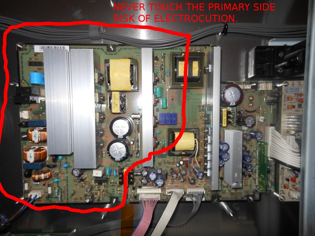

            I want to see the power supply, around the area where the connectors go from the power board to the sustain boards on the left and right of the TV (usually the place where the potentiometers are located.) I also need to make sure your multimeter is capable of measuring the 200V or so present on these boards. Most are, but a few aren't.

              this is the power board i'm assuming?
              another shot of it
              trying to get the left and right side angle (respectfully) so you can try to see behind the brace
              I believe this is where power comes into the Y SUS board
              connections from what i think is the logic board (has most of the inputs on it) to the power board
              this is a connection coming from the bottom left of the power board to what appears to be the power cord connection
              another shot of the power board connecting to another board in between the power board and the X SUS board (i think)
              X sus
              here is the tv as a whole

                Okay, so you have a "China special" DMM. That's okay, but be careful as the probes on these are very dodgy, you can easily slip. Most of the board is safe to touch, apart from the Vs side, and the primary side (where the mains input is.) Still, avoid touching any of it, just in case. I've highlighted the approx. area of the primary side.
                For this test, and all future tests unless otherwise indicated, set your multimeter to the 1000V DC range. Move the red lead from the 10ADC jack to the V/ohm/mA jack.
                Pic #2 - There appears to be a sticker here. What are the voltages indicated?

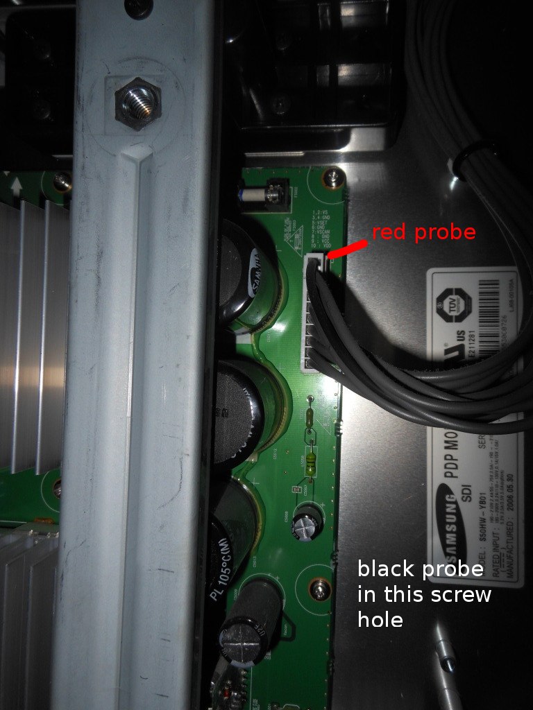

                Now, the adjustments:
                On the sticker you will see a voltage labeled Vs. Do not confuse this with Vset. Vs is typically 180 - 220V DC.
                Connect your red probe to the highlighted pin, and black probe into the screw hole. I find it's helpful to try and jam the probe in there, as it will stay there if you apply a bit of pressure. The black probe can sit in the hole. The metal panel is safe to touch, it is grounded.
                Measure the voltage. If it is more than 1% out, I would adjust the corresponding Vs potentiometer. Adjust it up very slightly (just a quarter turn, at most.) If it goes down instead of up, reverse the direction of the turn. Turn it until you are satisfied it is within about 1% (or around 2V of the sticker rating.) Don't expect the picture to get immediately better - this TV appears to use at least 5 different voltages and each must be set to the factory default for it to work well.

                    Vs was 211-212 prior to adjustment
                    i got it down to 201-204 depending on how i hold the red tester, lol
                    this has made the overall picture worse.
                    i'll post a quick vid of that momentarily.
                    i have have also now gained a noticeable "bar" of what appears to be more blue sparkles on the left side of the tv.

                            I just noticed this point is for Vs, use this instead and tweak to the rated 203V. Try and get it as close as possible.
                            Then, do the same with Va, but tweak to its rating (55V - 80V). Try switching your meter to the 200VDC range - you'll get an extra digit of resolution. Unfortunately we can't do this for the 203V Vs voltage because it's 3V over the 200VDC limit. Although no harm would be done to the meter it would just show over-load... There's also a nice Va test point. Remember not to touch this test point or the Vs test point it can give a nice (or nasty) shock...
                            Note the Va reading before you tweak it in case you have to return it to the technicians' settings.
                              the sticker for Va is 65 which i have set it to ... it wasnt far off to begin with ... around 63 ish ..
                              Vs is now a solid 203

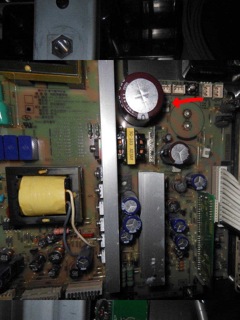

                                  Noticed that the cap in his first picture [top right] looks bulged. Might just be camera angle. Just though I would see if he noticed it?

                                    tweaked the YRR and YFR a little bit each experimenting back and fourth and have eliminated all the sparkle that was brought back from adjusting the voltages from earlier ...
                                    there are still sparkles there however ... i'd say it looks better than it did before i started, but still not "sparkleless"
                                    now what?
                                    also the blue bar i was talking about earlier (that you can also see in the video) has mostly disappeared however a small portion of it remains in the lower left hand corner.

                                        I noticed that too, but wrote it off as the camera angle. However, I would think a bad capacitor could cause sparklies. OP, with the set off and unplugged, feel the capacitor - if it feels slightly bulged it might be failing. Now, it's a Chemicon, which is a high quality capacitor, and I haven't seen these caps fail yet... but I wouldn't write it off as being impossible.

                                          Try adjusting Yrr only, turn it about an eighth. Yfr doesn't have much effect on sparklies.
