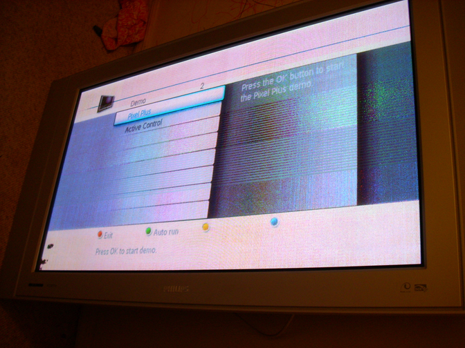

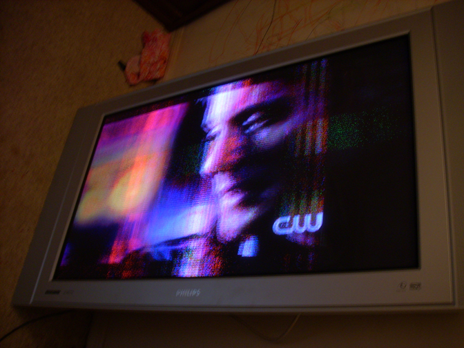

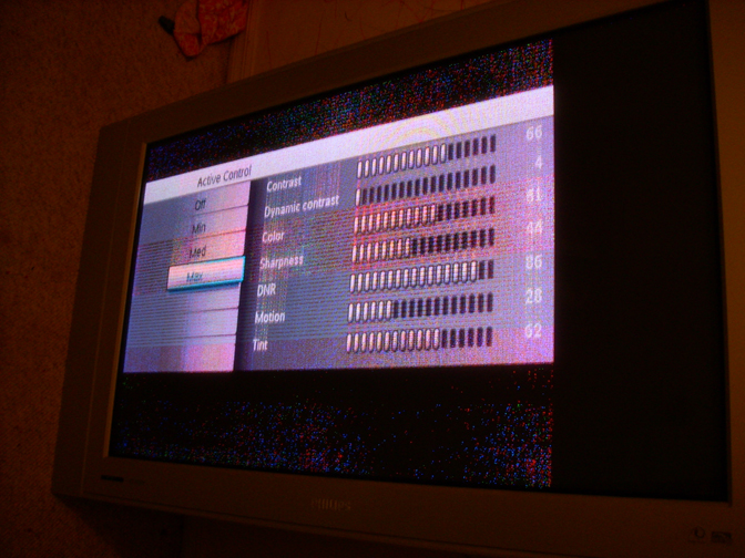

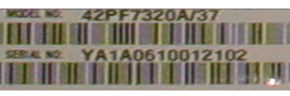

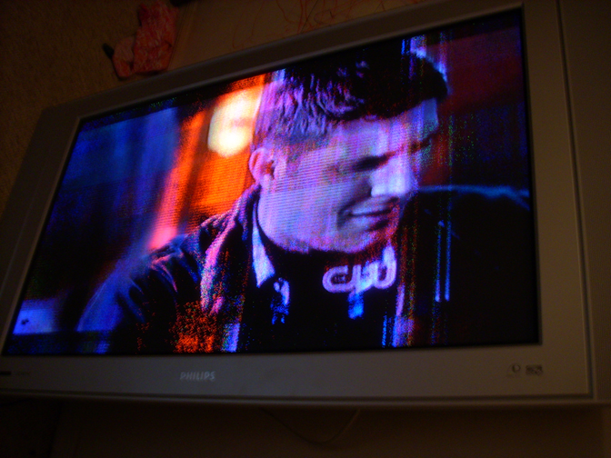

    Picked up this TV and need some advice
    I have done some research but am looking for advice on how to fix
    I have read that the buffer boards go bad on them.
    I have attached some pics
    could anyone please take a look and tell me what they think

      It's probably buffers, or it could be the main logic control board. Main logic control boards (LJ92-01270A) are available for as little as $10 with free shipping on eBay; a pair of Y buffers will cost $150 and up.
      I have a pair of these sets, they have a nice picture, but the buffers are a very weak point. Given the cost of a pair of buffers, the age of the TV, and the price of a new 42" plasma, I'm not sure I would recommend repairing it.

            There is an extensive discussion of this plasma panel (and it's support cards) on the Coppell TV Repair blog. If you are standing behind the TV on the left hand side of the TV is the Y-Sustain and Y-Buffers. The buffers are the long narrow boards with 6 ICs (and usually heat sinks) on each. These buffers handle voltages ranging from +200 to -200, so be very careful when power is on.
            A common failure mode is one of the buffer ICs shorts. Due to a poor design, the surge is transmitted to both the other buffer and the Y-Sustain, damaging them. IF a buffer shorts, the recommended approach is to replace both buffers and the Y-Sustain at a total cost of about $250. Then sell the TV quickly in case a replacement buffer fails.
            The pictures would indicate both buffers are compromised, or the main control logic card is defective.

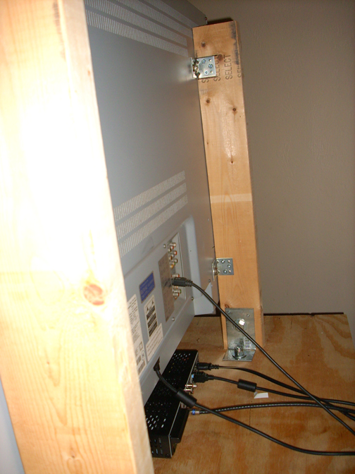

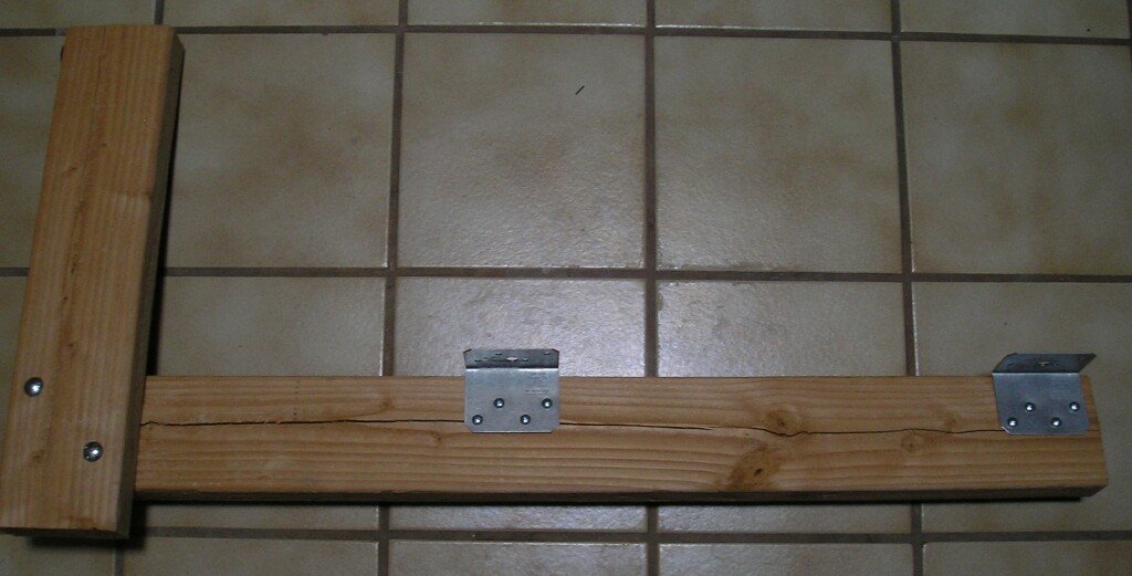

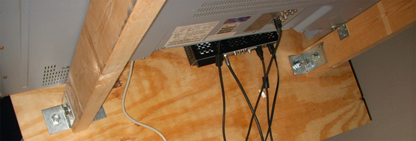

                        My question is being that I found this TV I need a pedestal stand for it. After checking the prices for the actual stand I know I can build one for cheap.
                        Does anyone have DIY Tv pedastal stand that can support this TV.
                        I am looking to build a stand and then put it on top of a dresser.
                        I do not want a wall mount.
                        any suggestions ???

                            These Philips TVs are an entirely different panel than the LG sets and the IPMs on this model are entirely different than the LG IPMs.
                            The lines are a symptom of worn out buffer ICs or some other component on the buffer. The washed out image looks as though the timings on the Y-main are bad. You will need a training manual for this panel and an oscilloscope to adjust the timings if they are indeed wrong.
                            You will not find any problems or shorts with a meter on the buffer boards until they have completely failed. By then you will have to replace the Y-main and both buffers.

                              How elegant do you want it? I built a work stand out of one 2 x 4, 4 drive in nylon feet, 4 angle brackets used in home construction, 16 screws and 4 5/16" carriage bolts. Here's a picture of one, the other is the mirror image. Use wood glue where the pieces of wood cross. Dress it up with plywood or fabric.
                              My Great Grandfather was a carpenter. His specialty was fine cabinetry. He's spinning in his grave right now.

                                I really love the design. I had an idea how I wanted to do it, but after seeing the pic you posted gives me a better way to do it.
                                Thank you so much

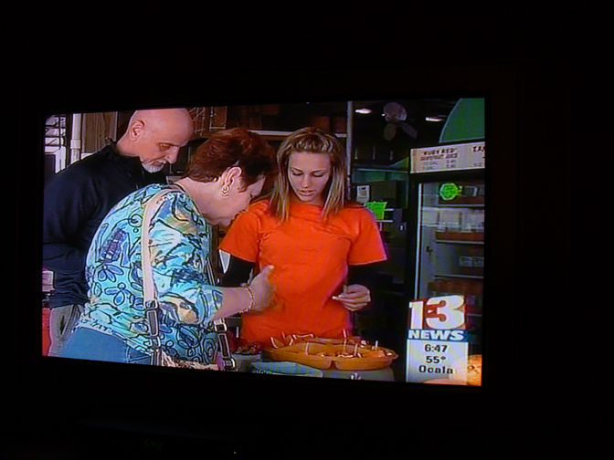

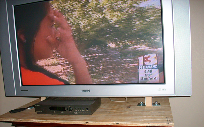

                                      Wanted to take this time to thank everyone for their advice.
                                      Parts came in and the picture is amazing.
                                      Also thanks for the tips on the DIY tv stand
                                      Here are some pics of the finished project
                                      Thank you all again so much. I could not have done it without the help from you all.
                                      • PlainBill
                                        • Feb 2009
                                        • 7034
                                        Re: Question on Philips 42" Plasma
                                        Neat adaptation of my stand design. Add little trim and it will look (almost) professional.
