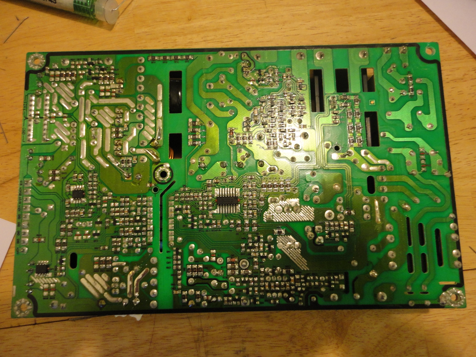

      Hi - Im just a learner myself so can only suggest obvious things. Have you checked that you put the caps in the right way round?
      Have you checked for poor joints?
      Picture of back of board could do with being a bit brighter/clearer so the
      writing can be read ( not easy when its black on green)
      I attach a pic of part of your board - on the bit circled in red the solder seems to bridge - is it supposed to?

        You made a number of mistakes which wasted time and money.
        1. The symptom - power LED goes from red to blue, no picture - is NOT typical of bad caps. It CAN be due to bad caps, but is more likely due to a bad main board, inverter, tcon.
        2. You are correct, caps can fail without obvious signs. However, when troubleshooting a problem where bad caps is not the most likely cause, replacing caps that have not obviously failed is a poor approach.
        3. When replacing caps, both brand and series are important considerations. Panasonic FR, FM, FC series caps are excellent replacement caps for use in a power supply. Panasonic M, NHG, and EB are unsuitable. A similar situation exists with Saxmon.
        4. The pictures are pretty good, but one important piece of information is barely visible. The output connectors are labeled on the back side of the board. With symptoms like these, one of the first steps should be to check if the proper output voltages are present. If, for example, +5.1V and +12V are present, but +24V is missing it is possible to focus on a small part of the power supply. If all are present, look to the main board as the cause of the problem.

          1. It seemed from my various searches on this model of TV that this symptom was typical of capacitors, but it is possible I was mistaken.
          2. Having read on here that the black CapXons tended to fail without showing any outward symptoms, and knowing that replacements would be in stock locally, I figured it wouldn't be a bad place to start. If this hadn't been the problem, I'm only out ten bucks in parts, and if I DO get the TV working, it won't be using low quality capacitors anymore.
          3. Nichicon PJ
          4. The board outputs all proper voltages for a couple seconds, then there is a slight click and they drop to zero.
          It does look bridged in the picture, but it actually isn't- even if it was, though, I believe the two are supposed to be connected (which you can see by looking at the printing on the PCB)

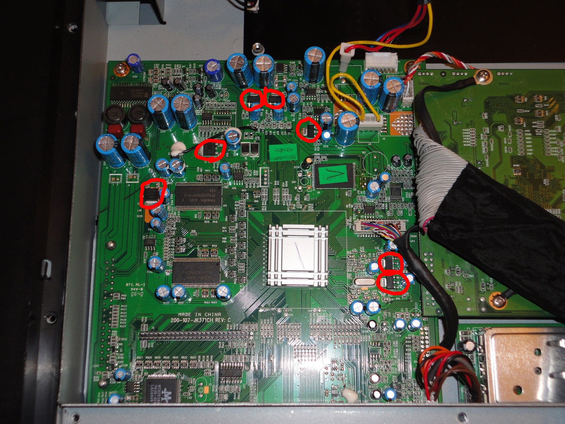

            Here are a couple pictures of the (visible side) of the mainboard

              Argh! Another Proview fail. (Crap TVs.)
              See picture. Press firmly down on main board near these pins and see if it starts working (while installed in TV of course.)
              They use some kind of stupid parallel port to connect the main board to the rest of the TV. When you unscrew the case to get to the main board and power supply, you loosen this connector and it gives strange symptoms ranging from no power LED, no sound, no backlight etc.
              I repaired a Bush TV which used a very similar design. It also had bad caps; the two 1000u/10V(?) ones near the upper transformer and one 1000u/35V. After replacing the caps I could not figure out why it would not work. I found it would work when upside down but not when upright! You can imagine my frustration. I then proceeded to remove the main board assembly and looked at the parallel port and thought nothing about it until 15 minutes later I realised why it wasn't working. Now works fine .

                  Do *all* the output voltages drop when the power supply appears to switch off?
                  In standby, are any voltages present? (There should be at least one.)
                  If the inverter (red+black only) connector is disconnected, is the behaviour different?
                  This problem can also be caused by a bad LDO. An LDO regulates voltage. I've highlighted several devices. For each device, read off the part # and ref-des (the letter+number on the board next to it, e.g. U5, U7...) Then, using your multimeter, measure the voltages on each pin relative to the metal case of the TV. (Do this while the TV is trying to switch ON (LED is blue.)) No need to measure the metal tab; it's internally connected to the middle pin.
                      Sorry, should have mentioned that the +5VSB is behaving as it should. It does the same thing whether or not the inverter is connected. I'll go check on the LDOs right now.
                      • pattheslat
                        • Dec 2011
                        • 25
                        Re: Polaroid FLM-373B Power LED but no picture, already tried replacing caps
                        Readings from the LDOs, taken left to right if pins are facing downward:
                        U3: 0, 3.30, 5.15
                        U4: 0, 1.798, 3.30
                        U5: 0, 3.29, 5.12
                        U6: 0, 1.798, 3.28
                        U7: 0, 3.28, 5.14
                        U13: 0, (no pin), 4.34
                        U33: 0, (no pin), 3.53
                        One thing that seems strange to me is that I was reading these voltages even after the power supply cut out and wasn't supplying any power other than the +5VSB.

                          Those voltages seem okay but could you redo U13/U33 but use the tab for pin #2?

                            Sure thing, U13 is 2.506, U33 is 1.950

                              What's the part # (1084xxxx) on U33? Strange reading there - closest is 1.8V or *maybe* 2V (But I haven't seen that before. Not a common voltage.)

                                  U13 is 1084-25PE 96315, U33 is 1084 PE 35419.
                                  I found that service manual earlier, has to be the most worthless one I've ever seen. Its solution to most problems seems to be "replace control box".
                                    Most of the cheap brands are the same, they don't care about the customer.
                                    Is it possible you are mistaken in reading 35 and it could be 33? Either way, that regulator is most likely bad and could certainly cause your problem.
                                    Vizio TVs have a problem with a certain U33 failing, but I think that it is a coincidence that it happens to have same ref des.
