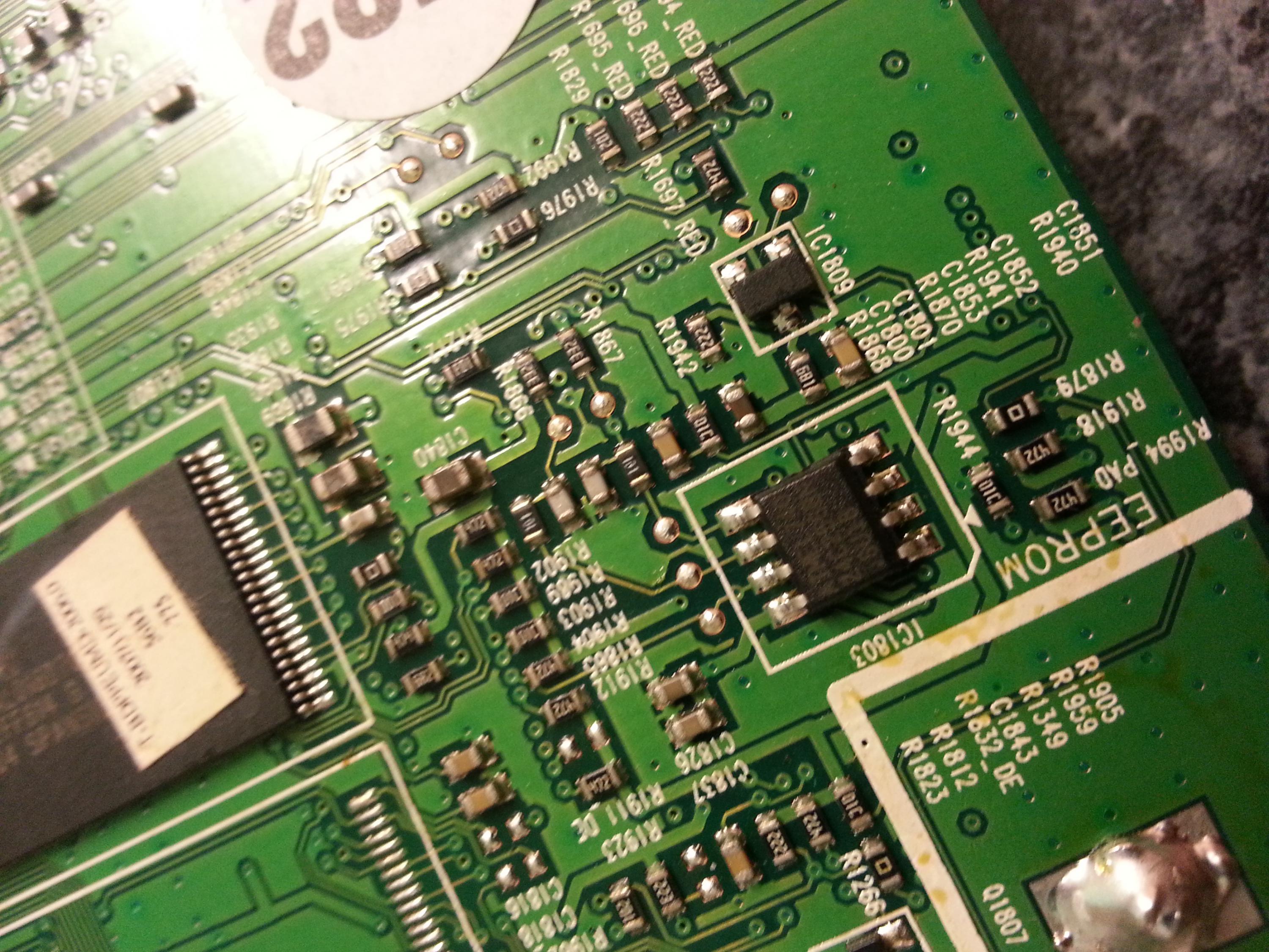

    hi I have the same problem with this how do u tell what pin 5 and 6 are ? there is 4 on top 4 on bottom with the writing facing the readable way ?
    • selldoor
      Slow Learner
      • Dec 2010
      • 7870
      Re: SAMSUNG LCD 40" does not turn on
      No one has managed to post a picture of this eprom or where it is on the board
      Can you do that?
      On the board one of the pins may be marked - "1" or with a white dot. Similarly the
      eprom may be marked with a dot for pin 1
            There it is
            • selldoor
              Slow Learner
              • Dec 2010
              • 7870
              Nice one Vince - still not sure as there is no A series fix BUT it does say the white triangle indicates Pin 1
              Just as an aside in case I forget when I enlarge pic post25 the tiny trace from pin 7 to
              R1865 looks broken - can you continuity test it.
              Adam is your tv an A series same as OPs
              Actually if you google eeprom short pins 5 and 6 there are quite a few hits
              The first thread has a blow by blow way of doing the shorting while switching on. As Vince says its at your own risk - may be safer taking it off the board and doing a reset?
                or may be buy a replacement eeprom not sure if they come blank and it re writes the data back when you turn it on or if there preprogrammed.There isnt much info really for the A series listed.
                • adamp91gvm
                  • Jan 2014
                  • 706
                  • uk
                  Hi all I reset the eprom last night tv came on but no pic im goin to check the t con tonight
