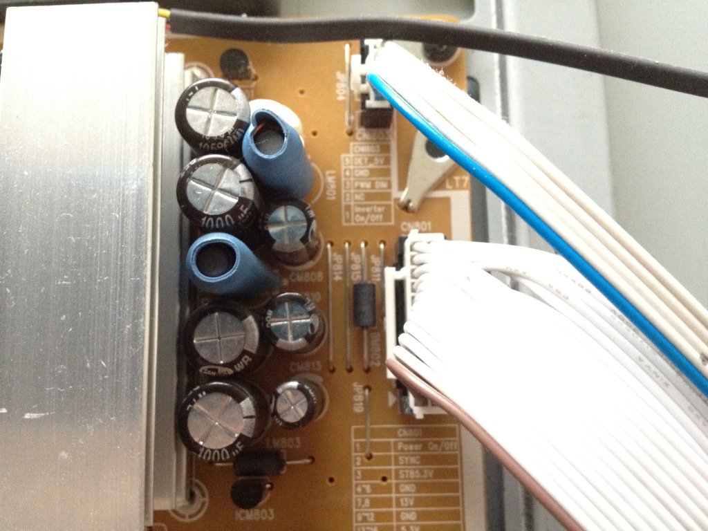

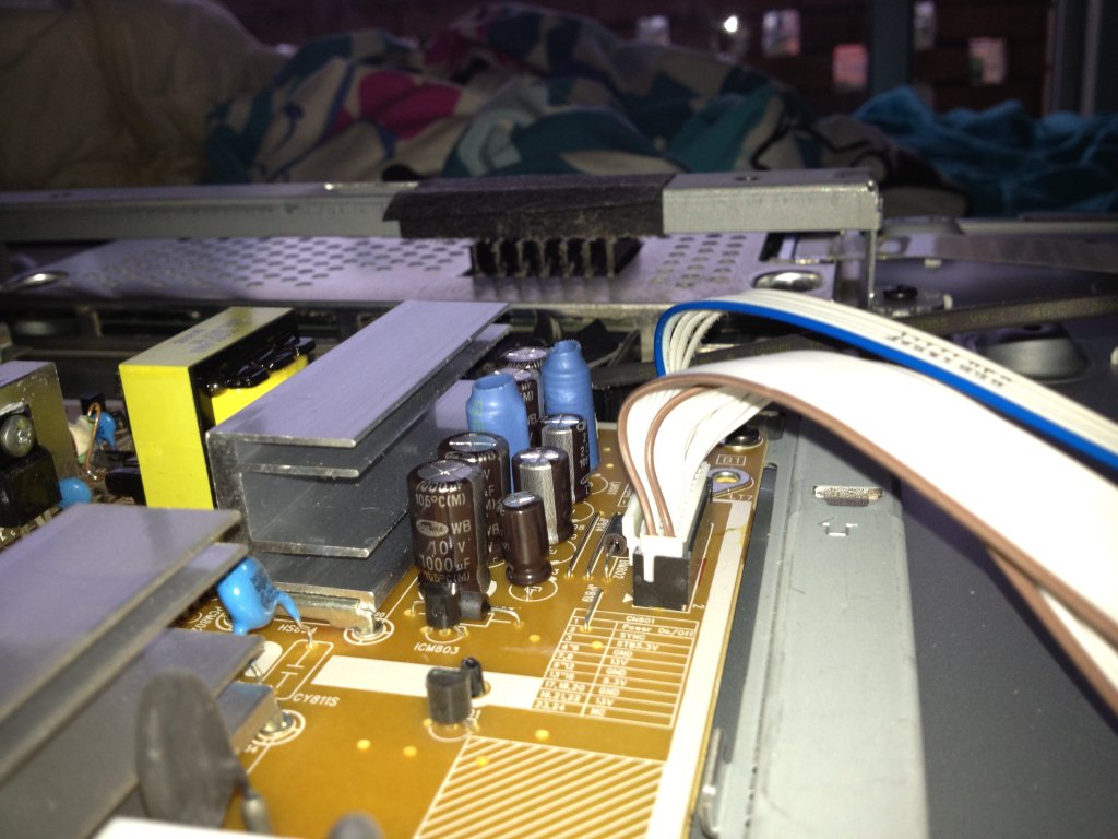

    As many of you, I started having issues with my Samsung LCD 40".
    The TV set has been working fine for the past 2 years, but since I came back from abroad after 15 days off, I am not able to turn it on anymore.
    Upon pressing the on/off switch, the TV makes the clicking noise and the intro song, the screen kinda turns on (but is still black) and no image appears. The on/off led then starts blinking at a rate of 5 blinks/sec and the sound works fine. http://youtu.be/mtYxzxAXroE
    I tried to open the TV set to check for popped resistors but apparently everything was fine; anyways, I replaced all (but the small one) capacitors shown in the picture with new ones, to no avail.
    Is there something else I can do to bring this TV from the dead? I'm in Australia and Samsung will not fix it because it's an overseas model.
    If you guys have any ideas I would really appreciate.
    Cheers

    Re: SAMSUNG LCD 40" does not turn on
    Forgot the pictures, there it goes...

      You might need to do an EEPROM reset. Post a picture of the main board.

                Be very careful about doing anything inside your TV. You have no understanding of what to do or why you are doing it.
                Check to see if there is a very large off/on switch inside the TV. If you find it check to see if it is in the "off" position. If you can't find it (and you can't because it's not there) then take your TV to a local TV shop and ask to get it repaired.

                    Hi, I had a similar problem with my LE40R86BD, after changing the bad cap, I pressed the power switch on the TV panel & plugged the power, hold the switch for 2 minutes and the TV will be ON....hope this work...

                              Guys,
                              Just wanted to thank you all for the tips. The TV is working again.
                              All I did was to reseat all cables and leads, and once I plugged it in it was all good!
