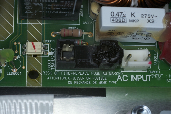

    My 50" plasma, a Phillips 50PF7220A/37B, has the seven red flashing lights.
    I bought this as a factory refurb 5 years ago and had no problems up to 18 months ago when I lost picture and sound, I don't remember if I got a constant or red flashing light but I opened up the back, checked the fuse next to the power input, it had blown and replaced it. It worked again.
    Couple of days ago it stopped working mid session. Red flashing light so I unplugged the power, left it for 30 minutes or so and more in hope than expectation I plugged it back in and it worked. Woo Hoo.
    My joy was short-lived as the fallowing day it stopped again and this time no amount of power off/power on would resurrect it. Opened it up and found that one end of the fuse holder had melted (See first photo) I can't tell if the fuse had blown as the end cap came off as I levered it out of the holder. I realize now that I should have checked first but be kind I'm new to this.
    I have replaced the fuse holder and put in a new fuse, a SLOW 250VAC 8A 5X20 As I had had the foresight to get 2 when the original had blown but I still get the seven red flashing lights. I've had a good look at the tops of the caps and none look blown to my untrained eye. Other than replacing the component immediately adjacent to the fuse holder that has heat marks on it (haven't done that yet) I'm not sure where to proceed.
    FYI I can follow directions, well I like to think I can, I'm reasonably competent with a soldering iron and know how to check continuity with a meter.

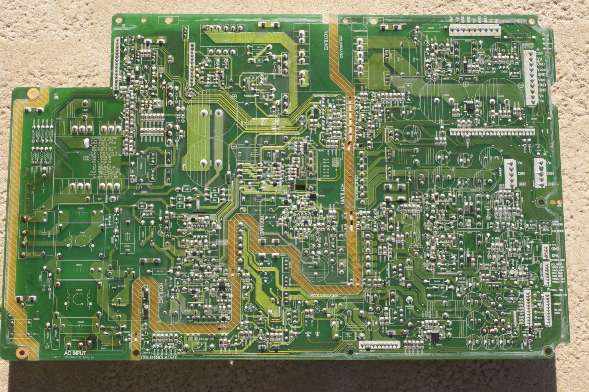

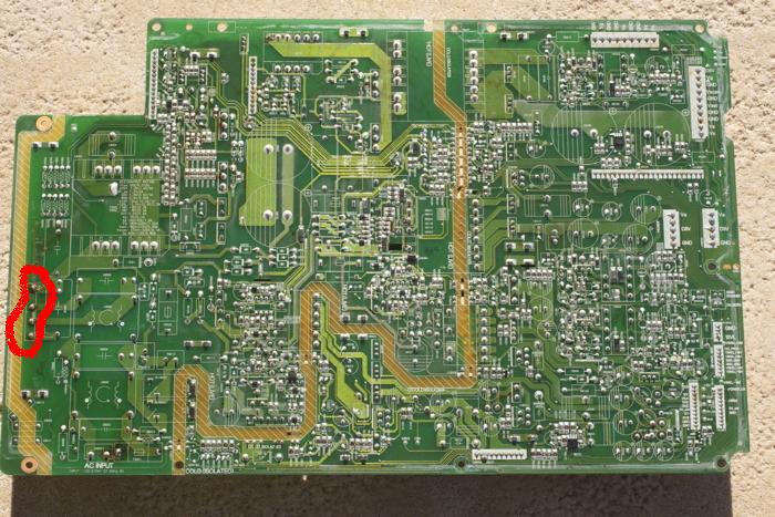

      I have removed the power board and can post a picture of the underside. Know of any source for new boards in the event this one is beyond repair?

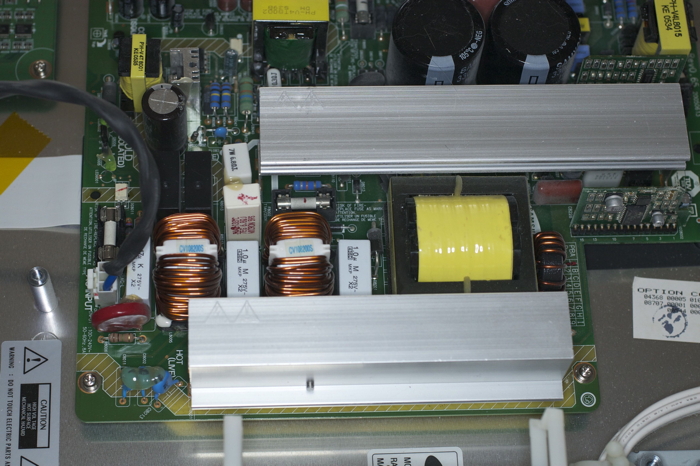

        I need a photo with a higher resolution; I want to be able to read the individual lettering on the board.
        Generally when you get an extreme failure like that, it's very good, because it means the fault is usually one single component which has had enough. And that's a simple repair.

          Re: Phillips 50PF7220A/37B - seven red flashing lights.
          1) Your bridge rectifier may be what I circled in red. It should start with BD101 or BR101 on the pcb board. Number the pins 1, 2, 3, and 4. You can perform this test "in circuit".
          Measure the resistance between pins 1-2, 1-3, 1-4, 2-3, 2-4, and 3-4. Any reading less than 30 ohms suggests a short and warrants desoldering and verifying out of circuit.
          2) Your power mosfet is likely a 3 pin IC and starts with "Q" and mounted to a heatsink.
          3) Your pics can be up to 2000x2000 resolution and 2MB. This allows us to see more and makes identifying components easier.
          BTW, please do not post inline. We can click on the thumbnails to view the images.
          edit: tom66 beat me by 1 minute regarding #3.

            Thanks. I read the FAQ's and downsized the image only to realize that I could have left it a lot larger.
            I hope this revised one helps but if you need an enlargement of a particular portion of the board let me know.
              The component you circled is at D8006 on the circuit board and is sandwiched between a large and small heatsink. I'll see if I can find a link to a service manual with a circuit diagram.

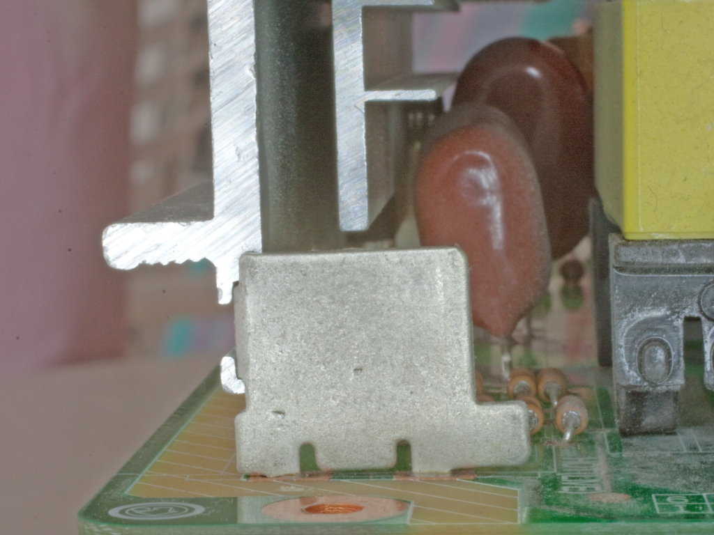

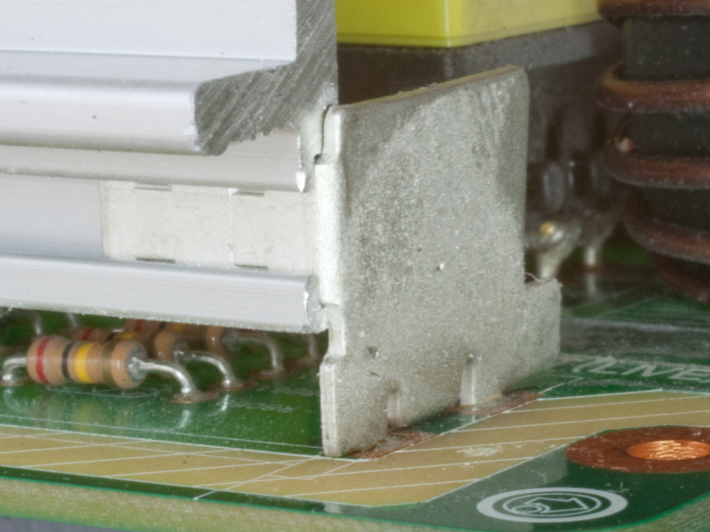

                      Desoldering help needed. The bridge rectifier I'm trying to desolder is sandwiched between two aluminum heatsinks. The smaller heatsink is screwed to the larger one with the bridge rectifier between them. The large heatsink is attached to a pair of two legged clips that slide into it and the clips are soldered to the board.
                      I've desoldered the bridge rectifier but I cant move it until I desolder the heatsink clips. When I try and desolder the clips, the heatsink is doing its job too well and I'm having a problem getting the solder to melt. I'm concerned that I'm going to damage the board by overheating it so my question is :- Is there a technique for desoldering these clips?
                      I cant see any way to remove the clips from the heatsink but I could cut the legs off the clips but then there is the problem of finding replacements ....
                      HELP PLEASE.

                        I'm no desoldering expert, but I have heard some people use a heat gun to warm up the bottom part of the pcb to make desoldering easier.
                        Post a picture so people know what you are dealing with as well.

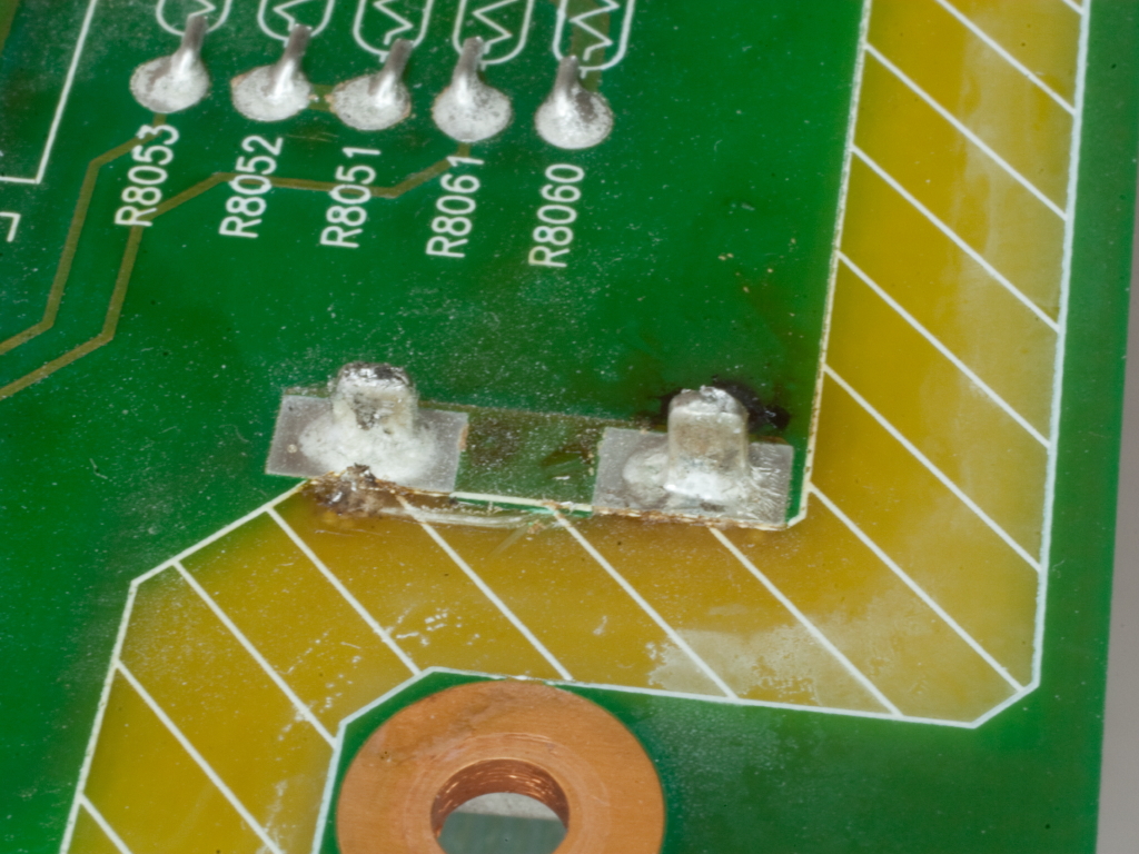

                          Pictures as requested:-
                          Pic # 010 is the clip showing the side sliding into slots on the large heatsinks.
                          Pic # 011 Shows both large and small heatsink. The dark shadow between them is the bridge rectifier.
                          Pic # 012 Is the underside of the PCB with the legs of clip.

                            Does your present iron melt the solder, even a little bit? If it does, a product called Chip-Quik will work. It forms a low melt alloy with solder.
                            What wattage iron are you using? I wouldn't tackle this with anything less than a 40 watt iron; 60 might be better.

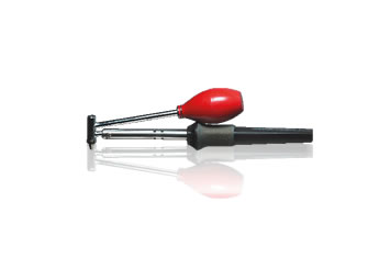

                              I have 2 irons, a 30W and a 45W Radio Shack desoldering iron (see below). The 45W will melt the solder a little so I'll look for some Chip-Quik. Thanks.

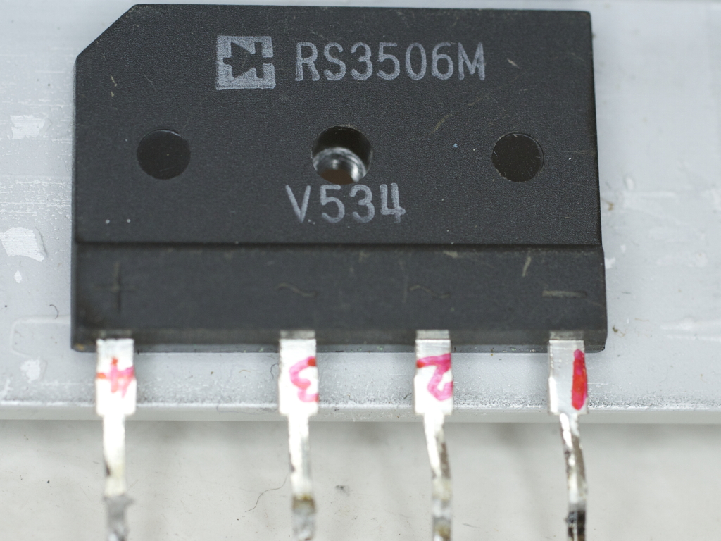

                                Thanks to a good application of Chip-Quik I have managed to remove the heatsink and bridge rectifier (picture below). Retested with results below:-
                                1-2 .66 Ω
                                1-3 18.0 Ω
                                1-4 20.0 Ω
                                2-3 12.6 Ω
                                2-4 13.0 Ω
                                3-4 13.7 Ω
                                A little different from the readings I got when the component was soldered to the board but more importantly, now what?

                                  Your readings definitely indicate a short circuit. You will need to replace the bridge rectifier with one of the same type. Now, please test the primary transistor(s) to determine whether they need replacement as well. It's pretty rare for a bridge to blow by itself, but being sandwiched between two heatsinks like that it might have failed due to the heat alone.

                                    Can you redo the test on diode mode? It definitely looks shorted.

                                      1-2 .428 v
                                      1-3 .428 v
                                      1-4 .747 v
                                      2-3 OL
                                      2-4 .410 v
                                      3-4 .408 v
                                      Nothing between pins 2 & 3.

                                        To test a bridge rectifier with the diode test, you should get 8 results because you have 4 diodes. It helps if you look at your bridge rectifier and the symbols and compare it to this
                                        http://upload.wikimedia.org/wikipedi..._rectifier.jpg
                                        You want to test each diode in both directions. One direction should be between 0.3 and 0.7V and the other direction should be 0L for a good diode.
