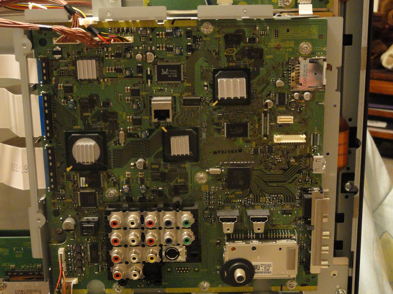

    The service manual blinking light code indicates a failure of the "A" board (main board) but at an interval of 3 seconds.

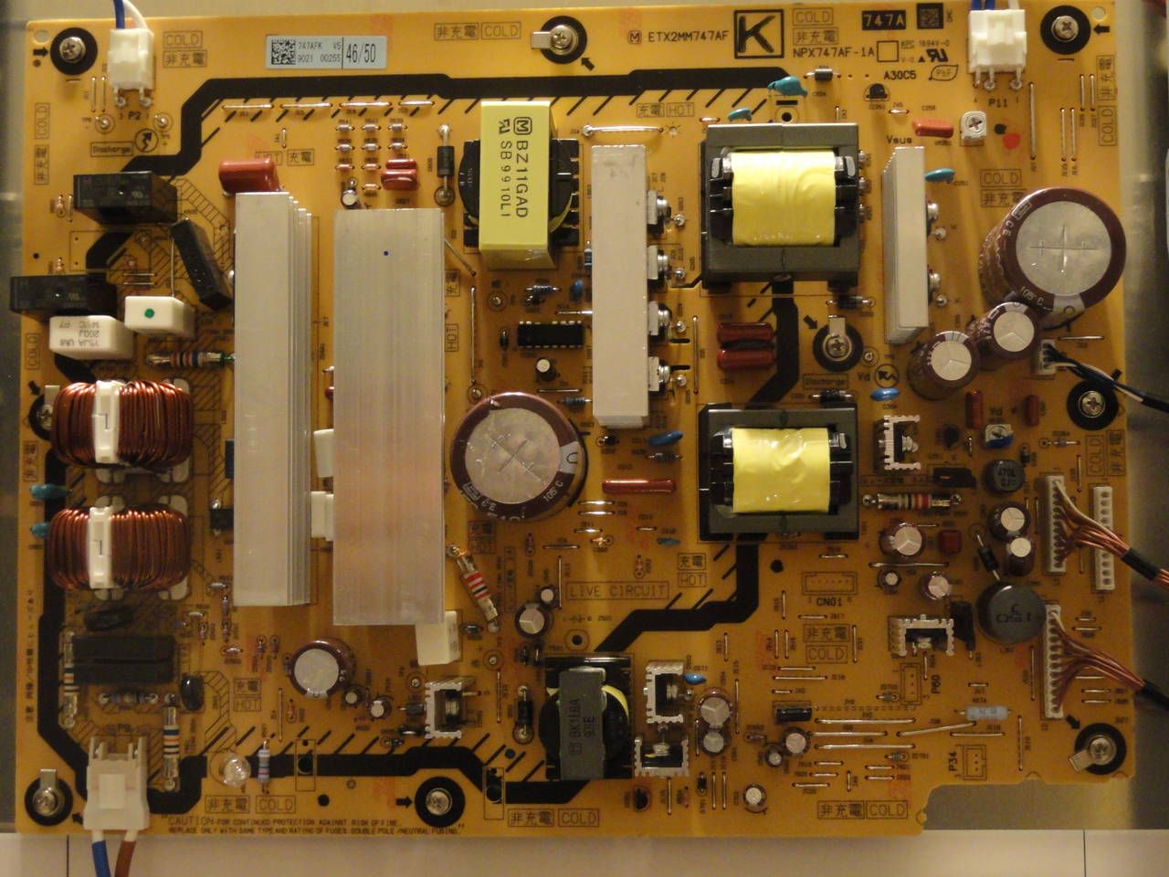

            I'm working on this TV and don't ask, but I shorted out D503. I now know it is a double diode, a zener in one direction and a regular diode in the other. (wish I knew that before!) But anyway, I need to replace it. Would you be able to tell me from your manual what part number it is? The number I read on the diode is T3D9 1 I can't find a cross for it anywhere. Thanks in advance!
              I need more info like what board?
              If you're rebuilding a SC, maybe you'd like to go through this post and share any info you may have. TC-50PS14
              EDIT: Ok, I think I know which board. The P-board VXST3D82BL3 is the full number, location D503. I think I've looked for something like this before, took forever to find for a PC PSU.

                Ok, I got it. TRANKILLER ,Power Clamper, ST03D-82, by Shindengen
                β€’Power Zener Diodes with FRD
                On another Panasonic PSU, I have 120V diode, in cct it bells short, 1ohm across but sits across a transformer winding. No idea how they should test out.

                    I was just reviewing the drawing that was attached to an earlier post on this thread, specifically, page 002. The schematic shows the D503 as being a common anode configuration, the ST03D-82 is a common cathode! I'm glad I didn't install it yet. Now I'm back to the drawing board, maybe I can get some more info from Shindengen, that's where the data sheet came from. In the mean time, if anyone has an exact part number for the D503, I would be much obliged!
                    This diode is on the main power supply board ( pic # 2 on first of this thread)

                      Using a Tektronix Curve Tracer in the AC mode, I noticed that in either configuration, the zener continues to fuction as a zener and the rectifier acts as a rectifier. I'm a little confused, maybe it doesn't matter?
                      tw2005, did you get the p/n from the actual shop manual? Cliff, does it say in your shop manual the actual p/n?

                          Thanks tw2005. I just got thrown off by the contradiction in the schematic when comparing it to the datasheet. I'm going to give it a try. I appreciate you help with this. I would love to get this set going!

                            Update:
                            I replaced the diode with the one I made up, now I'm back to my original problem, solid red light, lots of clicking relays, the boards on either side of the p/s have solid green led's lit up, but no picture or sound.

                              Re: Panasonic TC-P50G15
                              So the panel is energised? Do the relays click like it's resetting and restarting all the time?
                              Sounds like it could be the A-board. You could try disconnecting all the ribbons from the A-board, power from the SC, SS and any power to the C buffers and powerup and see what it does?
                              I have done this on a 2010 HD model to prove the A board was ok and the TV just turned on normally minus a a picture.

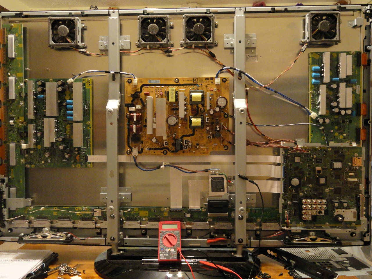

                                    Sorry for the delay. I'll start from the beginning, I found this TV at the dump, so I don't know the back story...
                                    When I first plug the set in, I get a single relay click, then after a few seconds, I get a second relay click. Then, I hit the Power switch, I hear the relay again, the backlight is activited (dim, but definitly on) and when I look in the back, the boards on either side of the p/s have green LED's on. The Red power light stays on steady, no flashing.There are no Video outputs on this model, so I can't try another monitor.
                                    Here's where it gets a little weird, when I shut the set off using the Power button, the Red light goes off but the backlight stays active for about 30 seconds, it does eventually go off. I also noticed that when I hit the Power button directly after shutting the unit down, it won't come back on right away, I have to wait about 30 seconds. And then when it does come back on, If I hit the power button, it doesn't seem to do anything, the Red light stays on, eventually it will shut off.
                                    I don't have a shop manual for this, does this sound like it could be coming from the p/s? I wish I had a manual that would tell me what measurements I should read on the testpoints on the p/s.
