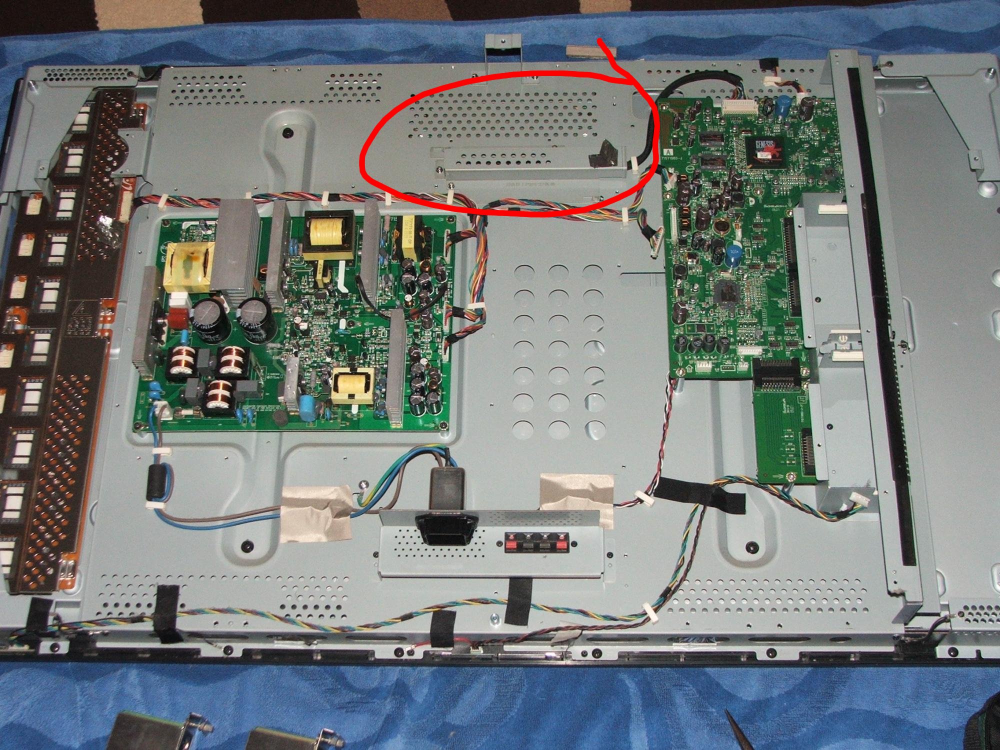

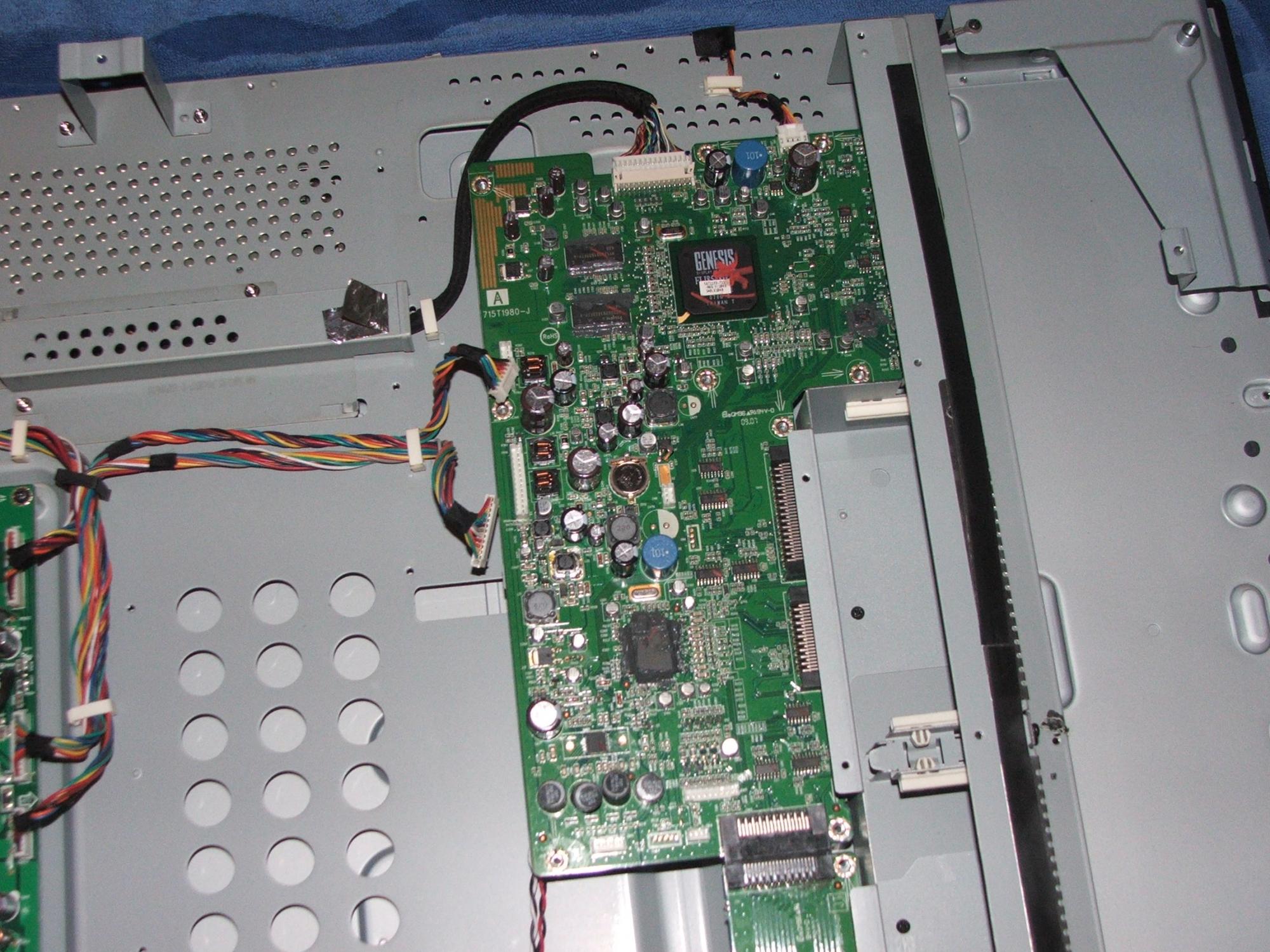

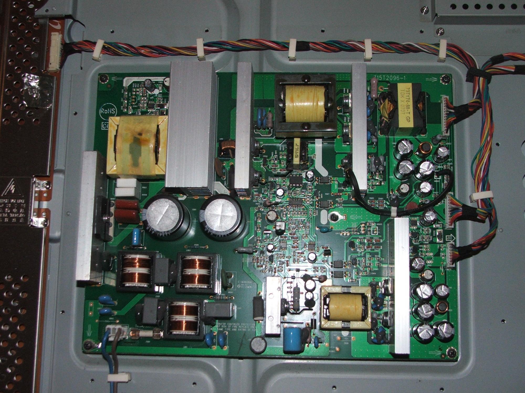

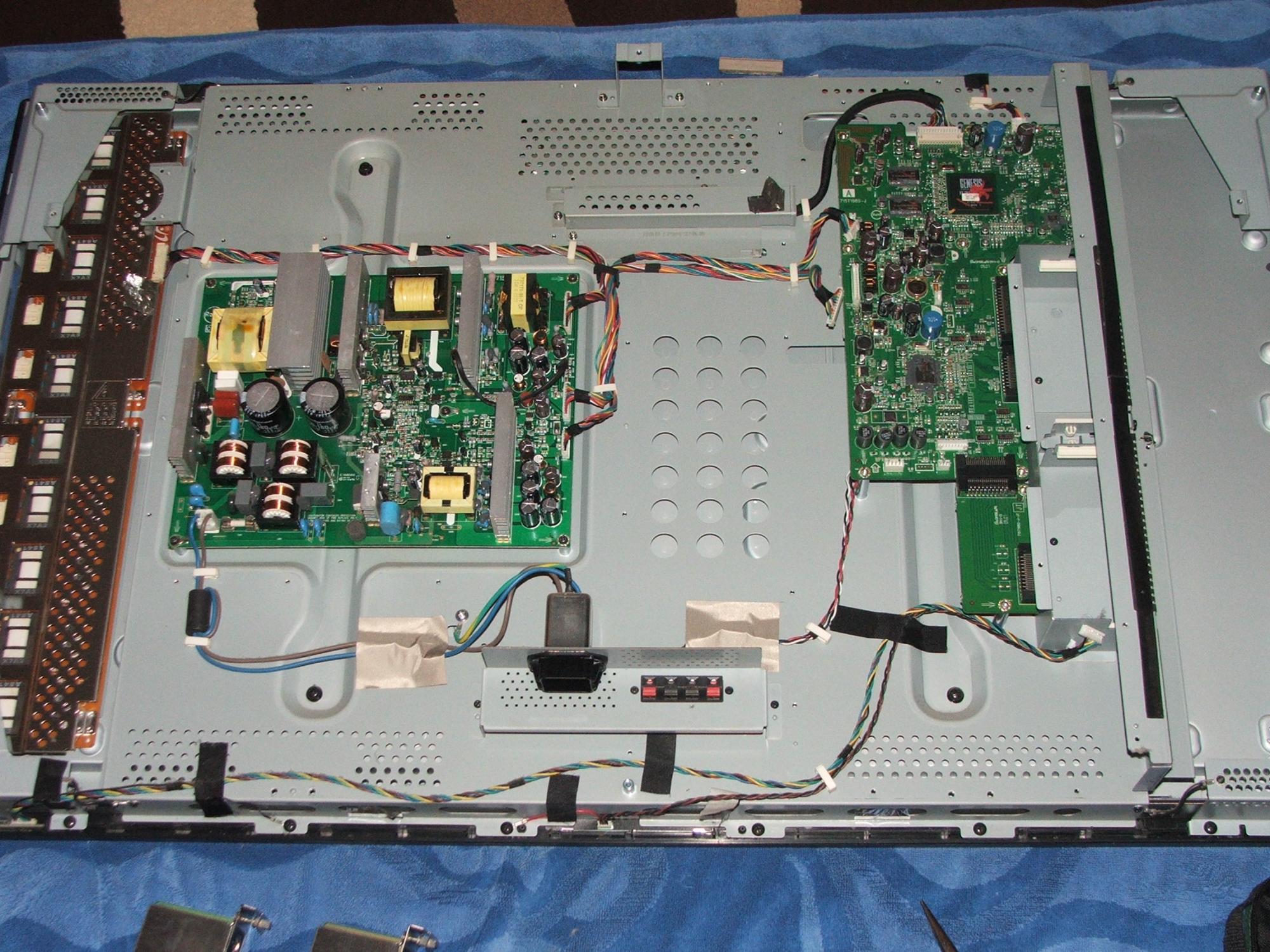

    FWD-40LX2F is the actual model number. Here's some pictures with the back off the TV. First picture is of the whole tv with the back off. The second picture is apparently the power supply. The third picture is of the digital video board.

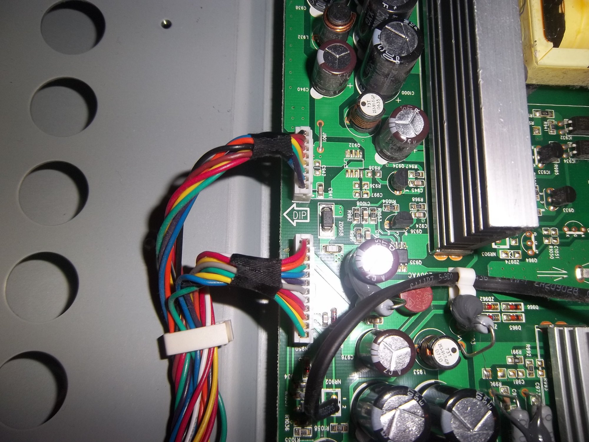

        Post a close up pic of the power connector on the power supply, which goes to the main board.
        Usually no video/sound means a bad main board.

          I think this is what you're talking about....
            Re: Sony 40 in LCD, no video no sound.
            Good - is there a legend next to the pins?
              The only label next to the pins are as follows:
              As you see it in the picture
              - top connection CN931
              - bottom connection CN950

                Remove the board and flip it over. Is there a legend on the other side?

                              There is a T-con board under here. Trace the connector.
                              Unfortunately, it looks like you'll need to remove the metal frame to get at it.
                              I've repaired an Acoustic Solutions (cheap no-name) TV with a Samsung LCD in it - that had a bad fuse on the T-con. Symptoms were no video (but backlit) but good sound. AFAIK, Sony use Samsung LCD panels (S-LCD: Sony/Samsung joint partnership.) The Acoustic Solutions required the removal of the entire metal back frame to get to the T-con.

                                In the first picture there is a black cable coming off the upper end of the main board and going under a metal cover. That goes to the tcon.

                                  Ok, I hooked up a speaker and powered it up -plugged in an hdmi cable from the PS3 and went thru the inputs (I think, again, no way to tell when there is no display or anything for me to tell...) so I would say at this point, no video and no sound. If I knew where the T-con board was, I could check the fuse...if I knew where the fuse was ON the t-con board. There was a fuse on the power board, and I checked that for continuity and it shows o.2 on the ohm meter.
