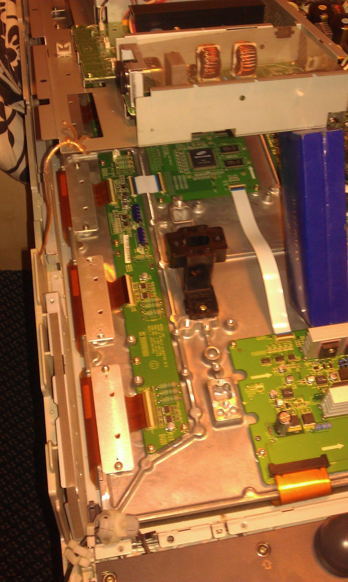

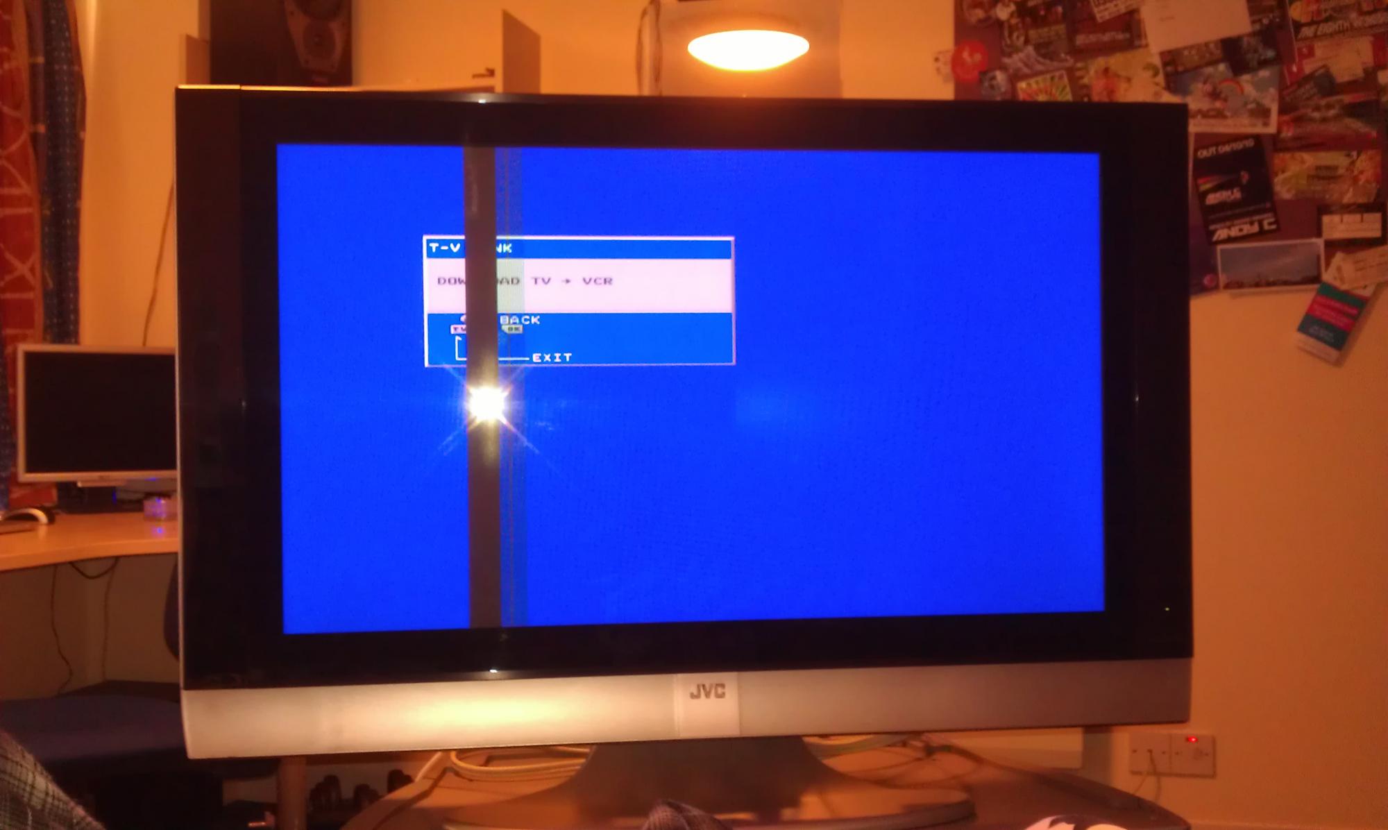

    I have just acquired a JVC 42" tv that has thick black and green vertical lines down the left side of the screen, I have checked all of the ribbon cables for loose connections but everything seems ok. I have been reading some other threads posted here that say this could be one of the X drivers. If anyone could point me in the right direction I would be very grateful, this is my first TV repair!
    I have attached a picture of the vertical lines that are also appearing when the menu button is pressed.
    Alex

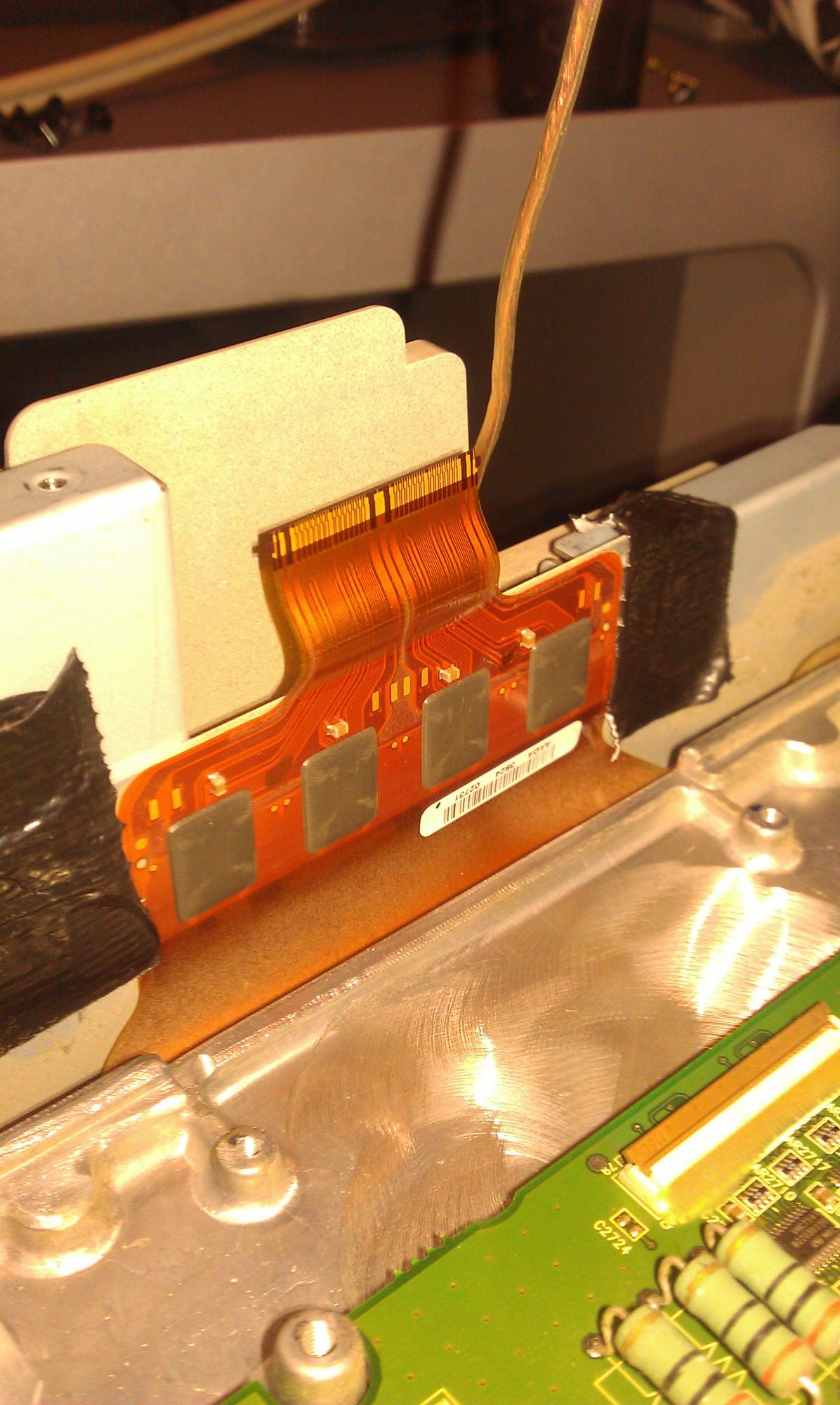

        The X buffers appear to be bonded to the ribbon cable. If that is the case it's essentially unrepairable. Since this is a standard definition panel (852 x 480), it should be treated as more of a learning opportunity than a repair for profit opportunity.

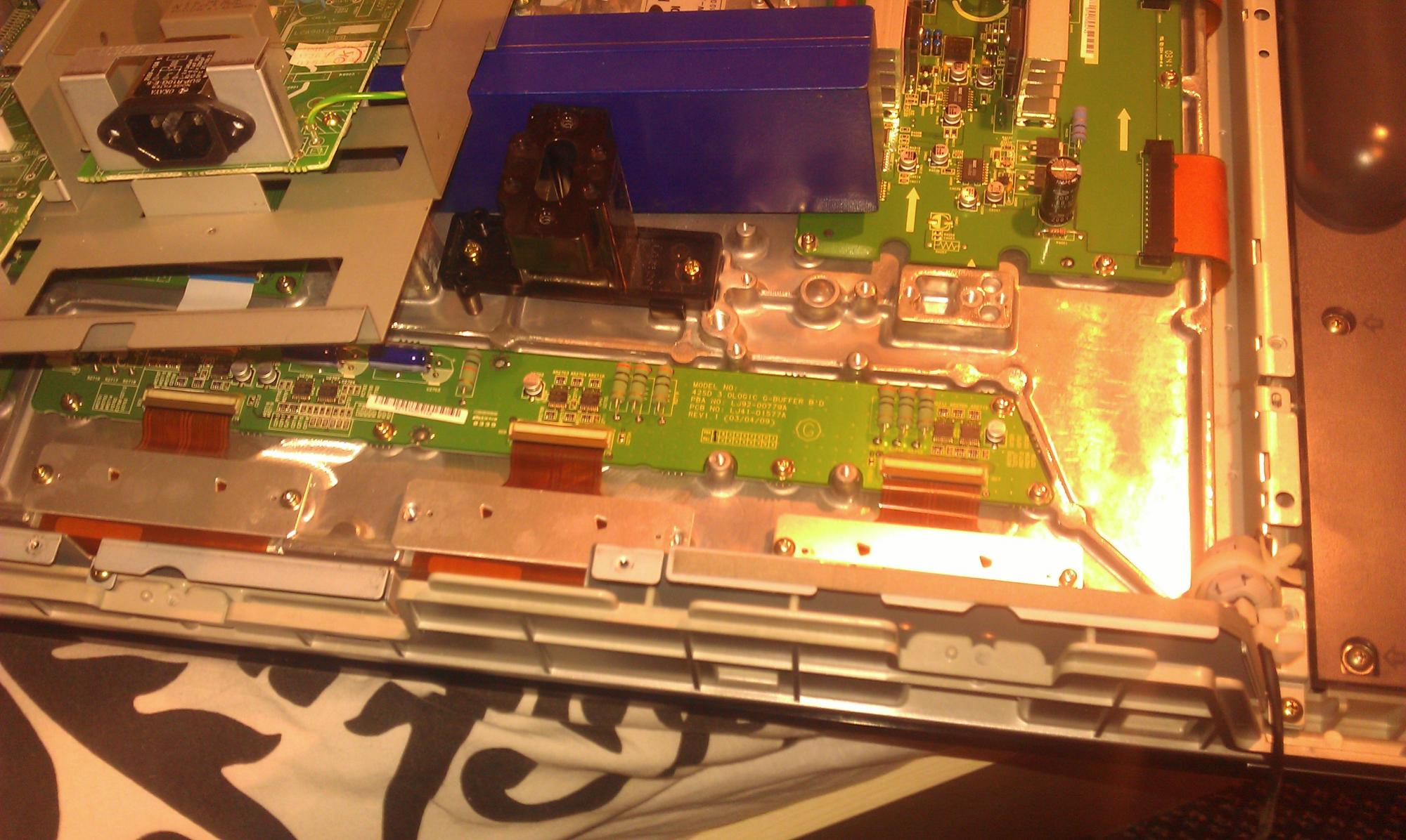

          I have enclosed some more pictures, It seems that the long thin board that the ribbons connect to is called "G-Buffer" but the ribbons also have chips and metal heat-sinks? attached, I have tried to re-solder and check for any dry joints on the ribbon but this has made no difference.
          I have also identified the buzzing sound (only present when the pannel is on) to be coming from the "X-Main" board.

            When there are issues with the g board or when you have vertical bars you will hear the x driver board buzzing a bit louder than the other boards.
            Vertical bars are bad in most cases. You could try a used g board. they are cheap if you can find one. (10 or 20 bucks)
            I have not seen this problem (burned chips) on the older plasma tvs mostly 2006 and newer.
            I have seen the solder problems and board problems with the older units.
            If you can inspect the chip on the ribbon cable or take a look at the g board you might find something.

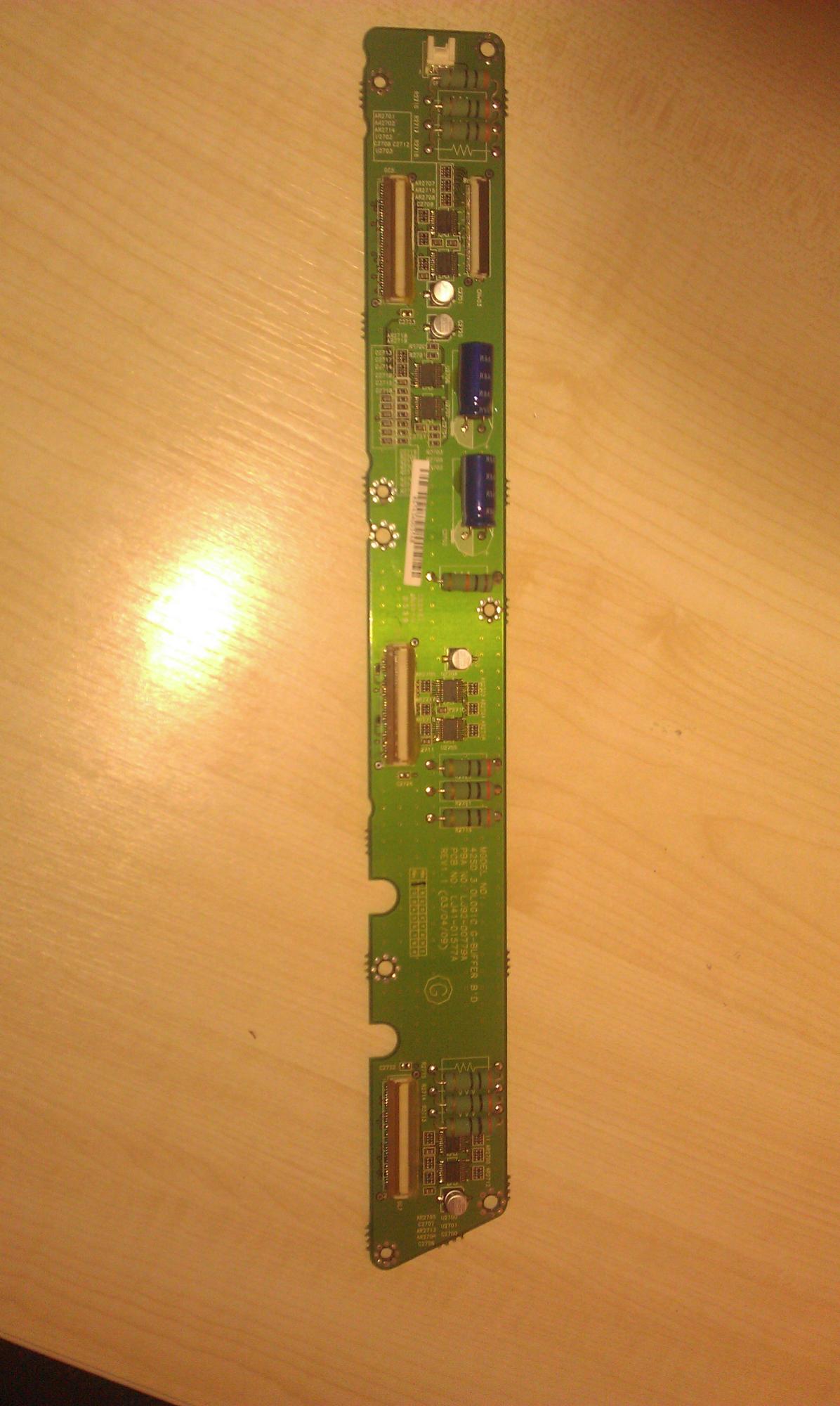

              I have removed the g-buffer board from the tv and inspected with the limited resources I have to hand at the moment! I have seen a cheap g board close by so may go and collect tomorrow and see what happens!
              I will try to replace the g-board but I wil not get my hopes up because something is telling me this is more serious!
              If it turns out to be the pannel, and I can source a relatively cheap replacement, is the swap over straight forward - I have worked with smaller LCD's before but never plasma displays?
              Many Thanks

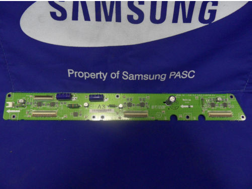

                    Thanks for the advice guys, I have not been able to locate a buffer board at all in the UK, I have however found a another board that looks very similar. Does anyone know if this is likely to work, or am I wasting my time?
                    First Picture is the original board, second is the similar one
