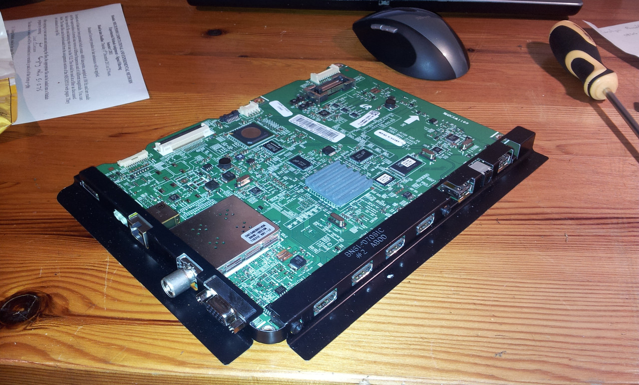

                        • graham01
                          • Oct 2011
                          • 92
                          Re: Samsung 59" Plasma 3D Blank Screen
                          hope this is okay
                          regards
                            I need one looking from the top. It's difficult to locate components side-on.

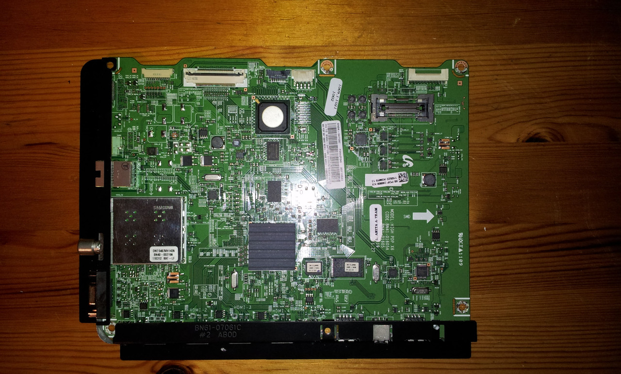

                            • graham01
                              • Oct 2011
                              • 92

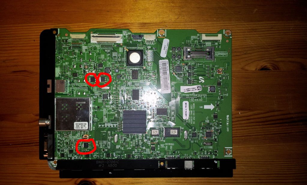

                                It would be nice to get a higher resolution (2000x1500 ), but here are some basic tests.
                                RED circled regulators: Check the voltage on each pin (except the middle pin) relative to the metal case of the TV. Do this while TV is trying to turn on. Record the voltages and the part number on each regulator.
                                Heatsinked processor: Does it get warm? (leave to warm up for 10 minutes)
                                Processor with metal pad: Does it get warm? (leave to warm up for 10 minutes)
                                If I had a higher resolution, I would be able to highlight other potential failed components, such as diodes.

                                • graham01
                                  • Oct 2011
                                  • 92
                                  tom, thank you very much for your help, I will do this now.. I apologize for the poor image quality, it is strange, on the image I took you can even zoom in and read the part numbers on the board.. how should I upload it?
                                  Regards
                                  • PCBONEZ
                                    Grumpy Old Fart
                                    • Aug 2005
                                    • 10661
                                    The site resizes so you have to compensate by starting with a bigger pic.
                                    Closer would be good too if you can keep it in focus.

                                    • graham01
                                      • Oct 2011
                                      • 92
                                      Thanks, I tried to attach but not sure if it has worked.. Anyway the voltage regulators as you have circled;
                                      Top Left: IC707_3V3 - 17-33Z 1105AG
                                      Left Pin: 5.34V
                                      Right Pin: 0V
                                      Top Right: IC203 - N055 950T45
                                      Left Pin: 2.50V
                                      Right Pin: 3.30V
                                      Bottom: IC708_1V6 - 17-18Z 1022BG
                                      Left Pin: 3.30V
                                      Right Pin: 0V
                                      Both processors are luke warm after 5 minutes.
                                      My eyes may have deceived me when taking the model numbers..
                                      Regards
                                      • graham01
                                        • Oct 2011
                                        • 92
                                        the upload failed twice, I think maybe because its 3.6MB.. You can find the image below;
                                        http://postimage.org/image/odnwgcpb5/
                                        Regards
