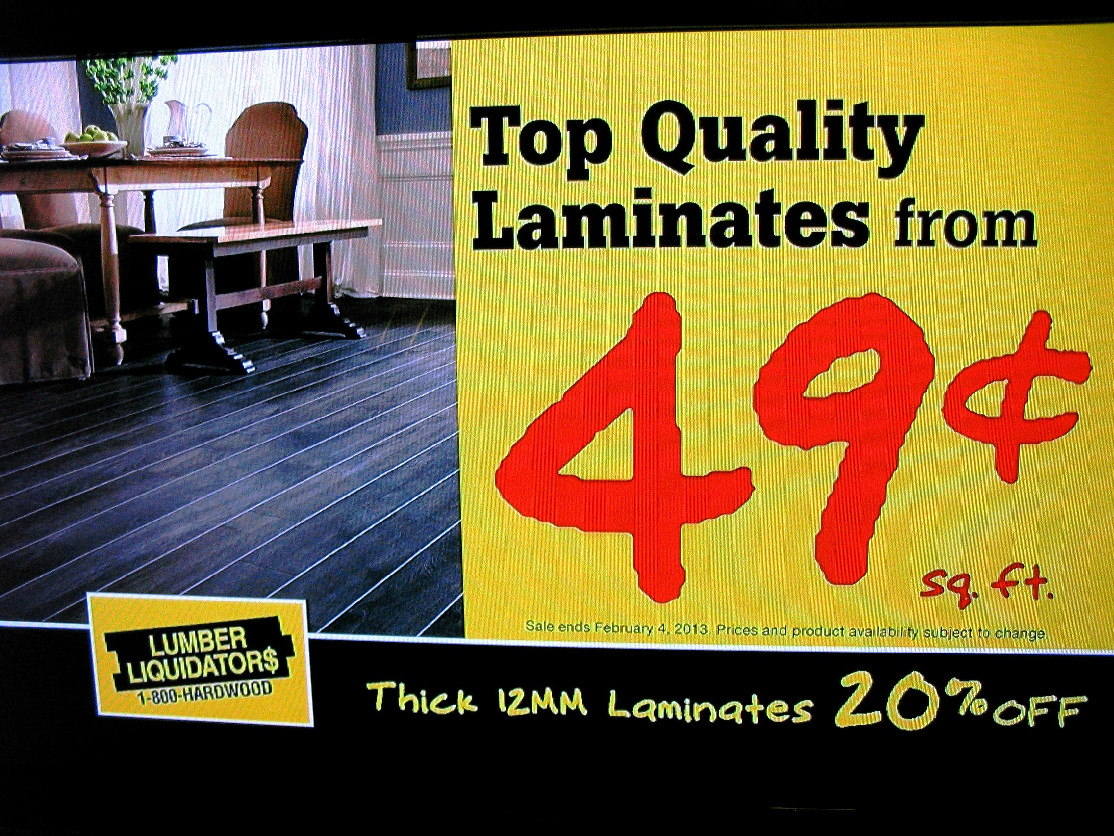

                  As a follow-up to my Insignia TV failure that appears to now be resolved, I found the following issues:
                  - Two bad IGBTs on the Z-Sus
                  - Three bad IGBTs and a bad diode on the Y-Sus
                  All the above components were on the large heatsinks. I also replaced the Y-buffer board, just in case.

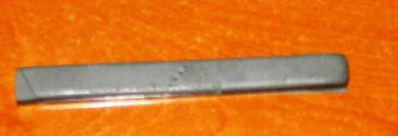

                        How would you recommend I reattach these pieces to the sustain boards? It looks like double-sided tape of some kind was used originally. I have some Momentive RTV, but I don't want to unnecessarily make a mess if there's a better way.
                        LG Plasma Mal-Discharge Correction Service
                          #52
                          Re: samsung PS42C450B1WXXU
                          I'd try re-using double sided tape

                            Ok. I was concerned about whether the tape originally used has properties that make it unique for use with electronics. If any similar double-sided tape will work, great.
                              #54
                              I think it's supposed to stop the board from flexing and touching the panel, causing a short.

                                  The reason for the above question is that I took a VERY wild swing and installed my good Y-Sus from the Insignia into a 42C450B1D I just picked up today; the Y-sus blew immediately when the buffer board was connected
                                  (1) The Y-Sus was fine when it was connected to the power supply without being connected to the buffer. Once I connected the buffer - POOF!
                                  (2) I left the Z-Sus disconnected when I installed the Y-Sus. BTW, the Z-Sus's components seem to check out fine in this TV.
