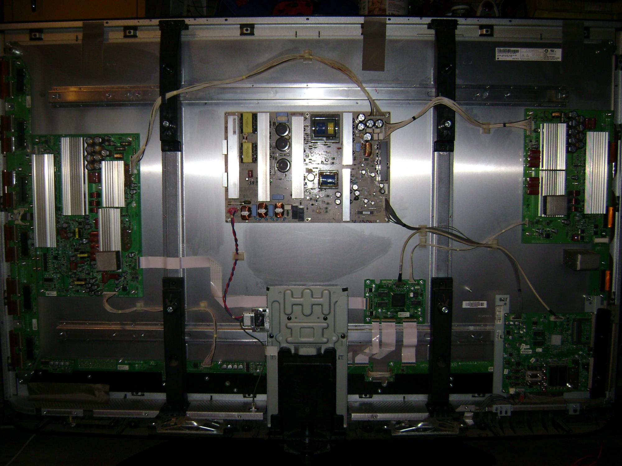

Hi everyone, first post and new to plasma TV repair. Repaired some LCD's Xbox 360's,PS3's and other various electrical and electronic appliances over the years. Hoping you clever bunch can point me in the right direction in fault finding this set as it's information overload at the moment learning about Plasma repair!!
Model number - 60PG3000-ZA
PDP Model number - PDP60X70223

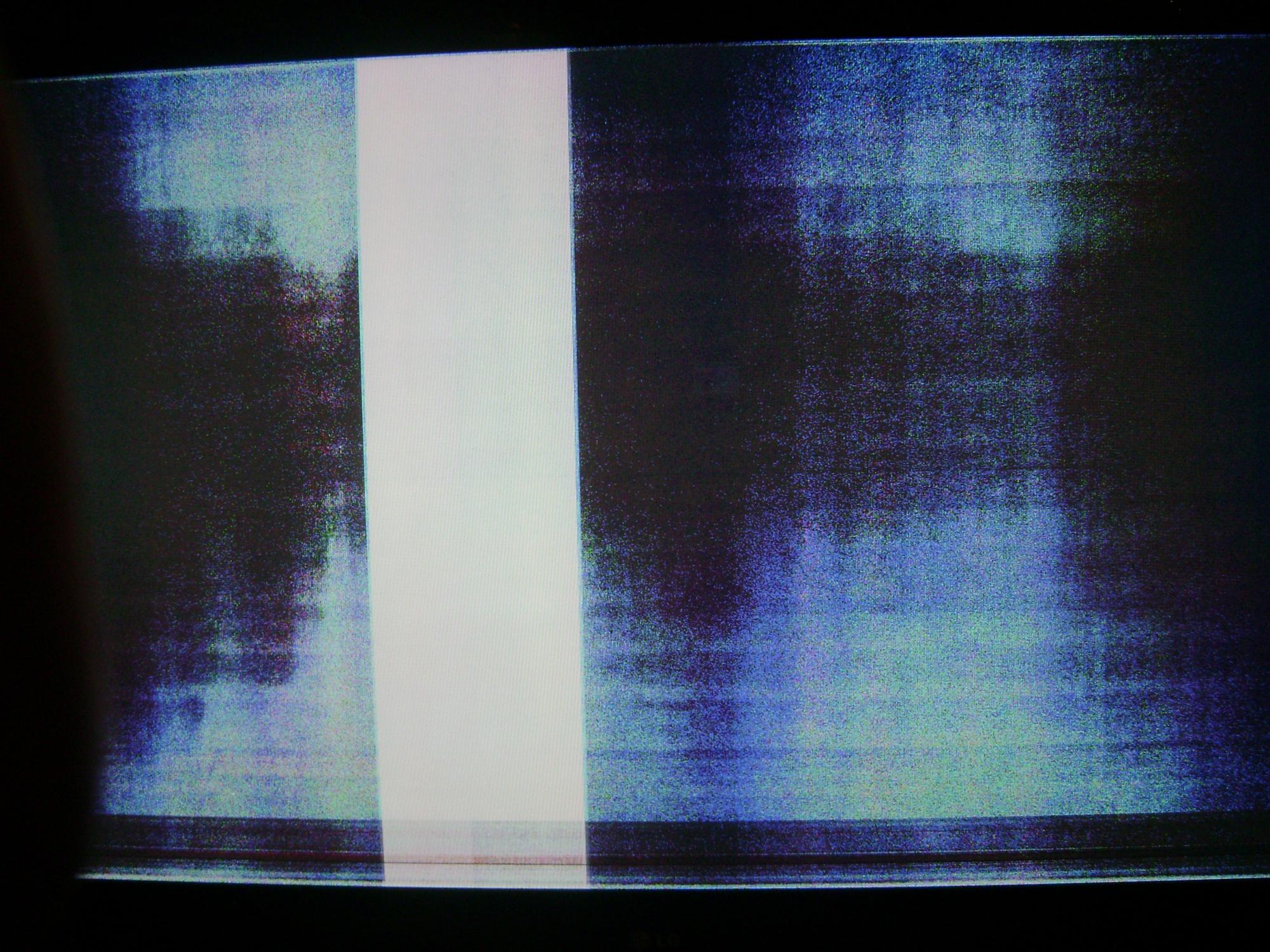

When you first power the unit up from standby it will display mal-discharge? and large vertical white bands that will appear randomly across the screen. Normally when you first power it up it will revert to standby but after a few try's it will display the picture as described (see picture below) for around ten minutes, then revert to standby.

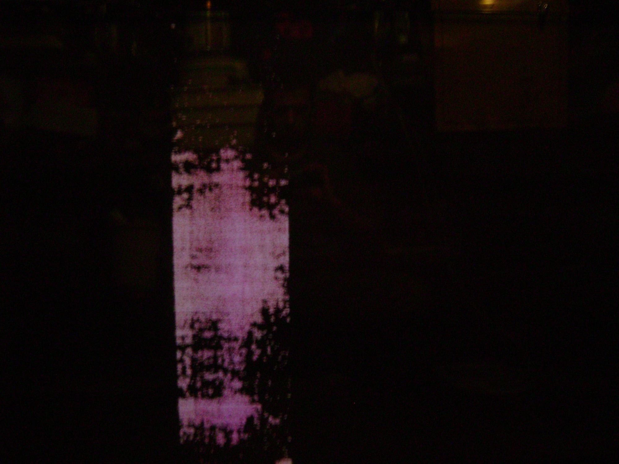

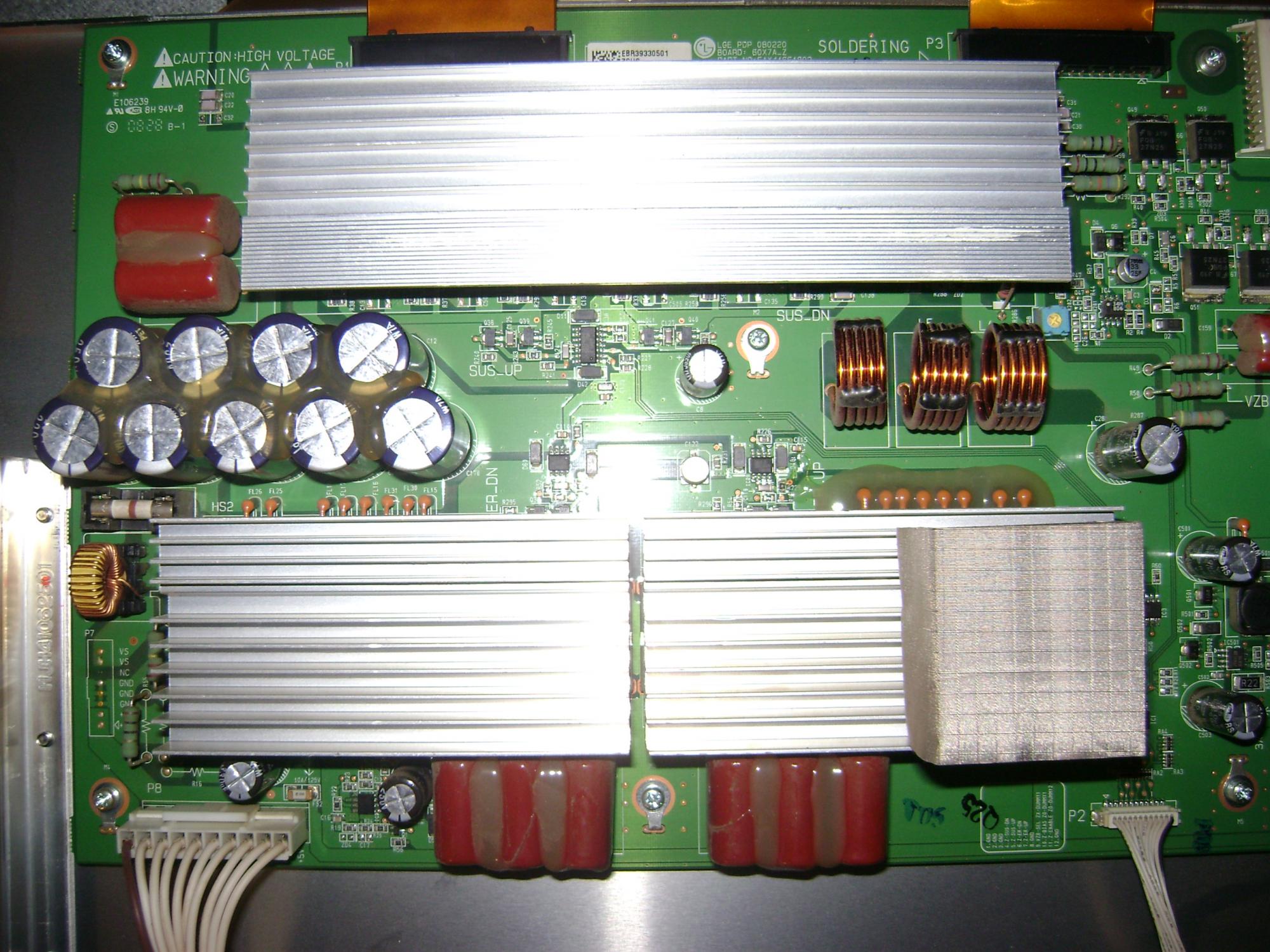

With Z-SUS disconnected the unit attempts to display the large white vertical bands but these are essentially expanding blotches of mal-discharge (pictured below) that attempt to fill where the white bands were previously shown with both the Z-SUS and Y-SUS connected. The rest of the display other than these areas is black. The unit will sometimes revert to standby when in this condition, other times it will not.

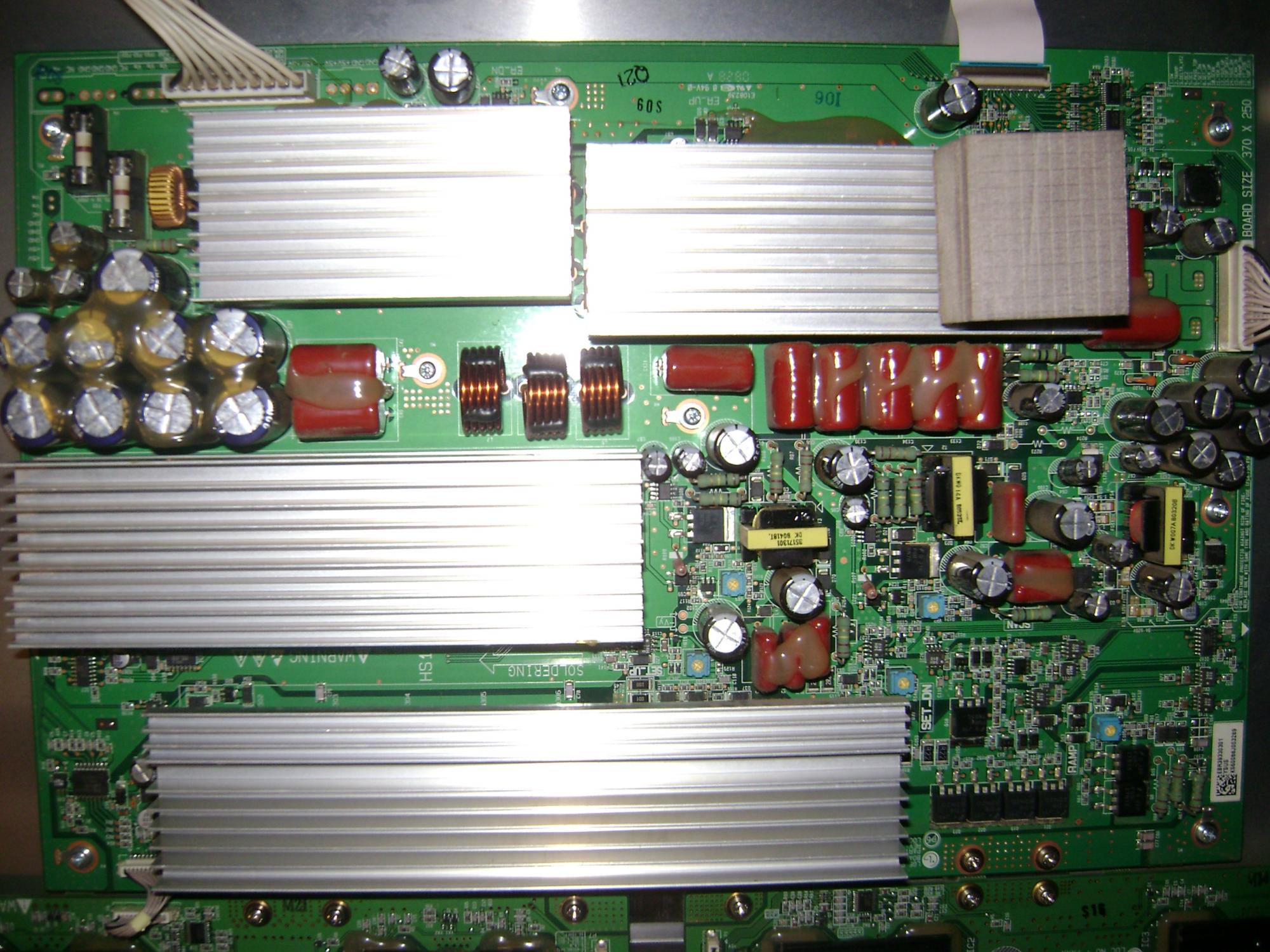

With the Y-SUS disconnected the unit has a dark screen although the green power LED (on front of TV) remains steady and does not revert to standby.
Tried bridging the AUTO_GEN with the LVDS cable disconnected to see if the self test card would appear. Test card does not appear, symptoms remain the same.
Only tested one source and that was HDMI. Got sound, but picture essentially remained the same, except with vertical multi-coloured lines appearing across the width of the screen.
All voltages on the power board test good.

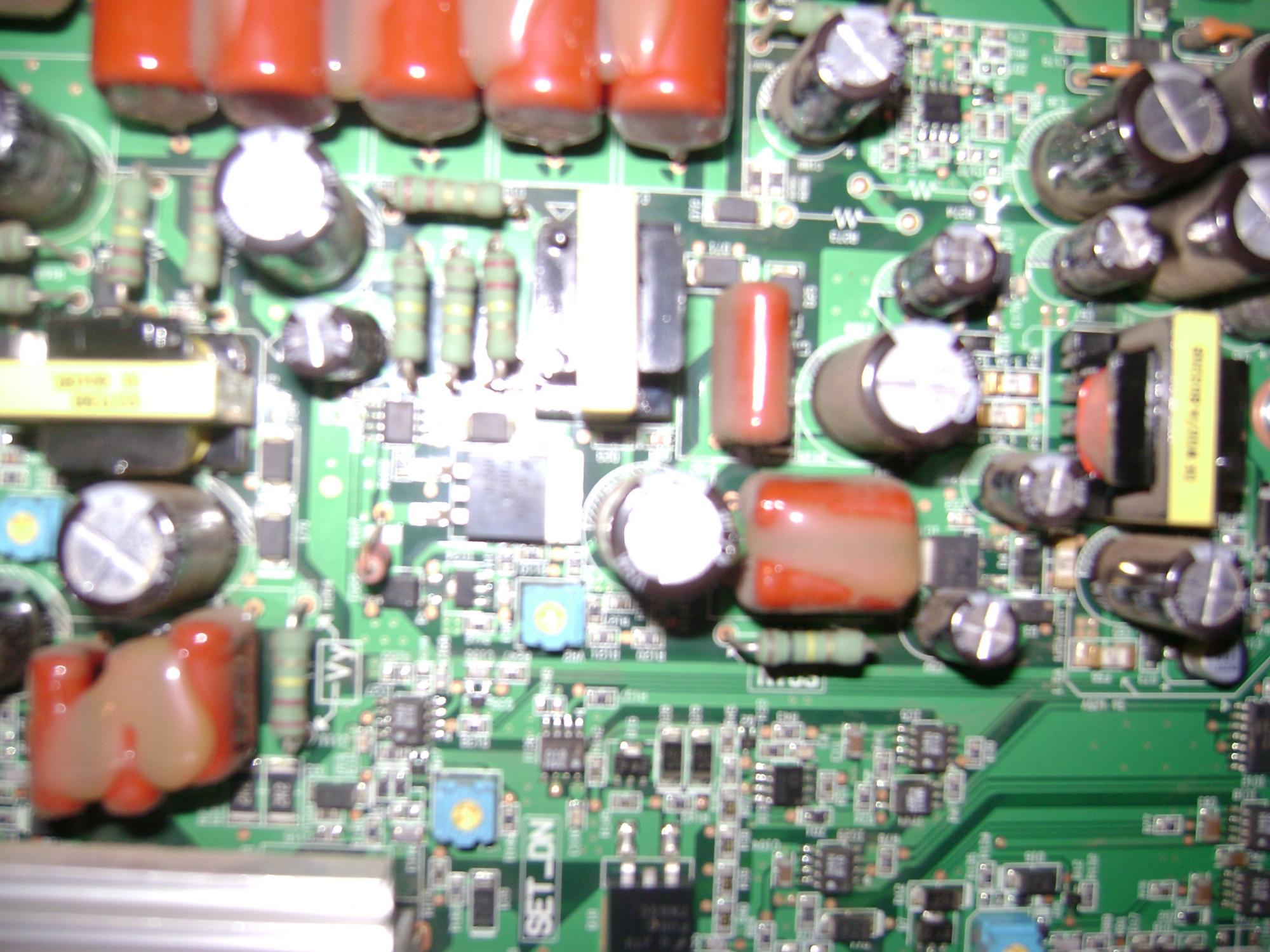

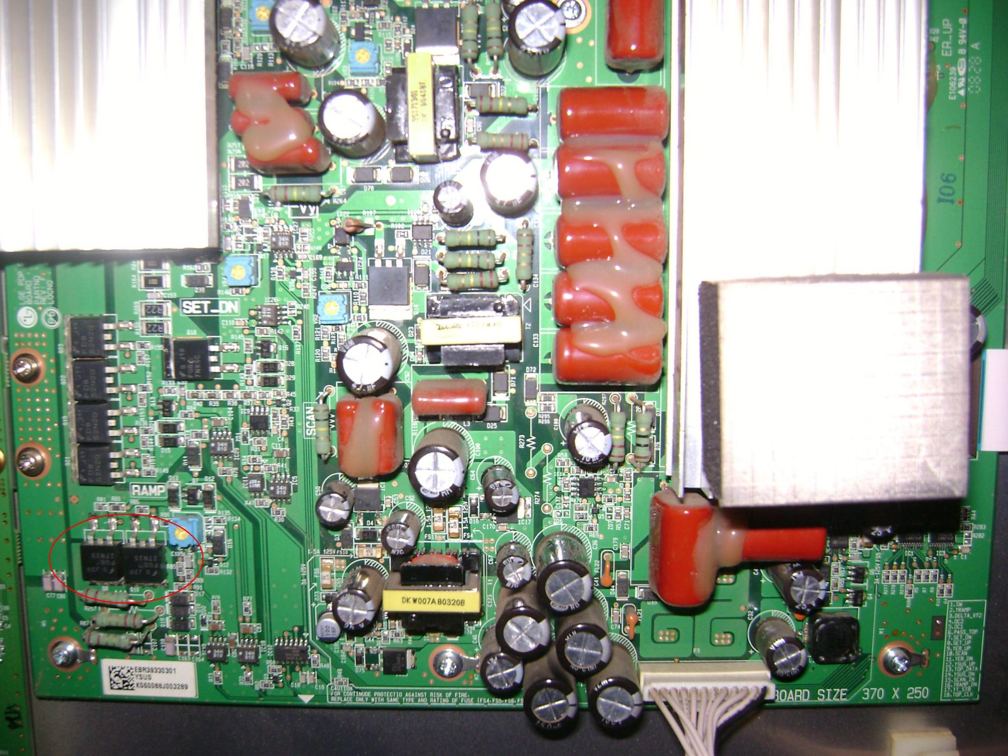

There is a resistor on the Y-SUS for testing the -VY voltage. When I attempt to check this I can not get a stable reading. I can not locate where to take the VSC voltage on the Y-SUS.
Seems to my like the Y-SUS is were the problem lies, going by the erratic reading on the -VY resistor check point. However, I have read that there are ROM firmware issues with these LG models, that when updated, can solve mal-discharge problems of this nature, and I would like to rule this out as a possibility before continuing, as getting the FW to update is not likely and would mean purchasing a new control board. Not wanting to do this if the problem is the Y-SUS...
That leads me neatly to why I have posted looking for any advice from some of you repair vets on further testing to locate which board (or potentially multiple boards!) that are causing me sleepless nights!
